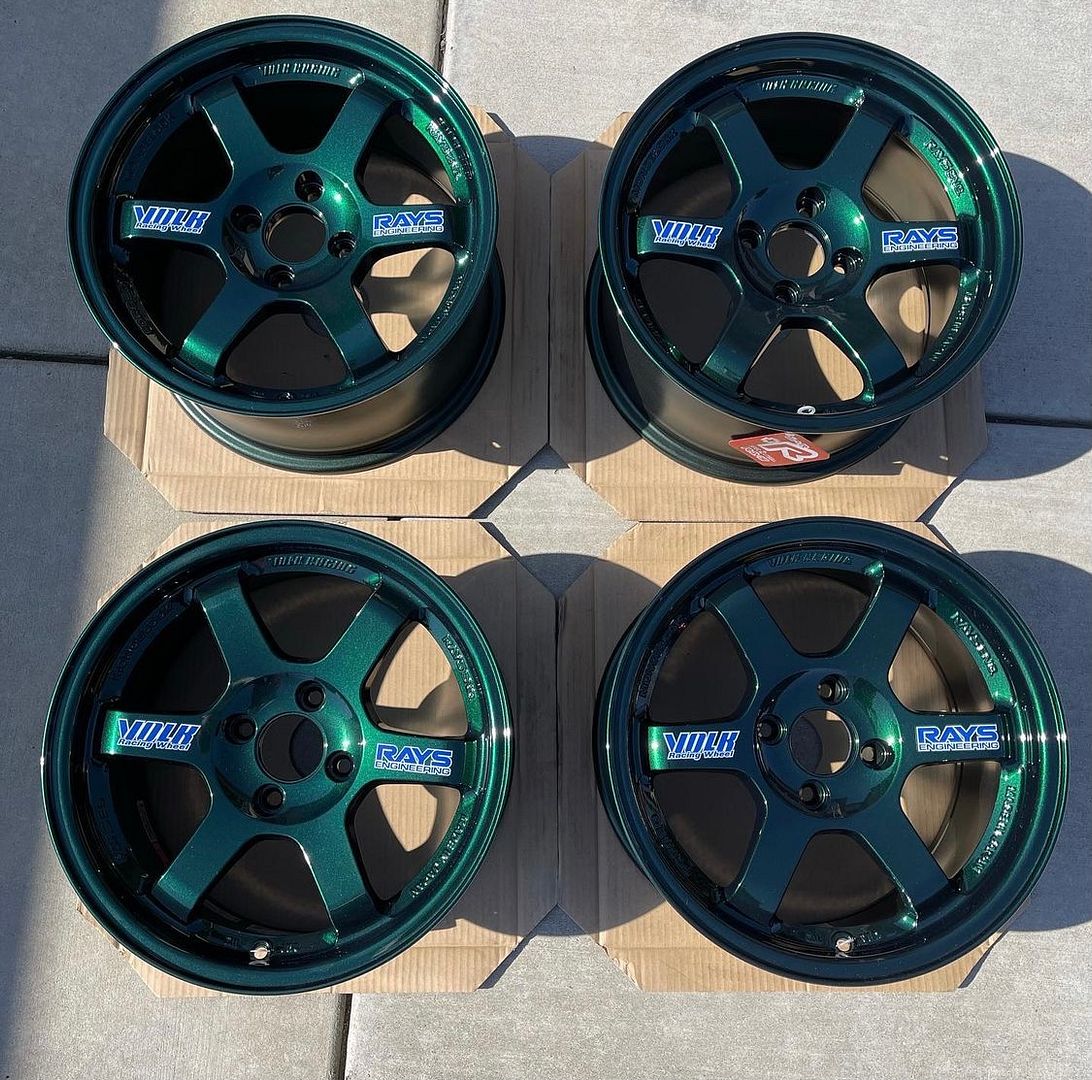

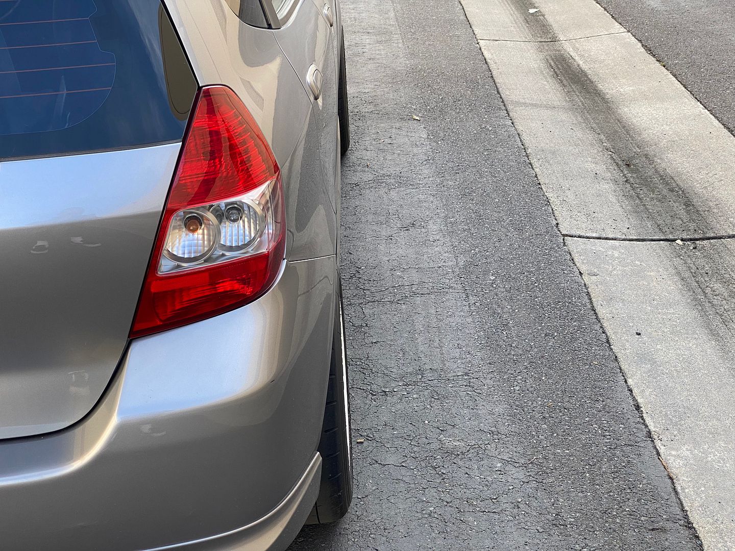

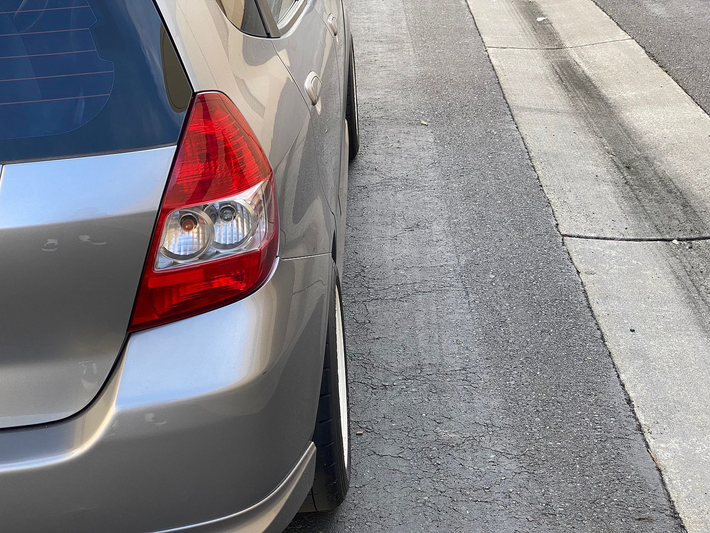

Here are a few pics of the wheels and fitment, perfectly flush no spacers, fenders rolled but not pulled. No rubbing at all but I'm also just lowered on Swift springs 15x8 +35 205/50 camber at -1.5 all around

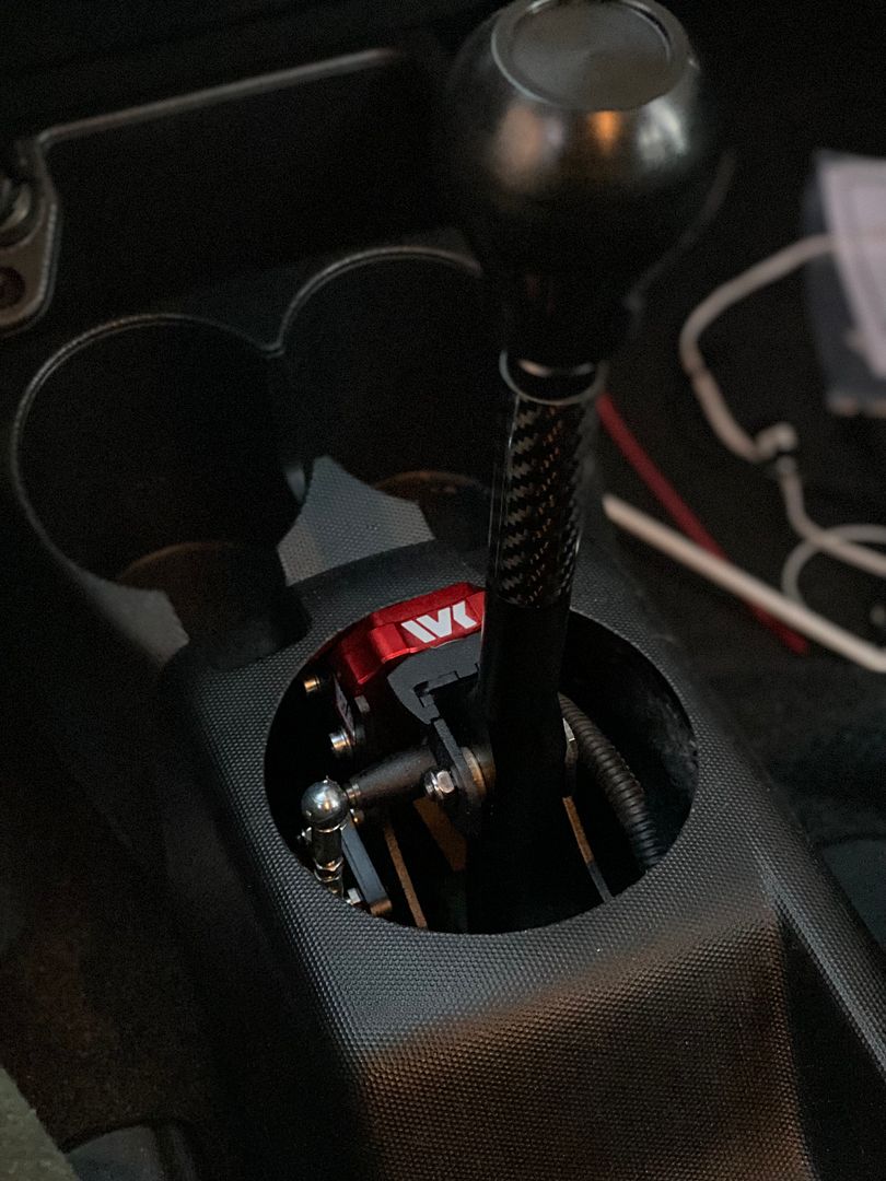

Also, installed the WK Motorsports shifter and holy.. Throws are even shorter than my friends Hybrid, dare I say almost too short? Feels like I'm shifting a sequential trans

I think it's great that Fit owners have multiple adjustable-short-shifter solutions available on the market now. Wheels look nice; give them a proper clean and let that white shine.

I installed an Mtec shifter spring when I did the CDV delete and that paired with the WK makes it feel like a gated shifter but with 1 inch throws!

Do you have any parts for sale? Just picked up a Recaro Sportster CS and can't find anyone that stocks the Bride Type RO bracket needed for it, might have to go Wedge if I don't want to wait months for the Bride to ship from Japan. Though, haven't had the best experience with their fitment/quality in the past(Wedge).
If you know anyone selling their Racing Green or OG Bronze in 15x8 +35 let me know!
I love the MTEC shifter spring. I'm always amazed at how such a small part makes such a big difference. I will be doing the swap with a friend at his house. He swapped his GE8 with a K24 years ago before things were becoming more popular and figured it all out with everything functioning. The L15B7 will definitely make more power with simple mods, but I am a big fan of naturally-aspirated engines.

I spent months trying to source Racing Green TE37SLs with no luck. If you find a set, they're going to be very expensive and/or not in the greatest shape; only real option is to order and wait. I was lucky and found the 16" Sonics available in NorCal and opted for those since I figured they are a better match for the future K24 anyway.

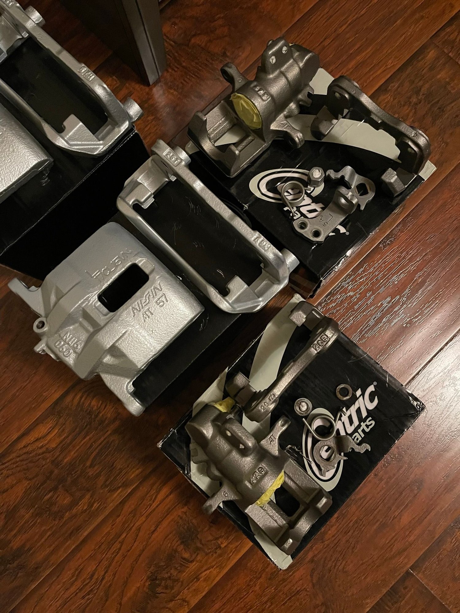

I think I selected 2007 Mini Cooper for the rotors; just make sure they are the 280 mm discs and you're good to go. You don't need to swap your master cylinder to make the brake calipers work. All you need are the calipers, rotors, TSX brake pads and it bolts right on.
So I don't get this wrong, 2007 Mini Cooper 280mm rotors, TSX pads, calipers (17CL15VN) will bolt right up to a GD3 with no problem at all? And you said that one doesn't have to get upgrade the MC?
Yup, TSX pads for 2004-2008, but I believe they're the same even past 2008. This setup will work for any of the USDM-spec Fits. BMC upgrade is optional, but it is not necessary for the setup to work. If you search "ITR BBK" or keywords along those lines, you'll find a lot of information on this exact setup as it is not specific for the Fits and is widely used by many Honda enthusiasts for a cheap and effective upgrade.

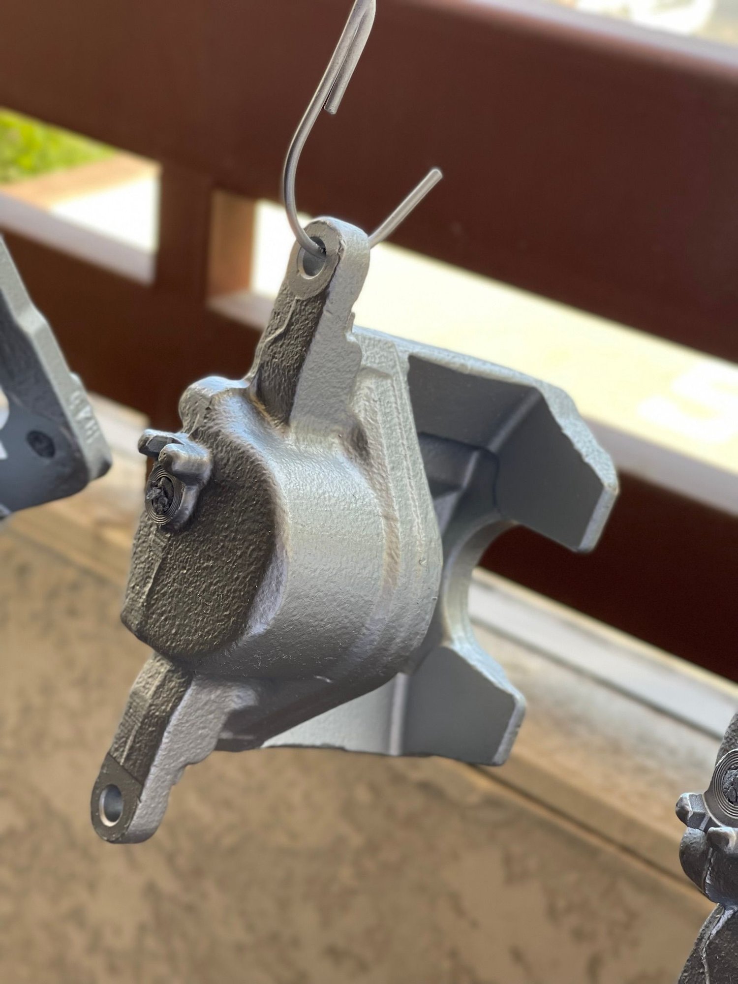

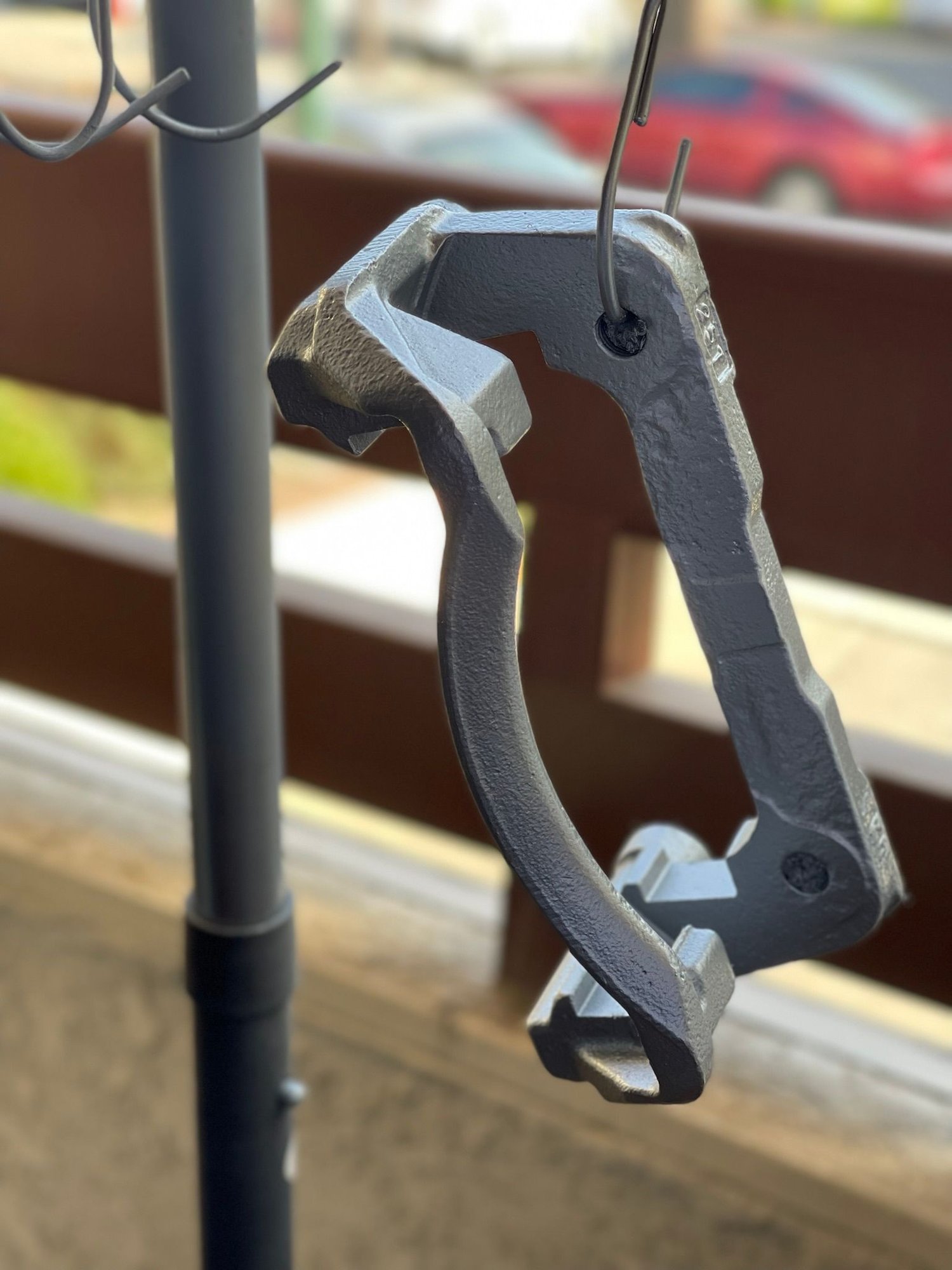

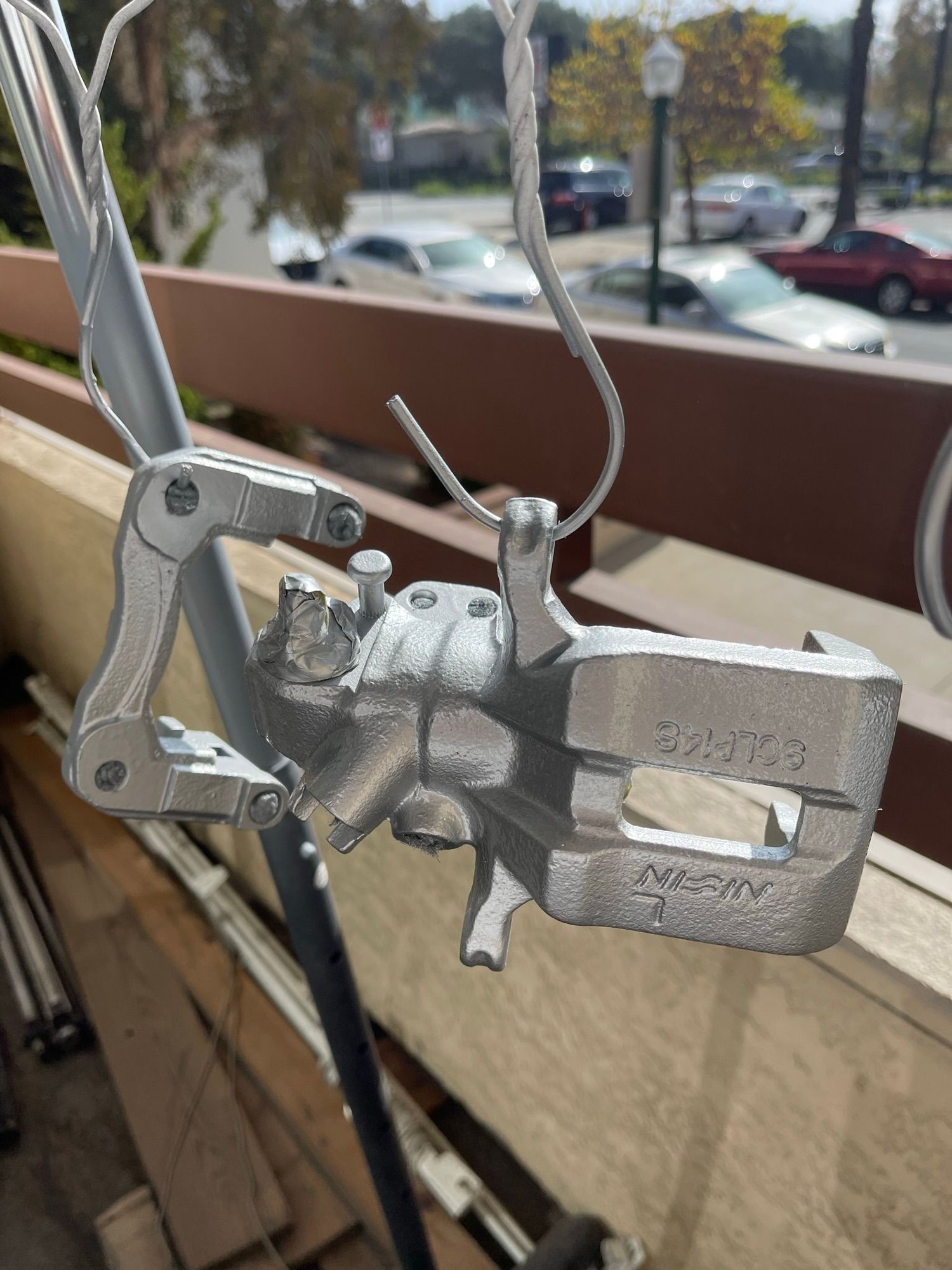

Initially, when I installed my front BBK and rear disc brakes, I opted not to paint my refurbished Centric calipers--this was not a good idea. Centric applies an anti-corrosion coating to the calipers, but it does not last long at all, so my current calipers don't really look all that great. That being said, I bought a new set of front/rear calipers, to avoid downtime, and painted them with VHT paint (VHT SP735). I like the clean and simple look of silver calipers. Unless you know what you're looking at, you can't really tell what's going on with silver calipers, which I like.
Here's a before & after with the front, painted calipers next to the rear, unpainted calipers:
Rear caliper & bracket painted:
Front caliper painted:
Front caliper bracket painted:

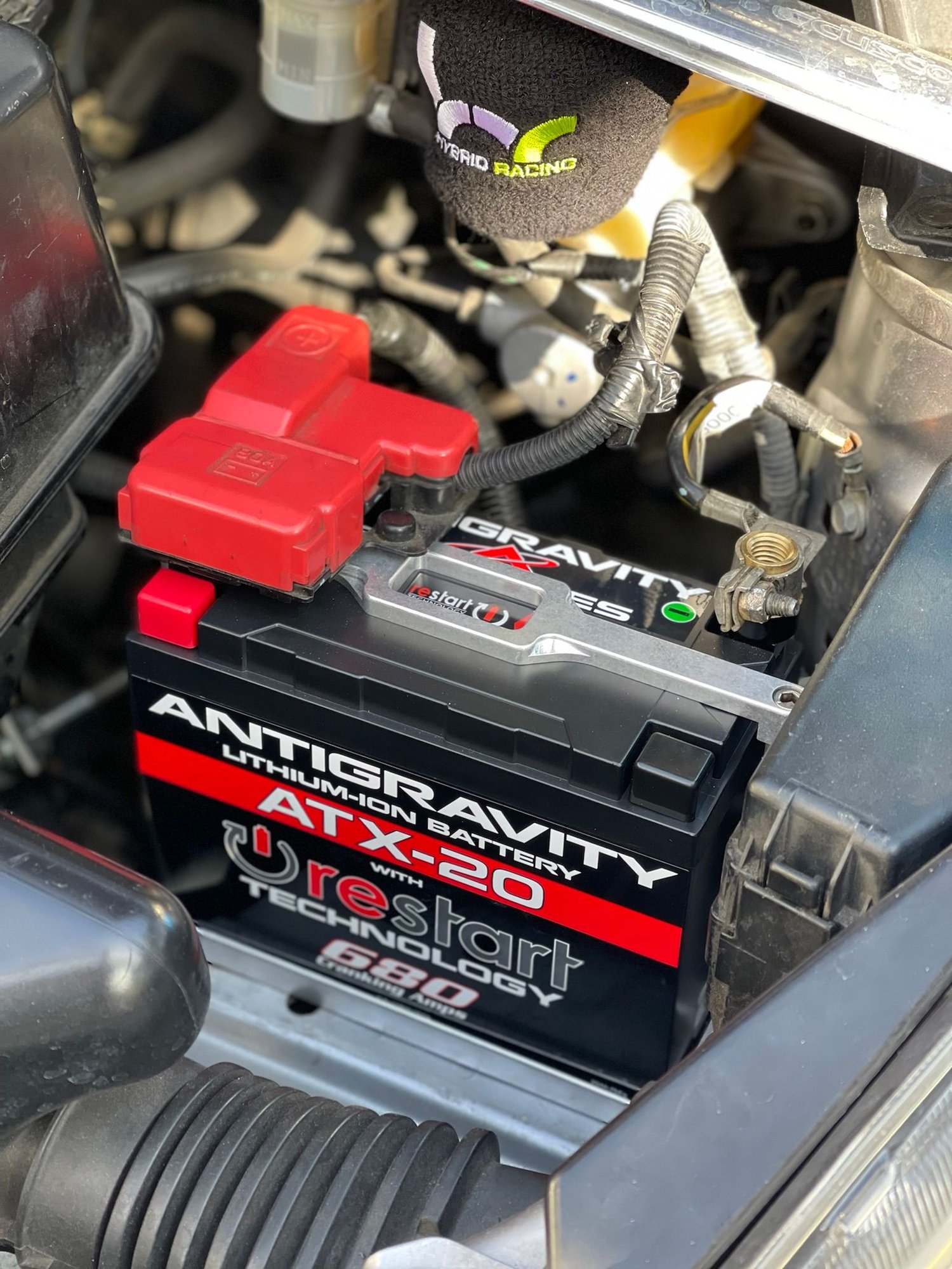

I also installed an Antigravity ATX-20 battery in place of my OEM Honda battery. This saved me roughly twenty pounds, on the nose of the car, over the stock battery and it fits great with the optional battery tray. With the rest of my weight reduction, I should have removed roughly one hundred thirty pounds from the car and I still have some more to go.

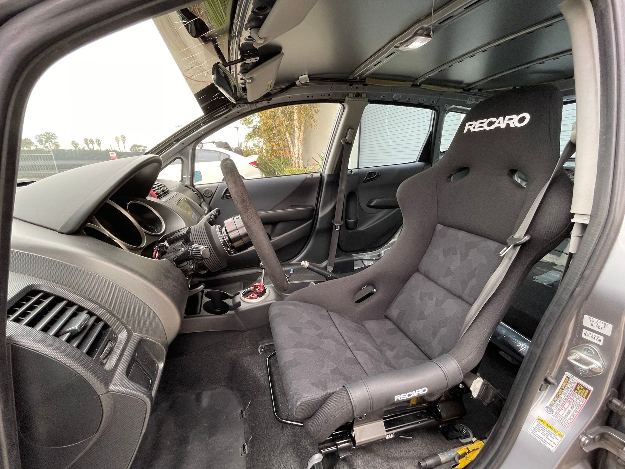

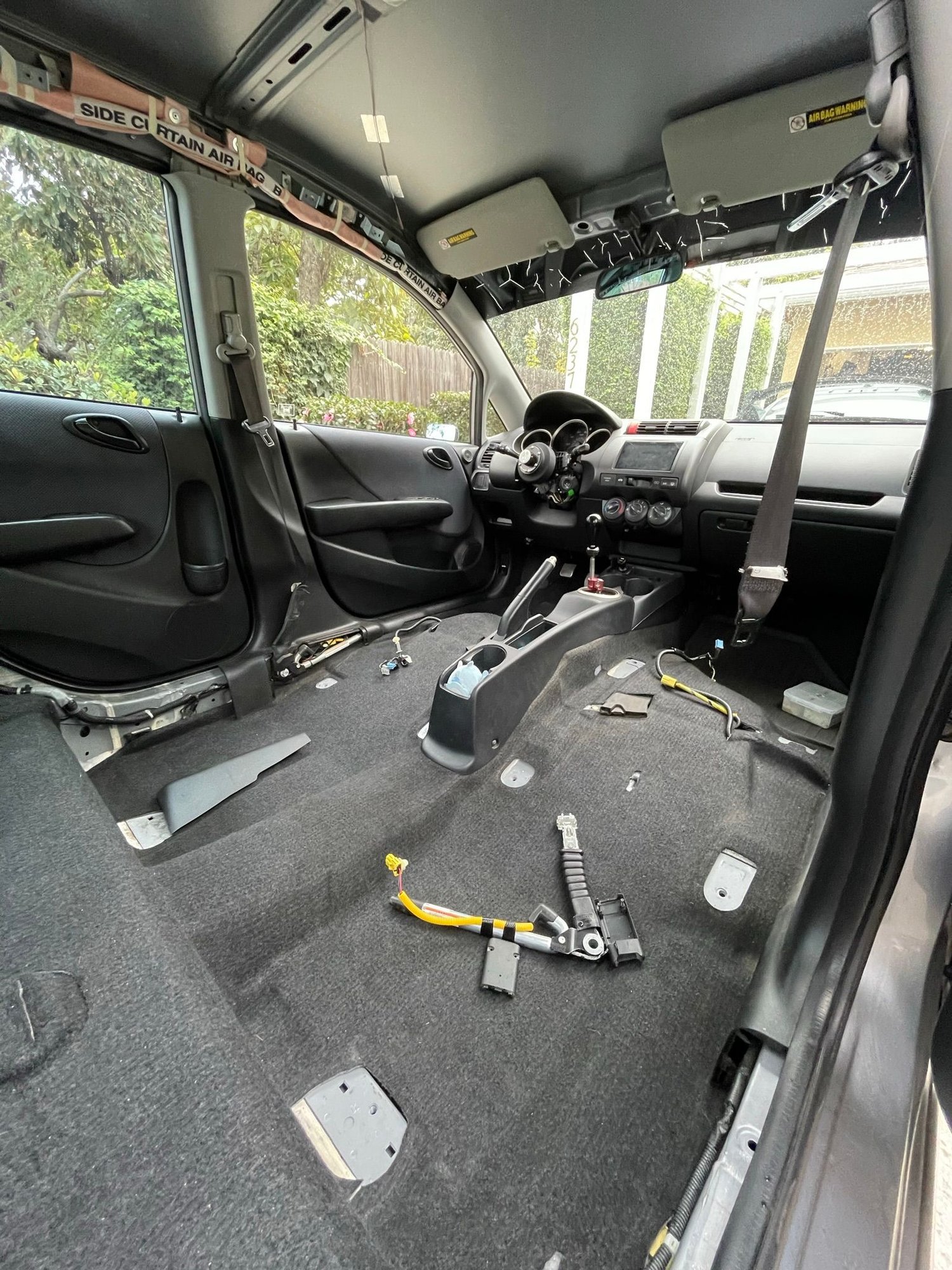

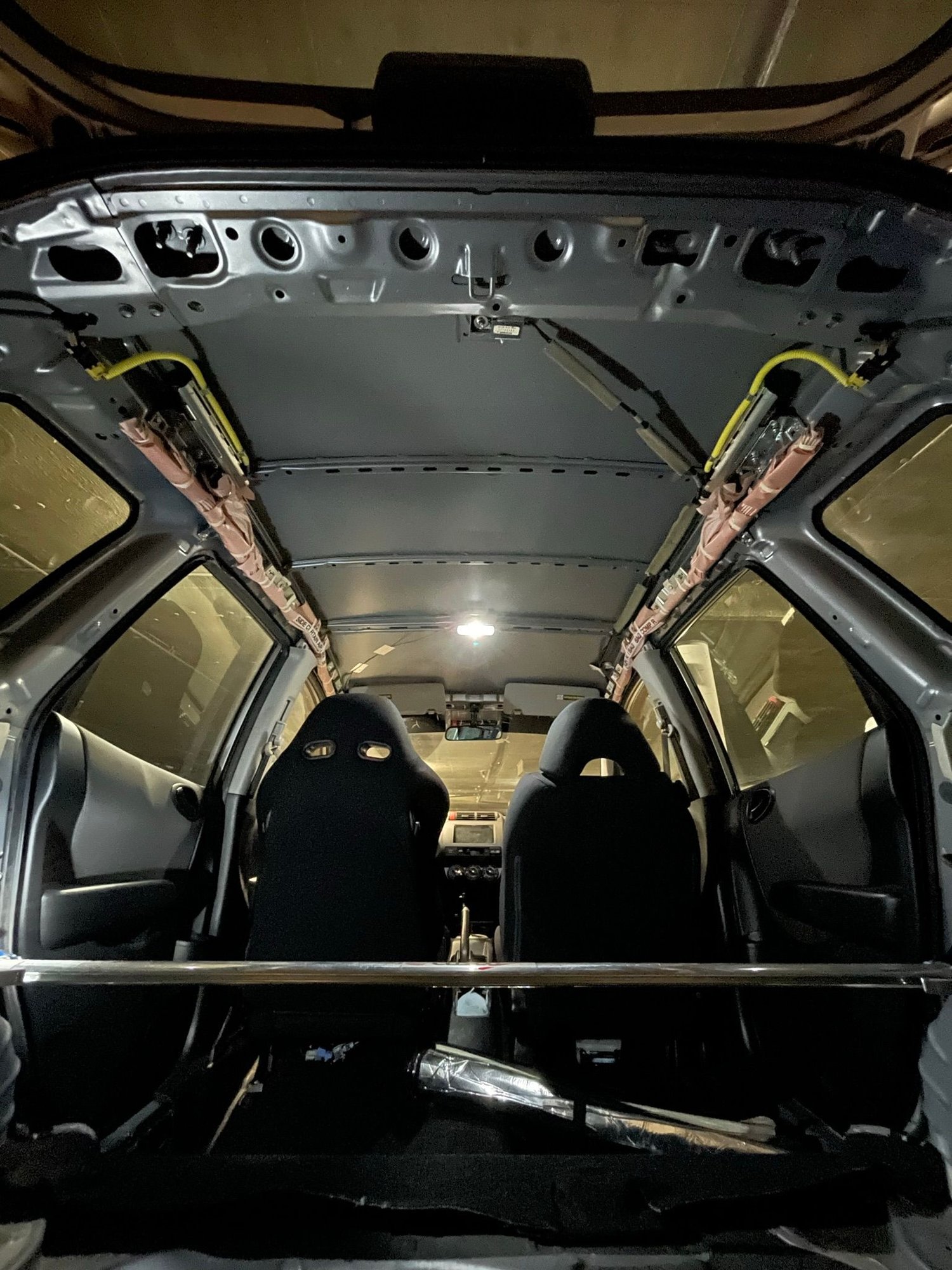

Recently, I bought a Recaro Pole Position ABE with matching fabric pattern to my Recaro SR-4. For the time being, the Pole Position will be my new driving and the SR-4 will become my passenger seat. Unfortunately, with the way the factory seat belt is designed for the passenger seat, it'll take a bit more work to have the OEM seat belt work with the aftermarket seat, so it's just the one seat, for now. I also removed my curtain air bags along with the passenger air bag for further weight savings and to continue to steer towards my goal of turning this car into a track machine. Currently, with no passenger seat, total weight removed from the car is around 267 lbs. I still have quite a few things I could remove or swap for lighter components, so we'll see what else happens.
Here's a photo of the setup before I swapped over to the Pole Position seat:
Here's another look at the interior while it was in the process of having the Pole Position seat installed:
Here's how it sits for now:

1) I was going to ask you how the rear seat delete affected the handling of the car, but I see that you've now gutted the entire car, so I'll ask: How does gutting the car affect the handling relative to a stock car?
2) Is that Antigravity battery suitable for a daily driver?

What are you considering to mount the passenger side seatbelt ?
Nice build.
Sorry, I couldn't really tell you because I never had this car stock. I bought it with coilovers and some other modifications already installed. I'd imagine my weight balance is off further than stock; I've also yet to corner balance the car. There's still a lot of weight to shed, if you want to be technical. I will also be adding a passenger seat back in, but it wasn't done at the same time as the driver's seat install because it required additional modifications to make it work. My goal with this car is to have it heavily-geared toward track usage, so the shoe may not fit most others.
Future ideas might include:
- removing interior carpet entirely
- removing front anti-roll bar and end links
- relocate battery inside vehicle cabin and remove factory battery tray
- removing remaining interior plastic panels
- removing wiring from harnesses for stuff that isn't applicable to my car any longer
As for the battery, I don't see why it's not suitable for daily usage. It's been in my car for over a month now and I've had zero issues with it. This is my daily driver by the way.
Do you have any parts for sale ? Always wondered what you did with the original jdm tail lights that came with the car, those still around ?
We're going to remove the provision from the factory passenger seat rail and bolt it on to my Bride rail which will allow us to bolt the passenger-side seatbelt to the seat rail as if it were a factory seat rail. I'm working on having custom seat mounts made that'll better suit my needs and will be selling my Bride seat rails and the side mount brackets eventually.
