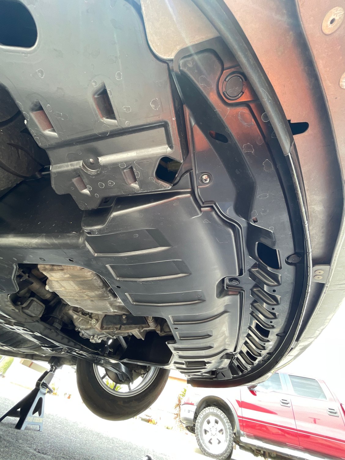

When I initially installed all of my fender liner/splash shield components, I chalked up the loose clip fitment on the splash shield to the age of the car. However, after looking over parts diagrams, I realized that I was missing the front bumper air spoiler, so I went ahead and ordered the missing piece and got it on the car. Everything fits nice and snug now.
Here's a bottom view of the front bumper air spoiler installed on the car:
Here's a front view of the front bumper air spoiler installed on the car:

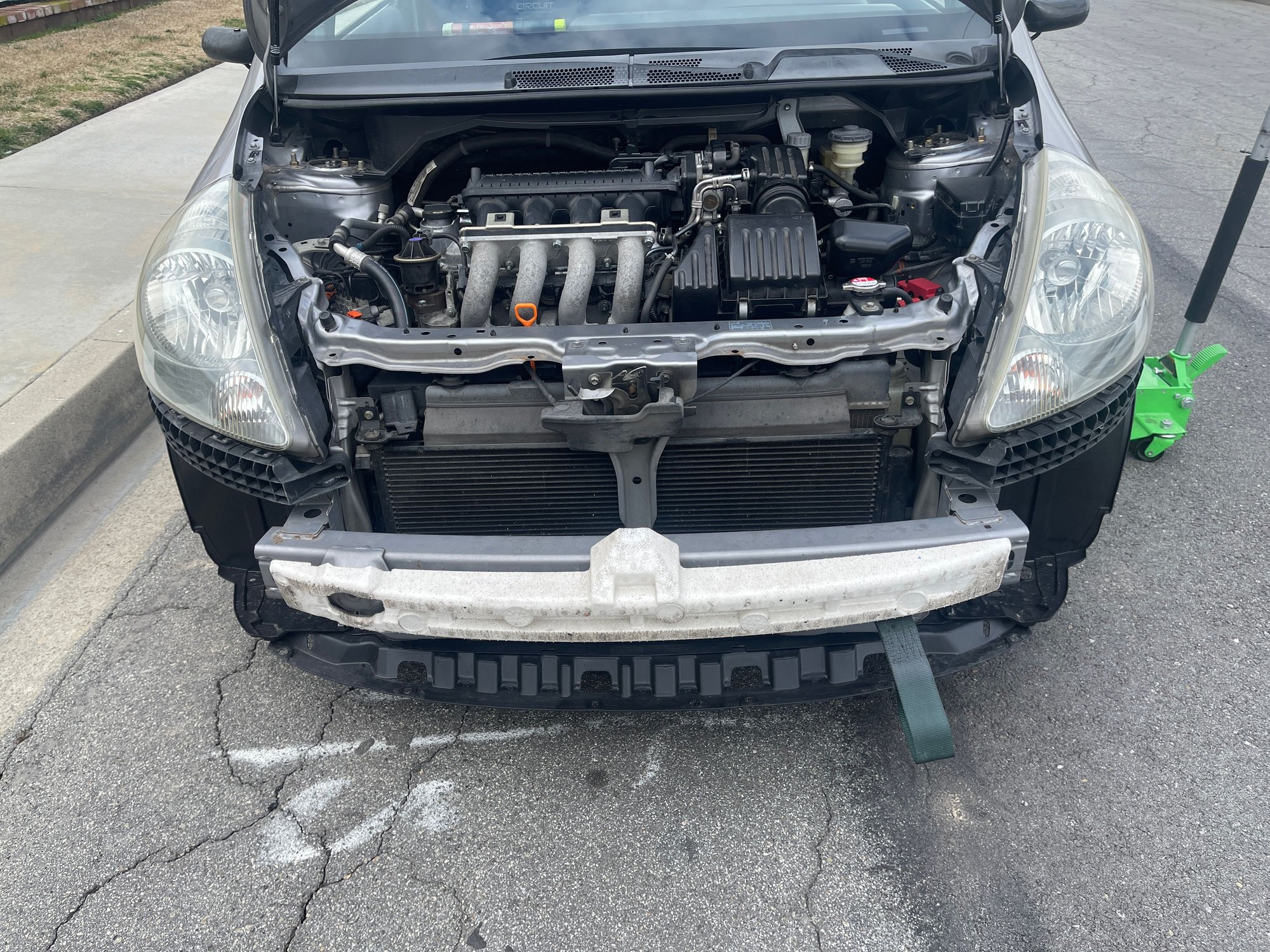

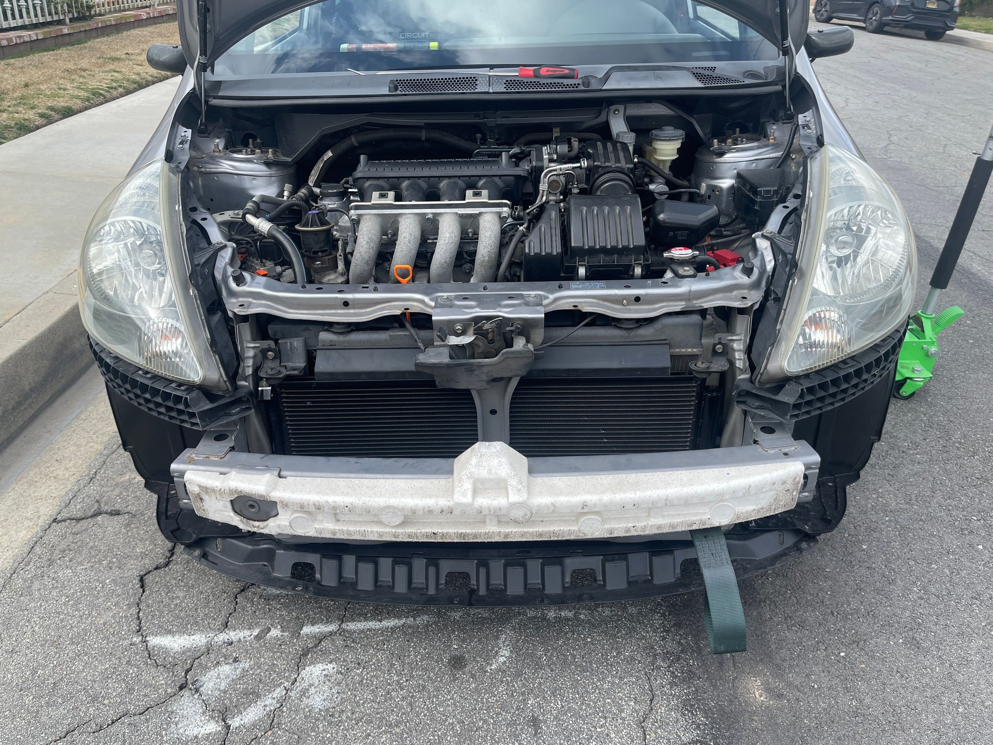

A/C condenser needed to be replaced after discovering a puncture; at least the process was easy.
Here's a photo after I had removed the bumper and before the condenser was removed:

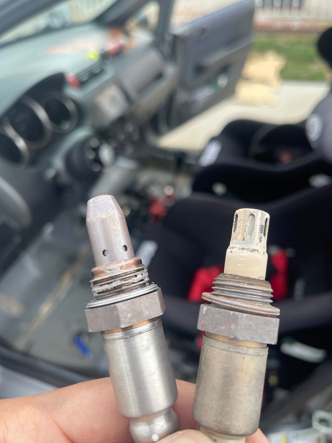

I also replaced the MAP sensor and primary/secondary O2 sensors. Replacement NTK sensor on the left and original sensor on the right.

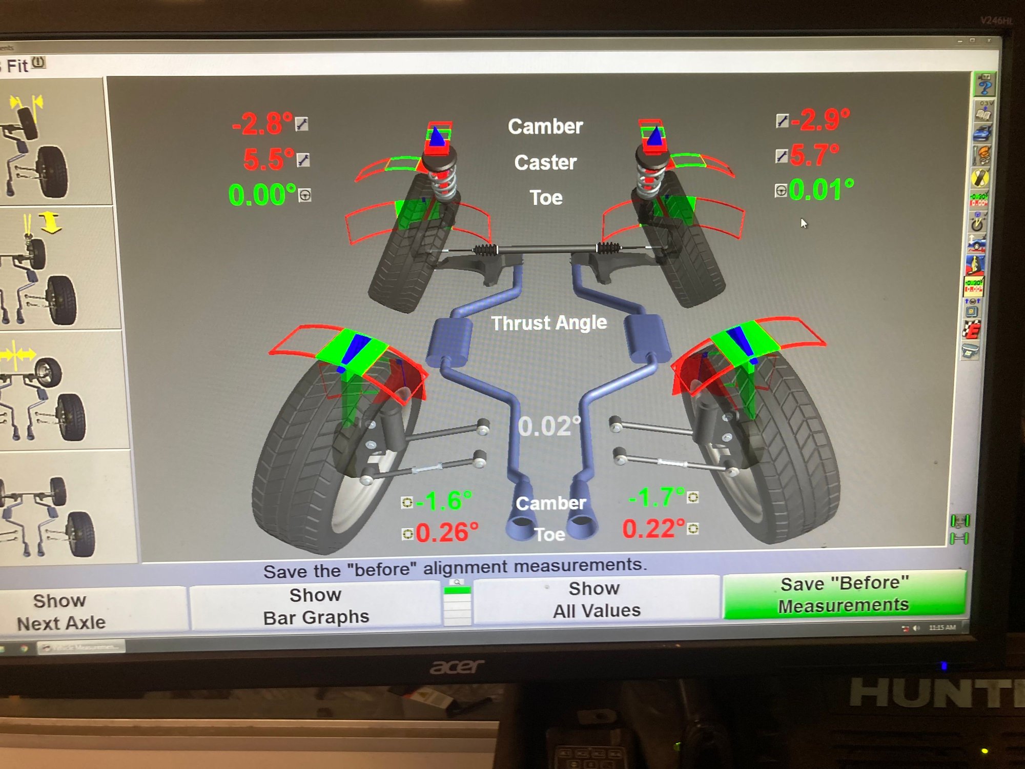

Aligned by Robert/Chewerks and ready for her first track day of 2023, this Sunday, 3/26.

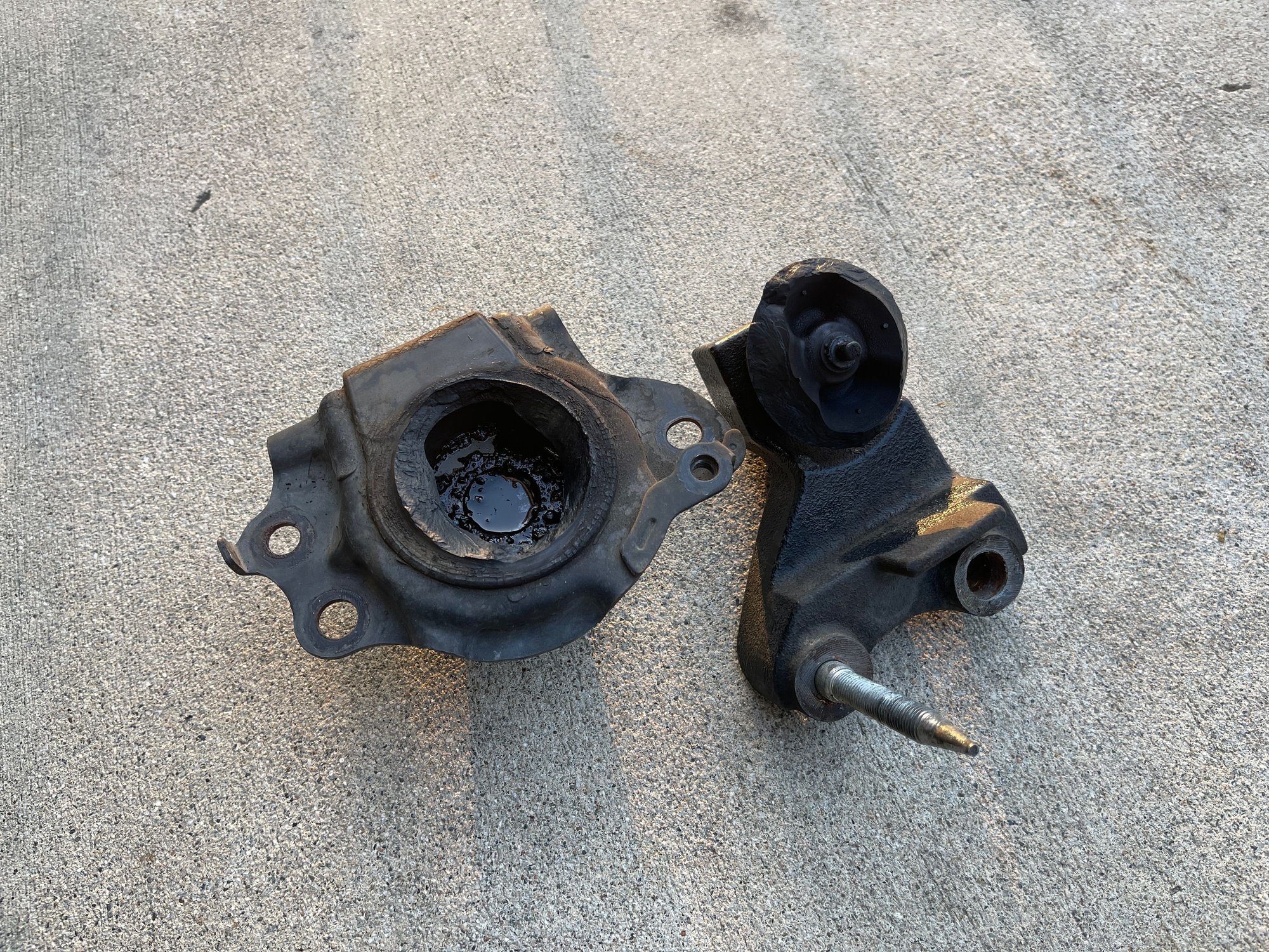

My mounts from Cheddas Auto also arrived. I replaced the engine oil, PCV valve, and ran out of time after replacing the transmission mount.
My impressions on the transmission mount, only, after ~50 miles:
- Obvious increase in NVH—don't buy these mounts expecting them to be OEM replacements in that regard—though, I imagine most, if not all, people buying these mounts will understand
- Fitment is good. I didn't really have any issues here. I struggled to keep the bushing spacers on and install the transmission mount bracket over it, even with a second person helping. I spoke to Cheddas Auto about this and decided to slot my bushings to make for easier install over the bushing. This might not be necessary for your install, but it's an alternative solution if the mount bracket gives you trouble.
- Throttle response from just the transmission mount being swapped out alone is very noticeable. I had an OEM Honda mount in the car that was a year old before swapping to the Cheddas Auto mount (so it's not like I went from original mounts with hundreds of thousands of miles on them). The "lag" between shifting gears has been noticeably reduced. I'm able to shift, comfortably, at my pace without having to account for the delay from the stock mount.
- The car is putting more power down to the ground. I actually got the car to spin the wheels in second gear which has never happened before.
Also, I have my muffler off at the moment (removed to paint it and decided to leave it off for the upcoming track day this weekend). The mount makes the car sound rowdier and brings in some of the transmission noises into the cabin, which is something I personally enjoy.
Overall, I am very happy with just this one mount. I ran out of time yesterday to install the engine mount, but I'm hoping to get that one on before this Sunday. I might attempt the rear mount as well, but, from my understanding, it is rather difficult to replace without lowering of the subframe and I don't want to mess with my alignment settings since I just had the car aligned.
