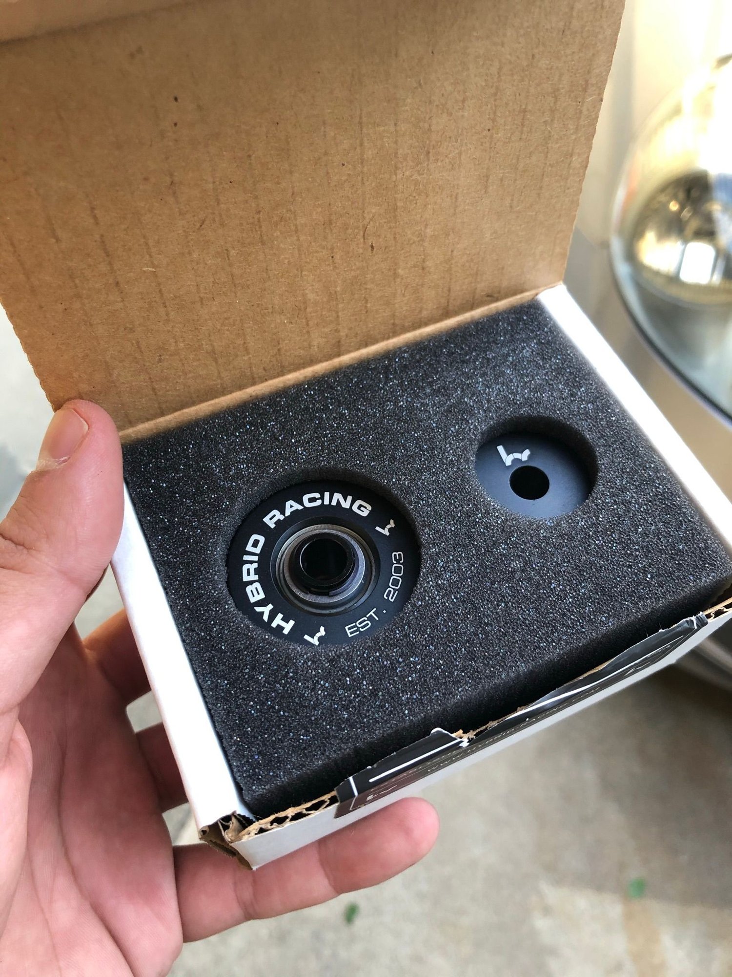

Hybrid Racing shifter cable bushings and short shifter were a no-brainer. Amazing products, especially the short shifter.

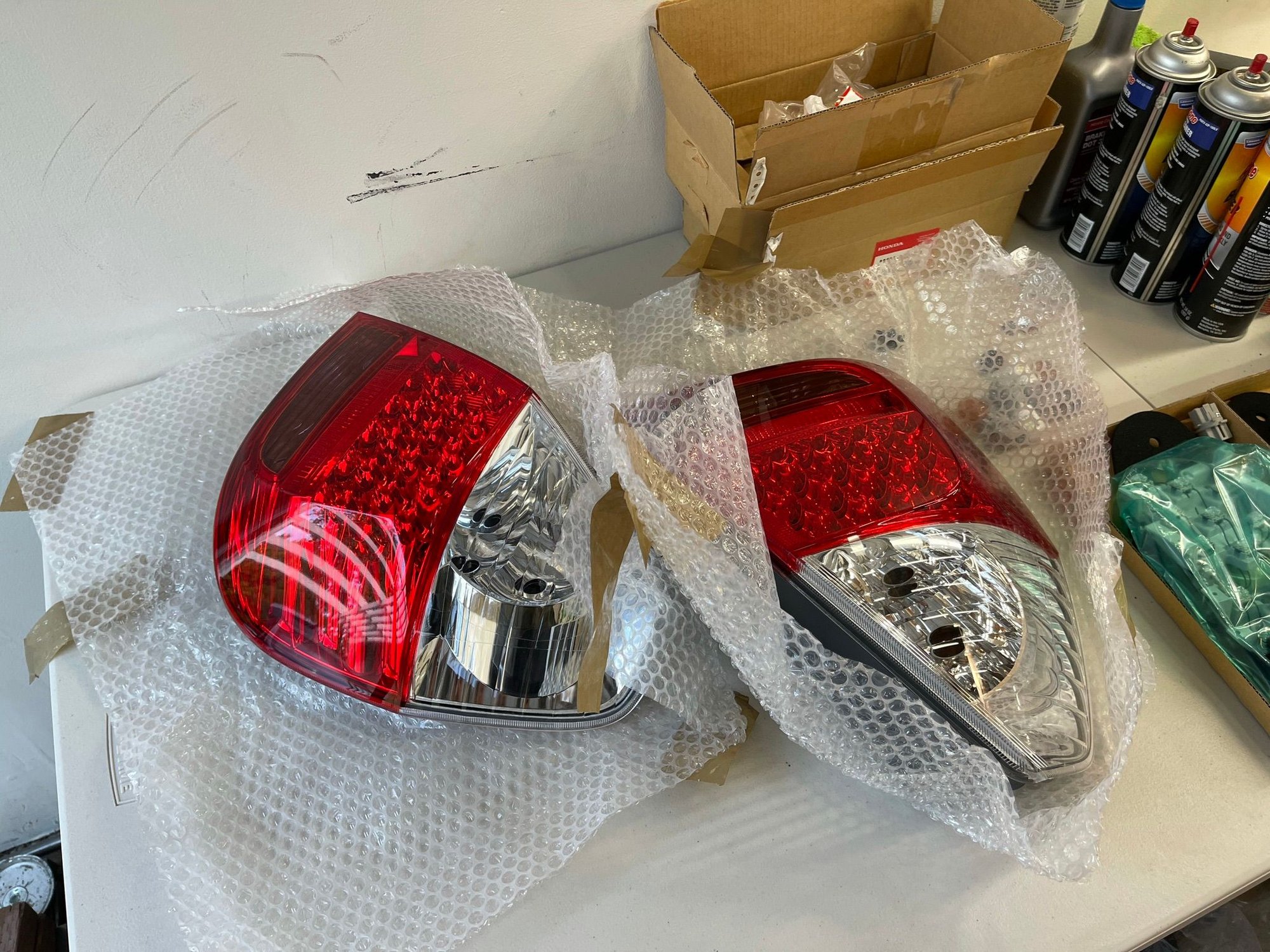

I also purchased some OEM JDM taillights as my driver-side taillight has a crack.

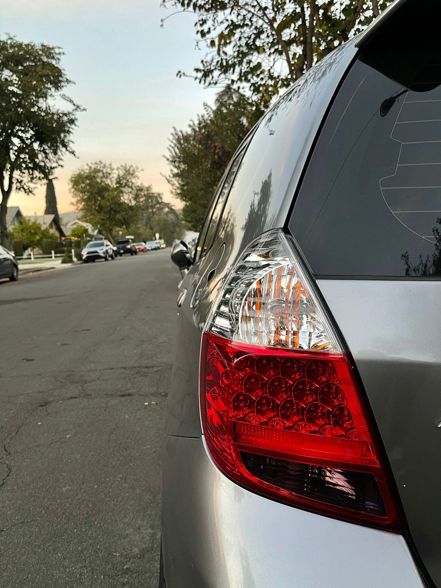

New OEM JDM taillights are on and coated with Jescar Power Lock.

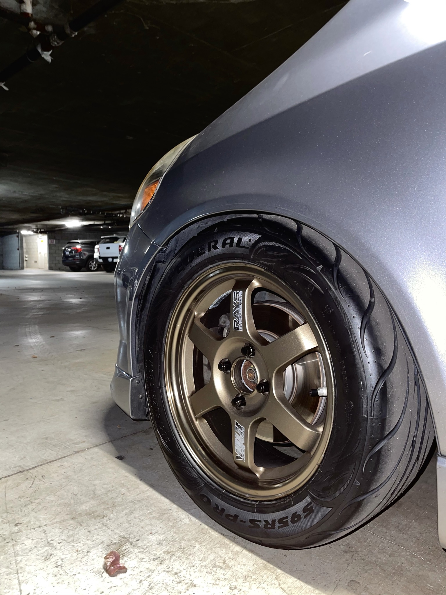

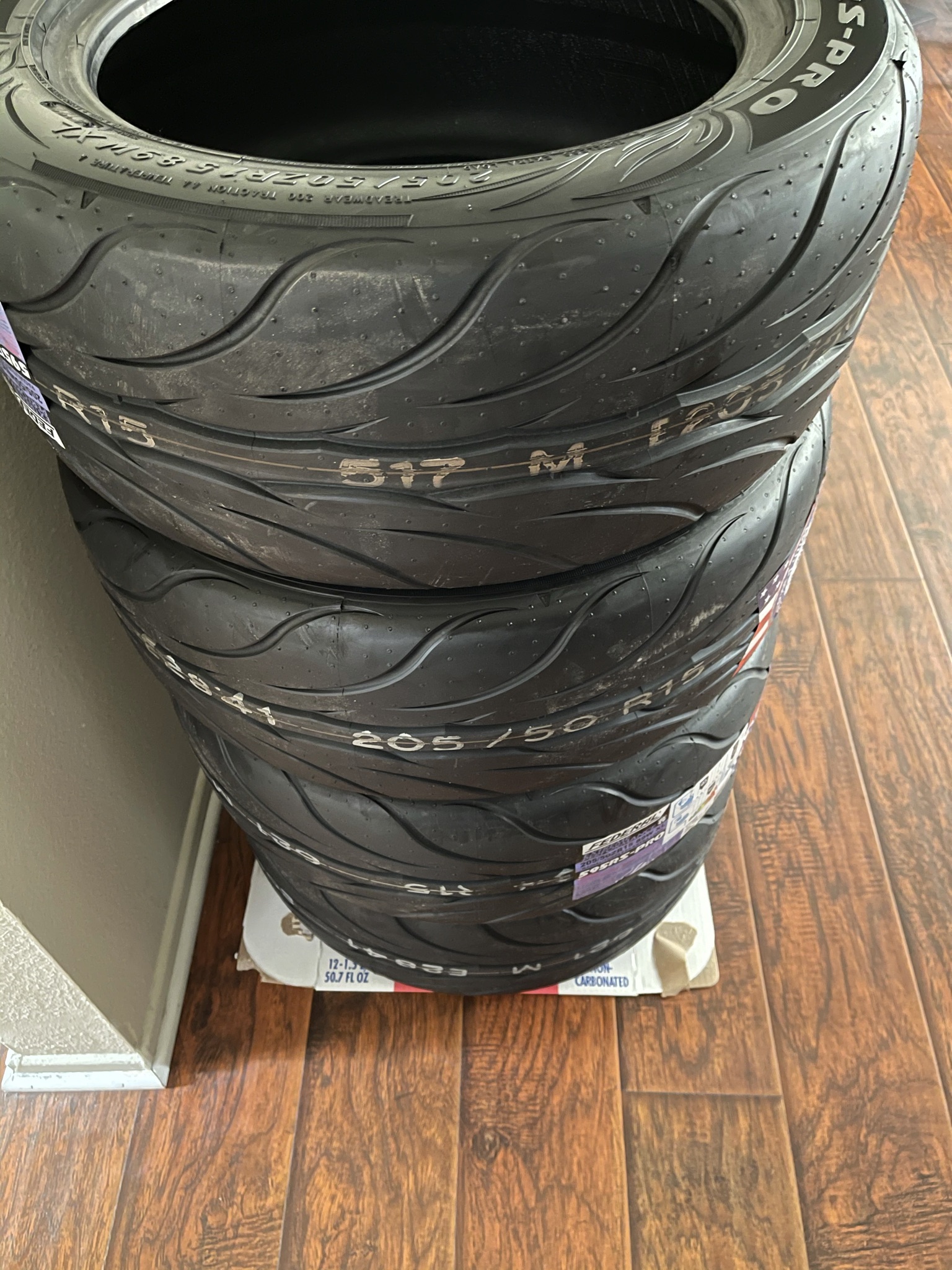

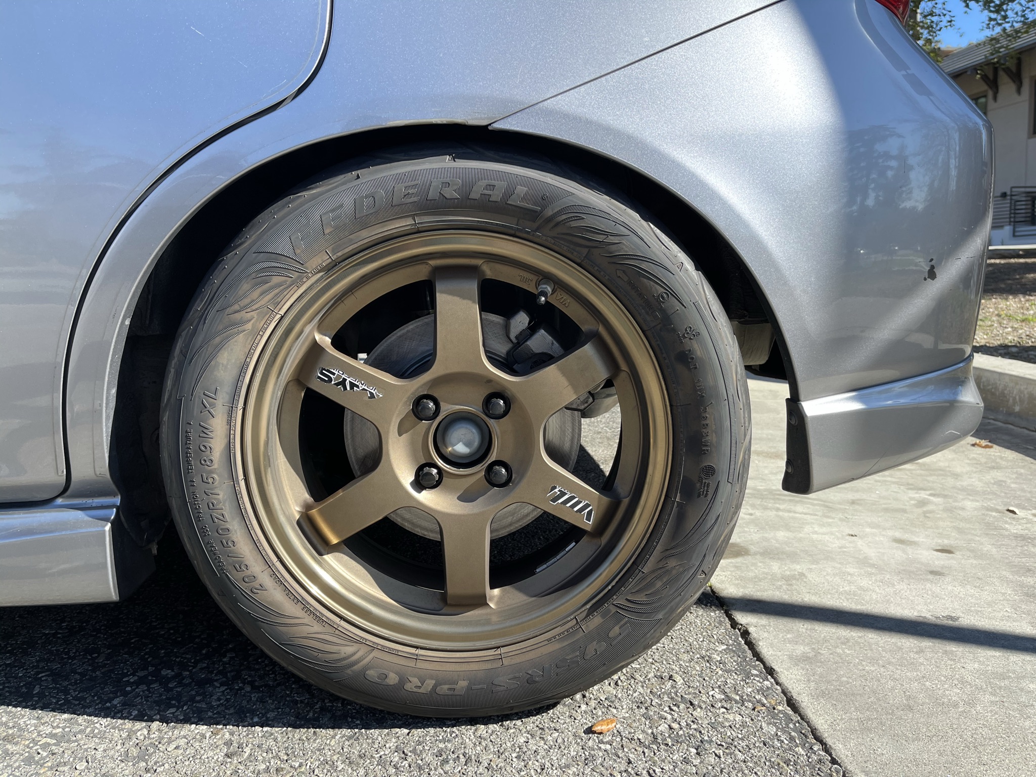

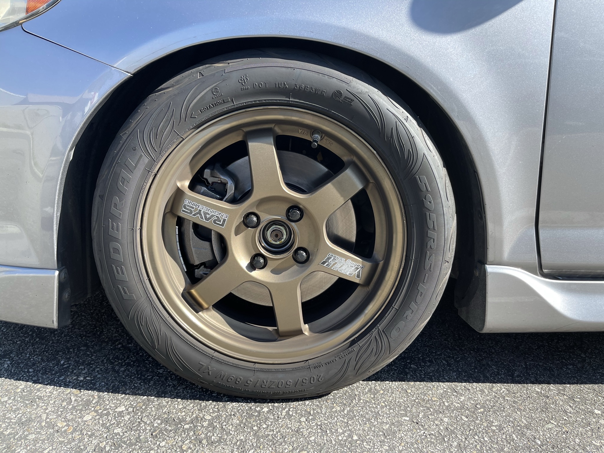

Since my last post, I've made some progress on the car. I still have a few things in the works before my upcoming track day, but enjoy these updates in the meantime.
We'll see how these tires perform on March 6.

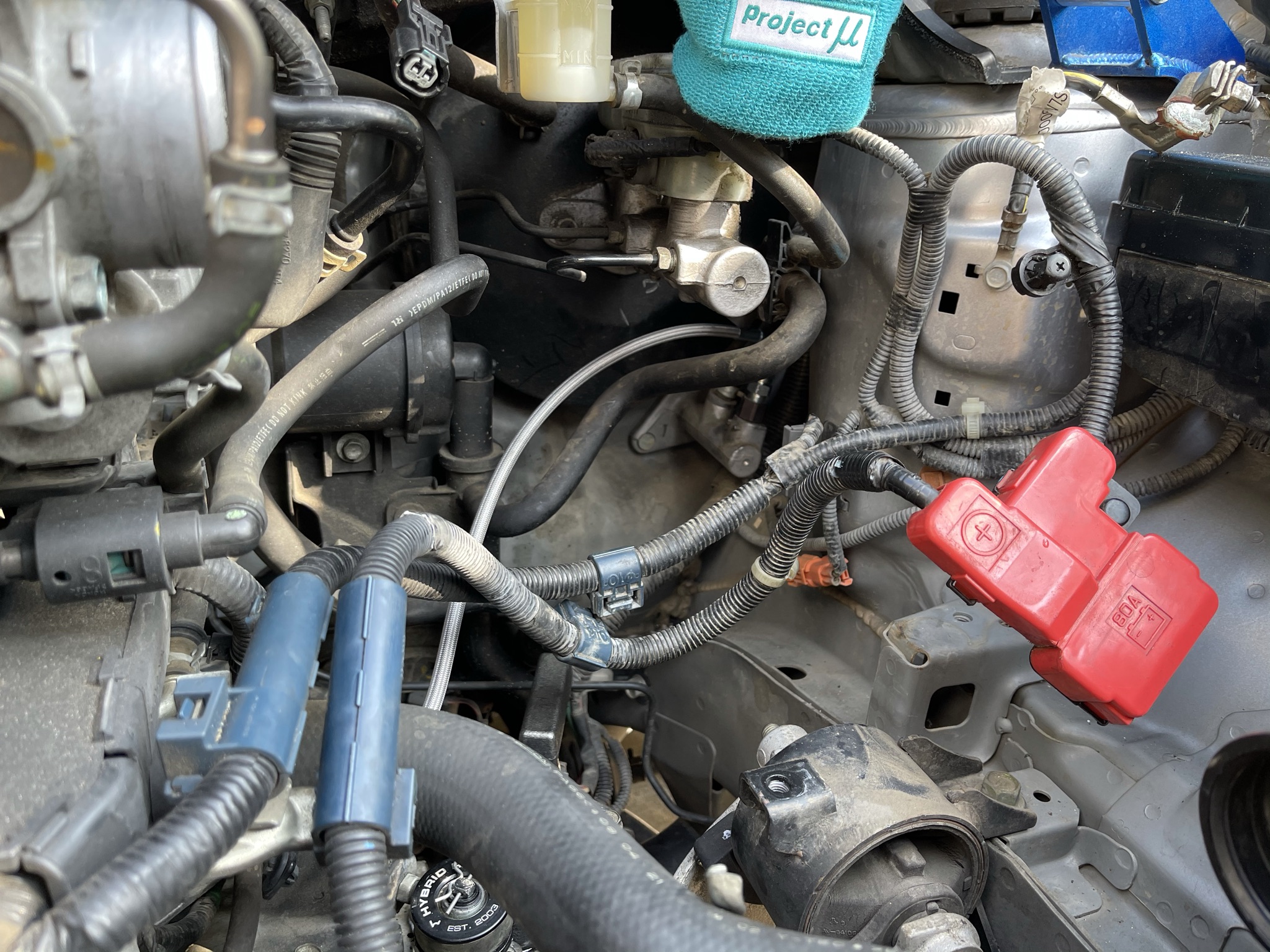

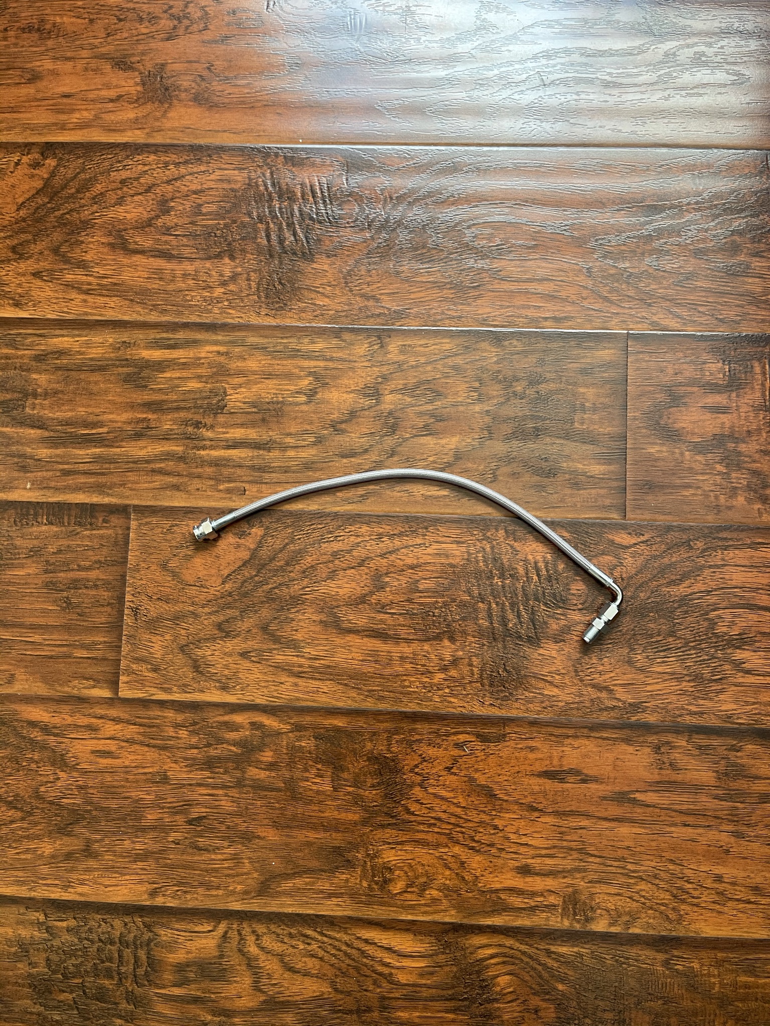

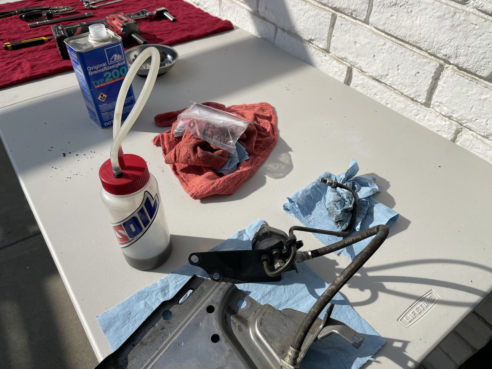

Piecing together information I found online, I had Techna-Fit build me a clutch line that also deletes the CDV.

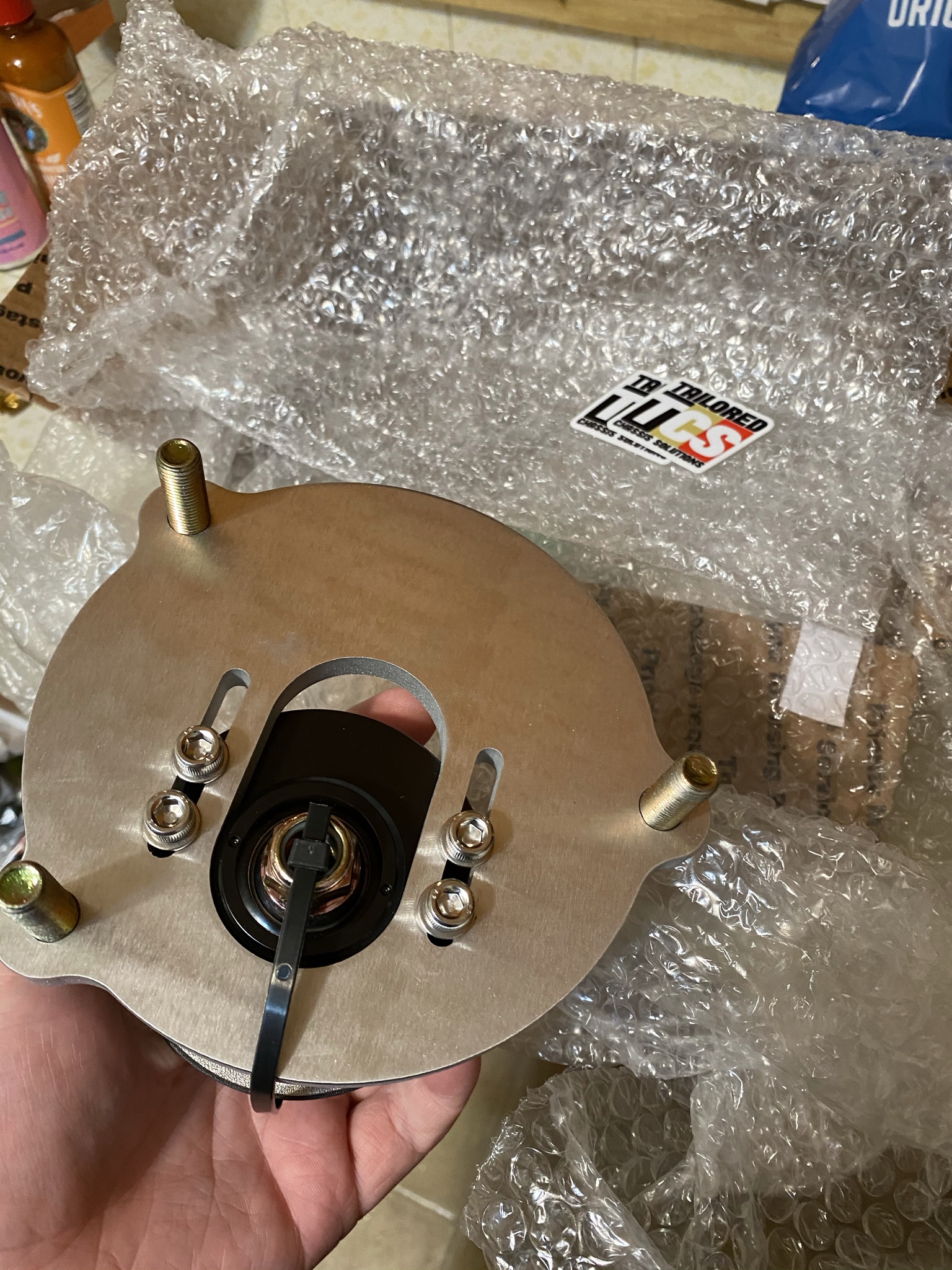

Ever since discovering the TCS top hats, I knew I wanted them. When Seamus restocked, I jumped on the opportunity to purchase a pair before it was too late.

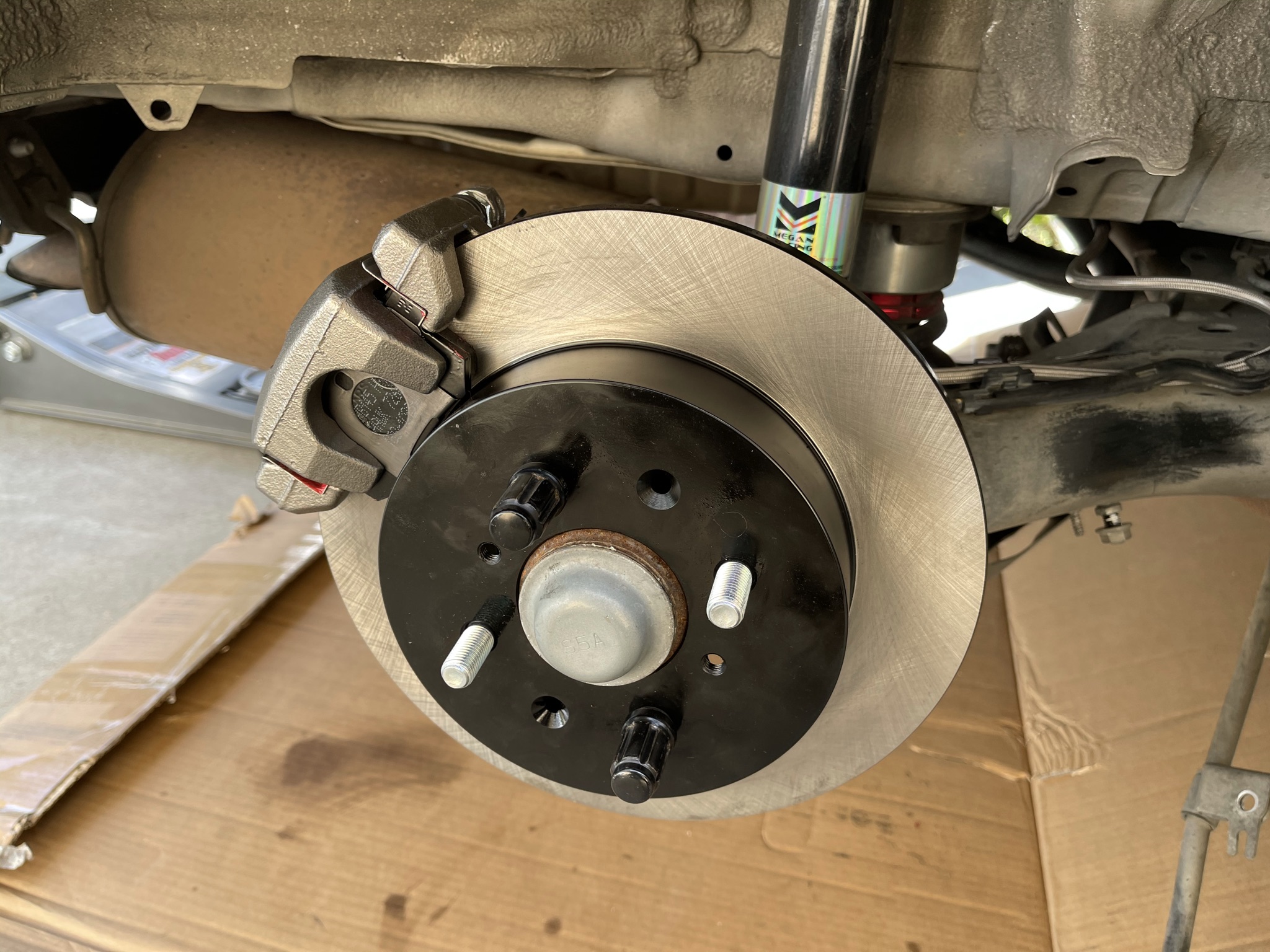

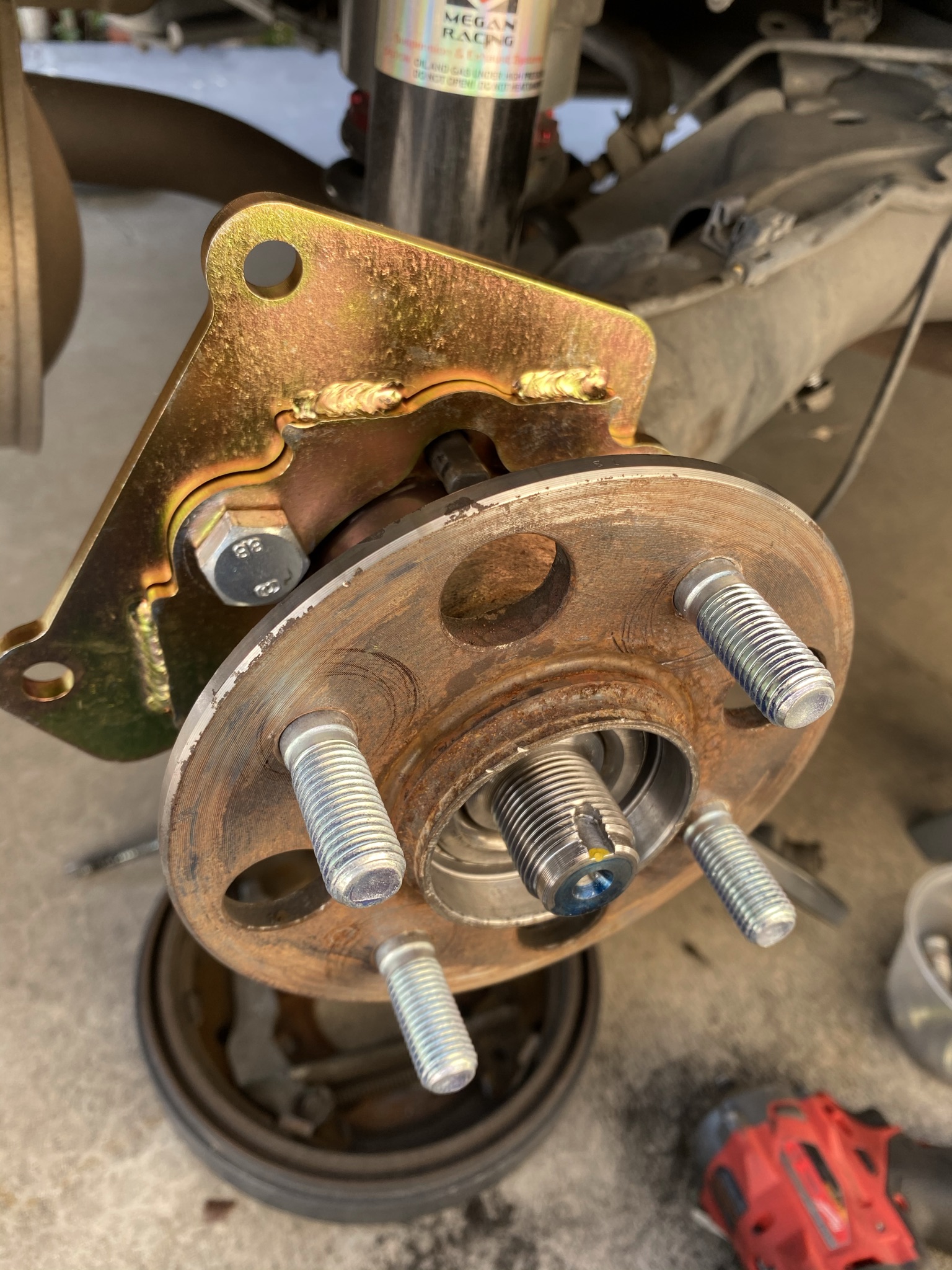

We converted the rear drum brakes to a disc setup utilizing EP3 Civic components and also replaced the wheel studs with new OEM stuff.
Here's a photo of the completed rear disc conversion. During the install, we discovered that the Scarebird rear disc conversion brackets are not the correct thickness which results in the brake rotors not sitting centered within the brake calipers. Conveniently, Scarebird offers a disc spacer that will center the rotors. You could also mill your caliper brackets or rear disc conversion brackets, but for $20 shipped, I went with the disc spacers.

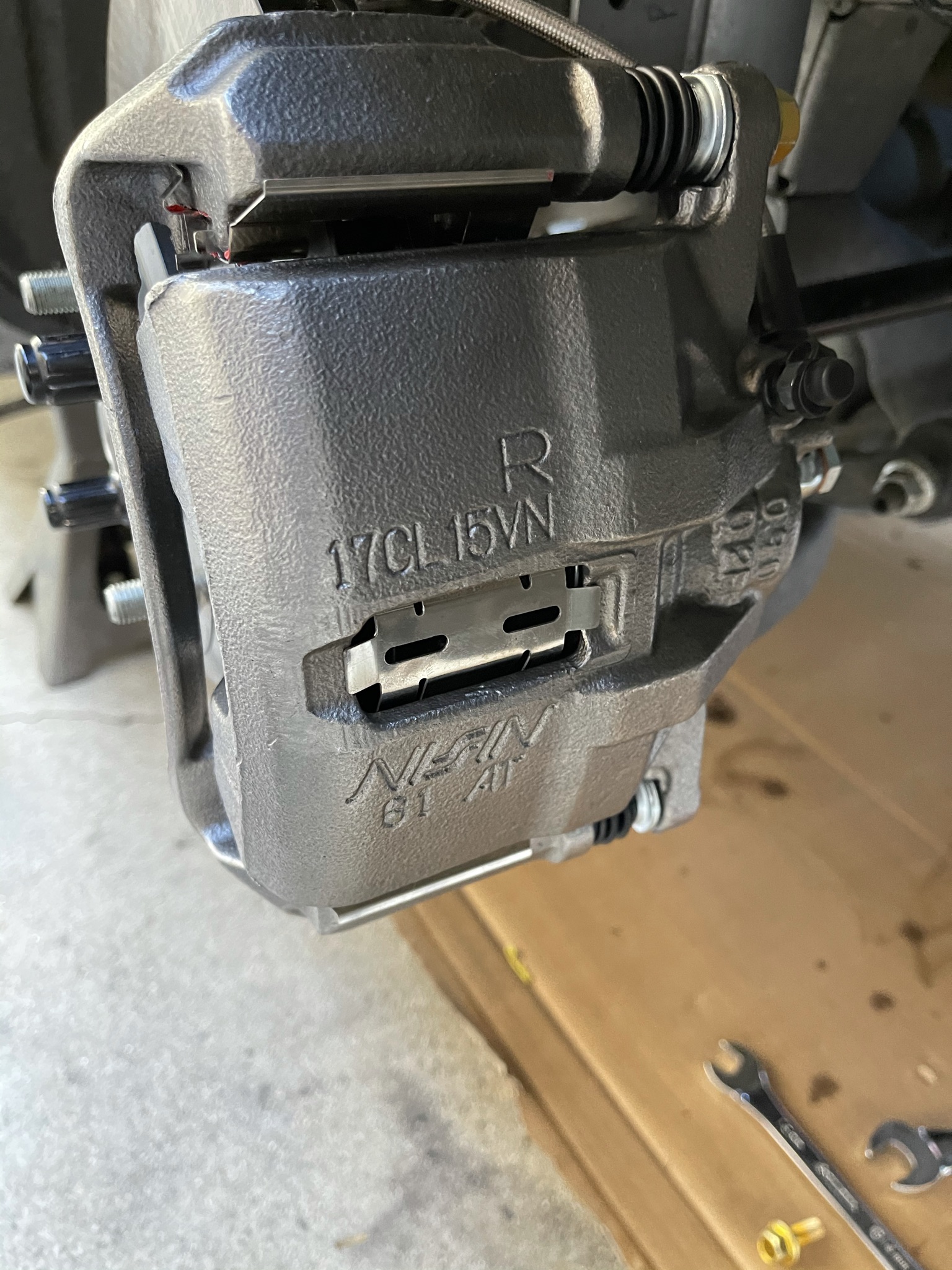

I'm a big fan of the ITR/Mini BBK for several reasons: cost, availability of parts, ease of installation, and increased thermal capacity. We ended up removing the anti-rattle spring clips from both front calipers because they were contacting the brake rotors. A larger brake master cylinder and Fastbrakes front/rear brake lines were also installed during this time.
Photo of the completed front brake upgrade:
Photo of the completed rear disc conversion:

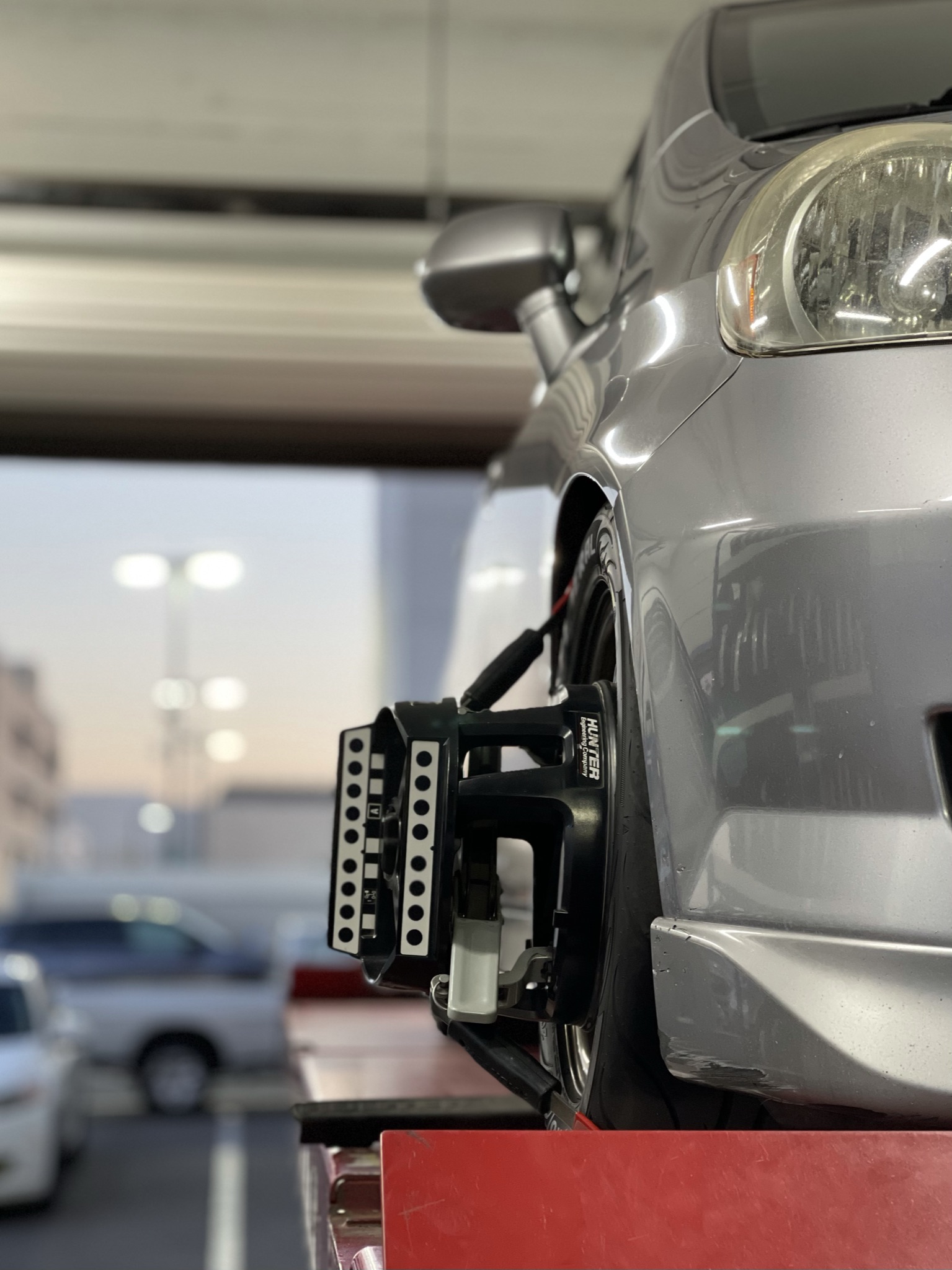

Because we installed new wheel bearings and hubs, Phoebe got an alignment to make sure everything was dialed in.
