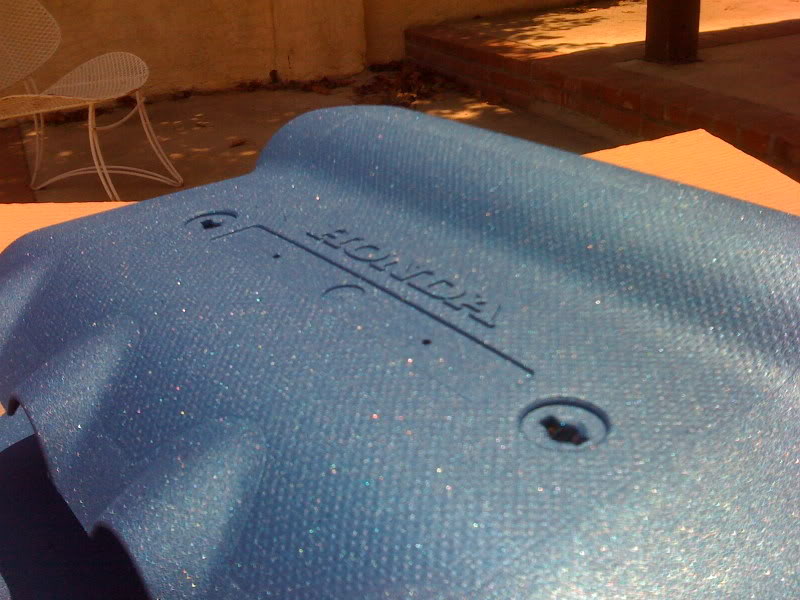

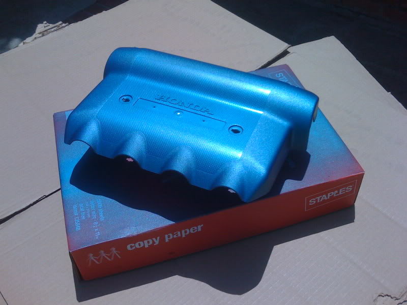

thtis thread made me envious, so i went home during lunch and did some work...
we have an 07 VBP Sport...
duplicolor metallic blue (base)

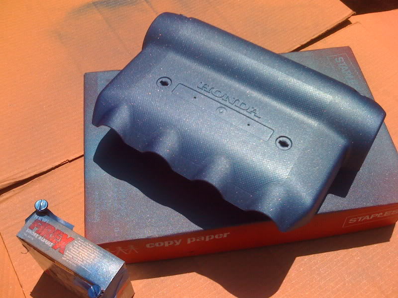

duplicolor metal specks ocean blue (top coat)

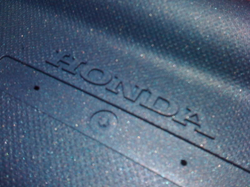

it started to get a little too dark, so i hit it with some more metallic blue:
finished product (with a few coats of clear):

^^^ Not bad. Looks like you put a lot of work into it.
Old Jul 17, 2008 | 06:43 PM
  #412
Lex_Dymndz's Avatar
Posts: 1,835
From: OC, CA
yup. thanks.
started the prep work last night (removal/ spray w/ brake cleaner/ 3M red scuffing pad). did the adhesion promoter (3 coats) and metallic blue (3 coats) this morning after the gym/ before work. finished up on my lunch break with a few light coats of the metal speck ocean blue and metallic blue. followed by clear (3 coats). then reinstalled the emblem. will put it back on the car as soon as she gets home with the fit. (its hers)
its not as smooth as i would like. but it will do. its under the hood afterall.

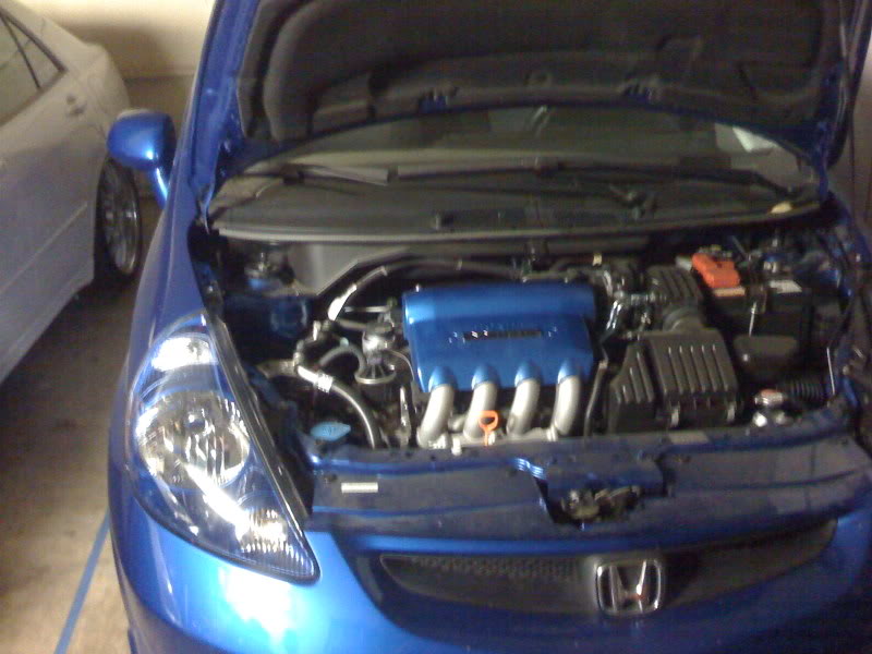

edit:
installed it last night
its pretty close to VBP
