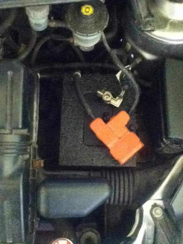

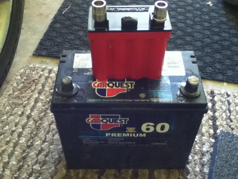

Ballistic Evo2 8 cell 2 lb battery

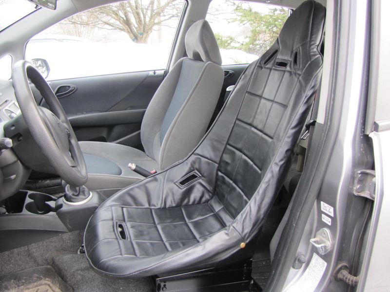

RCI poly seats with custom brackets

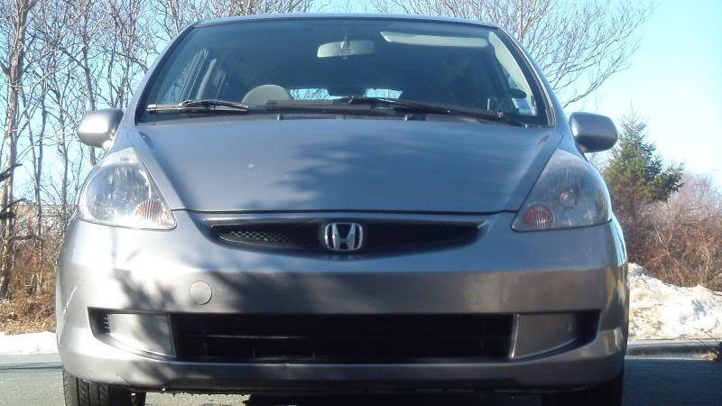

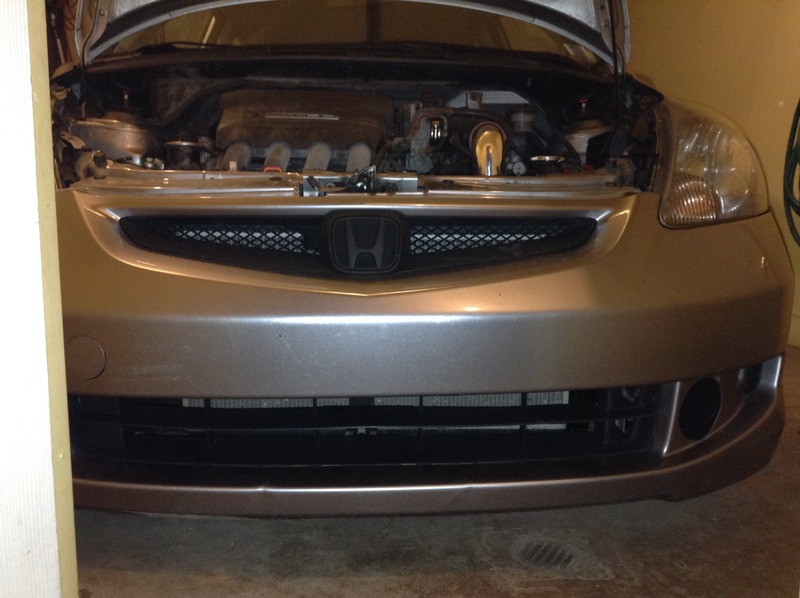

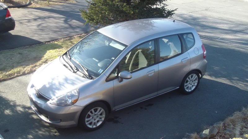

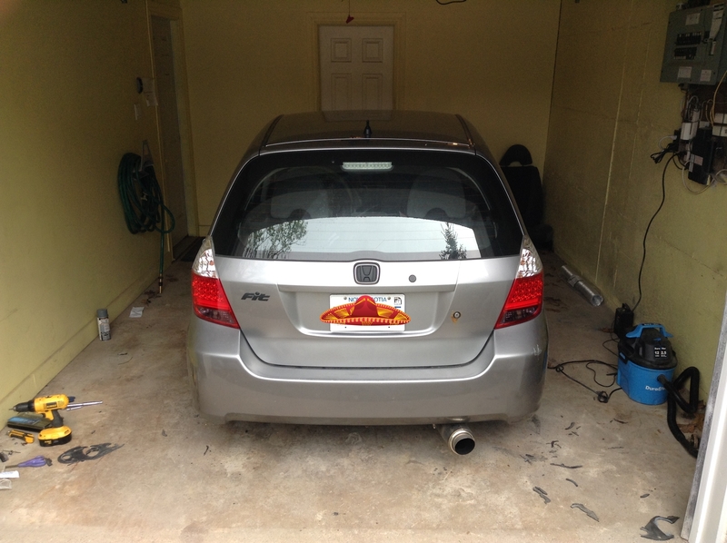

Here it is when I got it in december of 2014.
I paid $3200-ish CAD. It had 250,000 kms, was parked in a snow bank, full of dog hair/stink, had rust repaired and repainted the wrong color, leaked in the trunk and 3 doors and had an automatic ECU. I assume water somehow got to the ECU and the owner accidentally bought an auto ECU. Needless to say it had CELs for the O2 sensor and a few other things. Most were fixed by putting in a manual ECU and replacing the O2 sensor. All leaks were painstakingly fixed and I weighed most interior pieces in the process.

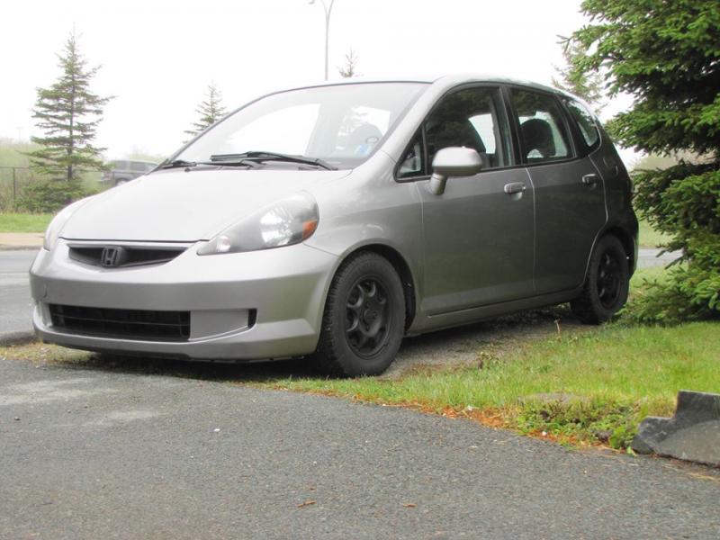

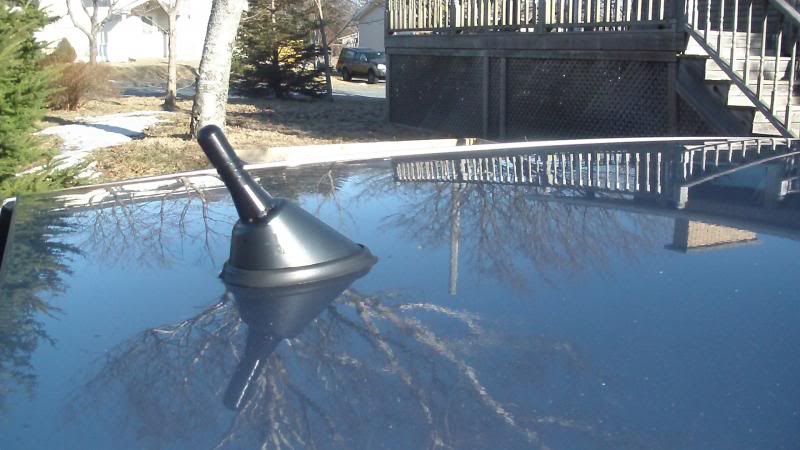

My first modification? A super stubby 1.5" antenna!

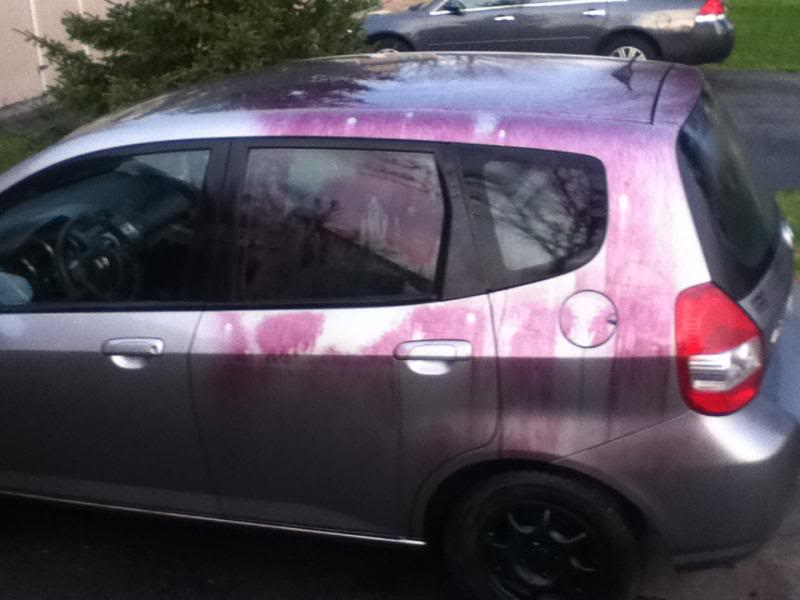

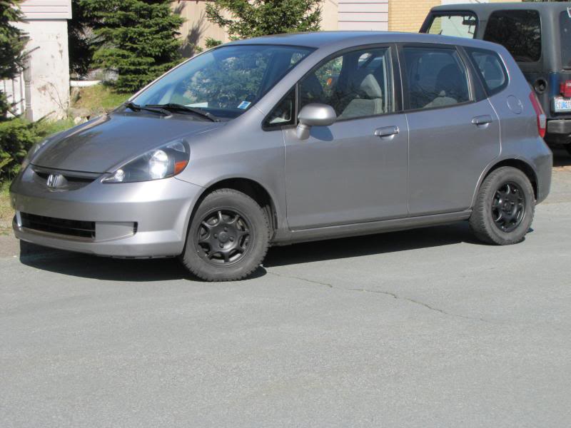

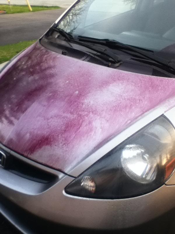

Sometime after that I got a set of VX wheels, repainted them flat black and proceeded to spend way too much time grinding down the stock front calipers to make them "Fit." It worked well enough. Yes, those are winter tires. Also painted the headlights and eventually the emblems and tailights and interior trims.

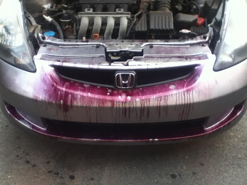

Little did I realize, all that steel dust embedded itself into my paint. Time for IronX!

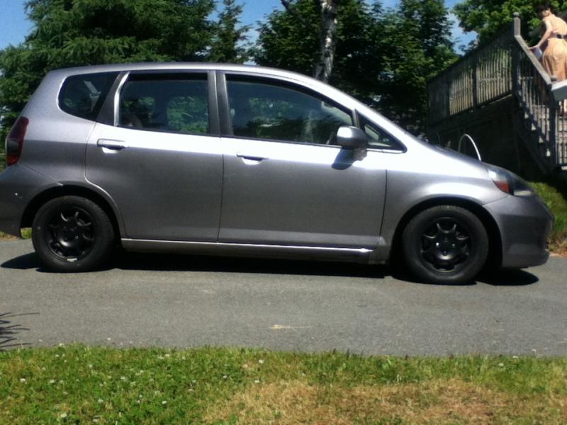

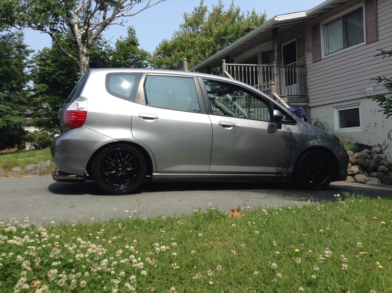

Next on the list was T1R S-coils and new tires. I wanted to try smaller diameter tires and went with 175/60r13s. This gave lots of noticeable low-end torque and the light weight (22 lbs total per corner) improved mileage.
T1R s-coils on winter tires 175/70r13

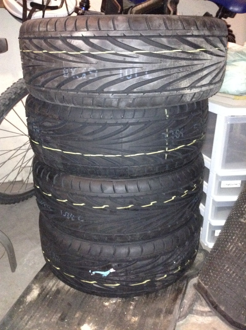

175/60r13 tires
The drawbacks to this size: Only R compound or All Seasons, more fender gap, lowered the car another 0.6"

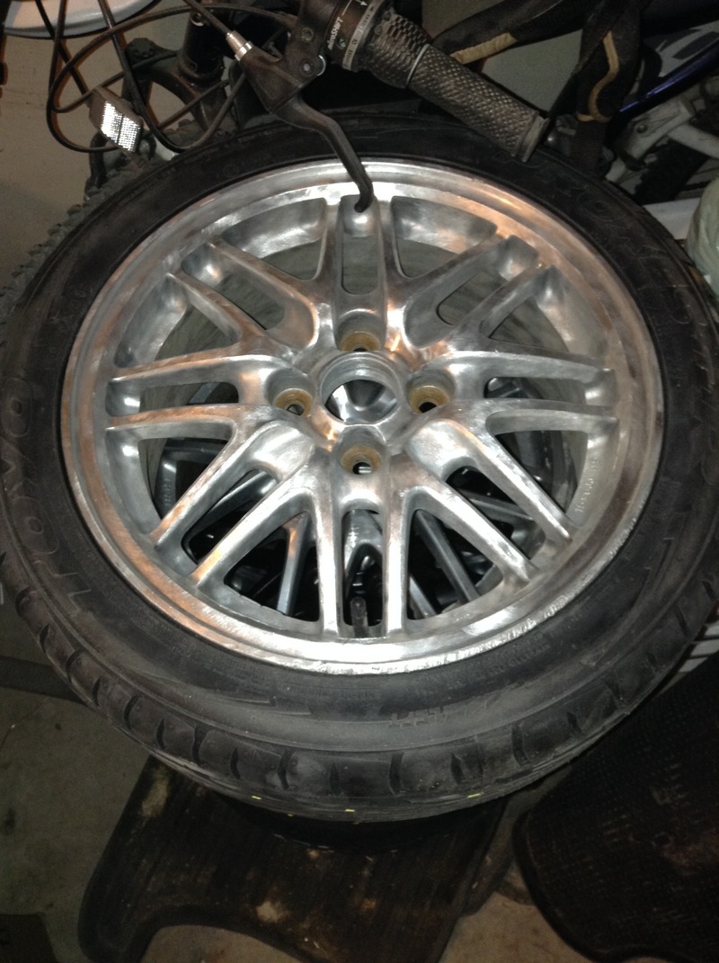

After being advised that my newly grinded brakes might not pass vehicle inspection, I decided to buy the Wilwood DPHA calipers (not installed yet). This needed 15" wheels so for now I am rockin Integra LS mesh wheels (which were sitting outside in someones yard, bought for $150) and new Toyo T1Rs in 195/45R15.
Here is after a few hours of sanding with a drill and brass brushes:
Tires waiting to go on
Installed, repainted gloss black, sorry not the clearest shots:

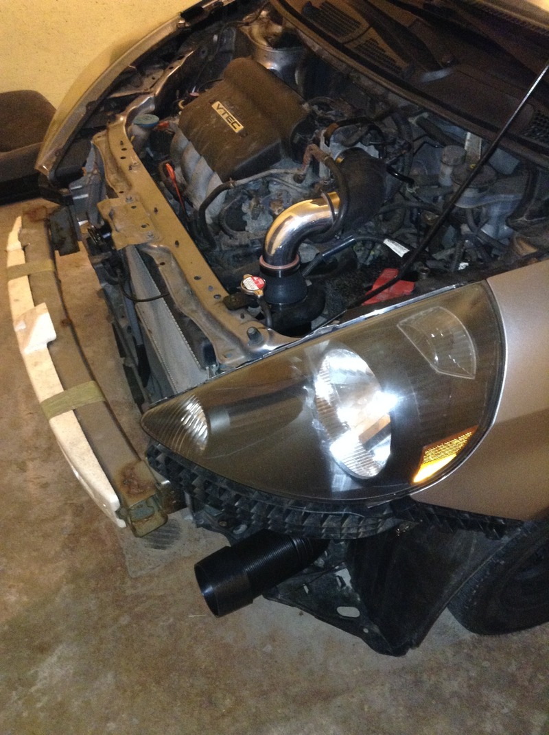

Decided to sell my eBay CAI, and bought a PRM intake to make my own ram air style intake. This is definitely function over form, not everyone's cup of tea but i like it.

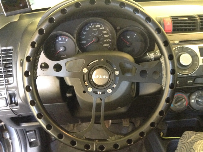

Next I wanted to reduce more weight so I found this gnarly wheel that weighs 0.9 lbs. Unfortunately it was 5 bolt or 3 bolt only, so I found a 0.5" adapter from Forever Sharp steering online. Magically, it also works with regular momo style horn buttons, joy. Again, more for function than form. The momo wheel I am replacing has such a great feel to it but alas, I need to lose that weight!

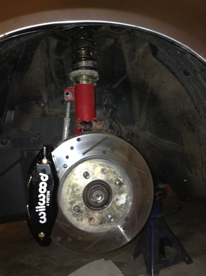

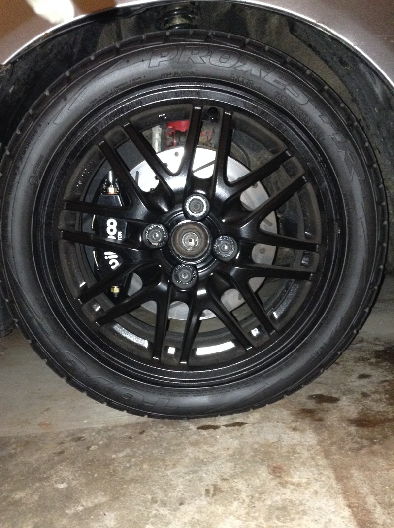

New from calipers on! Wilwood DPHA. First time doing this work, took about 3 hours including bleeding the brakes. Stops on a dime now!

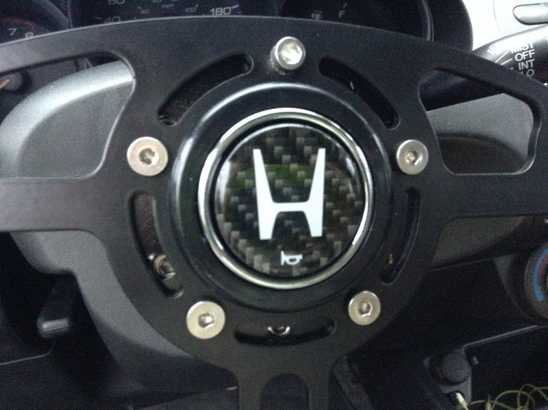

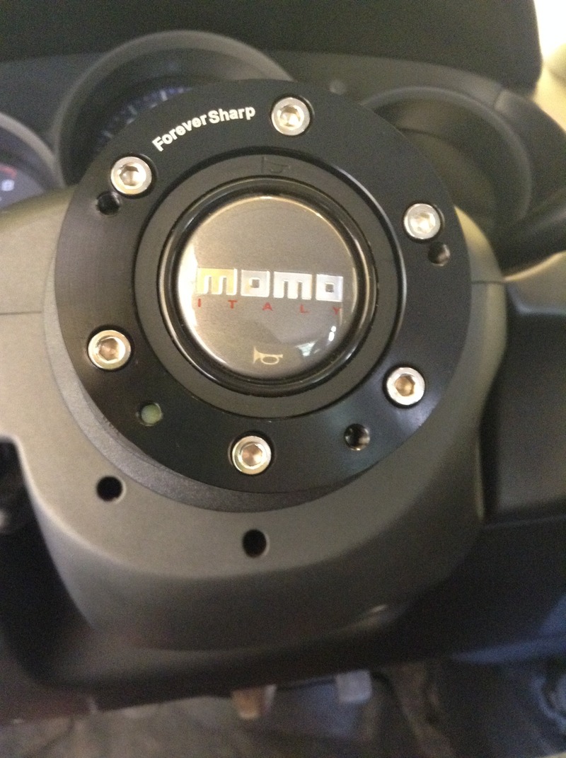

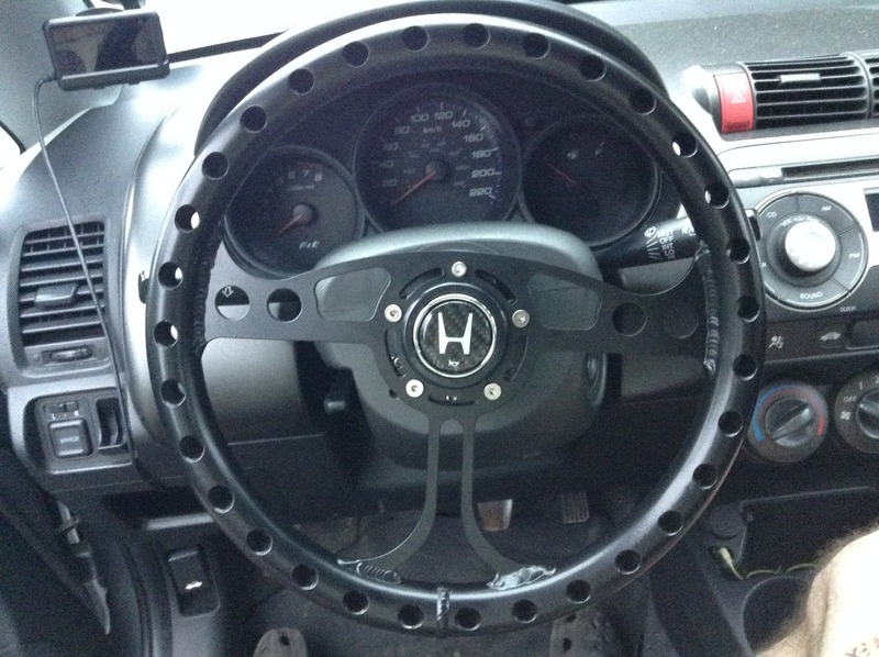

New NRG Carbon Fiber horn button. Had to install this a bit different than the MOMO one but it turned out looking better IMO.

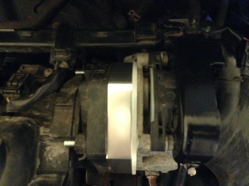

Torque Solutions Civic R18 throttle body spacer installed, needed to buy longer bolts than what came with the kit. Waiting for a working R18 throttle body to come in the mail.

That is a very interesting steering wheel. It would probably melt my hands here in FL.

I love the fab work of that steering wheel. If I was balls to the wall serious about weight reduction I would look into that.
Any thoughts on getting a cam to help open up the power band?

Yes I've drooled over those thoughts. We will see what time brings and how much money I'll have.
