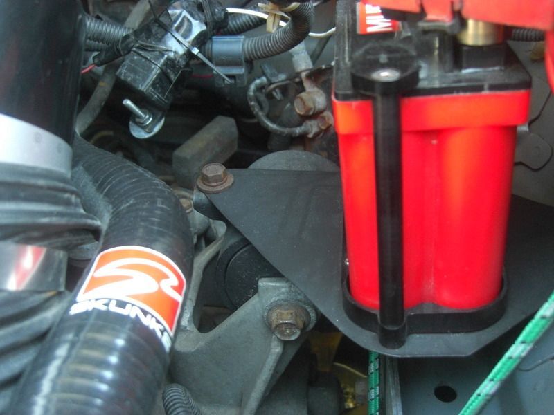

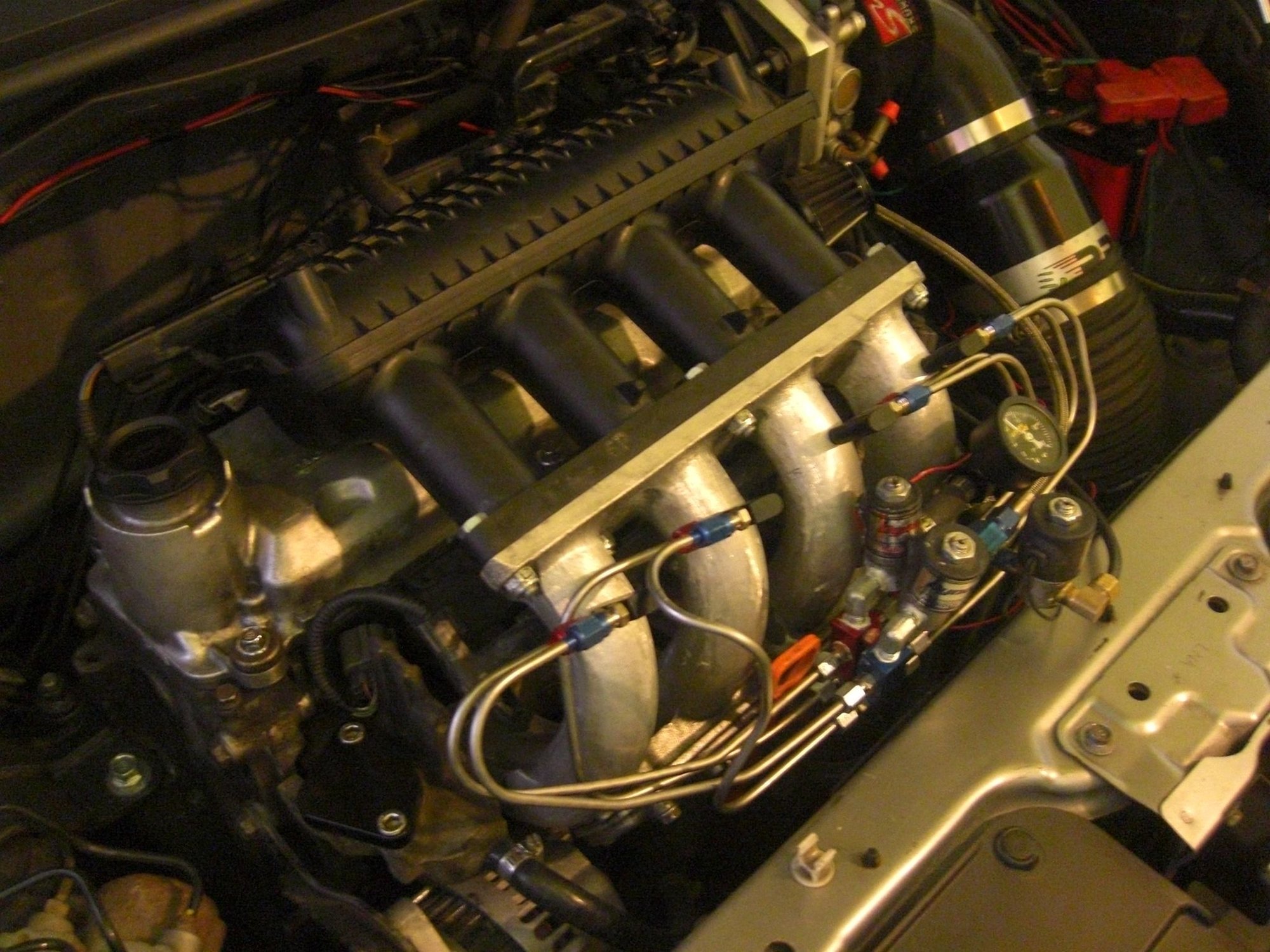

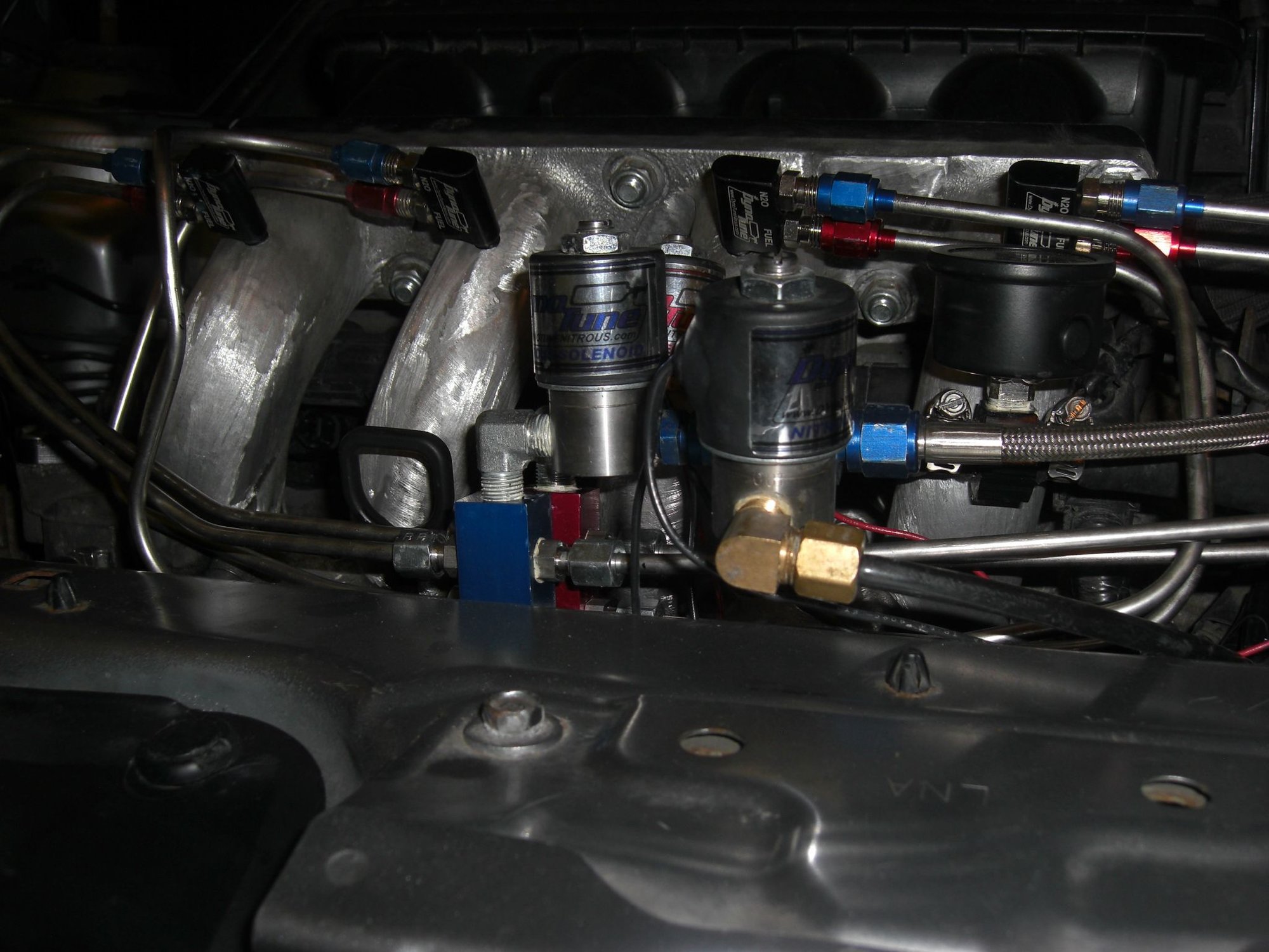

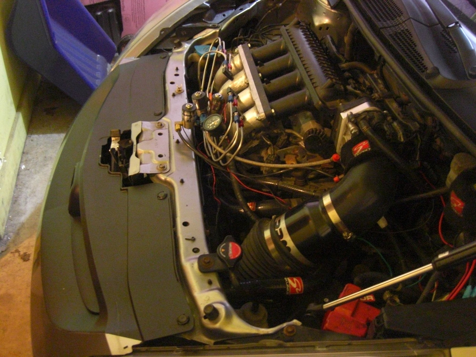

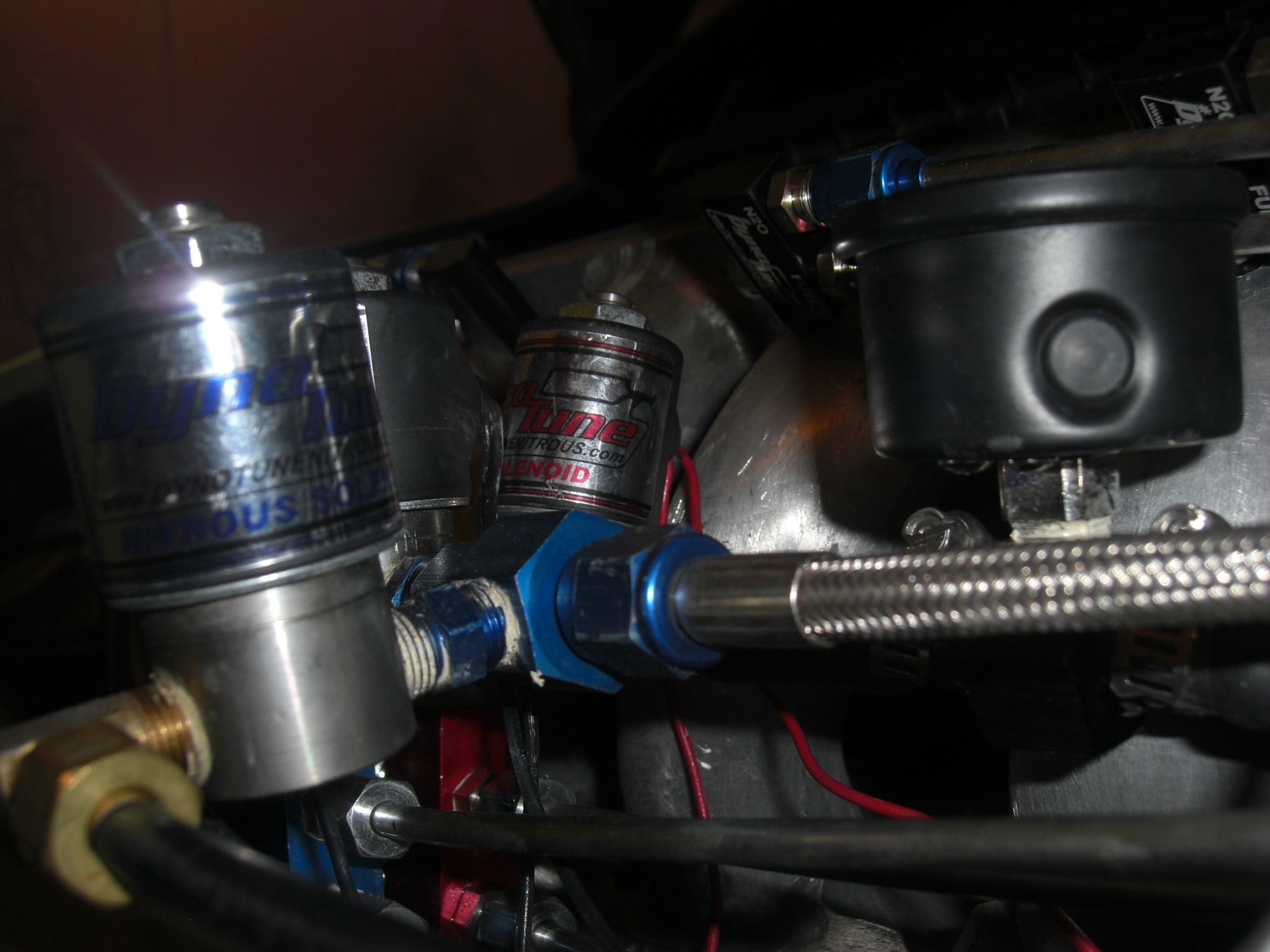

Relocated solenoids, installed mechanical fuel pressure gauge...only had to lengthen 1 wire...nope, no clearance issues!

Cleaned up some wiring, fixed a small fuel leak by the fuel pressure gauge, painted the dipstick and windshield washer reservoir cover flat black.

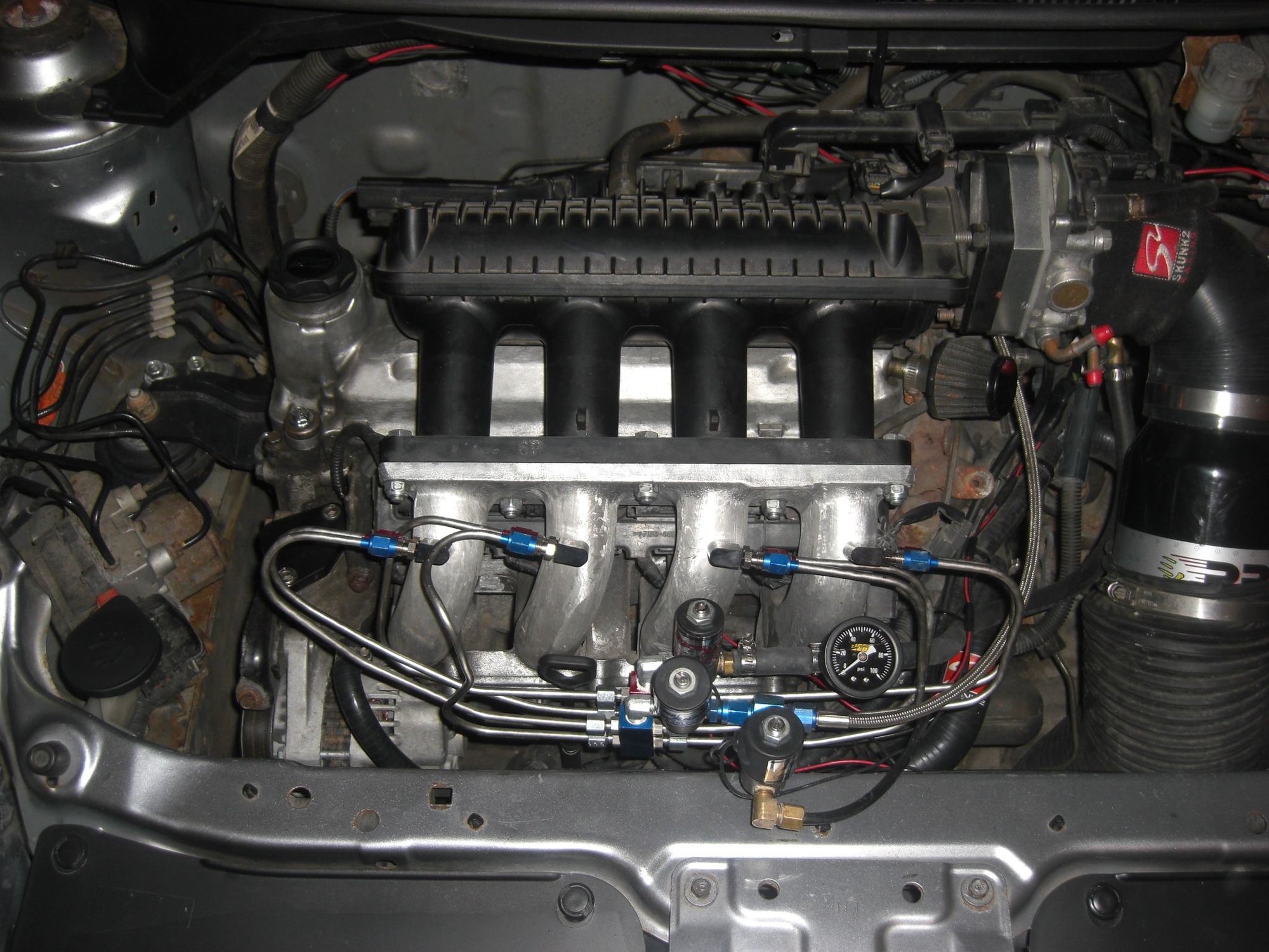

Evo X fuel pump installed! Fuel psi went from 51 to 55 psi. A little extra insurance when running a wet nitrous kit. Bottle should be filled TOMORROW!

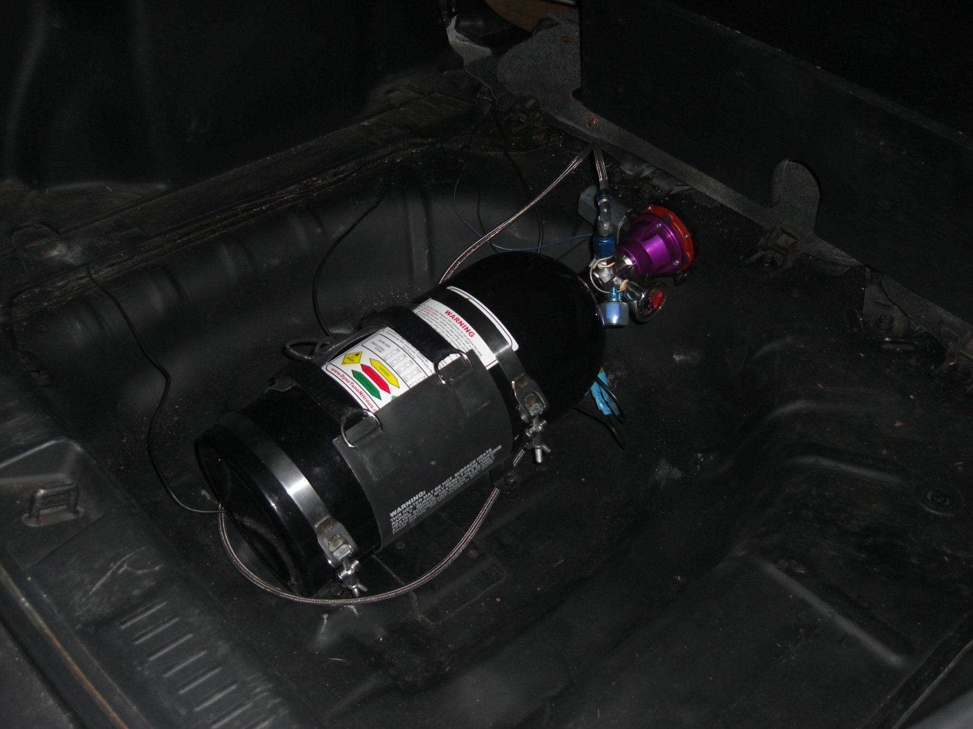

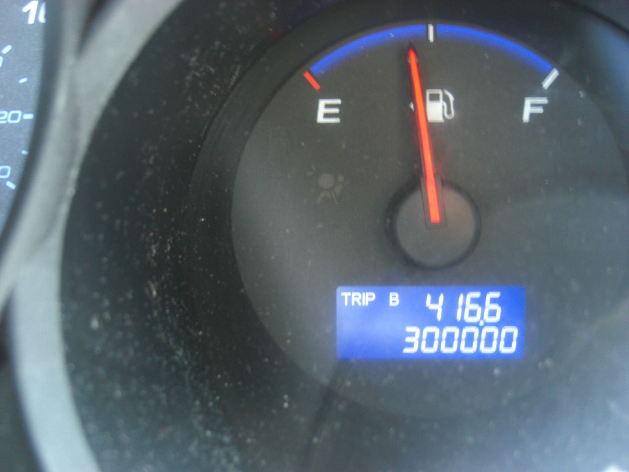

Passed the 300,000 km mark on a recent camping trip.

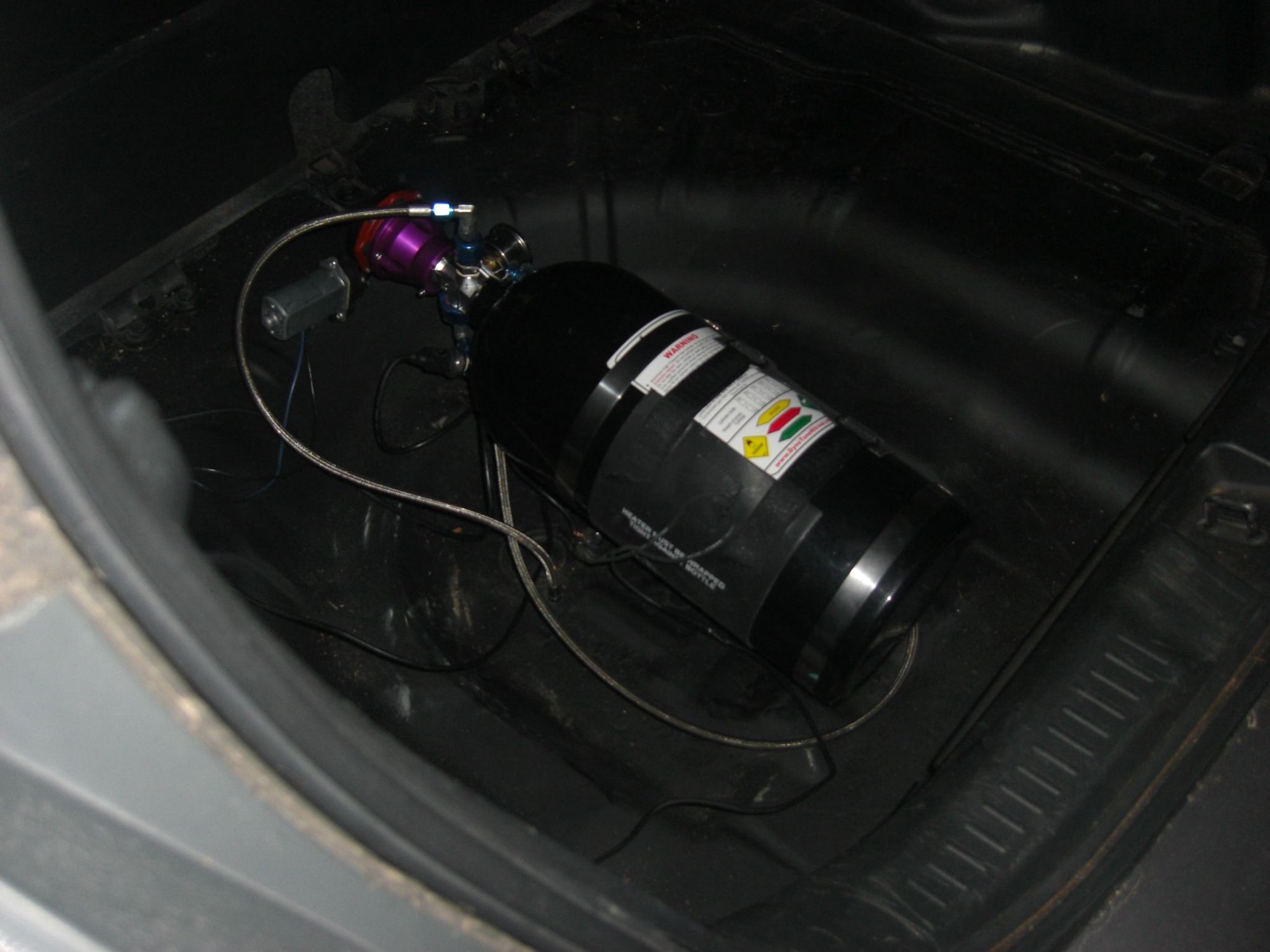

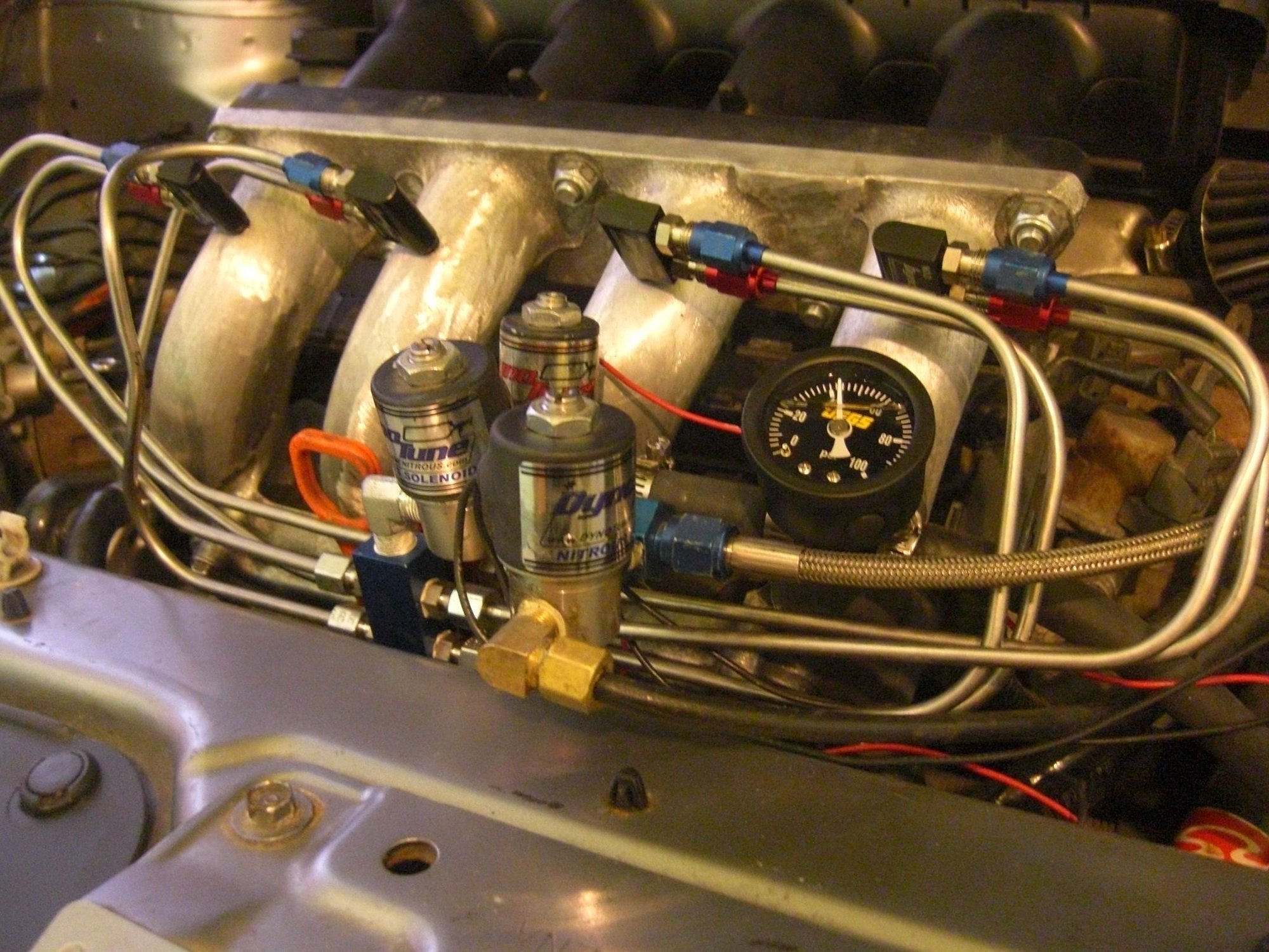

Some more pics of the nitrous bottle, direct port and the cover I made to make my trunk still useable:
