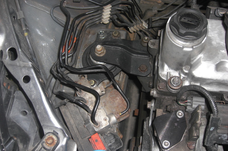

85A shakes yo sheeeot! One does acclimatize to it somewhat, however I wouldn't recommend it for daily driving. Some might like it, but most won't. So far the wife and kids are fine.....so far, lol.
Aesthetically speaking it really cleans up the passenger side engine bay, especially along side the blox EGR delete and A/C removal.
this is might be a bit late but I was wondering what kind of benefits you get from an EGR delete and what else would be required becides the block off plate

Benefits for performance are questionable. I did it for weight reduction and looks. The EGR plates need to have one hole widened just a bit to fit in that second position, when the EGR base is removed as well. Otherwise if you are just removing the EGR part, it will fit fine. Only other parts needed are an 8 mm silicone cap for the coolant nipple at the front of the engine IF you are removing BOTH the EGR and base. Also, some gasket maker around the coolant hole behind the base is good insurance against a leak. You will get an EGR code but it may or may not affect gas mileage.
