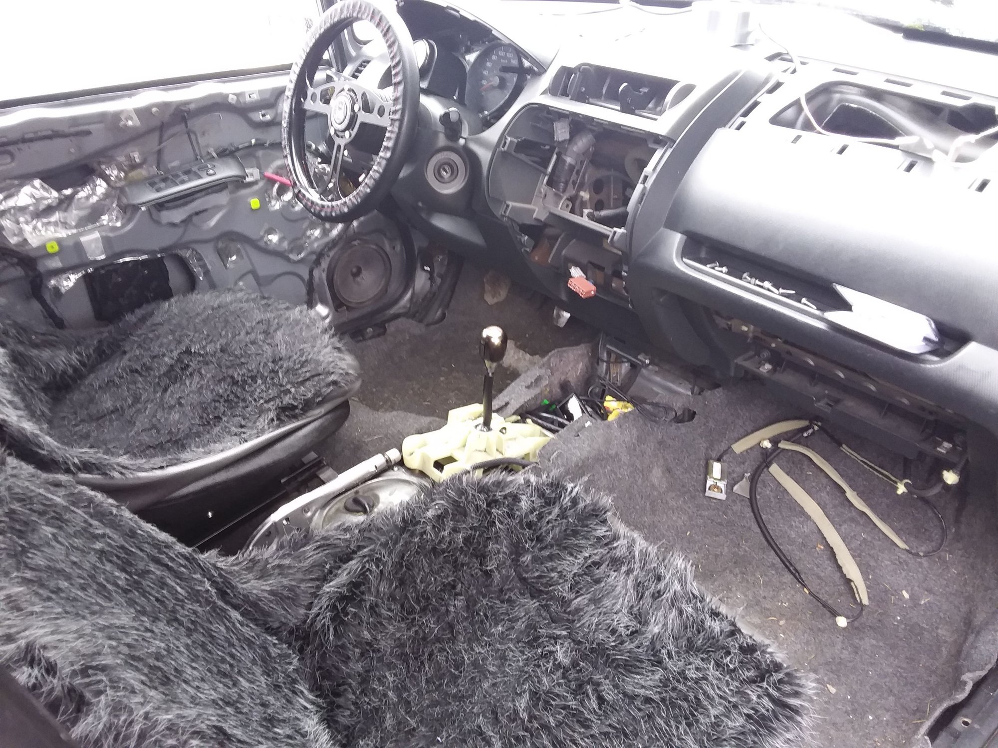

Just about ready to take the dash out now. Spent a few hours removing and tagging the nitrous wiring, removing the steering wheel (love that handy steering wheel puller!) and column, and disconnecting the wiring harness from the fuse panel, ecu, etc. Was able to remove the antenna wiring harness and that is 0.5 lbs not including the exterior antenna parts.
Should be able to get the dash out tomorrow night! 😄 Here's a quick pic of the mess before I quit for the night.
