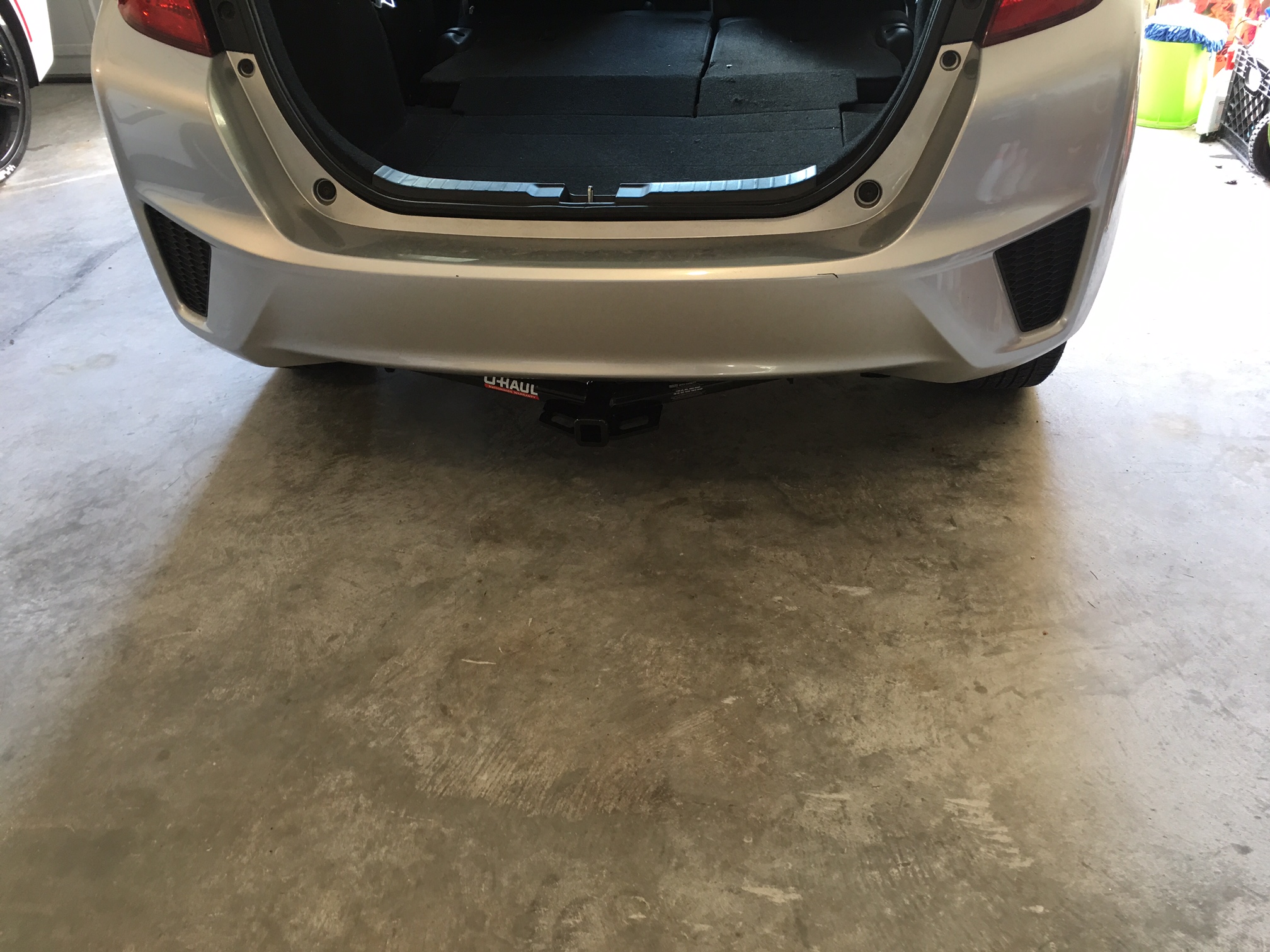

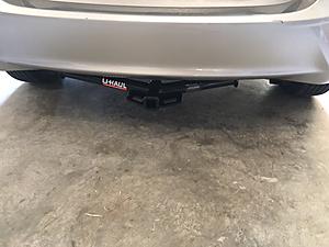

Got any pics of the tow hitch? Whenever I buy a Fit for myself Ill be getting a hitch right away, Im just curious how hidden they can be installed.

I mentioned in my post that U-Haul lists a specific hitch for the Fit, they will even install the hitch if you want but it was so easy I did it myself.

The hitch is not very obvious without the draw bar/ball inserted. Here are a couple pics
