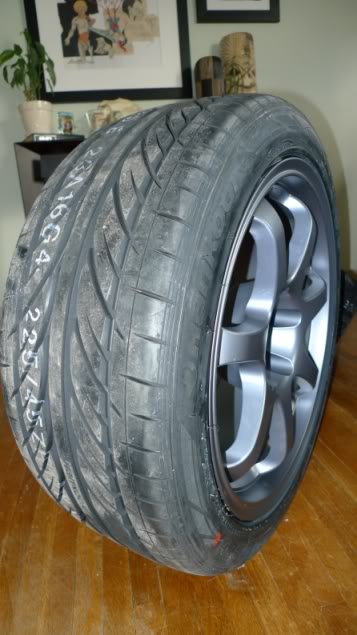

heres a 225/45/17 pic i found from k20a.org
Looks about right. Enough sidewall to give a lil but lots of tire meeting the tarmac. I might go with that for the larger sidewall = more comfy ride...not trying to build an all out race car...that im aware...but im not aware of alot these days...lol

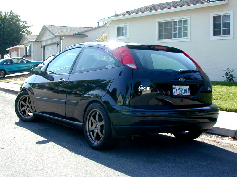

Heres another pic i found on honda-tech of 225/45/15 while searching for pics of 225/45/17...this guy seems like a newb
haha that looks perfect.
haha actually thats the rear which is a 205/50/15 on a 15X8" wheel. the front is 225/45/15 on a 15x9" wheel.
205/50/15 = 225/45/15 in overall tire height. also, those size tires on those size wheels maximizes the tread to ground usage. also keeps the side walls a little bit more stiff and prevent flexing. I chose these tire sizes because they are the fastest combination for each wheel size, and I wanted a 225 minimum on the front.
