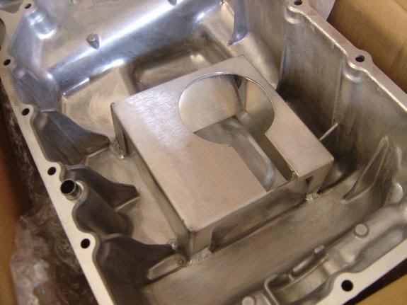

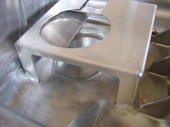

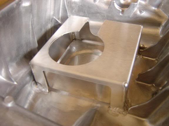

Here is the Prototype Racing one fabbed up by Joe McCarthy.
You can see the trap doors how they open and close based on which way the g's are pulling/pushing.
Though my vote goes for BALLER and drysump, a real winning combination.
