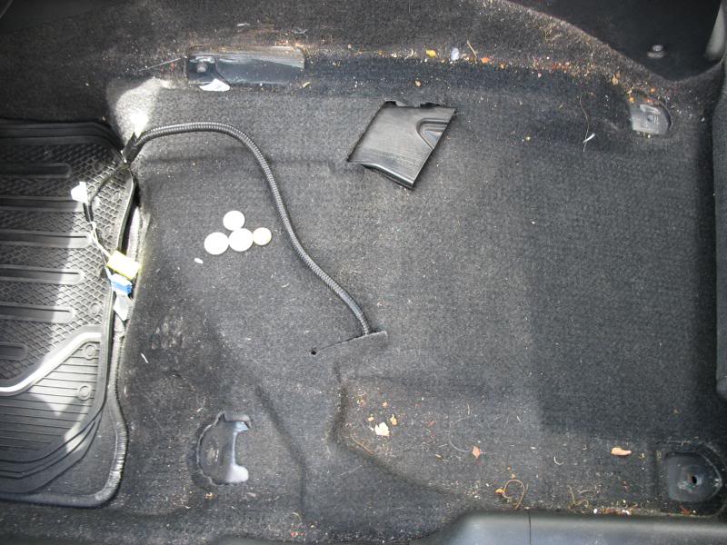

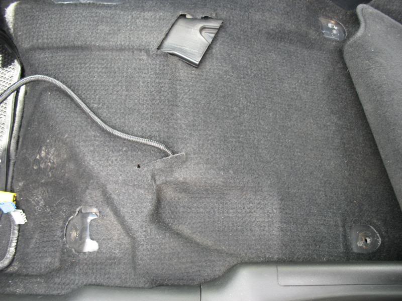

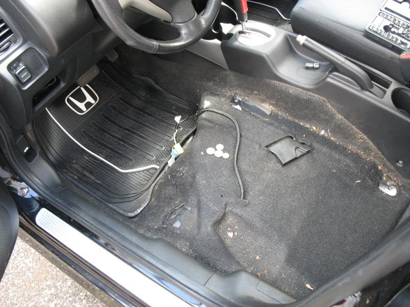

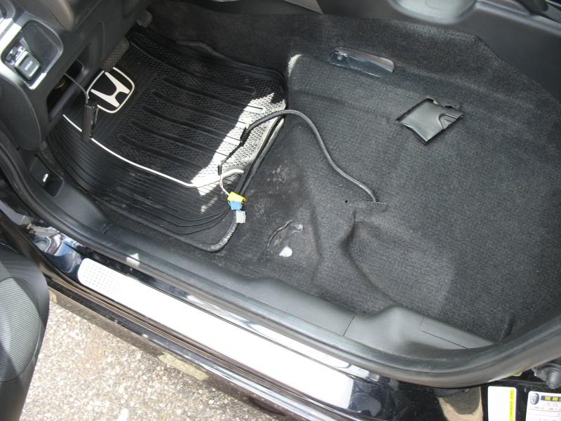

Spring Cleaning
Took the driver's seat out to get all the built up gunk from underneath it and to give it a good vaccuum as well.

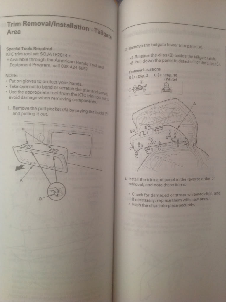

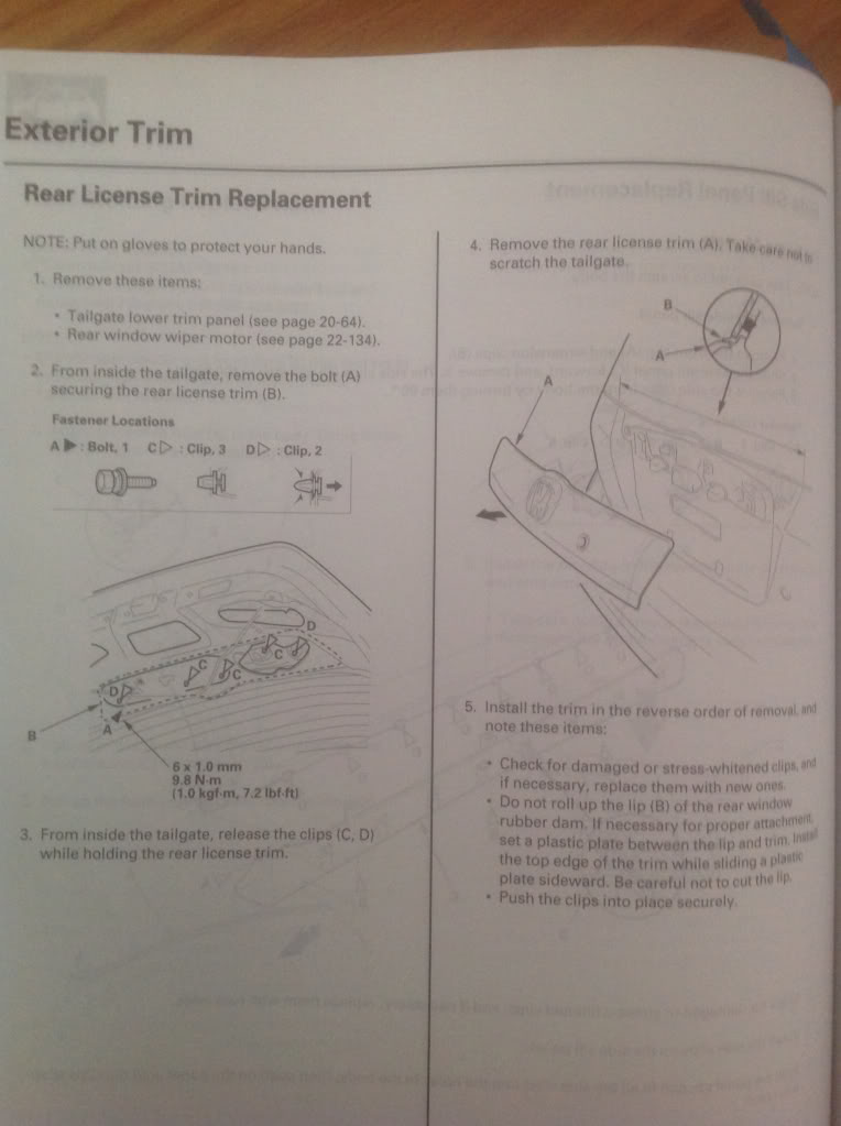

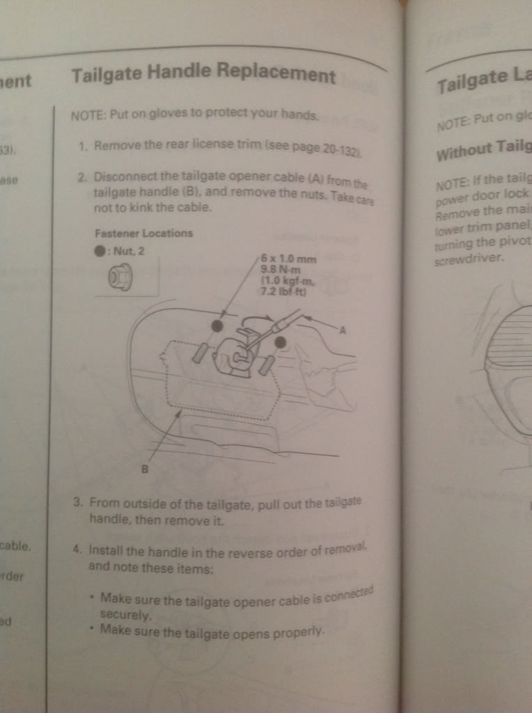

Today I clipped a garbage can and a recycling bin that someone had thoughtfully left halfway off the curb on my way to work, and destroyed the passenger side mirror utterly. It also dented the weather seal along the outside of the window where it impacted. So I've got a couple questions. I got a new mirror assembly on the way thanks to the internet. But it is 'paint to match'. Are the mirrors actually painted the body color? Mine seem to be just a glossy black, not the midnight mohawk pearl of darkness or whatever whimsical name they call the black ones. Secondly, is the outside window weatherseal (along the top of the door panel, not around the edges of the window) a replaceable part, I can't find a part number or anything for it on any of the normal parts sites.
I also decided I need to replace the back hatch handle, but I can't figure out how that comes off. Anyone done it?

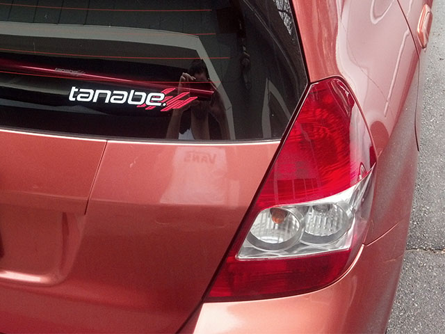

finally installed my Tanabe rear strut bar. had to use vice grips on the upper strut rings but the top nuts came loose without much of a fuss.
had too many of these decals lying around to not stick one on...
also used some blue magic metal polish to spruce up the medallion tip... looks worlds better now

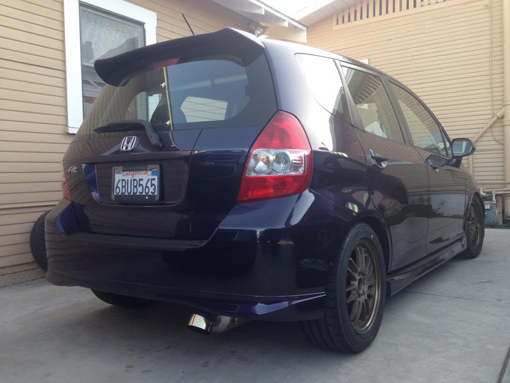

Washed, partial bluff, clay bared, re-washed, and waxed the Fit today! This is the cleanest it has ever been. First wax job of the beast too.

So here are pics from today. Not as shiny as yesterday but i didn't get a chance to snap a pic before night fall. This was moments before taking the Volks of to daily drive.
