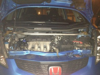

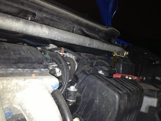

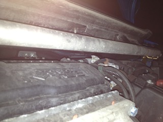

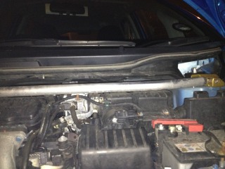

Further to my question on P12, I've finally managed to take some pics of my engine bay (excuse the dirt )

Judging from the pic- do you guys think the 69 K&N will be ok with my current strut bar?

I think you'd be fine. The K&N intake really sits back, almost completely under the wiper cowl. If anything you might touch on the top corner of the heat shield, but you could maneuver or bend that just enough to fit. Again just my opinion, but I'd go for it.

I know there are slight differences in our engine bay but you guys have a res bottle on the right (looking straight at the pic) plus it looks like your engine sits higher to the cowl?
Think might investigate (ie look for more pics on the internet) and compare it to mine but I'm really keen on getting one

The reservoir doesn't matter. It's not in the way in our engine bay and you don't even have it, so don't even worry about it. As far as the engine sitting higher, you must just be seeing an illusion. The engine positioning between your pics and those I posted look identical to me. That would be a strange difference just because you have the Euro version of the car. After looking at the pics again, I'm 100% sure it should work. Worst case the corner of the heat shield will touch the strut bar, but it comes with the rubber to put on the edge so it won't foul anything up. You may to have bend the heat shield or trim it every so slightly, but that's worst case. I think you're a go for launch.
BTW: that's the brake master cylinder res, so it's probably on the other side of your engine bay because that's the driver's side.
