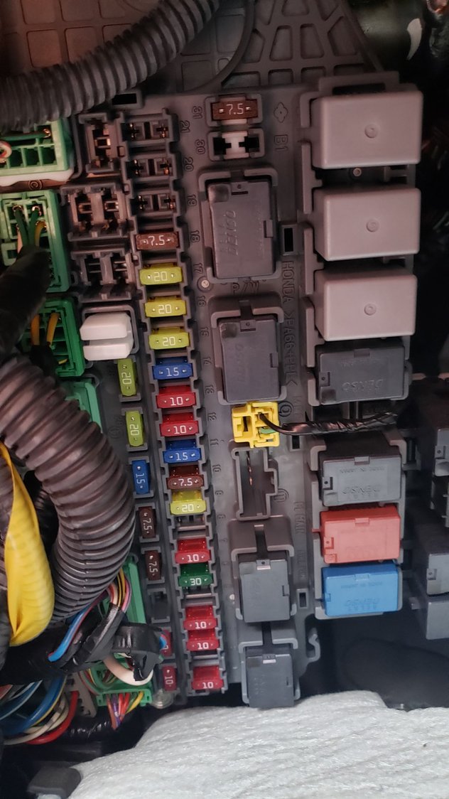

I'm having the same set of issues with 08 Base Fit with NO installed Keyless module.
therefore,
the kits you can buy from Amazon etc. will not have anywhwere to plug into.
I and others on this topic need the harness which seems to be the missing key piece.
I'd be interested in trying to 3d print the connectors if I could get a good schematic of the harness.
This is from my 08 FIT sport that has the keyless entry, my 08 base is missing this module and harness.
the harness for the keyless module plugs into the open socket just below the two wire yellow plug in the center of this pic.
closer view. obviously this particular base 08 fit does not have the Keyless option since it is missing the module and harness.
