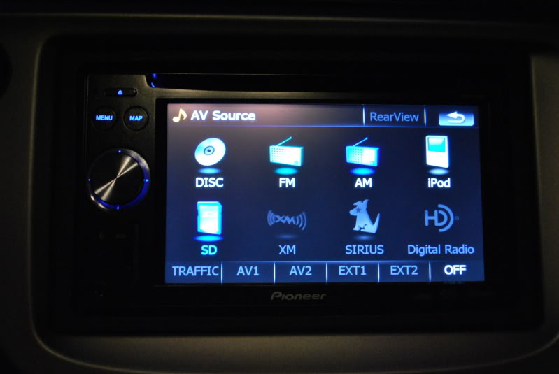

Here is the Pic's. I still need to get the pilot trim ring it's on the way. Any ?'s just ask.

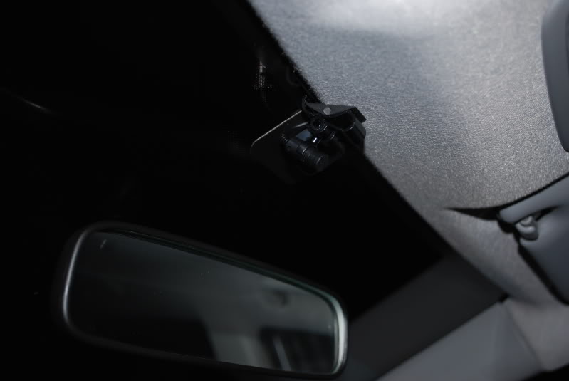

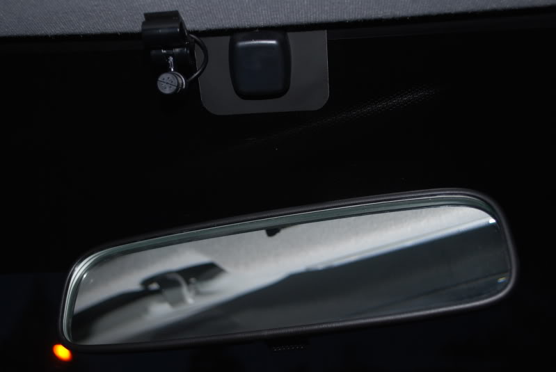

heres the install with my f700bt with the pilot kit and where i mounted the gps antenna and the bluetooth mic.

thats a nice spot for antenna didn't think about putting it up there. very nice

Does it give you accurate route when you mount the GPS mouse on top of the windshield? I vaguely remember that they suggest to mount it on a level flat spot. If it works, that seems to be a good location. What did you use to glue the mouse on? And how did you route the wire to the windshield? It looks very nice and neat.

its very accurate, and the gps antenna isnt glued on, the pad is some sort of metal, and the antenna is magnetic. i just routed the wiring under the headliner, then down under the weather strip, under the steering wheel column then to the head unit.
