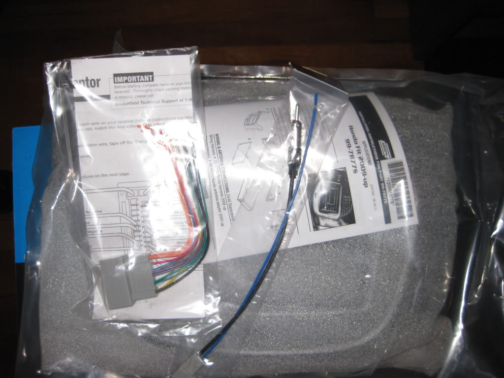

so what do i need to do to NOT blow fuses? my stuff come in today.. seee...

^^What unit are you running?
Old Dec 12, 2011 | 09:41 PM
  #150
Vash's Avatar
Posts: 1,053
From: North Carolina
iam running a clarion vx401
Old Dec 12, 2011 | 11:18 PM
  #151
Vash's Avatar
Posts: 1,053
ok clarion headunit here... iam about to weld together the wires tomorrow morning... just follow the colors right? or are the colors wrong?
