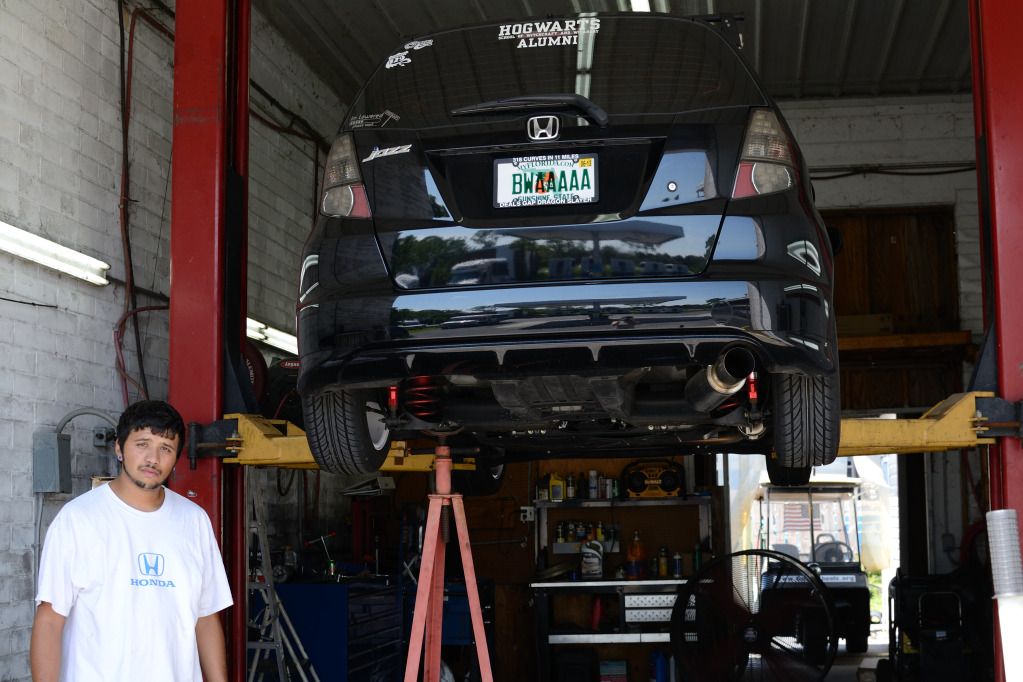

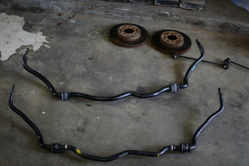

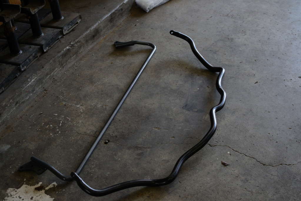

Well today was a long day. The wife and I took the cars out to my job to install her sway bars ten mins for the rear and what felled like a life time the front sway bar, as well as the front brake.

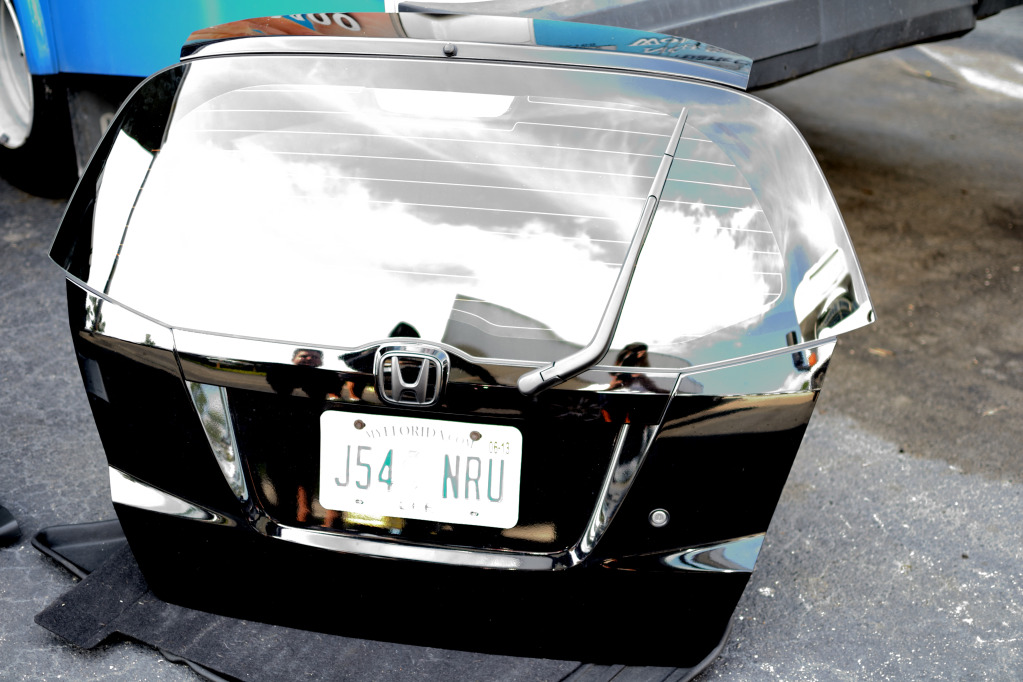

Our friends Nick and Chad came to help out as well, while the wife did her front brakes Nick and I swapped hatches (mine is a base hatch and his is a sport hatch).
After getting the wife's car off the lift and bedding the brakes we found out her car is too low and had to remove the RSB. All in all had a great day tomorrow Chad and I are going to give my car a full detail wash, clay and wax .
The only thing that would of made this day even better is if I didn't forget the damn memory car for my camera. But I did get a few
New sway bars

Me with the wife's car

her spoon sway bar and stock one with her rotors that I turned

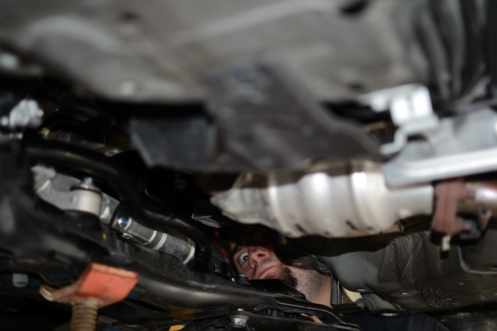

Nick playing around

my hatch

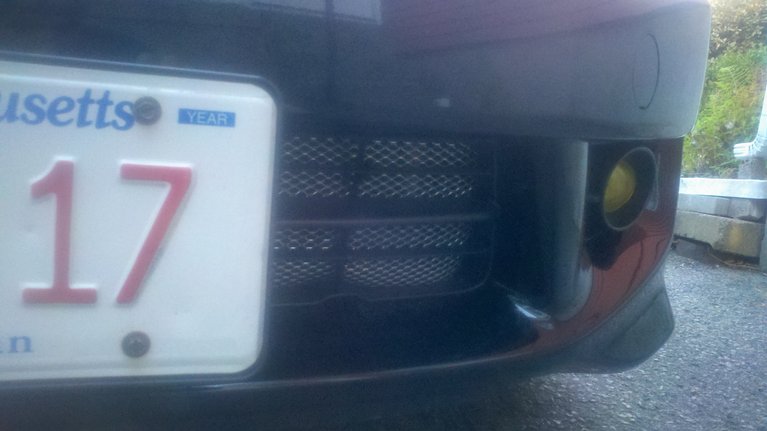

Today I finally installed a mesh grill to protect the AC condenser on my 2010. I found this 6" X 36" galvanized steel gutter guard at Home Depot for $2.29 (Model # 85280 Internet # 100002884 Store SKU # 808857)
Simple installation steps
1. Purchase gutter guard & about 2 dozen black 8" tywraps. Optional: vinyl door edge strips and a 6 pack.
2. Remove plastic cover from top of radiator well. Careful removing the push clips that fasten the cover. Pry up the center pin before pulling on the fastener.
3. Using tin snips, cut 6" off the end of the gutter guard, so you now have 30" long X 6" wide strip. Also remove and discard the two little metal clips that are attached to the gutter guard. They're not necessary. I had some black door edge channel left over from another vehicle, so I cut it into 4 strips to cover the edges of the gutter guard. Absolutely not necessary, but it does protect your hands from getting cut on the edges during installation.
4. Place guard in opening with concave side towards the engine. The material is pliable, so you can gently form it to fit any contours.
5. Use the black tywraps to secure the screen. There are plenty of vertical sections on the vehicle's grille where you can discreetly make your attachments. Be sure to start the tywraps from the inside of the well opening. Run the tywrap through from the inside, around the vertical support, and back through into the well opening. Tighten the wraps securely and be sure to snip off the ends so no one thinks you're a dork if they should happen to look down into the well and see all the ends sticking out.
6. Put everything back together, have your optional adult beverage, and voila!
