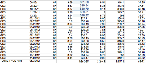

lol that's the least scientific measurement ever.
"From 6-7 days to 7-8 days"
Unless you're considering where you fill up, temps, driving conditions, exact mpg, etc., your assumptions mean nothing.
I keep records like this and have been since early 2011 in my Integra; I still acknowledge I miss a lot.

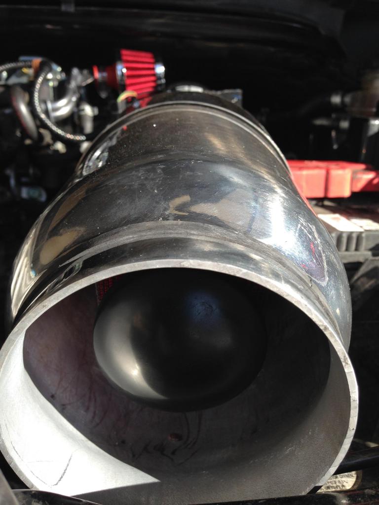

... and here are a couple pics. I cut the MAF "tube" out of the stock box keeping the horn shape at the entrance intact.
(note: weird, 2nd pic is rotated in forum display.)
[IMG]https://www.fitfreak.net/forums/[/IMG]
In the next pic you can see the rounded nose of the cone filter inside the housing. This is where it sits with the hood down. Had to take off the OG rubber air intake cover/channel that is attached to the hood and the new housing just barely fits with the hood down.

now that's a cannon!

Yeah, pic might be a little deceiving. The "cannon" is about 10.5 inches long. It's a 5 inch diameter tube reduced to a 4 inch opening at each end. The cone filter is the oiled variety & pretty much the full length of the tube.
Sounds great & I figure it has to be more "CAI" than stock. Thinking of possibly wrapping the full length to help insulate against engine heat but after this & the Eibach Street Springs I installed a few months ago I'd rather save $$ for my next project car.

Thats a negative unfortunately, the stock box pulls air from the coolest place in the bay that's fed from the fender. That's why intakes like the PRM are so short and routed the same place as the stock box to use that duct. I wouldn't bother with the wrap it's not going to make much difference, especially if you've got other uses for the money. If you're bored go for it lol
HOWEVER I do give an A for ingenuity and creativity, I've never seen a filter like that, and as long as you are happy with it all my gobbledygook doesn't matter so good for you.
