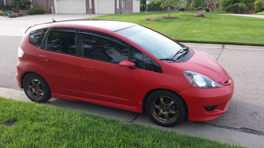

Dipped it matte red.

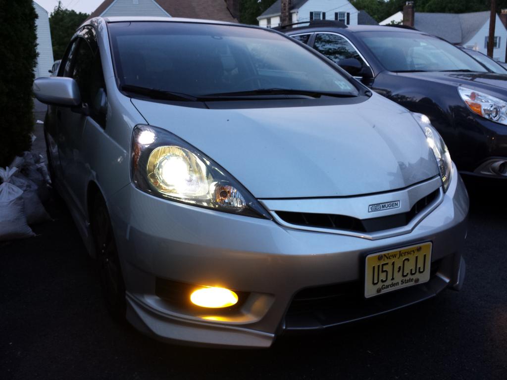

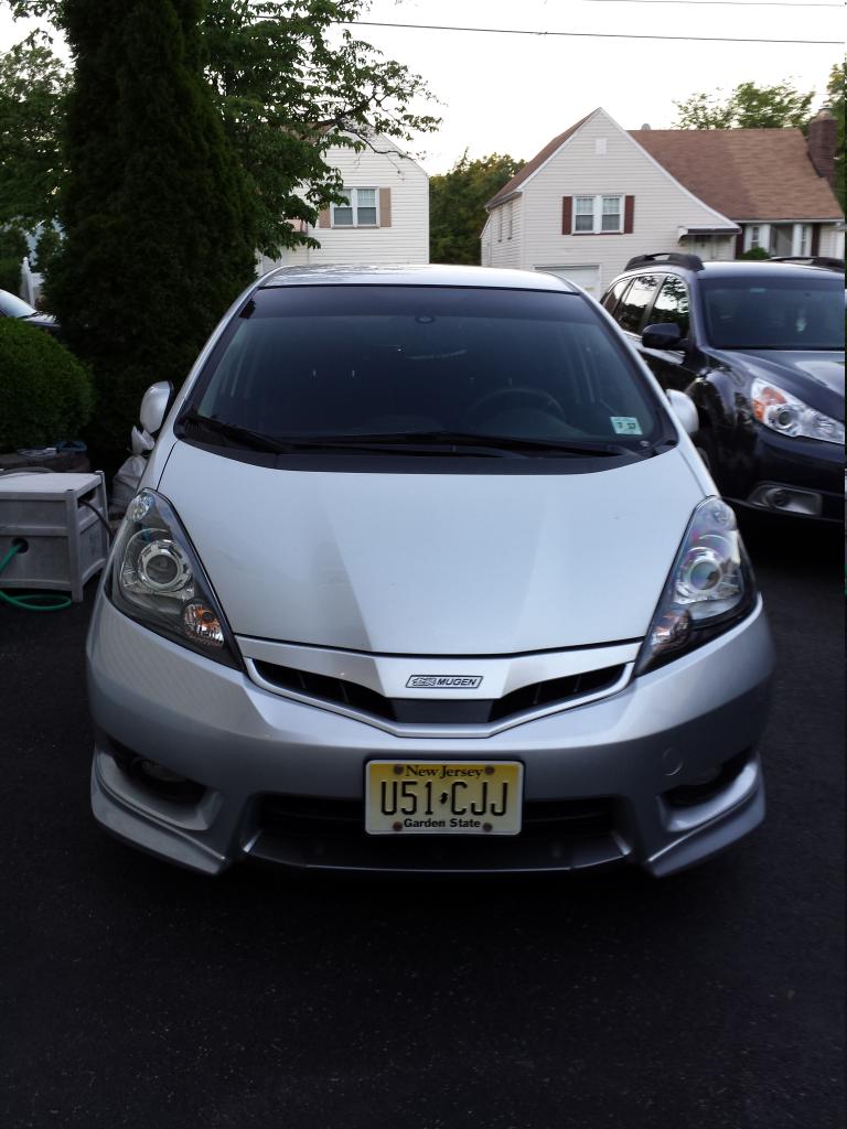

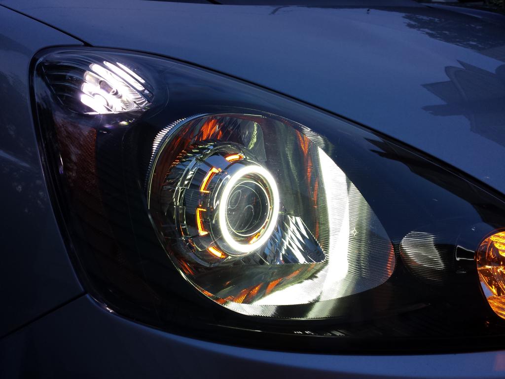

finally the sun is going down. took some pics of the finished retro

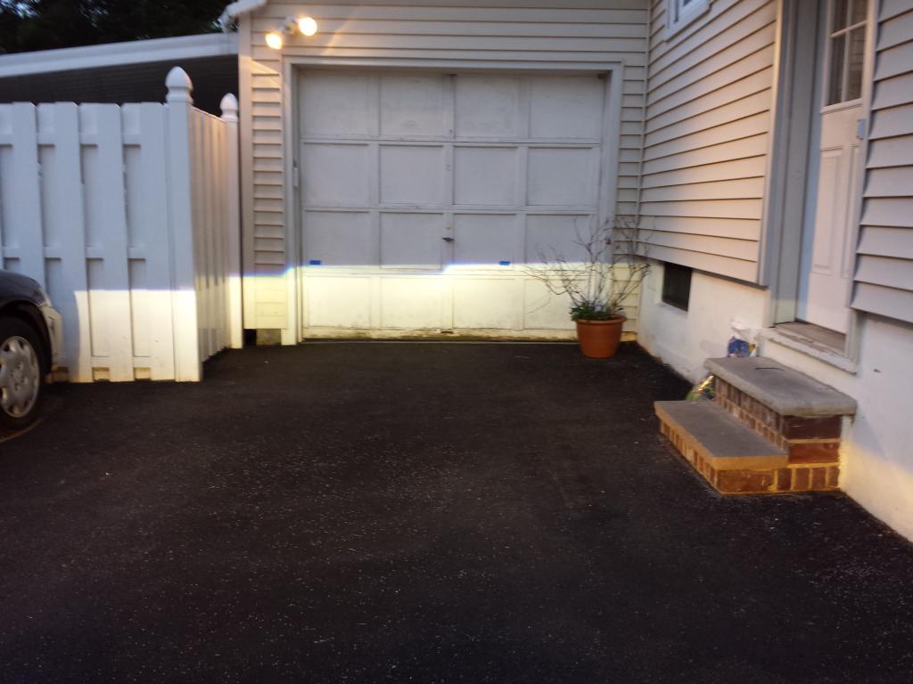

my cut off:
my driveway isn't level so it's slanted. it might still be a bit high.
Specs:
Morimoto Round D2S 3.0
Phillips 81522 4300k
Matsushita Gen V Ballast
Amber Morimoto xB 100 mm LED Halo
White (4300k) Morimoto xB 80 mm LED halo
TYC headlights from Rockauto.com
Morimoto T10 White LED
Install wasn't as bad as i thought. Used a heatgun to open it up. 1st one took me like 4 hours to finish. The 2nd headlight took 1 hour. There was quite a difference between how both headlights were made by TYC. The NSF certified one was much cleaner with the sealant. However the back plastic part wasn't as solid as OEM. Alot of complaints on hidplanet regarding the new T10s not working OOB. Mine fired up no problems and now the whites match.
