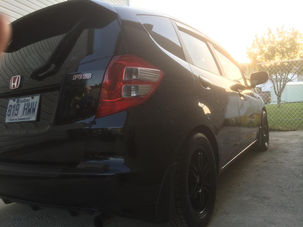

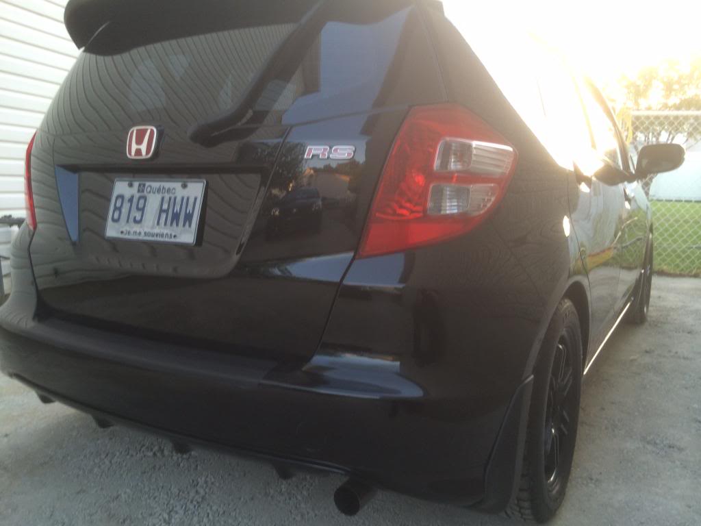

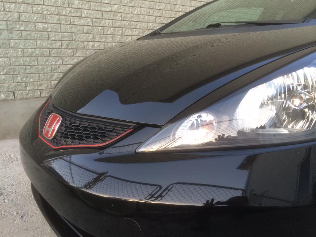

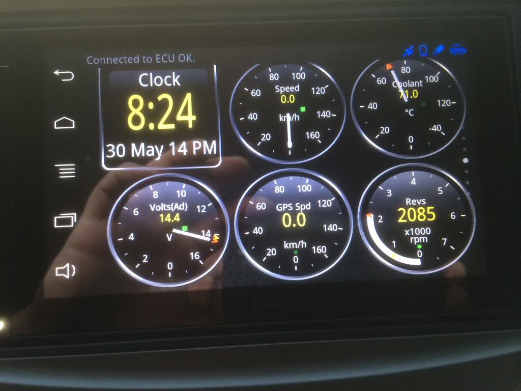

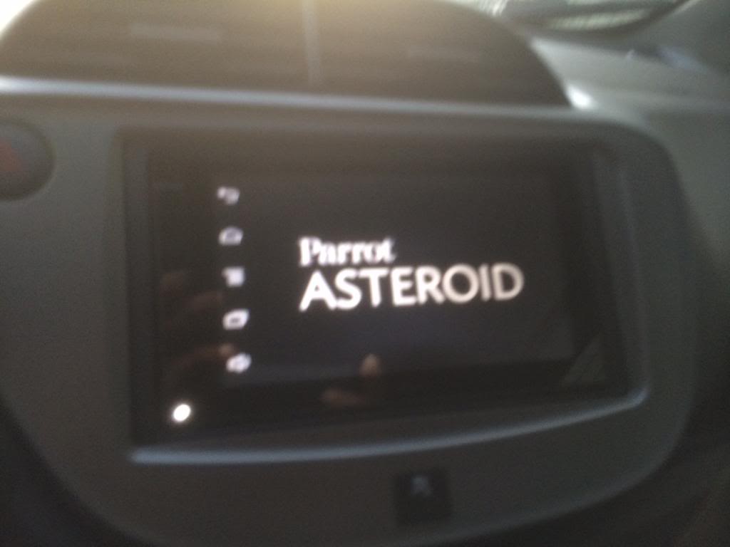

Clean the beast and installed a new head unit plus paiting the front caliper
