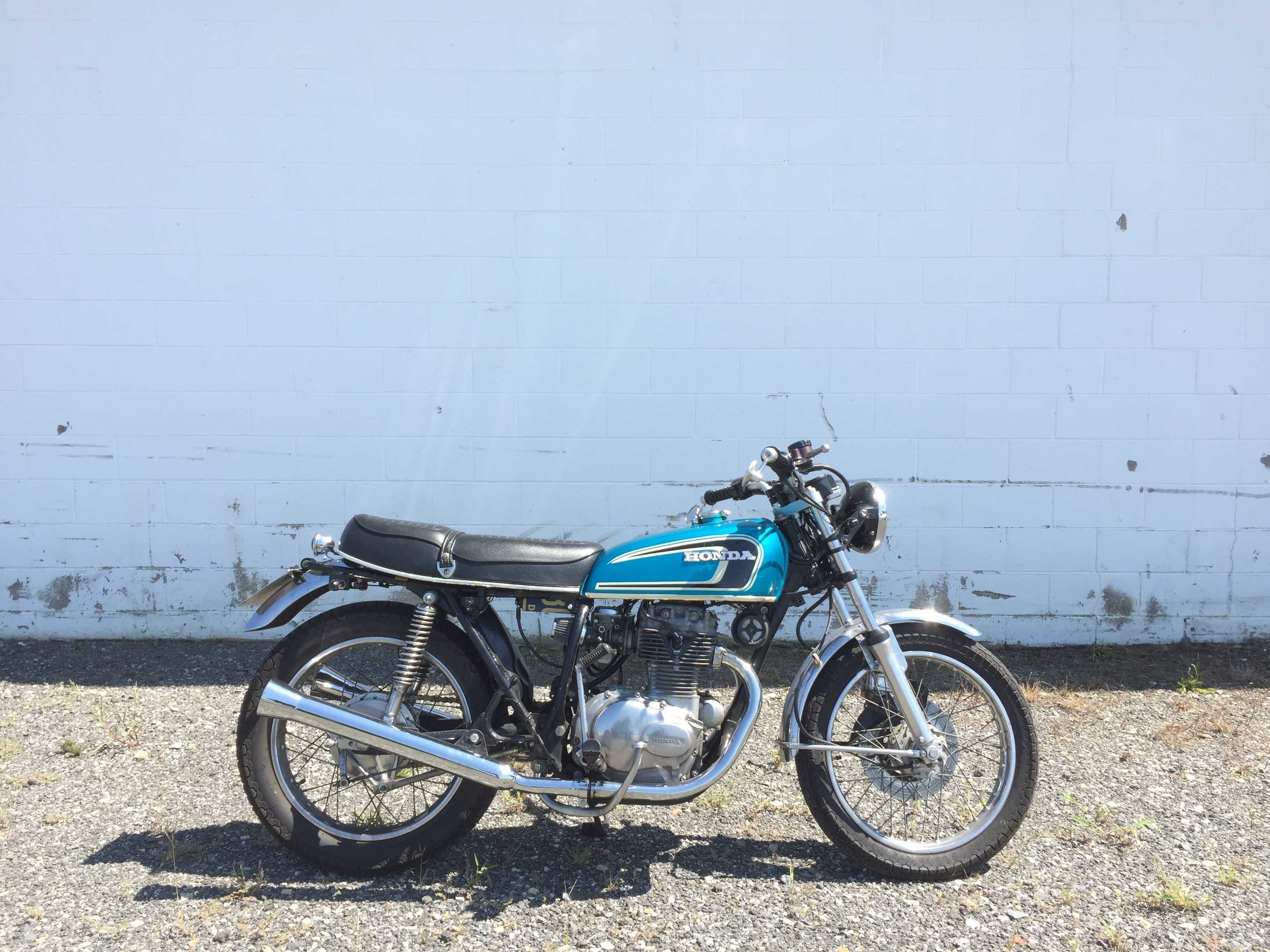

Nice little bike. Looks like original exhaust with no rust. And the cable operated disc front brake.
I looked in my Honda Motorcycle Identification Guide and (at least in the Guide), your bike is listed as a 1974 model. The 1973 came in Candy Topaz Orange (like yours), but had different graphics on the tank. The Guide shows the 1974 having frame numbers CB125S-1100001 and up, and the 1973 has frame numbers CB125S-1021922 and up. I don't remember if they had the placards on bikes back then showing the manufacture date.
Anyway, it's a sweet looking bike in good condition. Enjoy!

Ah, good eye! The placard does say 12/73, so it's indeed a 1974 model.
Since you like motorcycles, you'd probably enjoy my other bike - a 1975 CB360T.

I like your 360 also. Thanks for the pics. A friend had a 1973 CB350 in the gold color. Liked that too. I think just about all of the bikes from the late 60's to the early 80's were good looking. I had a 1970 Suzuki T125II Stinger (twin cylinder 62.5cc per cylinder), a 1973 Yamaha RD350 (stolen), a 1974 RD350 (rode from Orlando to LA and back), and a 1976 RD400 (stolen). All great bikes. Miss them all.
Good luck with you Fit build. Nice work.

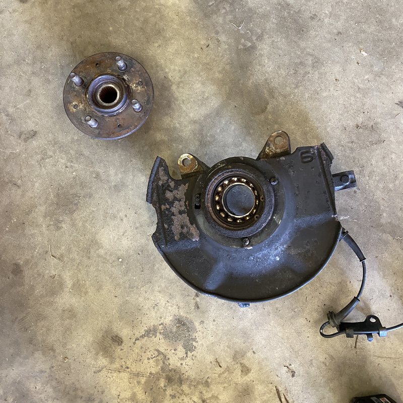

Drove the Fit around the block, noticed a not-so-nice sound was being made. Thought it was this...
Fixed that. Drove it home, the noise was still there... Ran errands the next day and drove it to a friend's house to see if we can diagnose where it's coming from. Sure enough, it was a wheel bearing up front. He said he could get one in half an hour or so (shop account), so we got to work.
No more noise! Hoping the other three behave. Shocking they've even made it this far in life, to be honest. Went about 30 miles on a bad bearing.

So this was the first wheel bearing failure after all the miles on your Fit ? The fix is to press in a new bearing or replace the entire assembly?
Old Mar 12, 2021 | 10:17 AM
  #309
julianachos's Avatar
Joined: May 2016
Posts: 378
From: Delaware
Correct. Going to be on alert with the other three for the rest of the year.
The front requires a bearing to be pressed into the knuckle. Rear I believe needs the entire hub assembly replaced.
