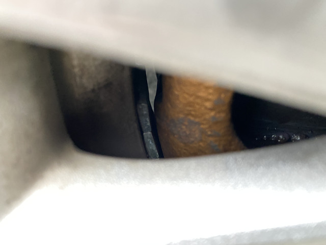

Mileage is somewhere around 545,500. Installed new front lower control arms with a buddy, nothing too exciting. Also new front tires because mine wore through from the bad arms.
Ball joint on one was making noise and a bad bushing was causing a vibration at 60 mph. Other side had a torn boot that was doomed for similar failure.

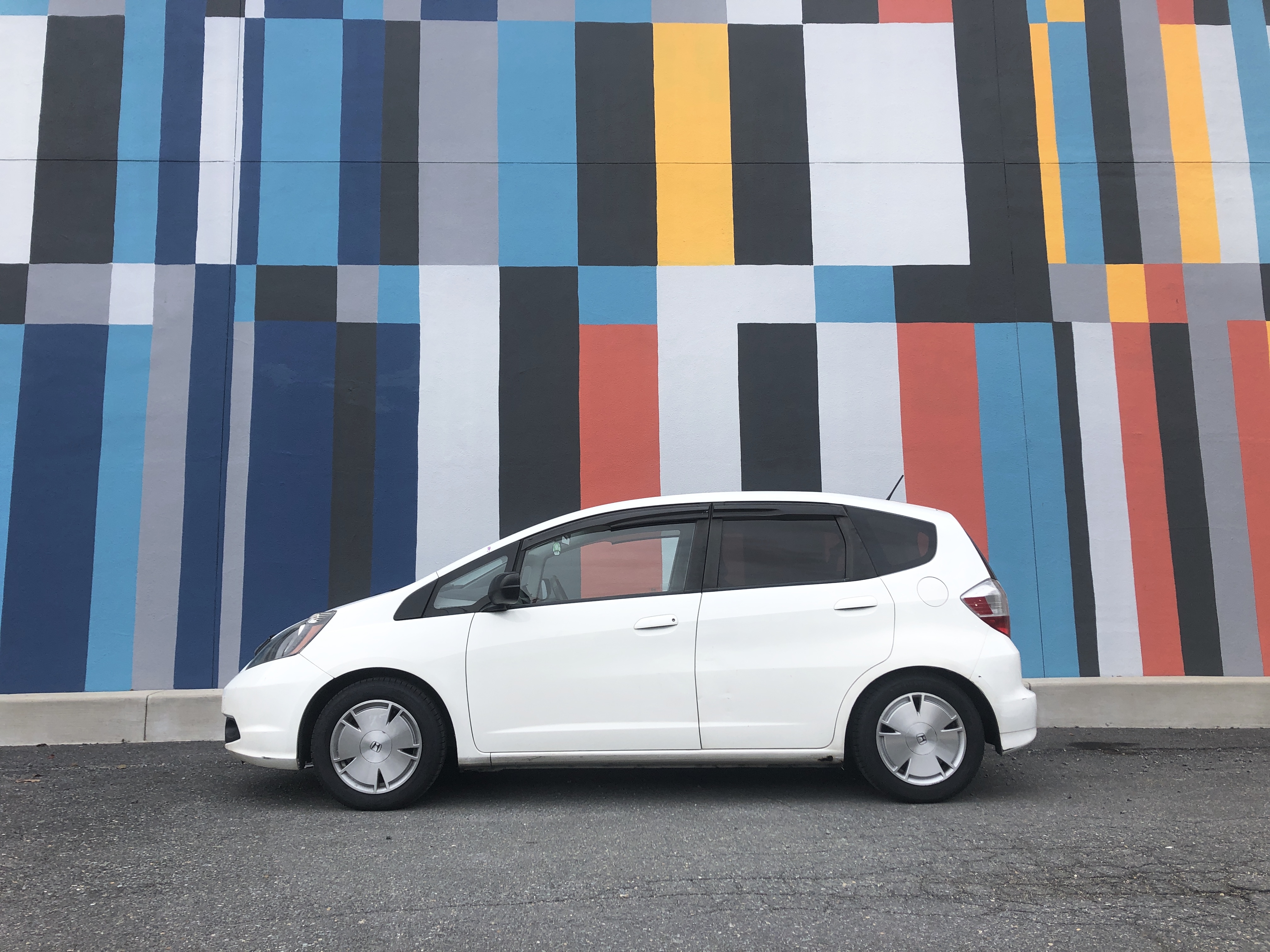

The body on this is so clean! Do they not use salt where you live? Cars start rusting in about a year up here... damn.
I really like the civic wheels, I’ve got to keep an eye out for a set to use as winter rims. Looking forward to your updates!

Salt is used where we live! It just doesn't snow as much as Canada, however New Jersey (where the Fit spent most of its life) uses ALOT of salt when it does snow. If you peep the side profile, you can actually see a hole in the rocker.
They're actually Fit LX (Canada only) wheels! We don't have these stateside. The only thing similar that we have are the 8th-gen Civic Hybrid wheels, and they are 5x114.3.

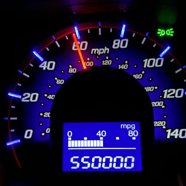

Not much to update besides two things:
550k miles!

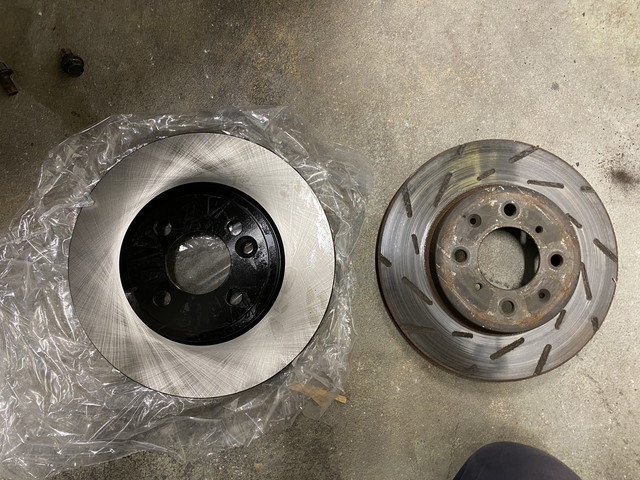

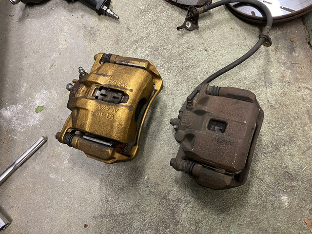

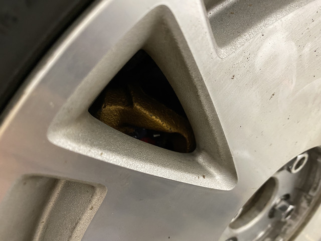

Also gave my brakes a much-needed upgrade. A friend of mine had put RL calipers on his Prelude, so he gave me his old calipers, with almost new EBC Redstuff pads. I decided to put them to good use. I followed De36's big brake kit DIY using the specified 280mm Mini Cooper rotors and added SS brake lines I got from GolNat a while back. Since I have 15" wheels, I ran a 5mm spacer to clear the bracket.

Wow that's a tight clearance. Wonder why there's that much of a clearance issue with those wheels. I run 15 inch wheels and 280mm rotors and I've got almost an inch of clearance between the caliper and wheel, Konig Heliums for reference.

You just said it right there: I'm running factory wheels whereas you're running aftermarket wheels.
These wheels are not only flat-faced on the outside, but they are pretty flat on the inside too. Will test fit steel wheels tomorrow.
Just dawned on me Red. Are you talking about the inside of the barrel? Factory wheels tend to not be forgiving with space. US-spec ITRs with factory 15" wheels have similar fitment, but they are design for the car with those brakes unlike these wheels.
