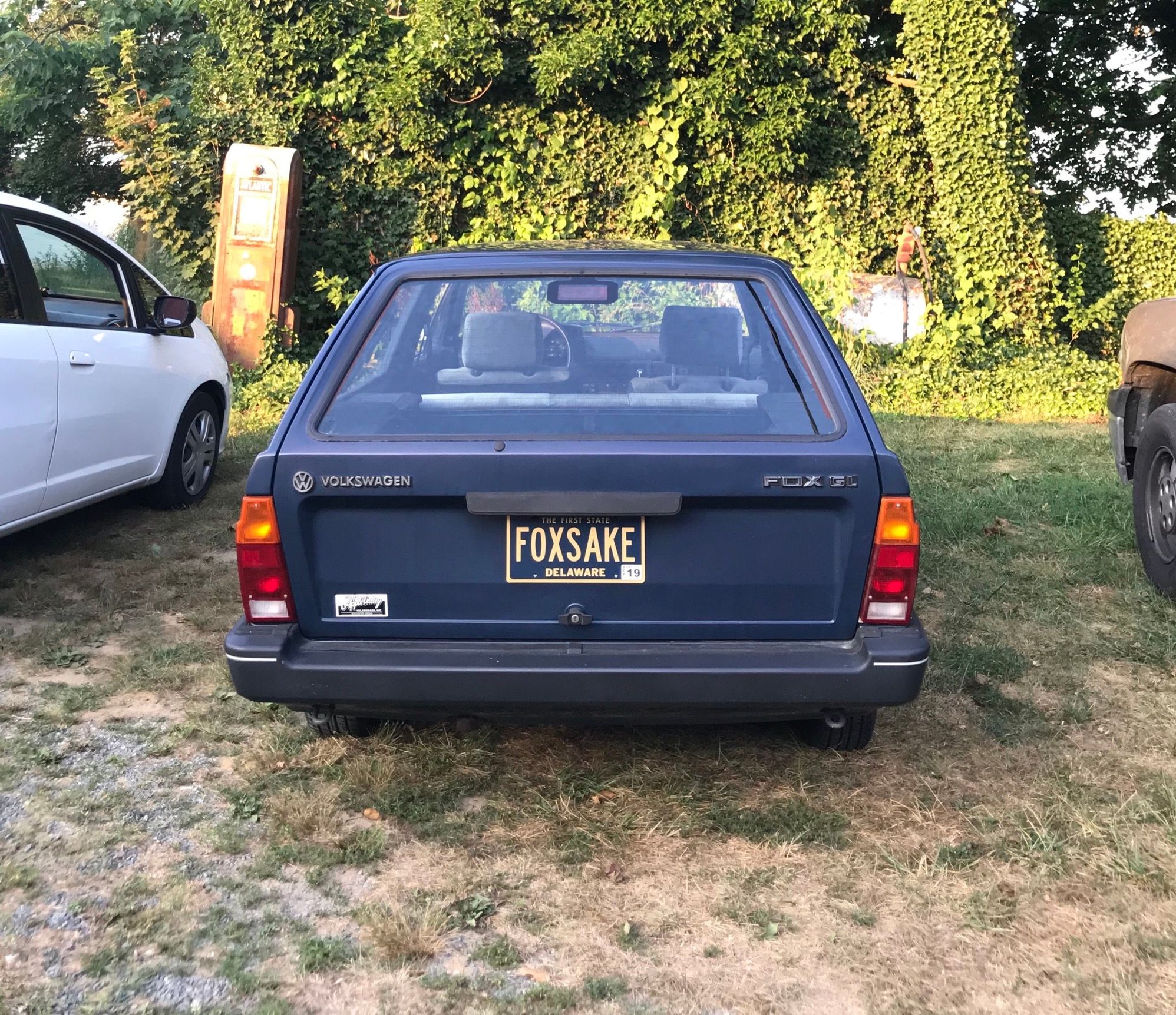

That’s a nice looking wagon. I owned both of these at different times. They were good ones I didn’t have to do much to, but my favorites were the $300 beaters that came back to life instead of going to the junk yard.

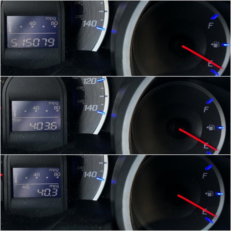

Decided not to drive like a dick for some odd reason and got good results. 75% is highway, though.

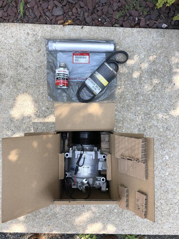

Also replaced the A/C compressor and dehydrator/filter/dryer-drier/whatever you'd like to call it. A buddy of mine was nice enough to drain the system out so I can just do all of this at home without ruining the environment.

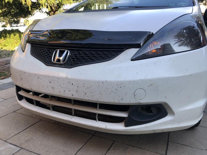

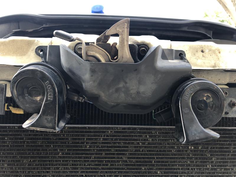

While the bumper was off, I decided to upgrade the meep-meep horn for dual Hella trumpet horns from an '03-07 Accord:

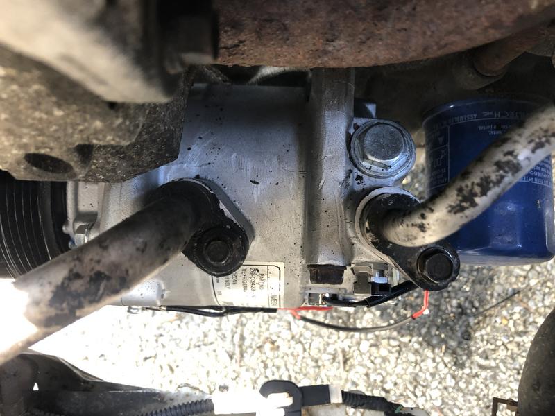

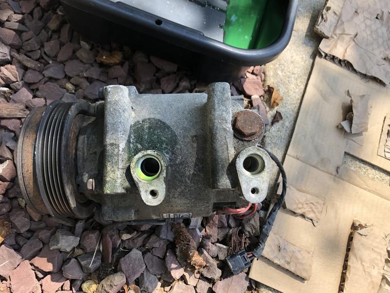

Only grief I really had was realizing I got sent an '11-'13 compressor. Note the minor differences in how the lines are bolted down:

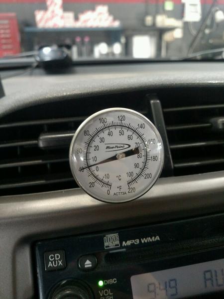

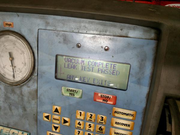

Today, the Fit has functioning air conditioning for the first time since my ownership and in maybe 4-5 years. Can't thank my friend enough for this!
Tuesday, it goes to Atlanta for a little then to South Florida for five days. Got this done just in time haha.

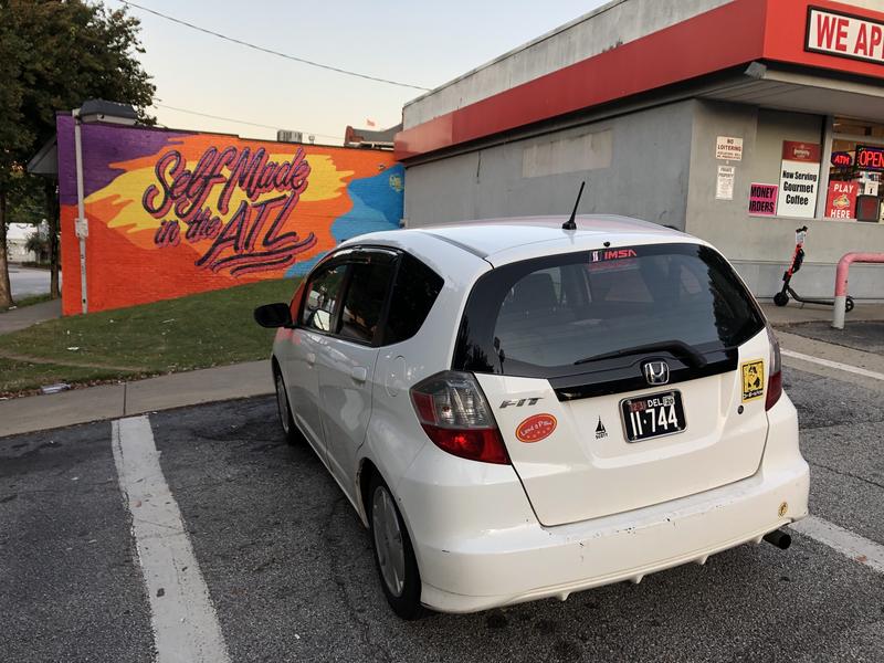

Fit is currently in Atlanta, doing well of course.
Was going to go to Florida, but with the upcoming hurricane, that's not going to happen.

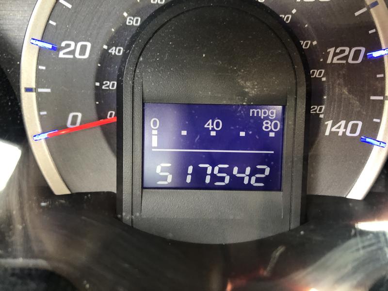

Forgot to post more photos. Beginning of this trip-
In Atlanta-
When I got home-
Fit is going to Toronto again after next weekend.

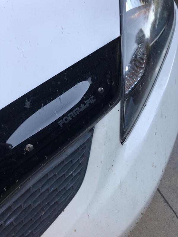

I've had this thing for a few months - a Form Fit hood deflector. From my understanding, these were a Honda Canada OEM accessory. Feels like an OEM piece. Didn't want to install it until I got a new hood, which I've acquired a week before my trip.

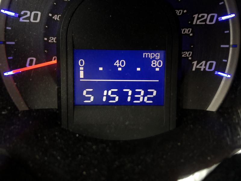

I think the odometer is currently reading 521k miles. Can't remember.

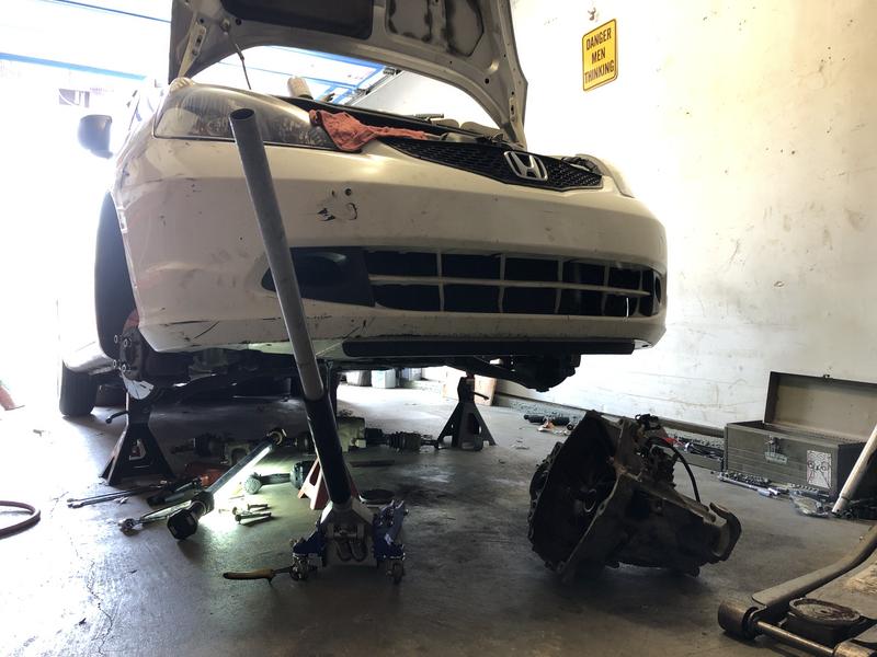

Clutch #5 took a dump on me Friday night. I was able to limp it 25 miles (just staying in 5th gear) to the nearest rest stop for easy towing. I was about 20 miles from home at this point.
Ordered a clutch while waiting for the tow truck and should be in my hands tomorrow when I pull the trans out. Gotta get this thing ready before I leave next Tuesday to go to TX.

RockAuto.
Pull wheels and axles out, remove battery, starter, and shift linkages, and pull trans out. At least that's how I remembered doing it last time.
Anything the clutch kit comes with along with MTF.

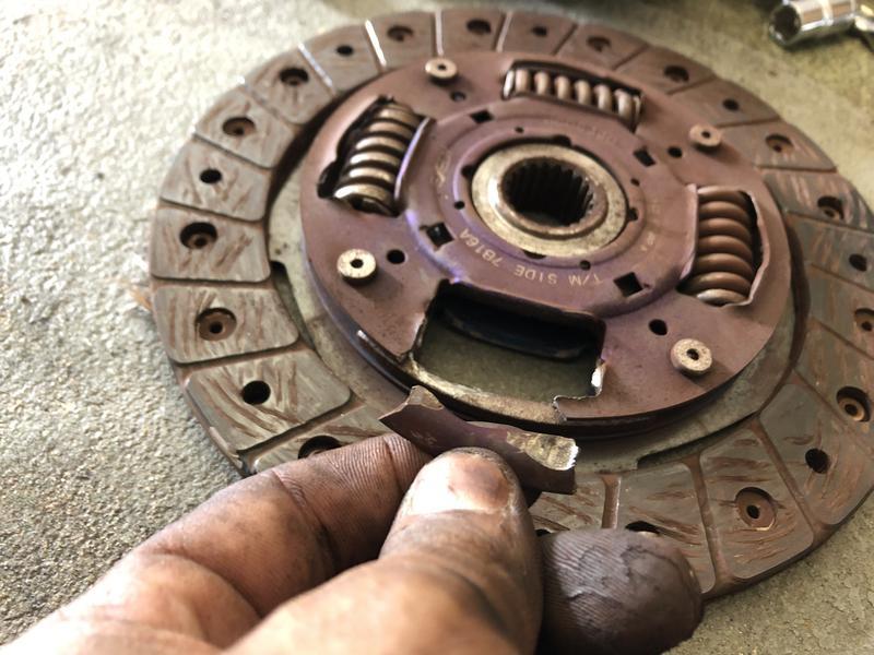

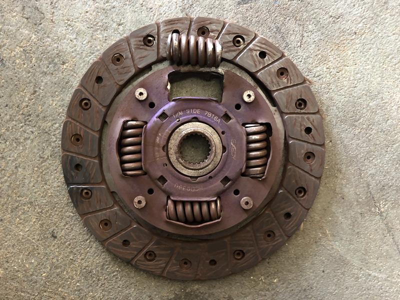

To what do you attribute the clutch failure?
Old Oct 8, 2019 | 03:07 PM
  #179
julianachos's Avatar
Joined: May 2016
Posts: 378
From: Delaware
Happens every time. Going a different route for clutch #7. Really didn't think this one would only last me 60k miles but here we are.
