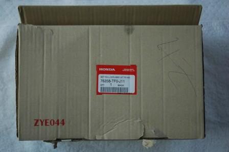

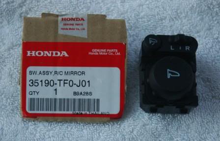

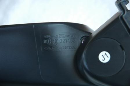

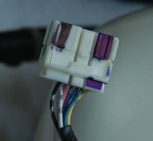

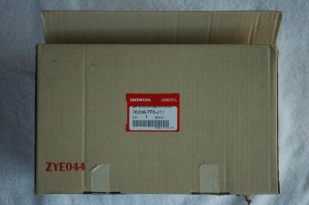

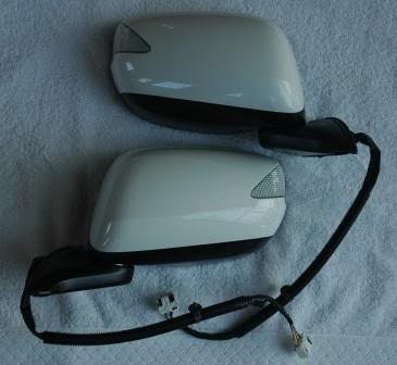

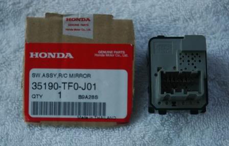

Integrate turn signal side mirrors
These are parts I bought. I will install them during my 2 week Christmas vacation.
RC Mirror Switch - Front
RC Mirror Switch - Back
Left Mirror
Right Mirror
Mirrors
Genuine Honda Parts

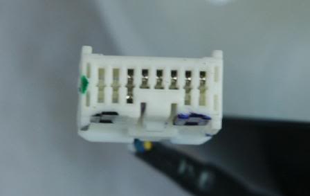

Plug - Front
Plug - Wires

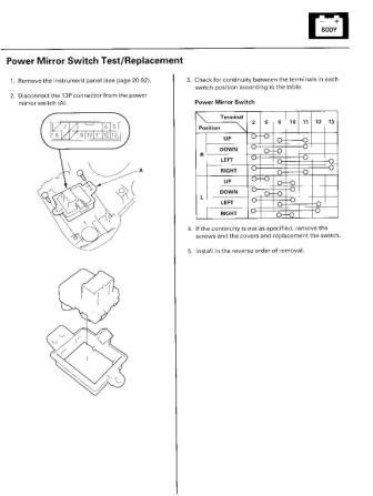

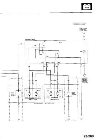

Power Side Mirrors with turn signal circuit diagram
I will install heated side mirrors with integrated turn signal base on these circuit diagrams. If you connect circuit 1 and circuit 2 together, you will get a complete side mirrors and rear defoger circuit. Circuit 3 shows RC switch pins, colors, etc.
Circuit 1
Circuit 2
Circuit 3
