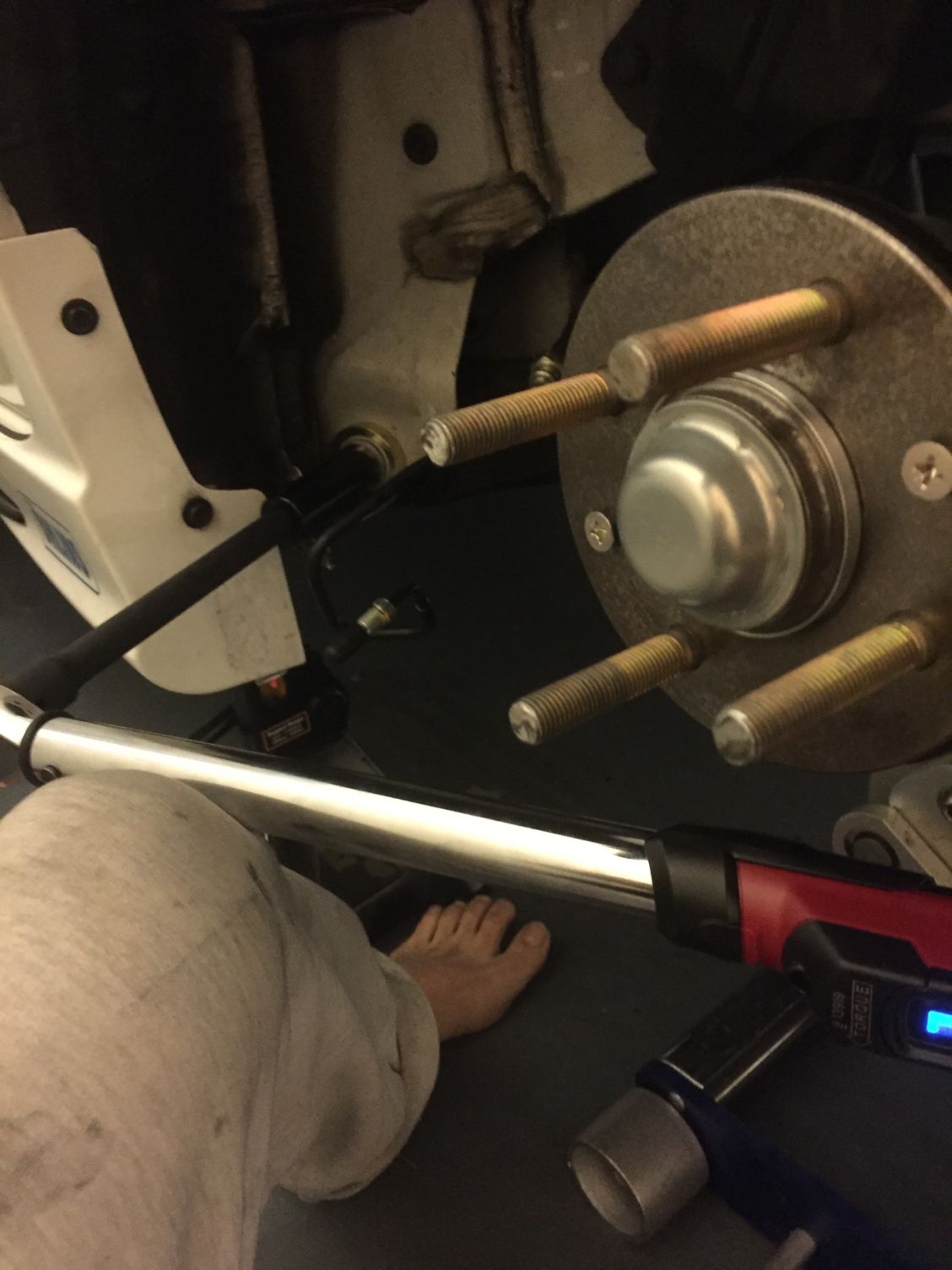

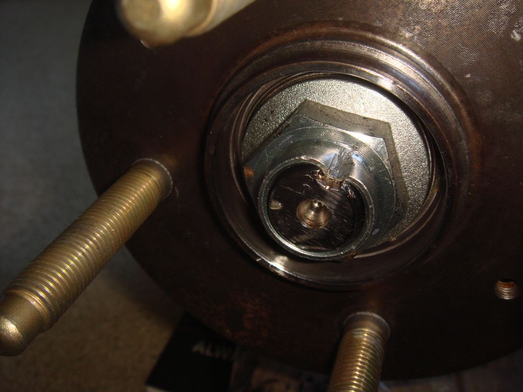

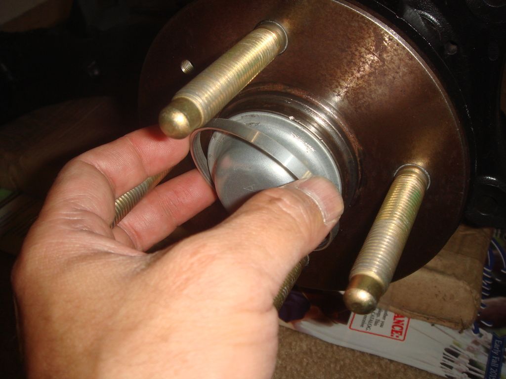

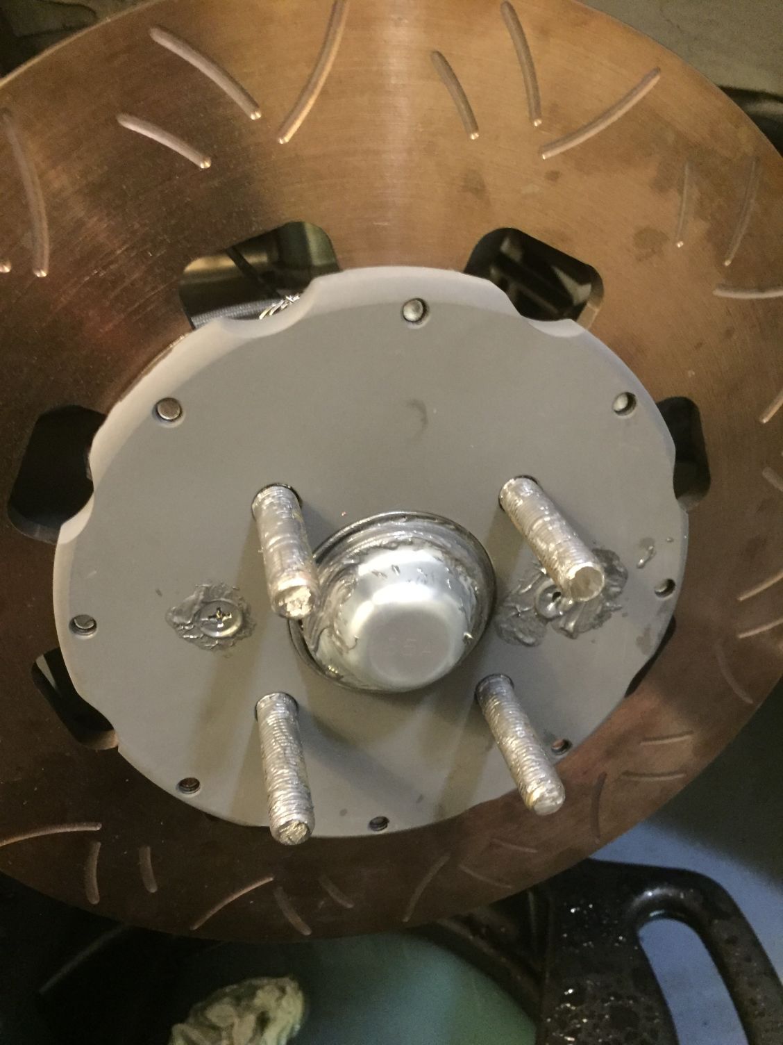

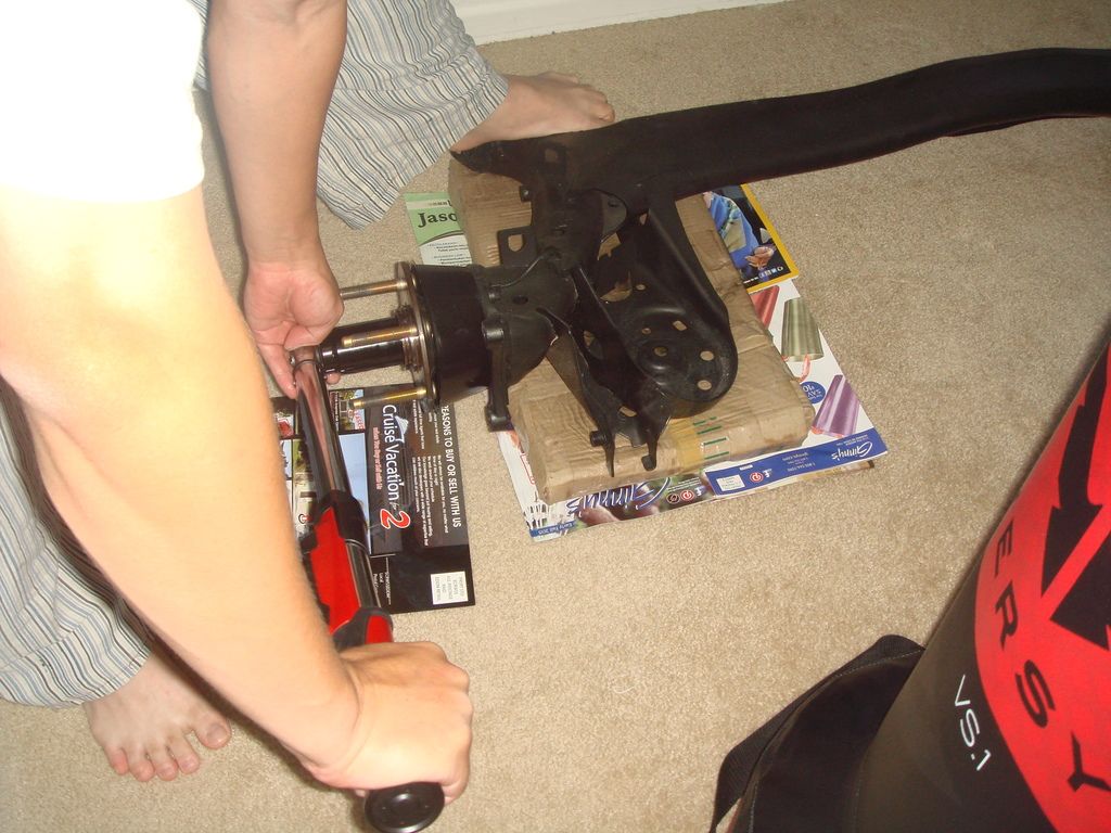

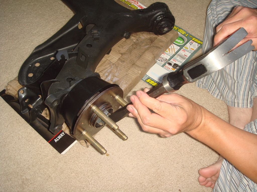

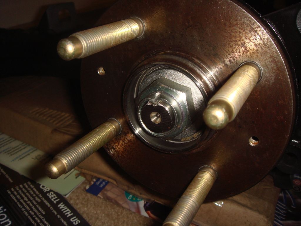

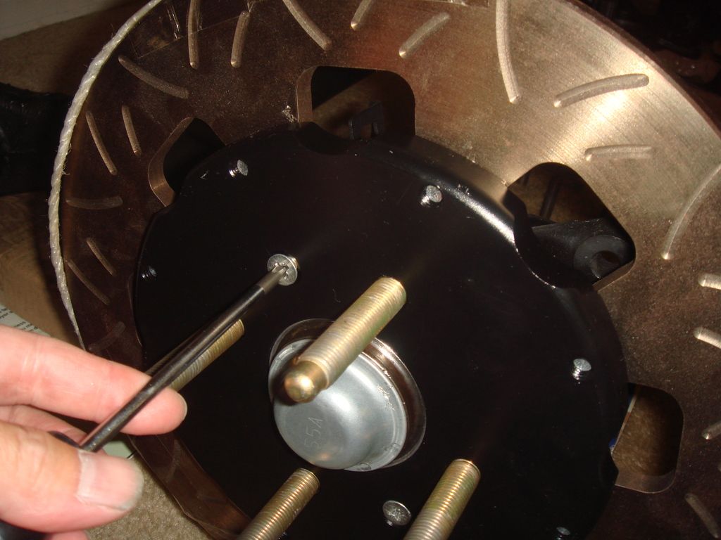

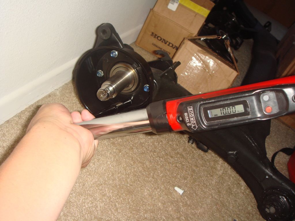

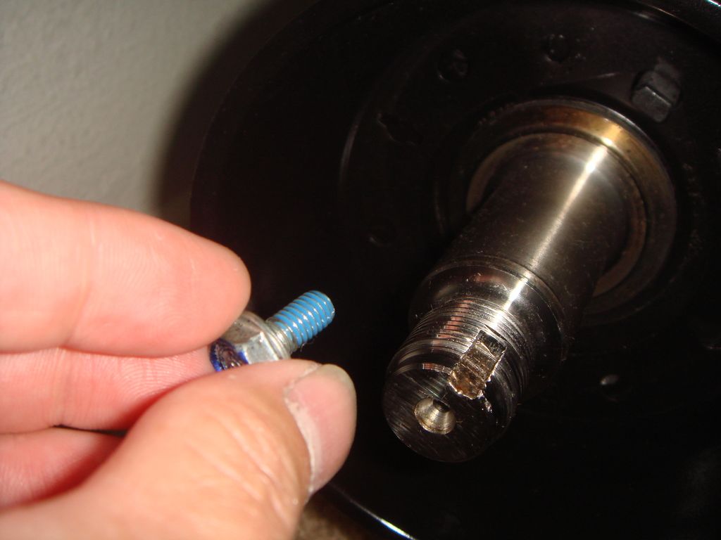

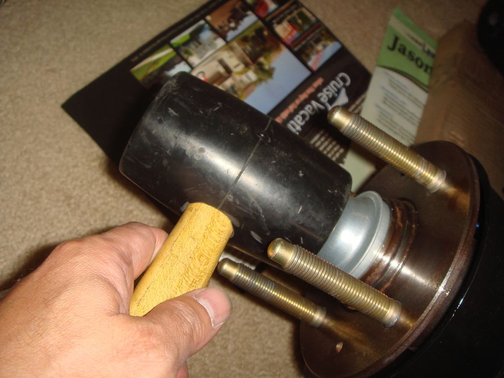

Install the Modified Splash Guard and tightening the bolt using Loctite
and Torque Wrench:
Insert the hub with the longer ARP stud (and stronger too ),
and tightening with Torque Wrench, after that lock it by
hammering with chisel and hammer:
Hammer in the Hub Caps:

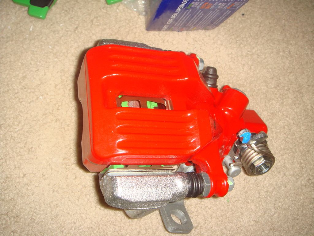

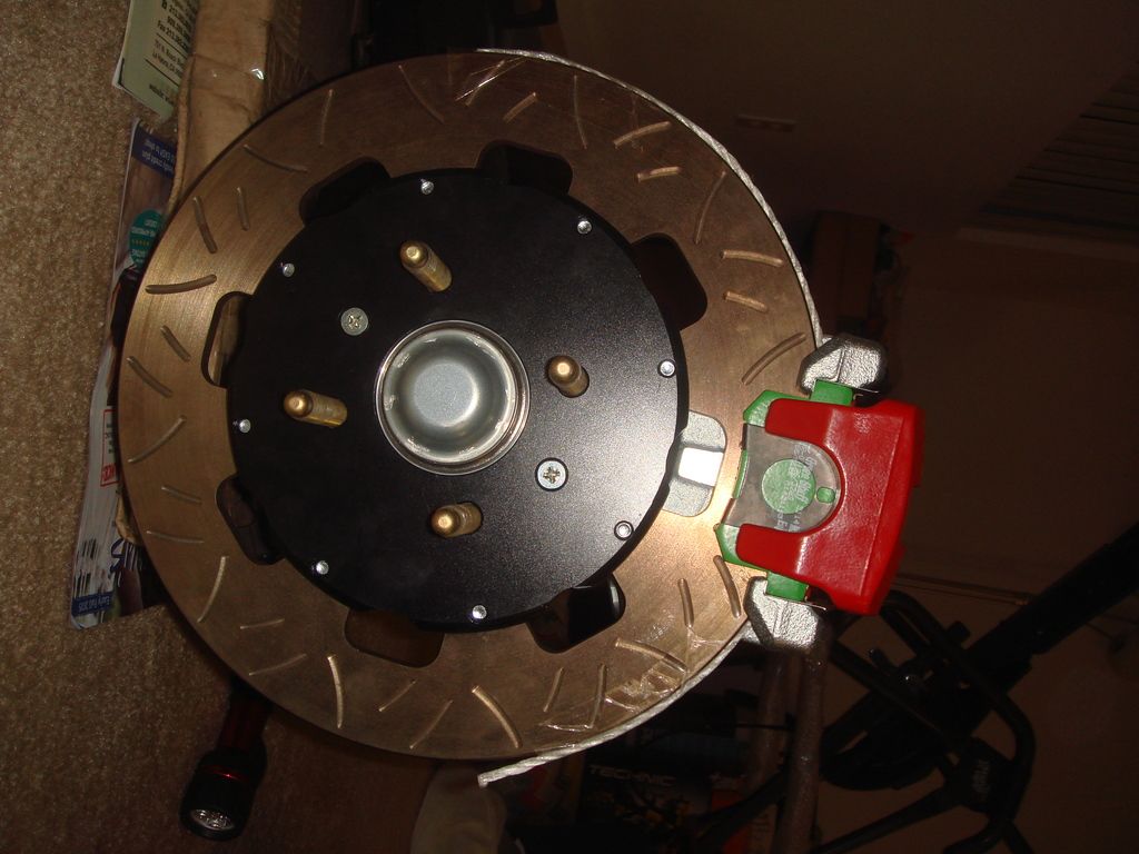

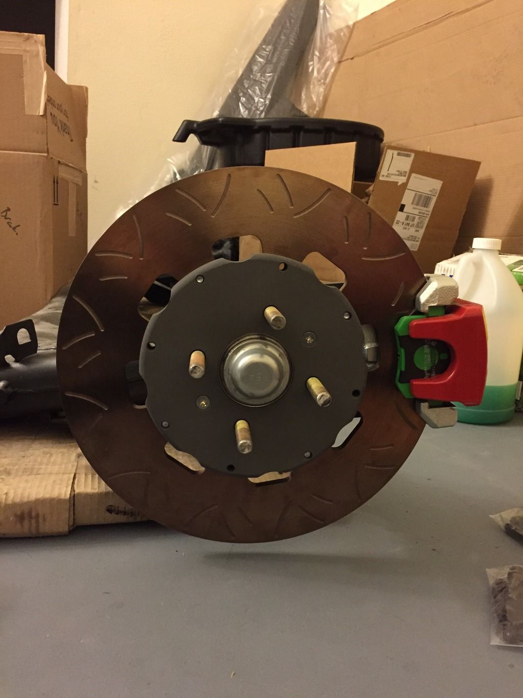

Assemble the rotor onto the Wilwood Hat for test fit of the
new JDM Integra DC5 Type R rear caliper:
Install the centering ring and the rotor/hat assembly to the hub:
Tighten the rotor screw:

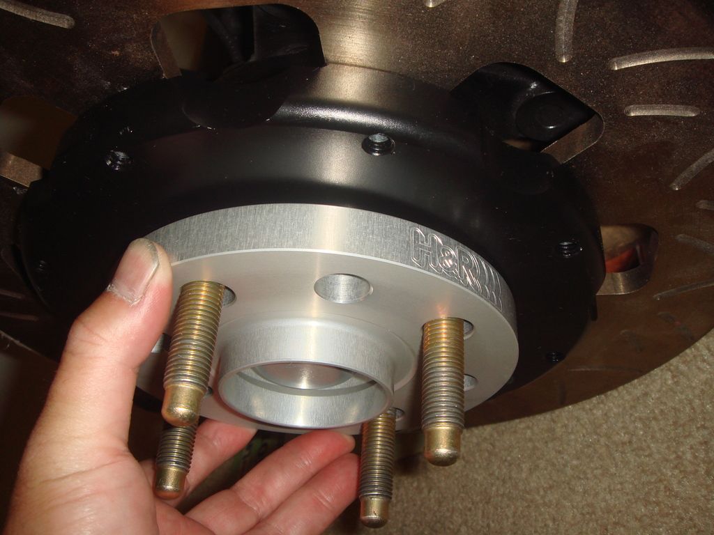

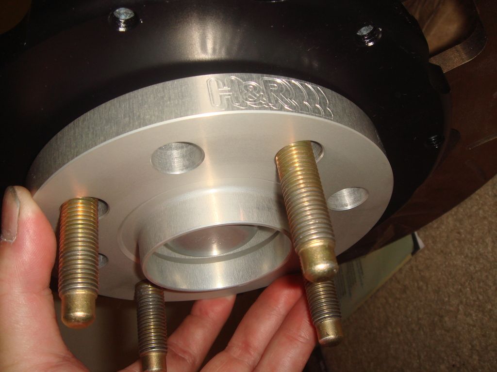

Test Fit the 15mm H&R Spacer that just arrived

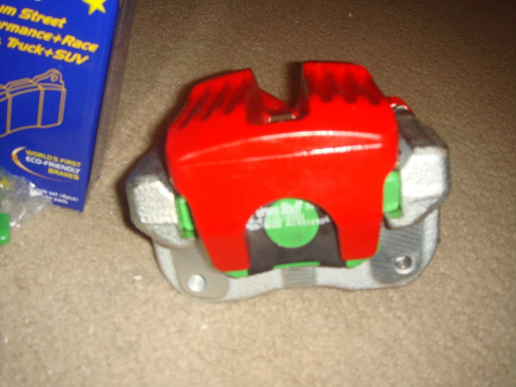

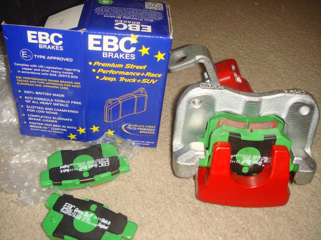

Install the EBC brake pads into the caliper:
Attached Thumbnails My JDM DISK BRAKE RS Rear Axle conversion-80-dsc09432_zpsyyorqkie_28551f6c09ff93bf02ddfc23711d8a76b25cba7d.jpg   My JDM DISK BRAKE RS Rear Axle conversion-80-dsc09433_zpsggdtrwmw_d0d87f8dc9e454093f1f0513a828144f855d85e7.jpg   My JDM DISK BRAKE RS Rear Axle conversion-80-dsc09434_zps525xw6q5_28437a9502e6840c0cd2b1861deadcc03c60fb9e.jpg   My JDM DISK BRAKE RS Rear Axle conversion-80-dsc09435_zpst7opquem_3c6eada42632c9c3148a40f466c9068c1e38d7e4.jpg   My JDM DISK BRAKE RS Rear Axle conversion-80-dsc09436_zpsrstwgpsq_fdec7d03d88a7603e1e574c67234221d237e34dd.jpg
My JDM DISK BRAKE RS Rear Axle conversion-80-dsc09437_zpsabxxeymi_ebcb09f588defc1149b893baac39e255e70de1c2.jpg   My JDM DISK BRAKE RS Rear Axle conversion-80-dsc09438_zpslajmmu01_fee5f8cfaf950b78aee6178517c7a91f15c5e249.jpg   My JDM DISK BRAKE RS Rear Axle conversion-80-dsc09439_zpsemvouwyl_6bc4b09083740330237aa4cc9bae6f5802e042a7.jpg   My JDM DISK BRAKE RS Rear Axle conversion-80-dsc09440_zpsr5olvoty_f14fa205d2bf1c165fef79cbdc527025e23a7805.jpg   My JDM DISK BRAKE RS Rear Axle conversion-80-dsc09441_zpsobzrvr8p_3c1b67429f4b326e5775ed4403d457a5eca8a190.jpg
My JDM DISK BRAKE RS Rear Axle conversion-80-dsc09442_zpsrq4jyzo2_3e73b66af879aa4e56ca700d7ff1a672ff93e21f.jpg
Old Oct 21, 2015 | 03:51 AM
  #304
BMW ALPINA's Avatar
Joined: Jan 2013
Posts: 2,449

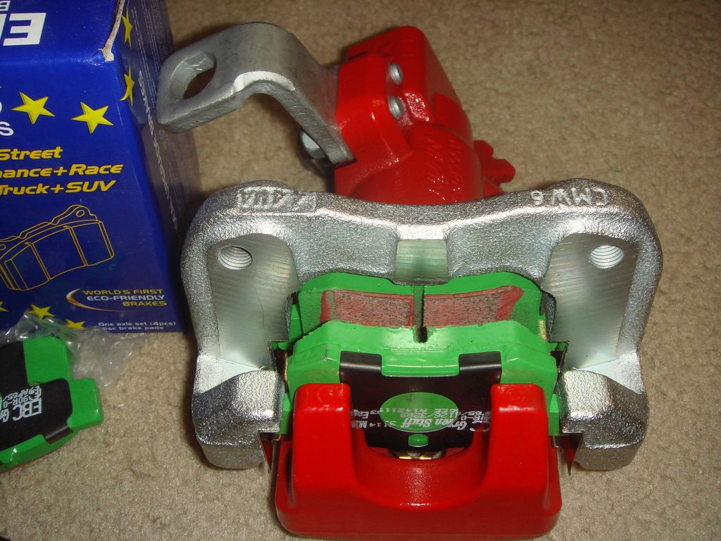

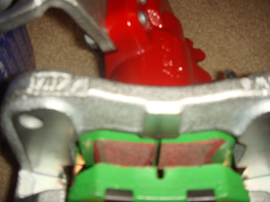

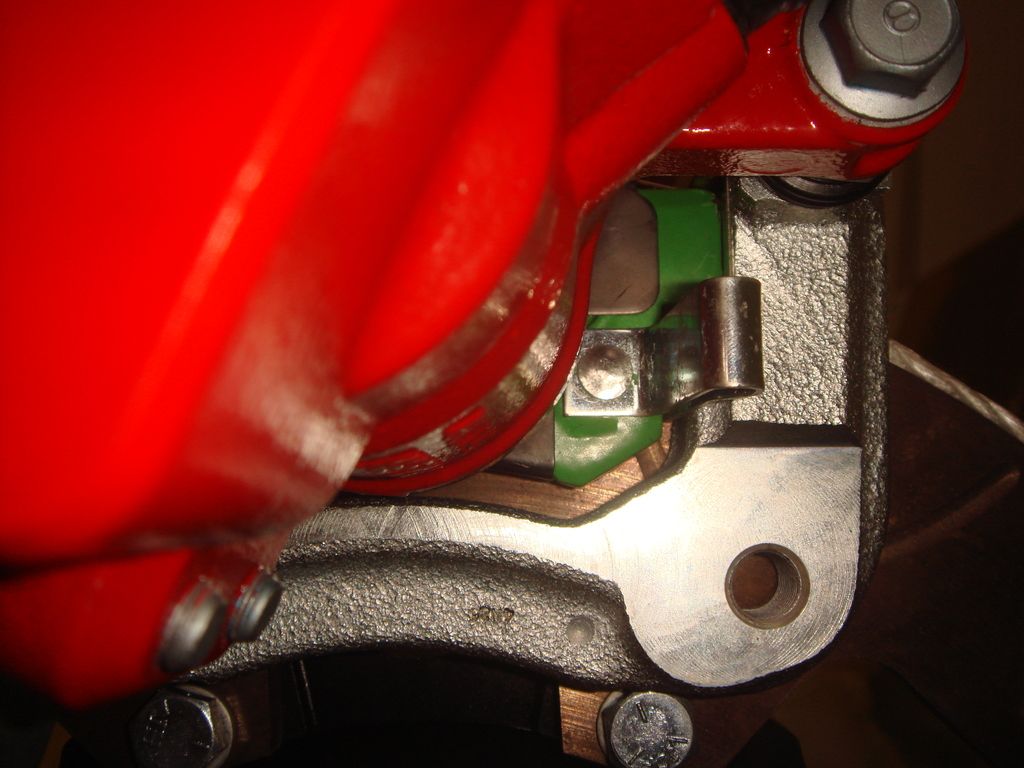

Test fit the whole caliper assembly onto the rotor
and found problem with fitting...
the Caliper Bracket is too long so
the pads do not properly cover all the rotor,
and the bracket hit the rotor/hat bolt.......
Looks like I need to get Integra GSR Rotor and New Brake Pads too...
oh well... more stuff to buy ...

The Integra GSR Caliper Bracket do NOT fit at all with this JDM Brake Caliper,...
perhaps because this JDM Brake Integra Type R caliper is bigger in housing size compare to the USDM Integra Type R caliper, so I return the Integra GSR caliper bracket and brake pad to Amazon...
I figure the solution for this is to force fit the current JDM Brake Caliper/Bracket
which mean only about 70% of the pads will touch the brake disk rotor,
and as soon as this custom brake disk rotor run out,
I will order an even larger custom brake disk rotor that will then fit perfectly...
and I think will look even better since it will be a bigger rotor too...
well, I just finished with measuring the custom brake caliper "extra" bracket
and ordering it,
if somehow after I install I feel the brake is not working properly,then
I can just throw away this current custom rotor and upgrade to the larger custom
rotor by then...

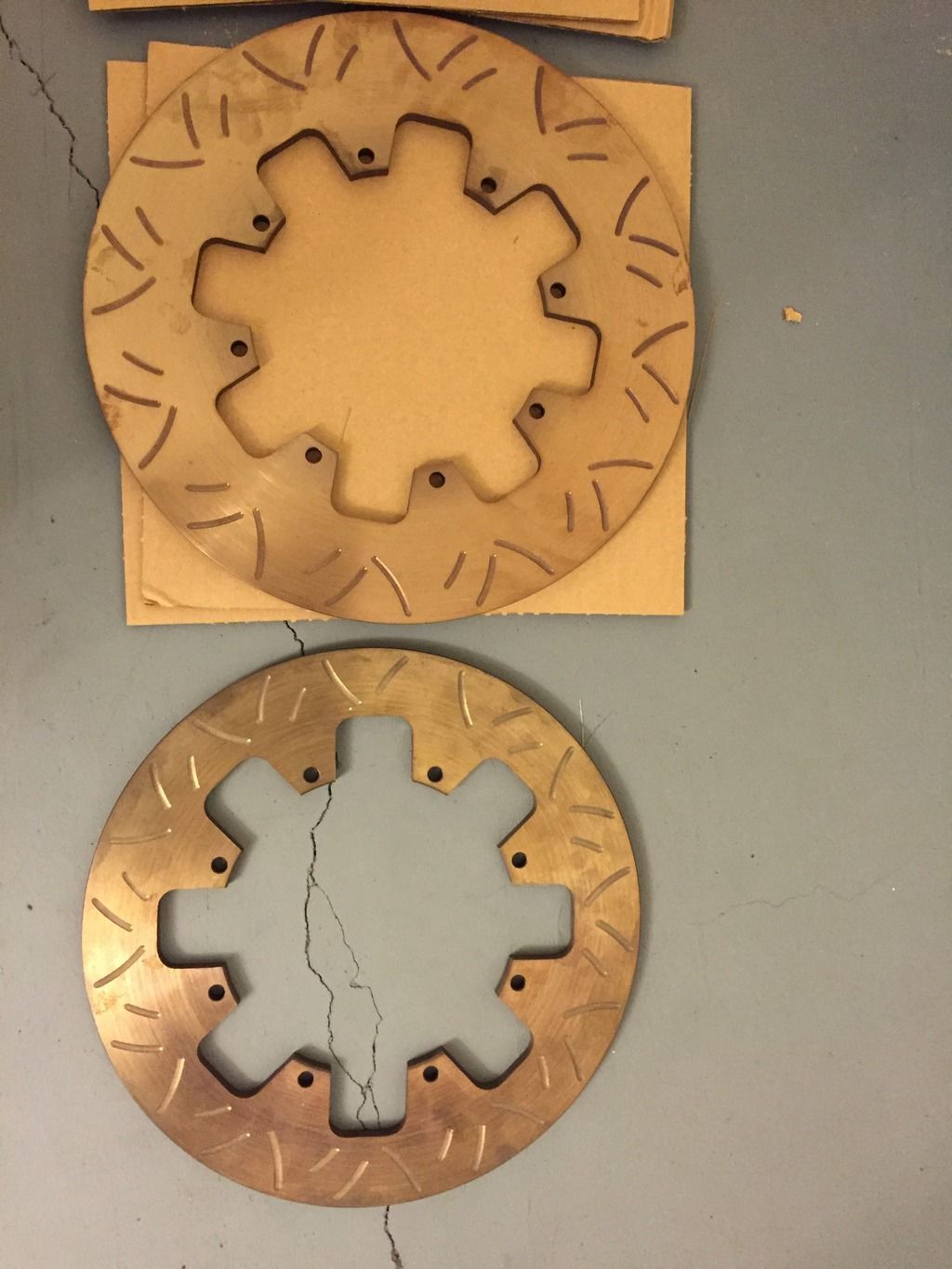

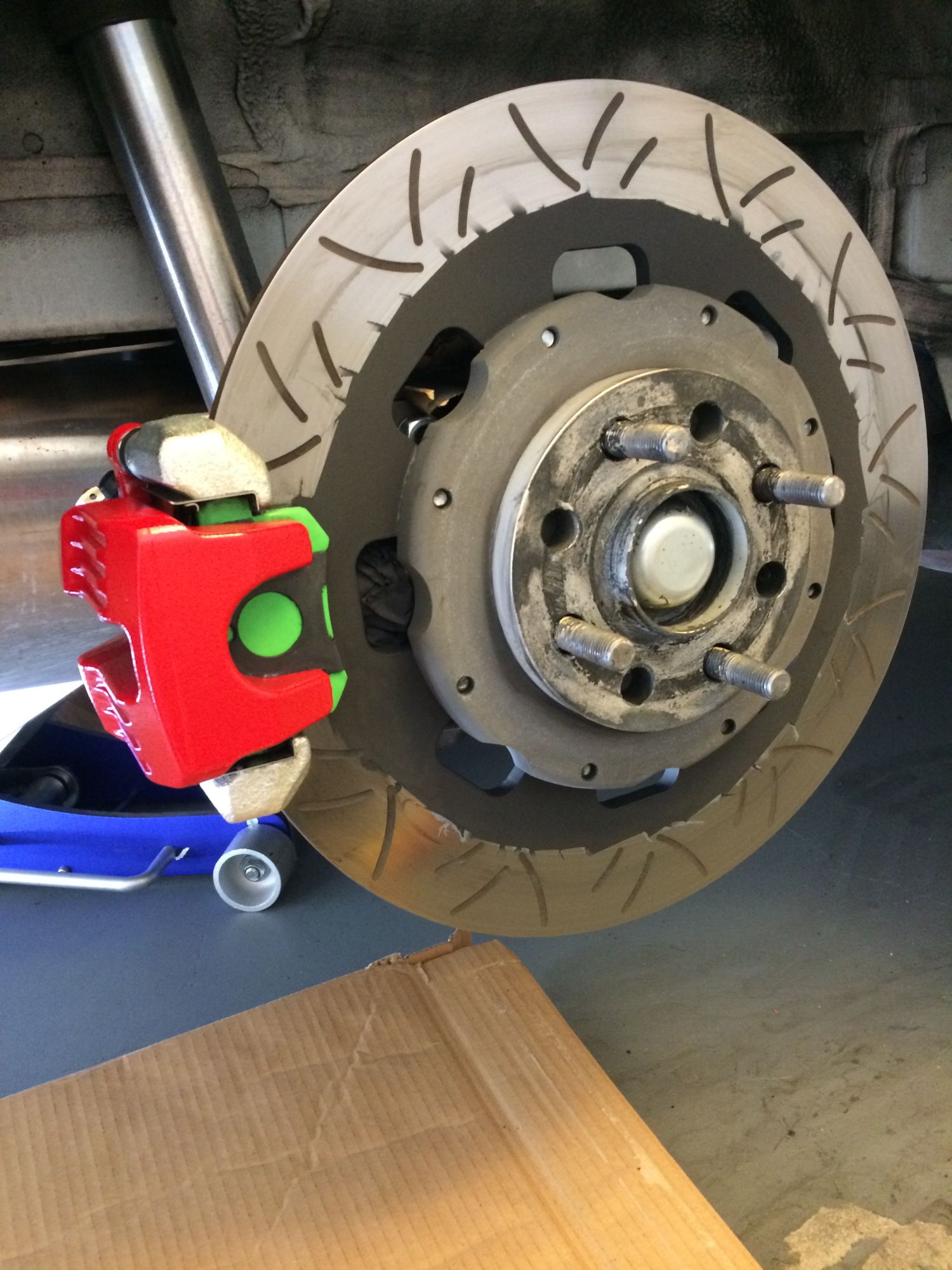

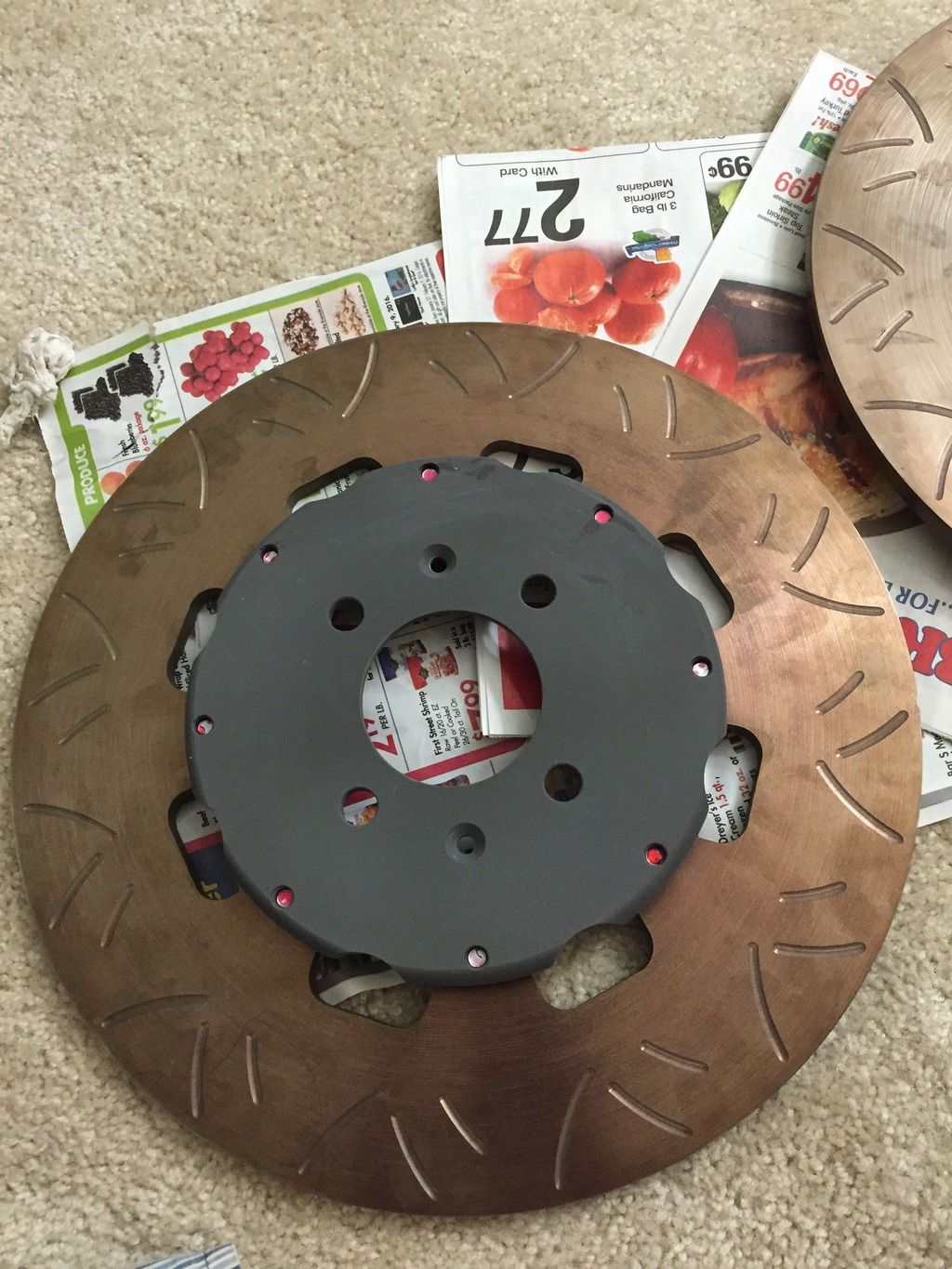

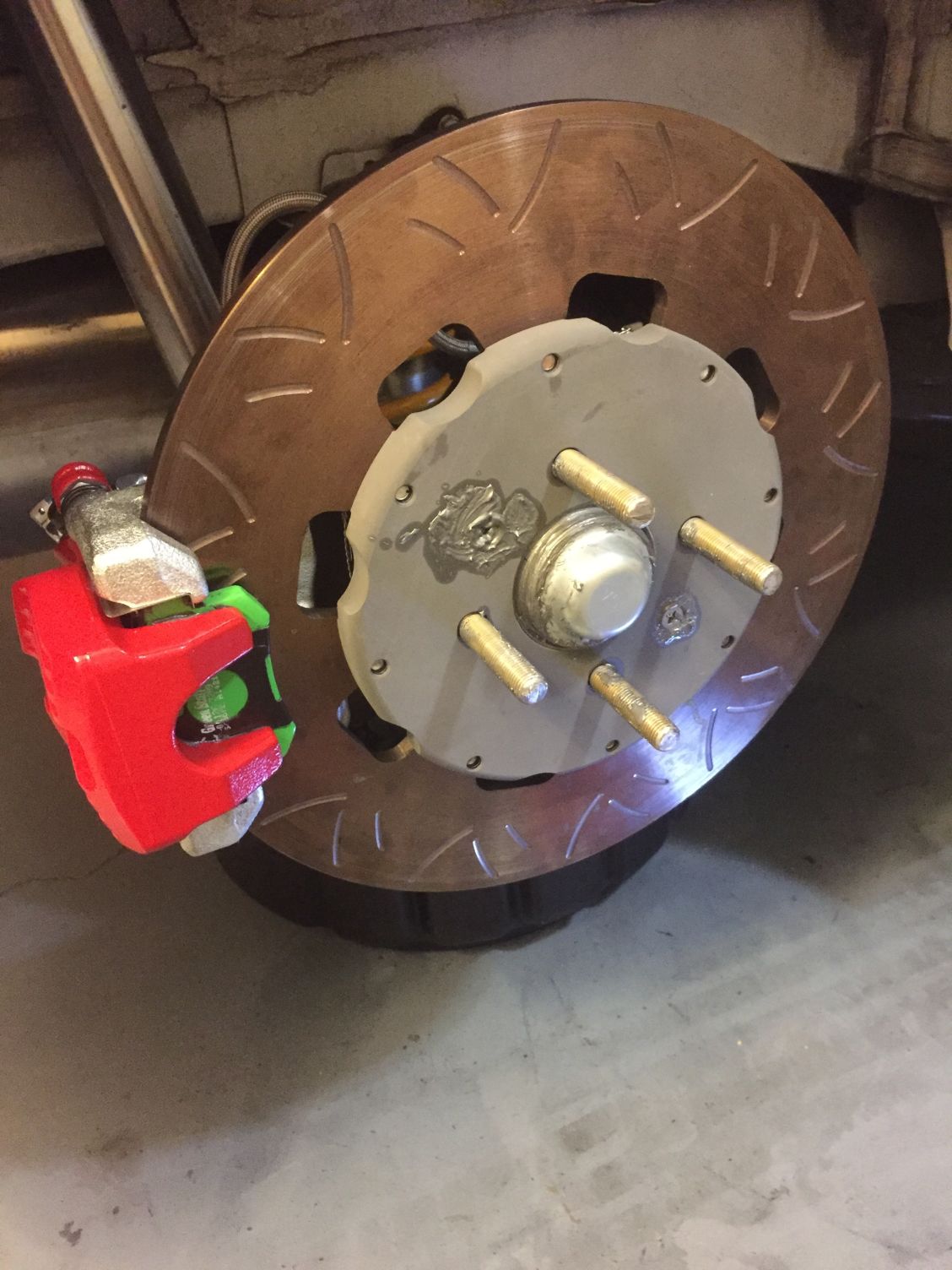

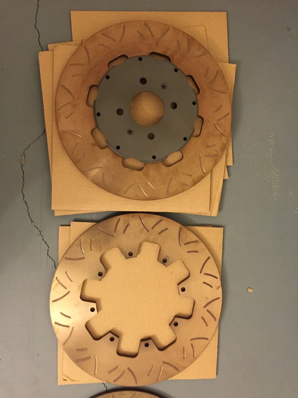

My New LARGER Custom Rear Disc Brake Rotor by Coleman Racing finally arrived today.
It is now 13in in diameter, so not only the brake pads will have full swept area,
it will also look more balance with my 355mm Brembo Front rotor.
This is the last part that I need to install my JDM RS Rear Axle conversion,
Hopefully I can finish the conversion this weekend
The pictures below will show the comparison between my older smaller rotor to this new larger one:

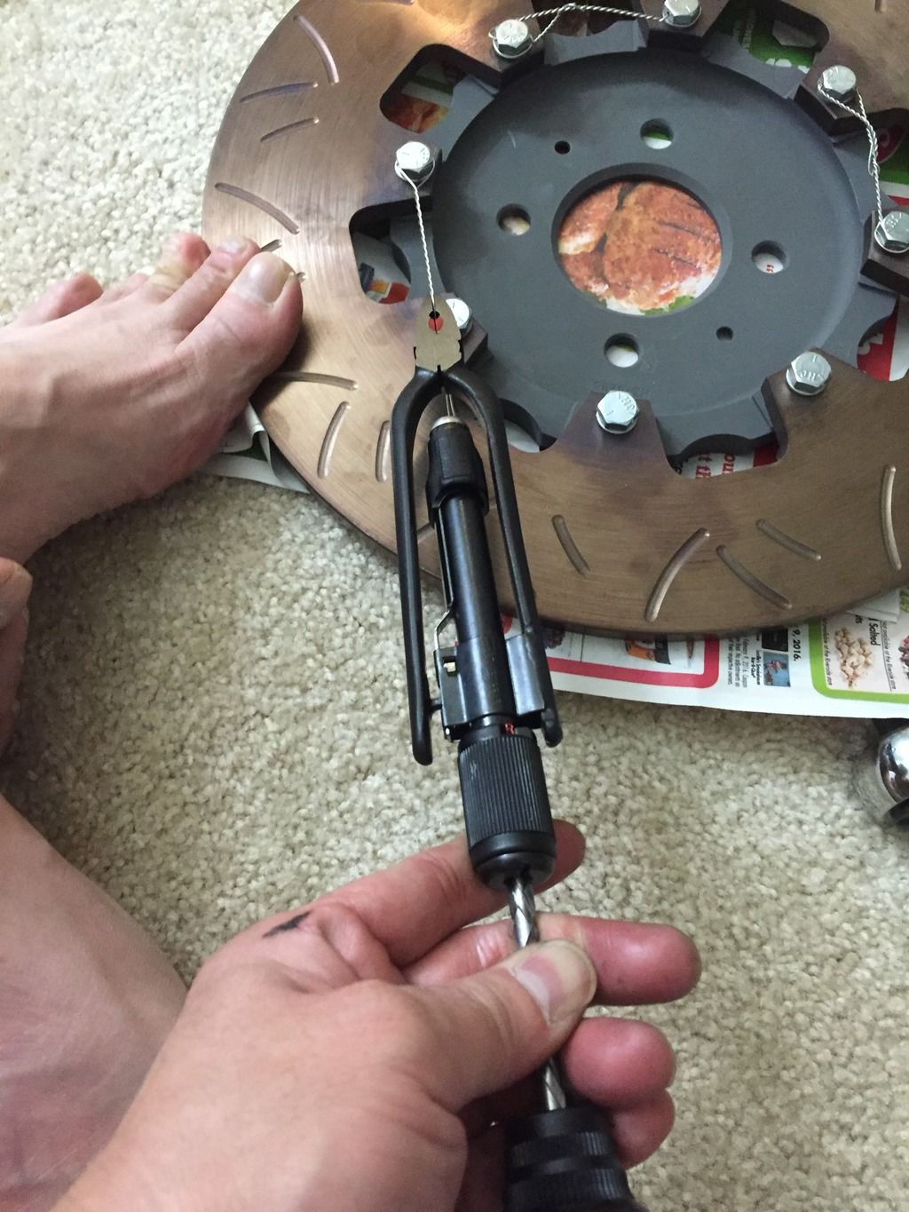

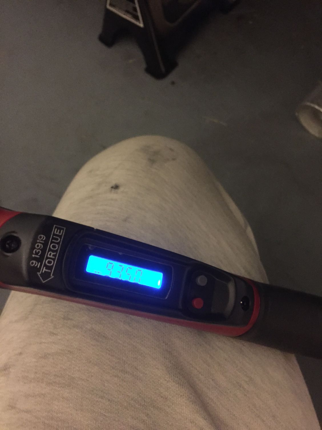

I haven't had time to install everything,
but I manage to make progress:

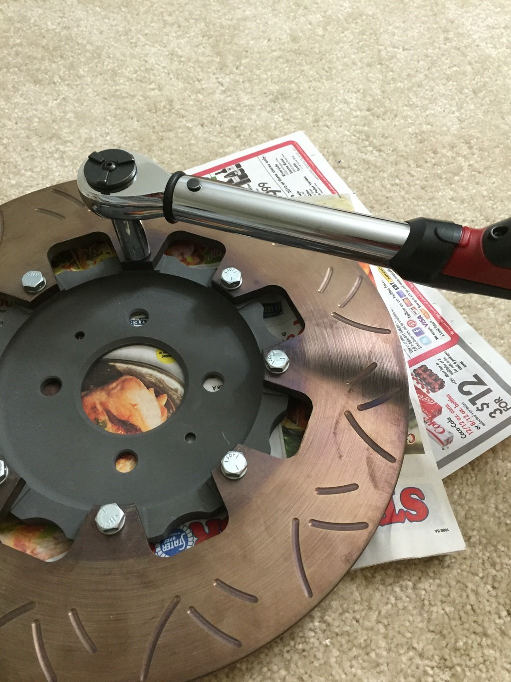

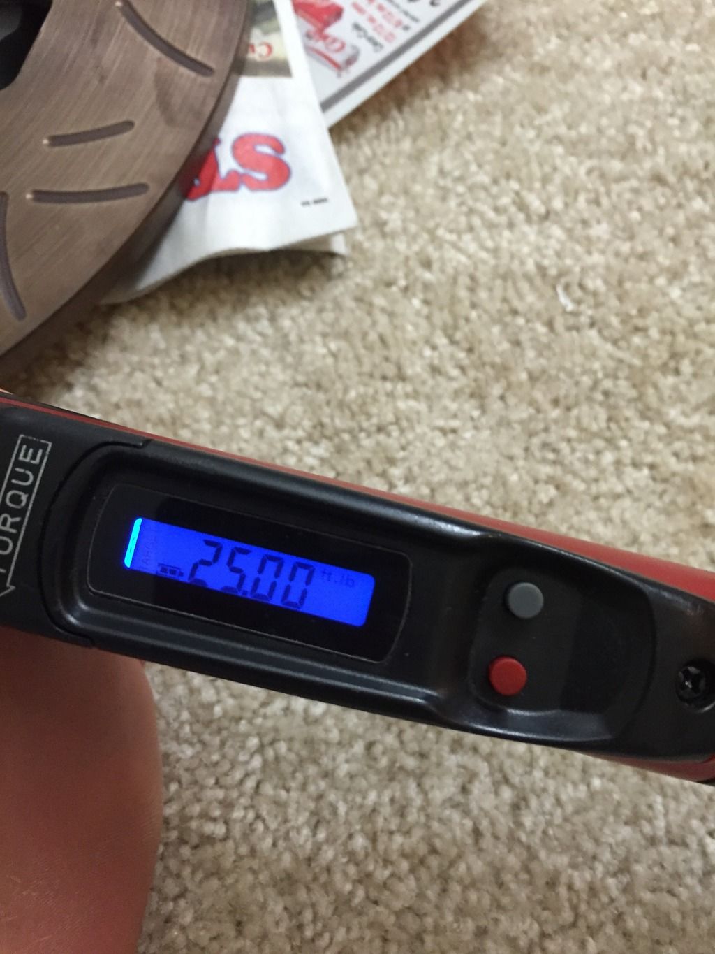

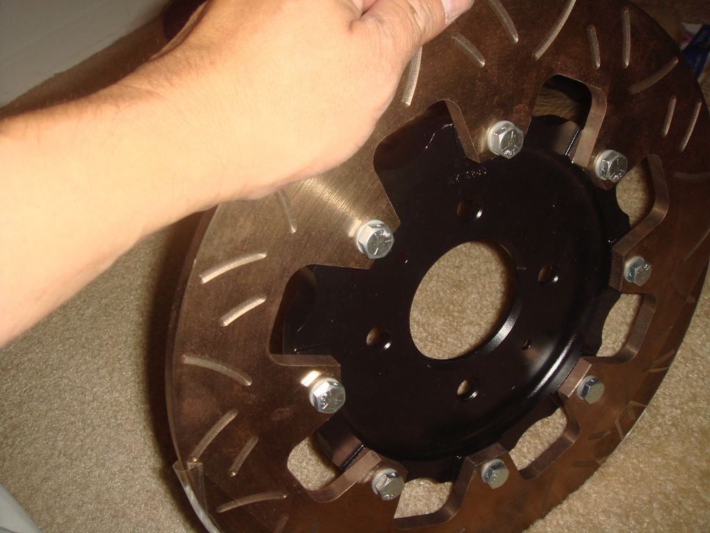

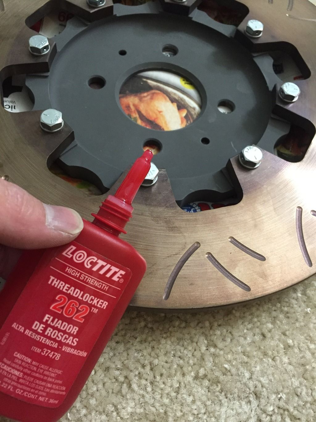

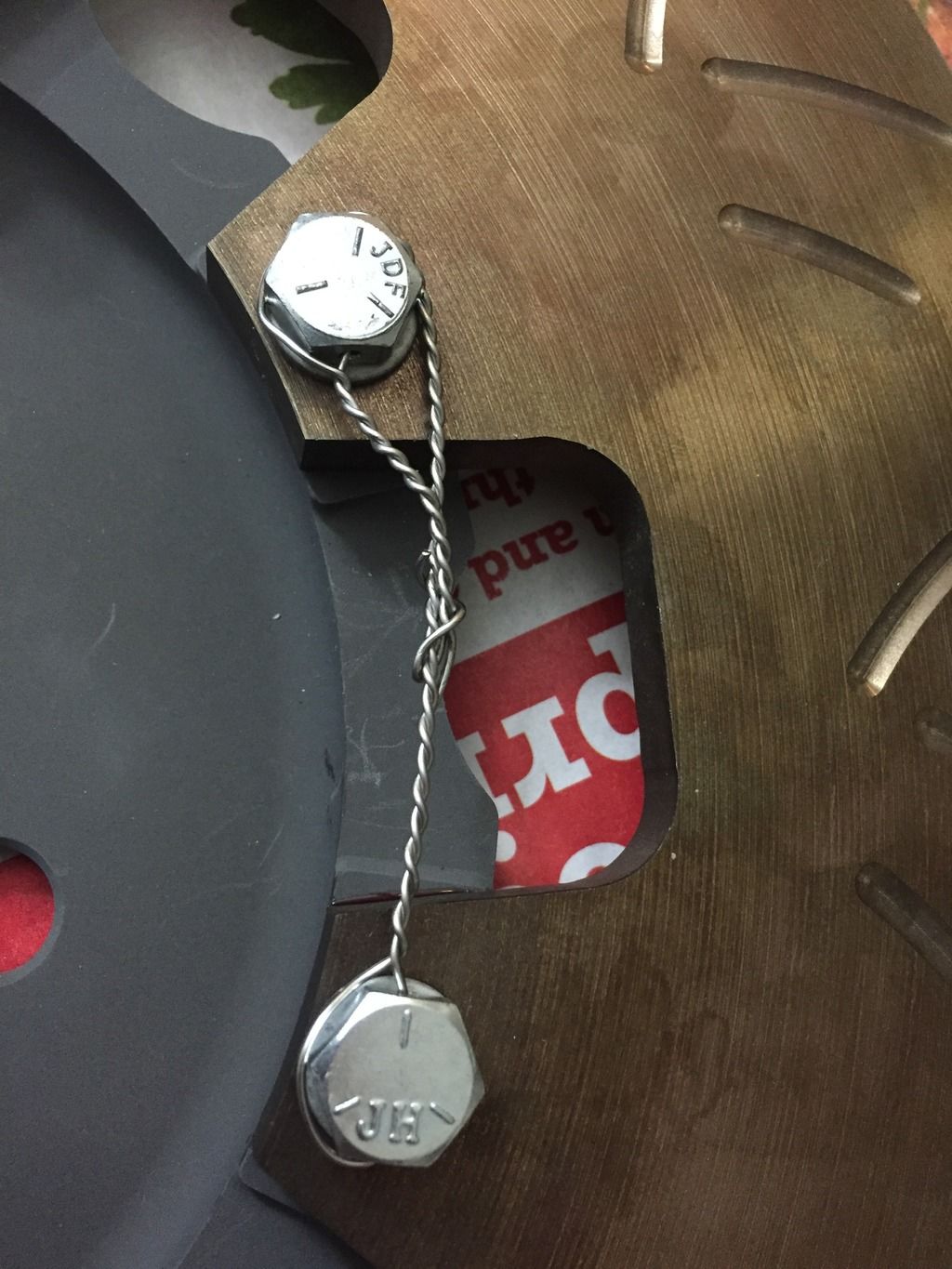

I install the new larger disc rotor to the Wilwood hat.
I use torque wrench at 25lb-ft as advise by Wilwood,
Use high strength RED Loctite,
and then use the safety wire with the tools to spin the wire.
here are the pictures:

Test Fit:

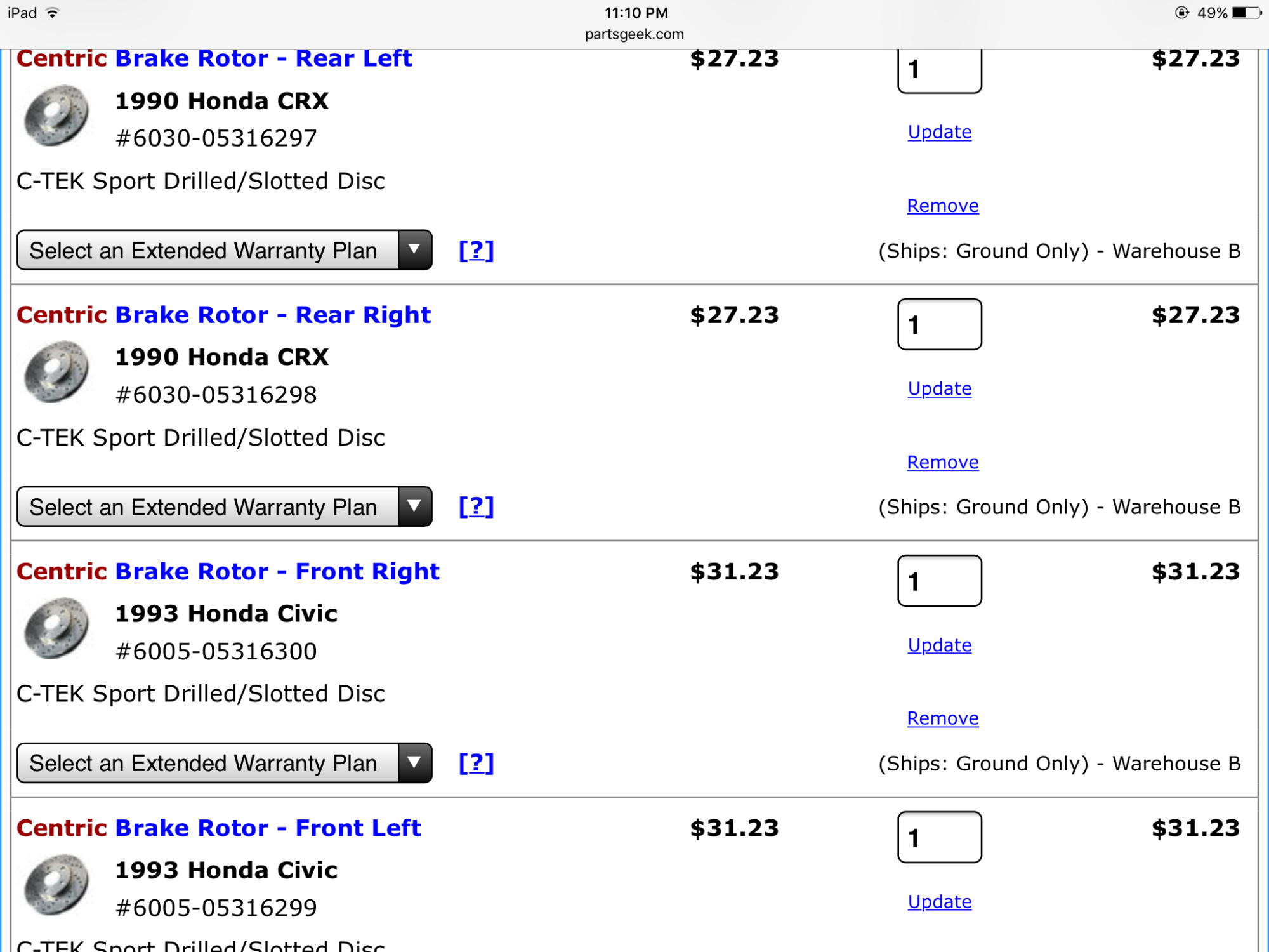

Thank a lot! I will purchase 1993 Honda Civic front rotors 4x100 and 1990 crx rear rotors hopefully they work as the specs are very close if not the same of the project mu front and rear rotors for jdm ge8
I'll try..thanks again!

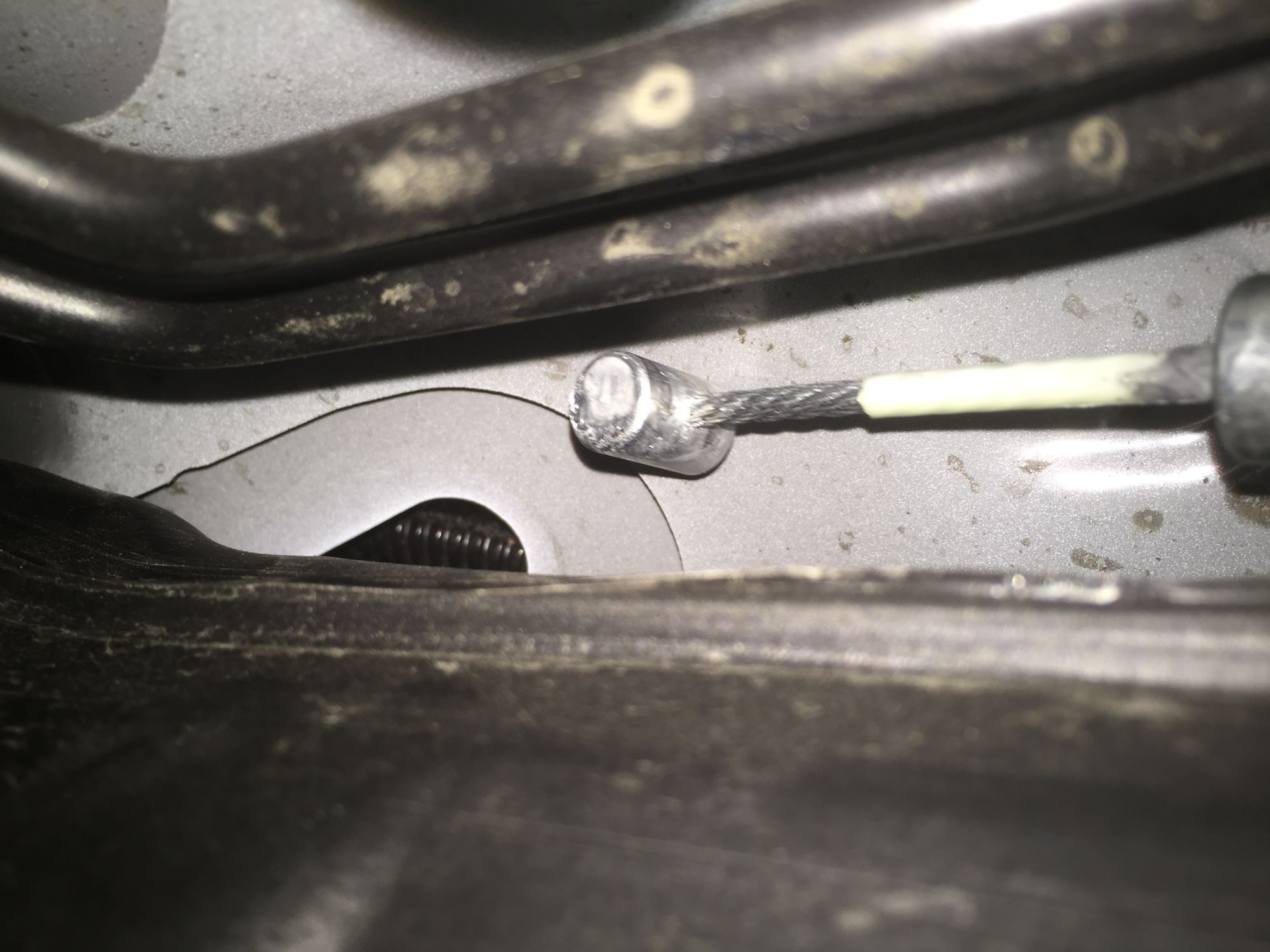

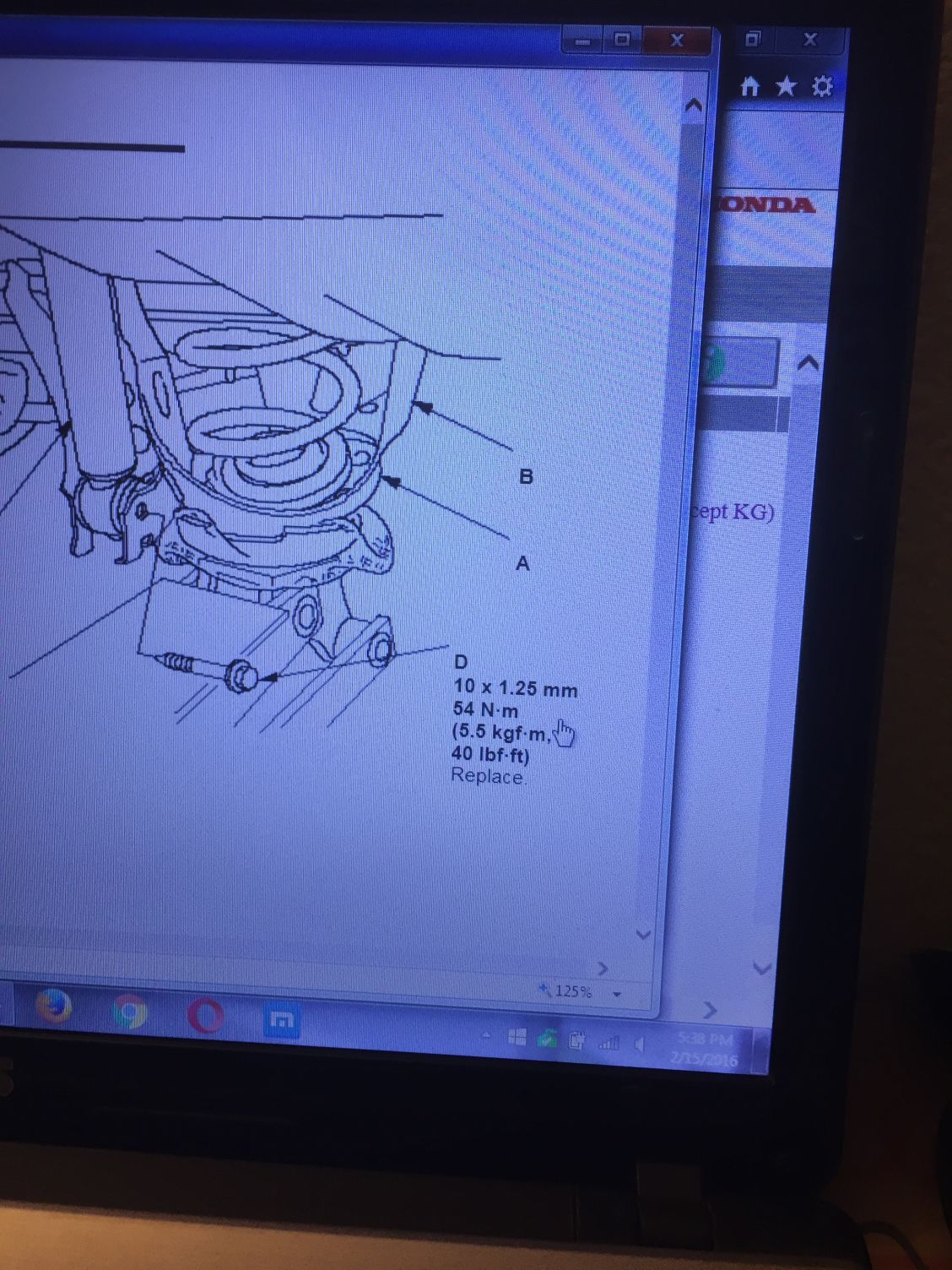

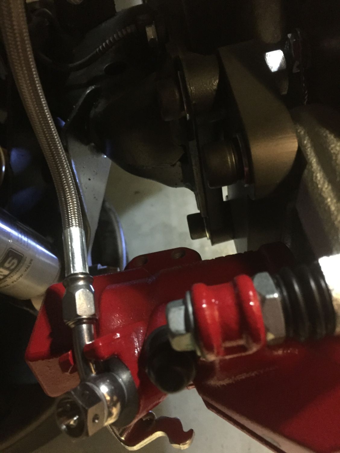

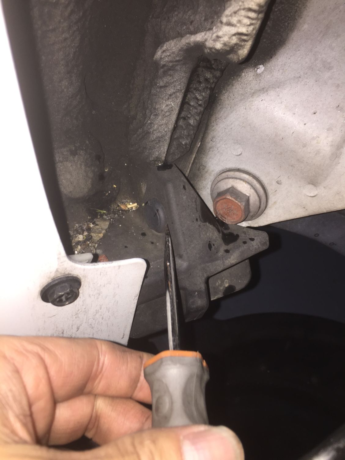

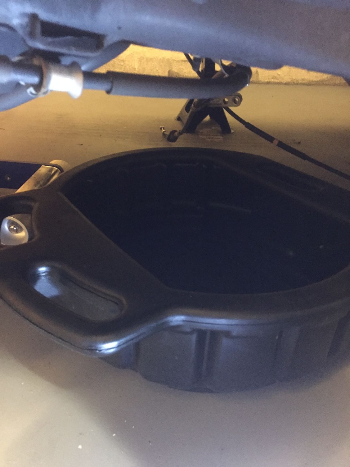

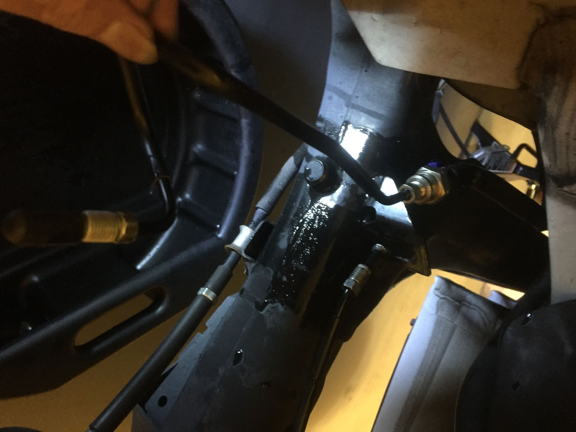

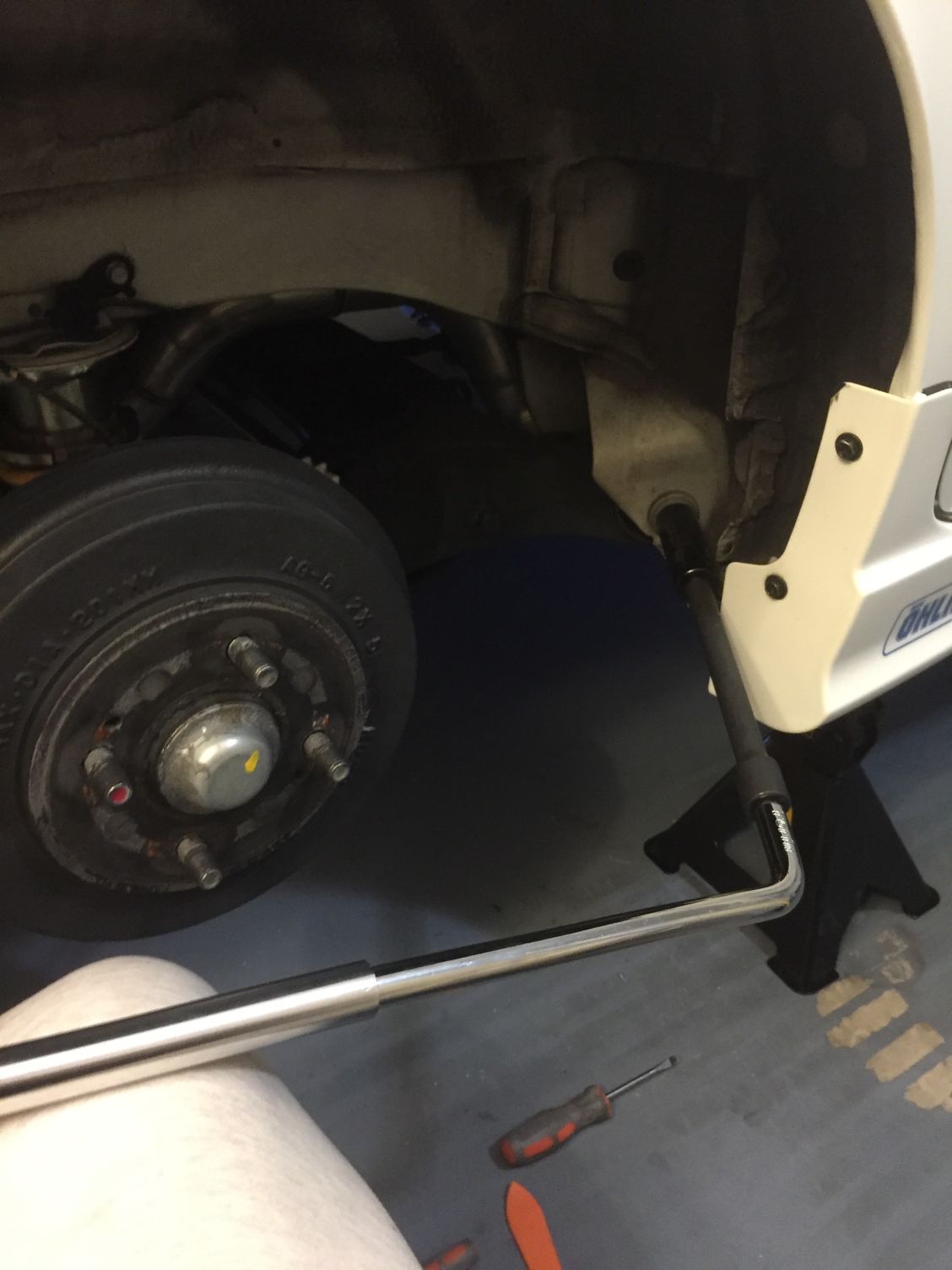

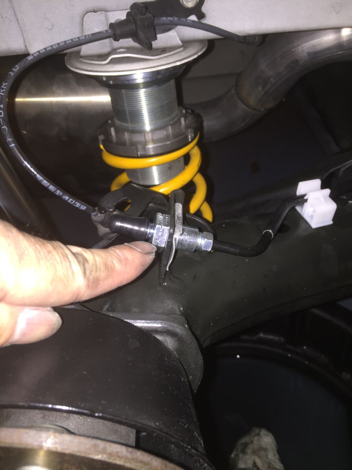

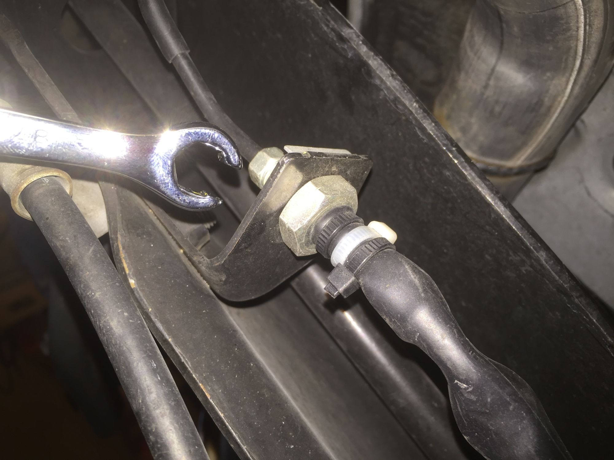

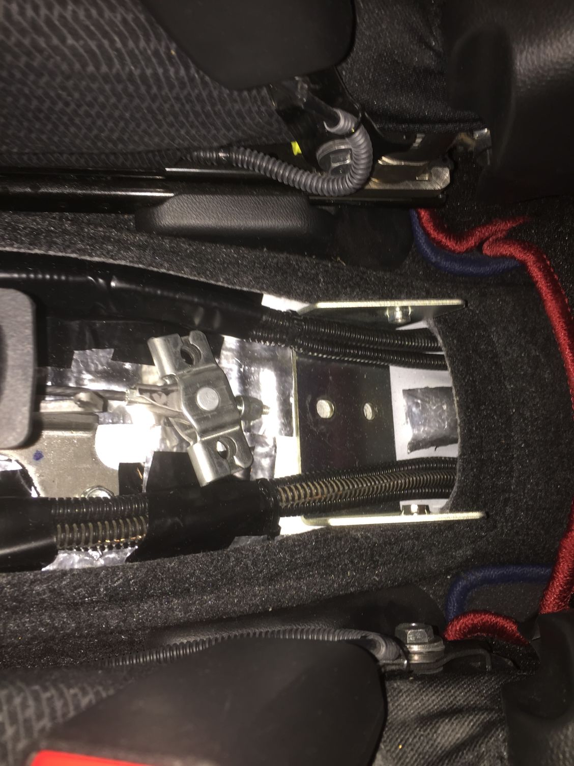

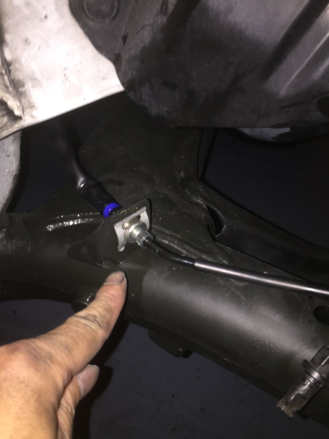

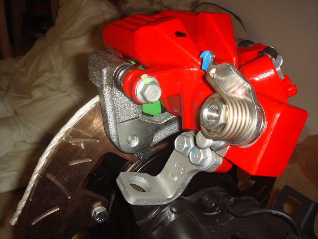

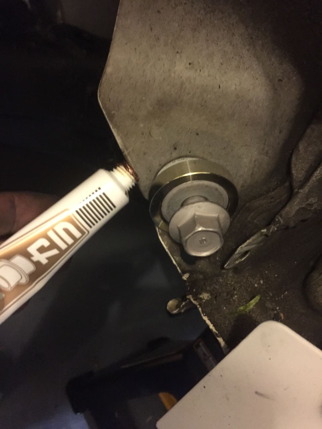

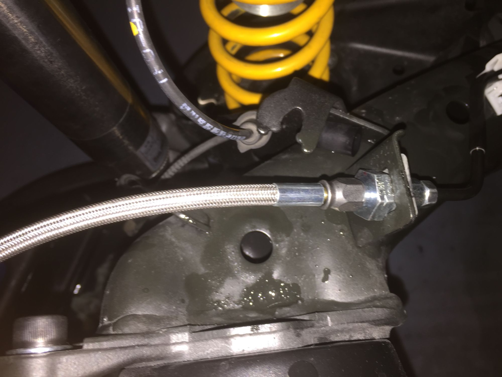

Take out the center console and remove the bolt holding the parking brake cable and
release the parking brake cable from the puller mechanism, then pull it from under the car

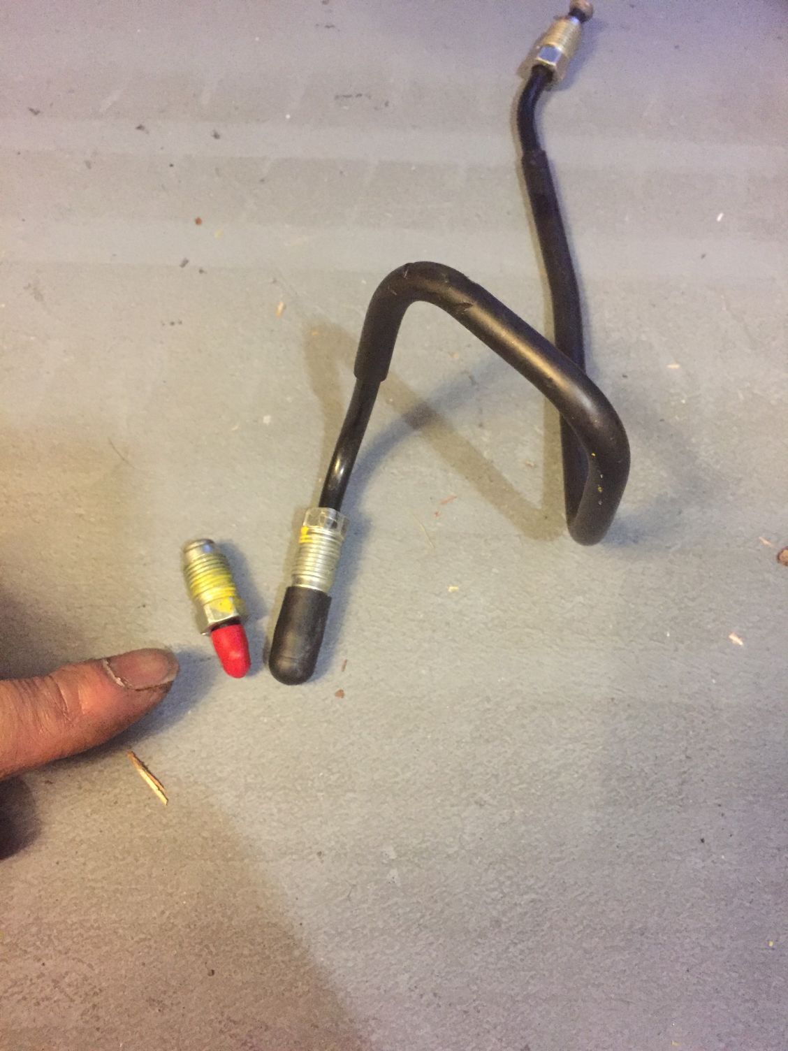

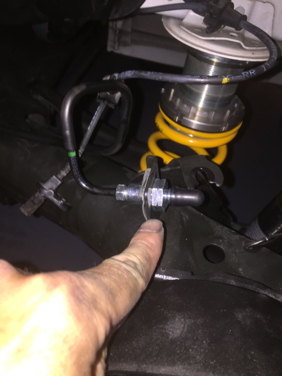

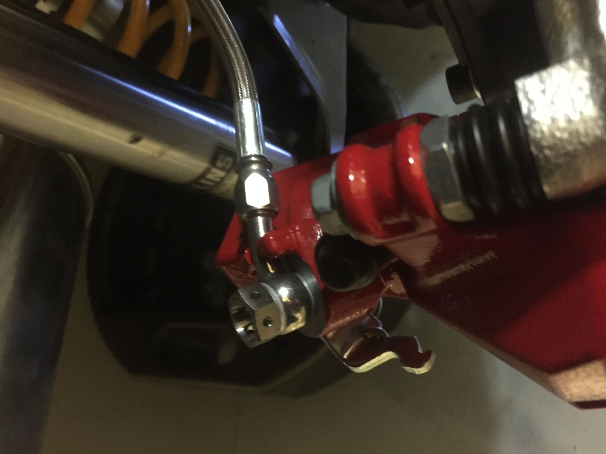

Prepare a pan to catch the dripping brake fluid then remove the brake pipe from the brake hose:
Remove the plastic clip and then remove the main bolt holding the rear axle,

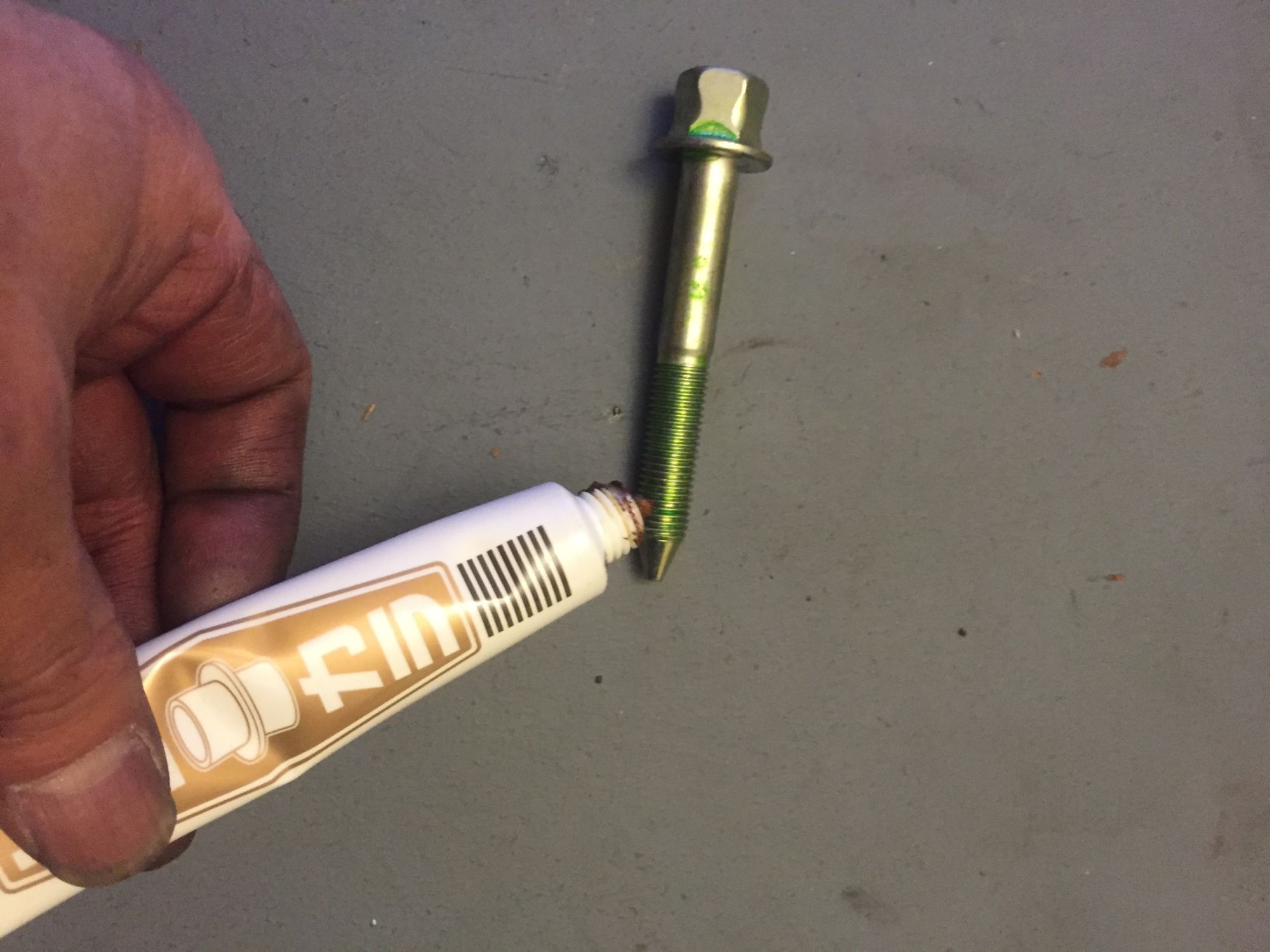

then lower the rear axle, after that then remove the two bolt connecting the rear axle to the rear shocks and the rear axle is now free.
install the new axle back and put some grease on the bolt then attached the spoon rigid collar and tighten it to 93nm:
Install back the Progress rear sway bar and tighten it according to Progress manual:
Tighten the bolt to the shock absorber:
Connect all the brake pipe and hoses:

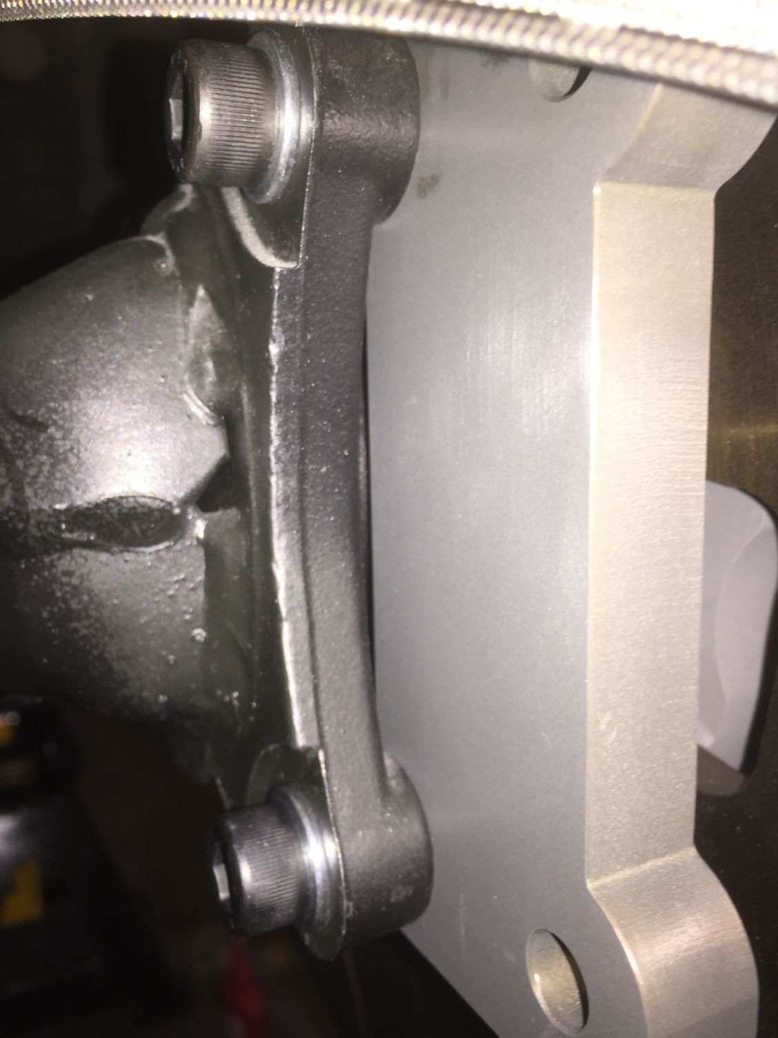

Install the bracket, tighten the bolt that hold the bracket to the axle to 68nm
and tighten the bolt that hold the caliper to the bracket 58nm,

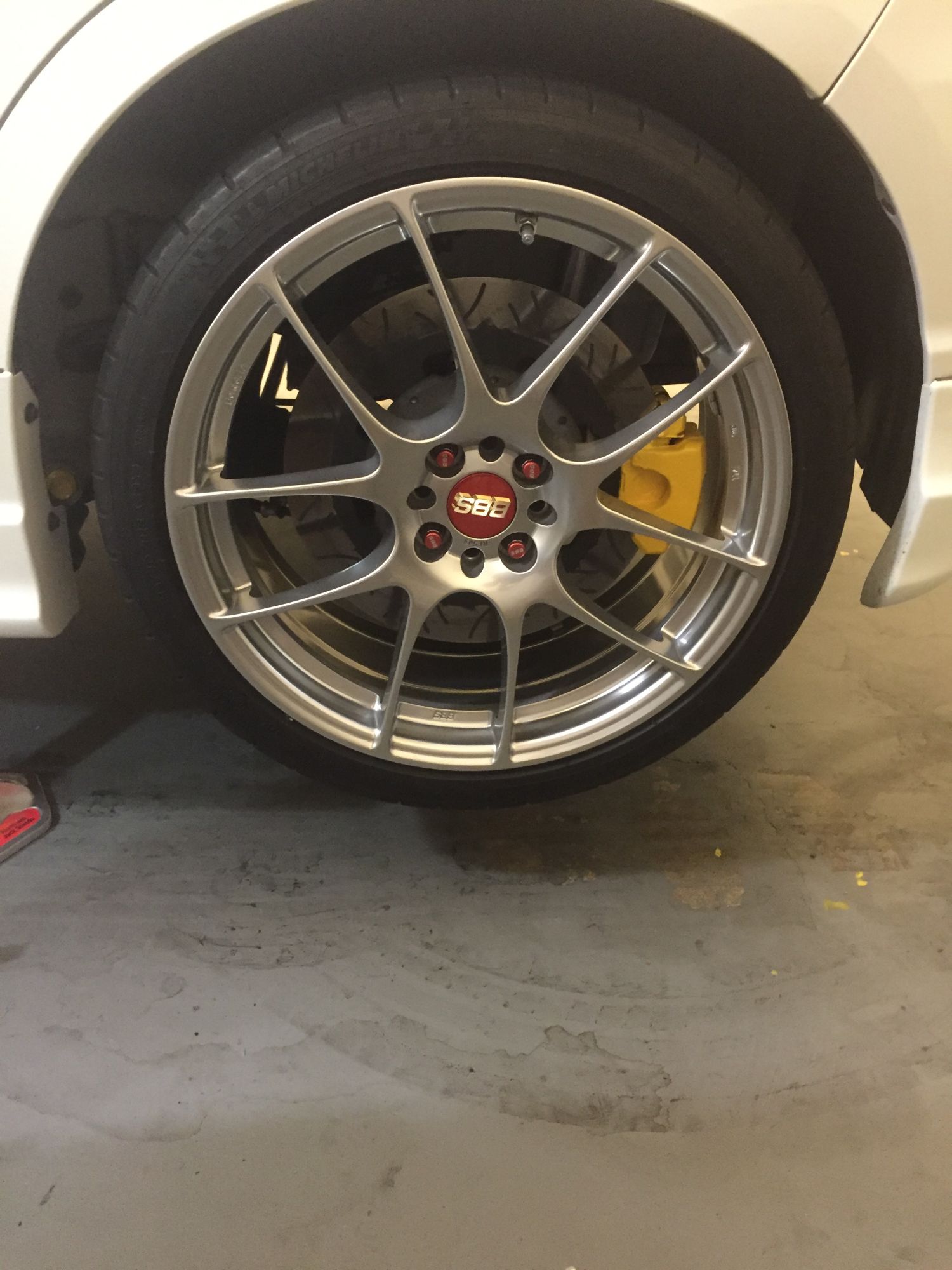

install the rotor and hat assy:
Install the 15mm spacer and the wheel,...
and the pictures after it is finished:

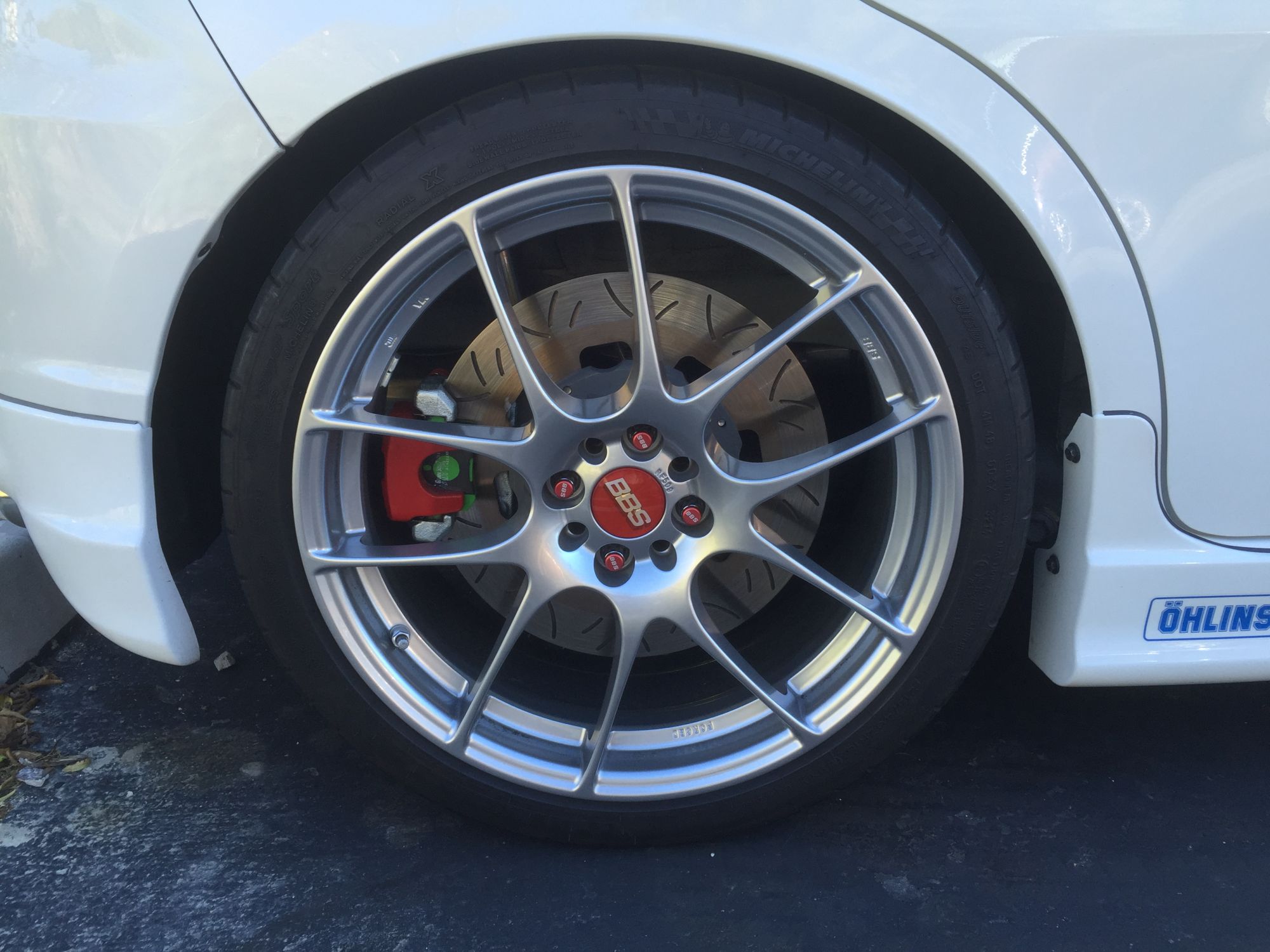

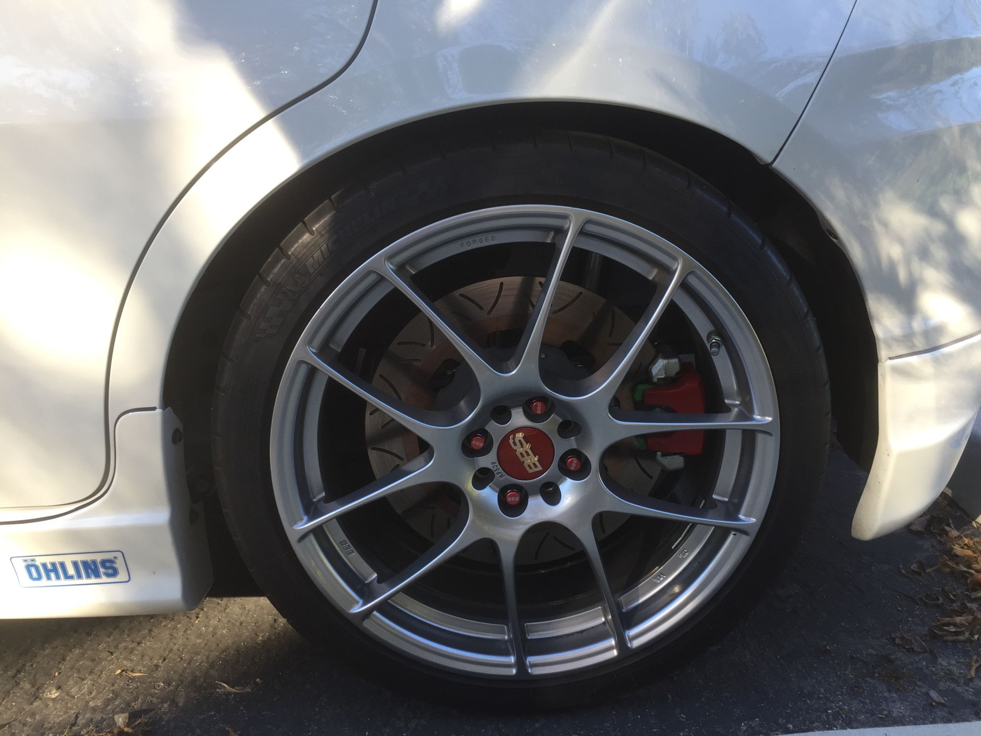

So with the pictures above,
I finally closed my journey from April 2013
The car now more stable,
due to wider stance from the spacer (15mm spacer),
The Spoon Rigid Collar and the filled bushing reduce the bushing side to side flex,
so the rear axle tracked more true...
The brake are easier to modulate
LESS NOSE DIVE under braking due to better rear brake bias,
which make the car stop faster because the ABS do not activate too early,
and the rear also do more braking than with the drum brakes,
Pedal feel also much improved...
and I think My JDM RS Rear Axle with aluminum caliper from DC5 Integra type R
with 2 piece rotor (wilwood aluminum hat combo) are actually lighter than the USDM drum brakes one...
I am happy to finally close the chapter on this modification with good result

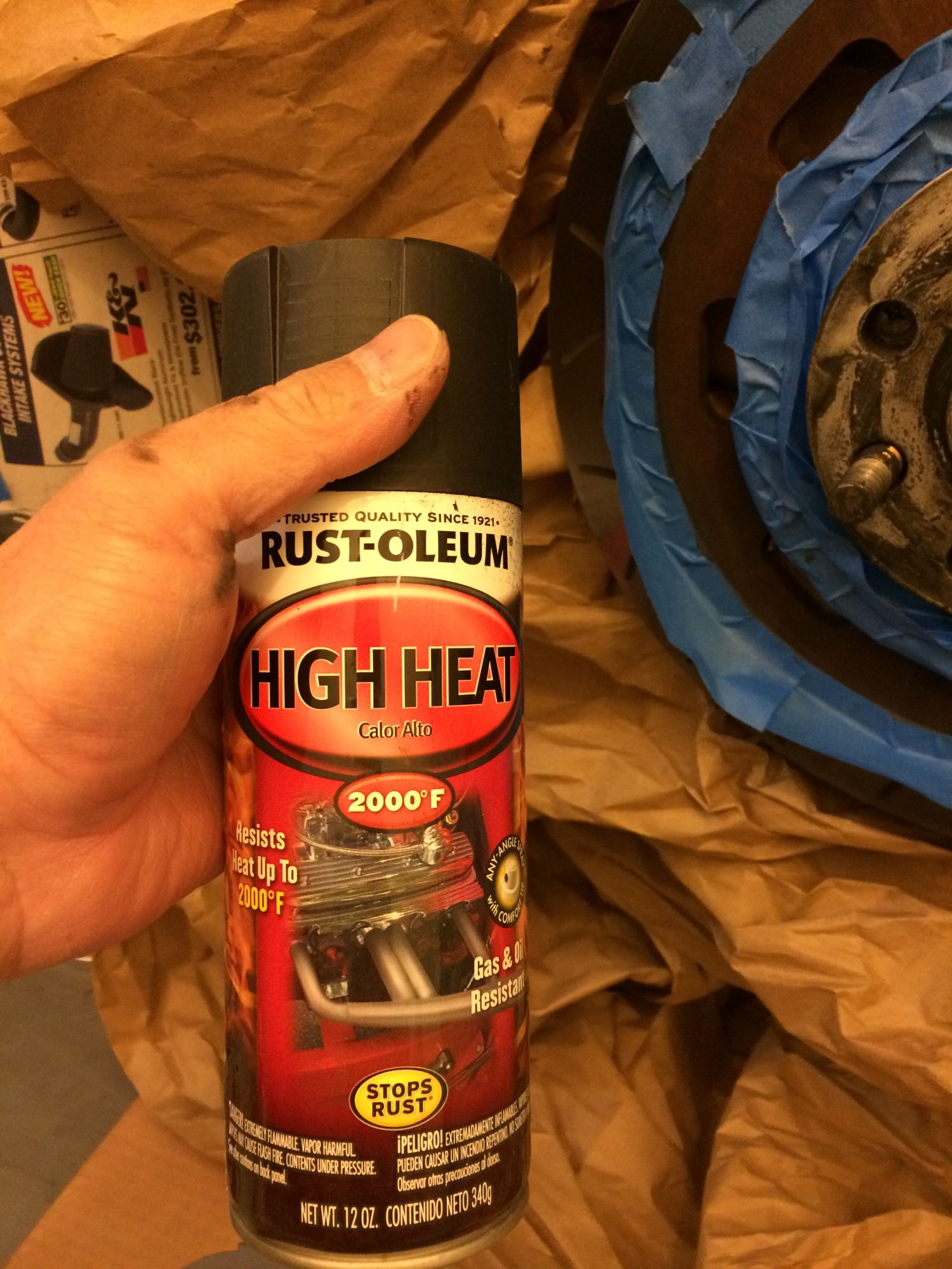

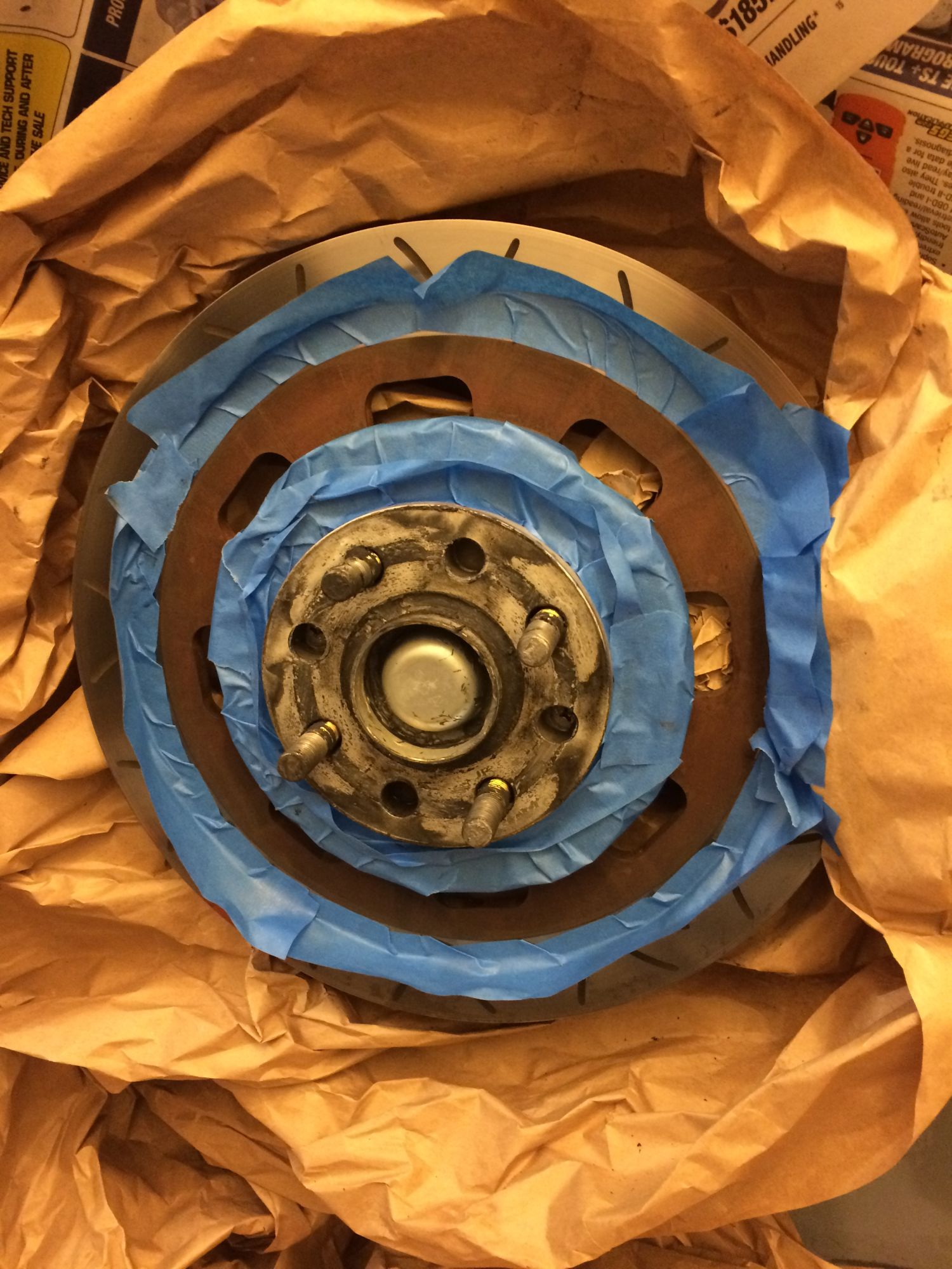

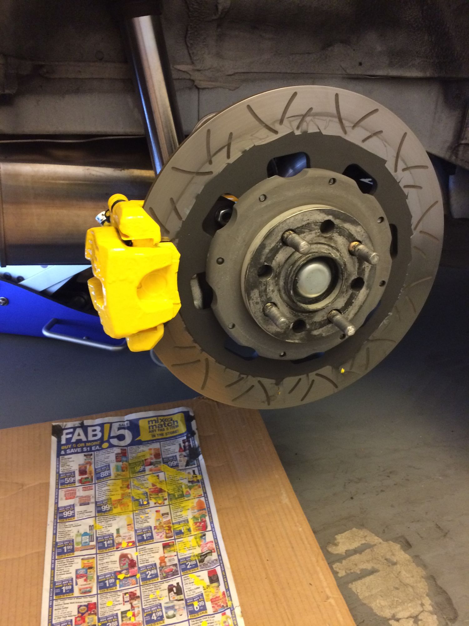

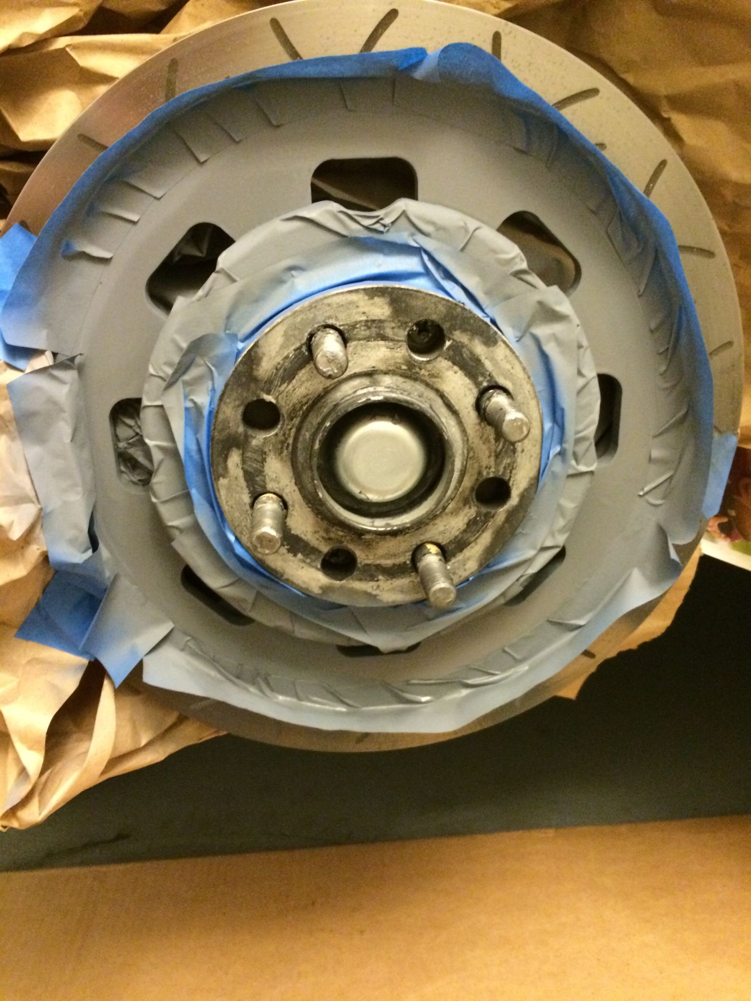

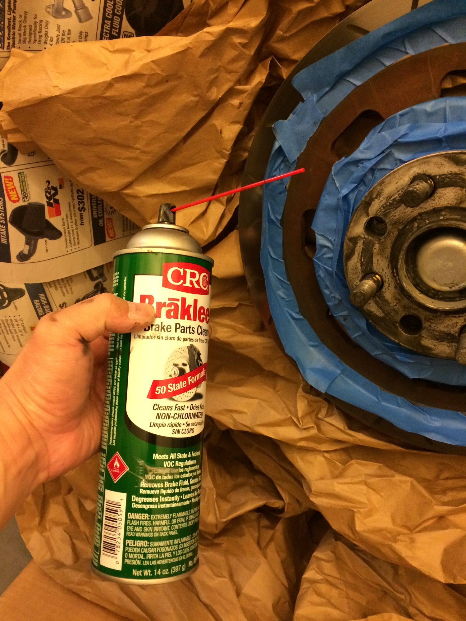

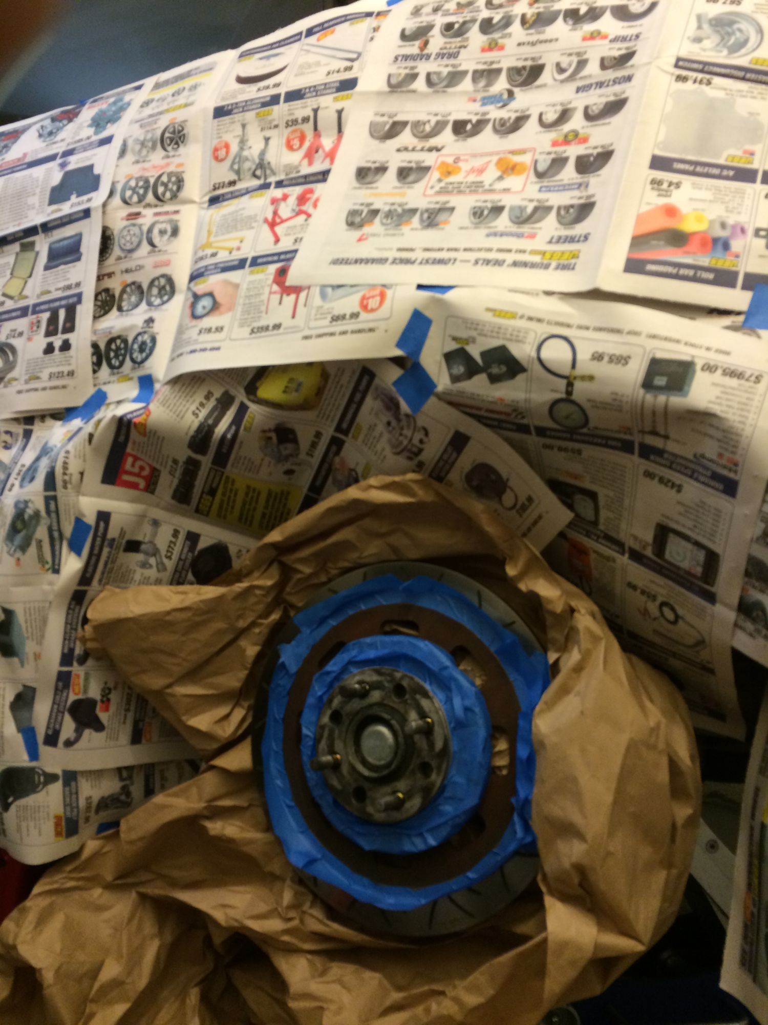

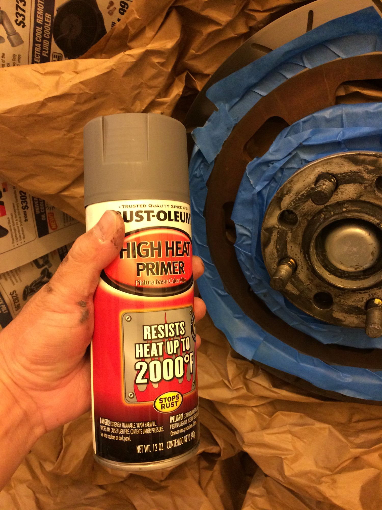

I decide to paint the JDM Integra Type R Caliper to yellow from it's original red to match the front caliper. I also paint the caliper bracket that was silver to yellow so the caliper would look larger from a distance
I also paint parts of the disk brake (rotors) that do not come in touch with the pads and rusting with black high temp paint.
The original color of Red Caliper with Silver Bracket, green EBC pads and rusting braking rotors/disk brake:
Protect the Car Paint with newspaper and also masked the area to paint the rusting disk brake/rotors:
Clean the area I am going to paint with Brake Cleaner (Acetone):
Primer High Temp Paint for the rusting disk brake/rotor:
Painted with Primer:
Black High Temp ready to be applied about 1 hour after the primer:
Rotor/Disk Brake painted so no longer show any rusting parts,
I know the black paint is not really round/perfect circle, but it will become perfect circle as soon as I use this brake

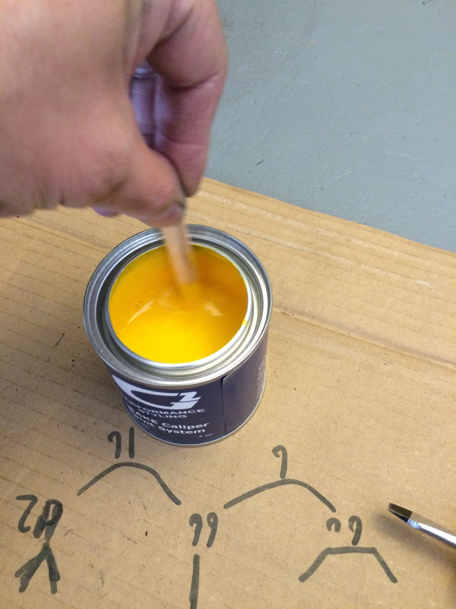

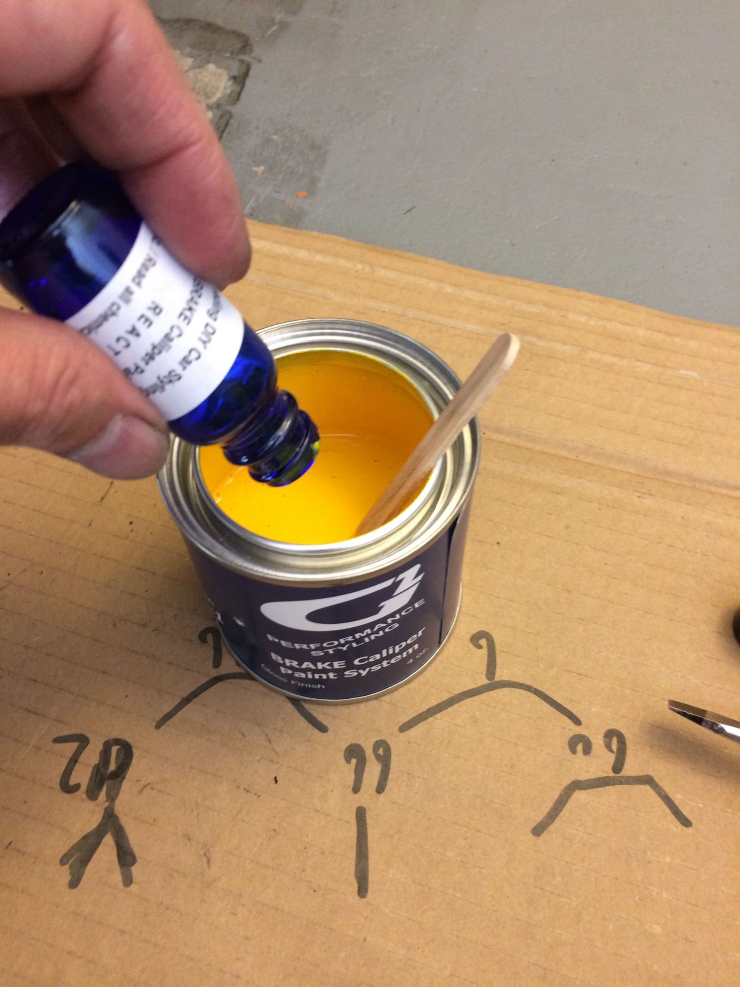

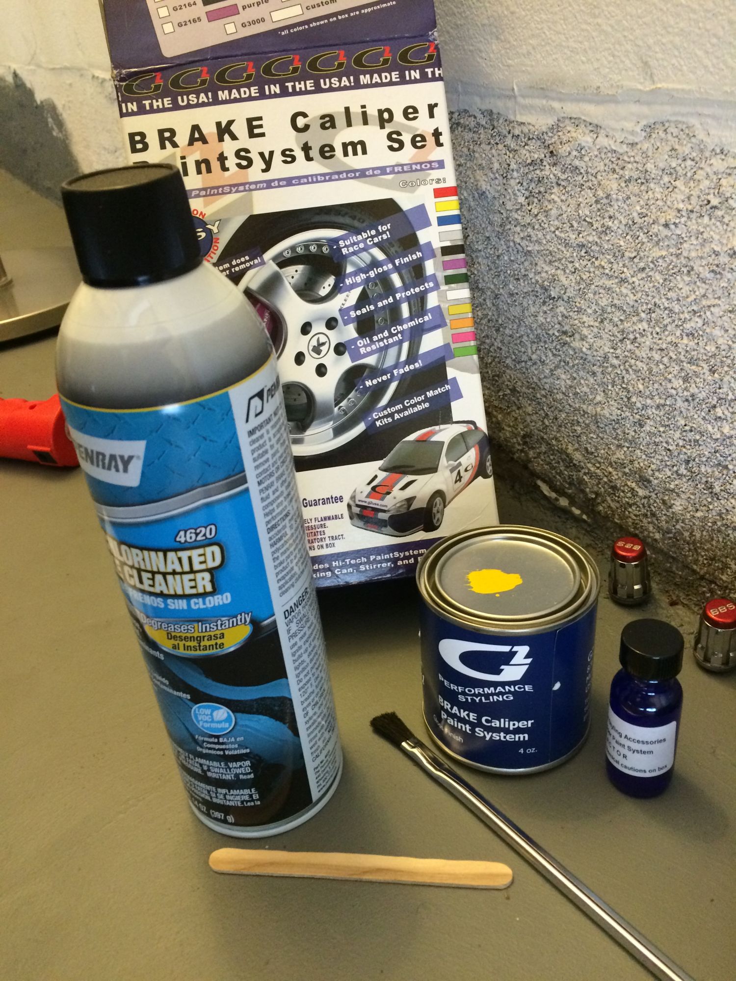

Time to paint the Caliper:
Here are the paints kit, it came with Paint, another can of brake cleaner/acetone, hardener/catalyst for paint, brush and plenty of instruction:
Pour the catalyst/hardener to the paint:
Mixed for 2 minutes, let it react for 5 minutes and mixed it again:
I am not very perfect with brush hahaha ,
but amazingly this paint have some kind of self elastic features
that after a while it become even by it self:
Wait for 2 hours after painting before install the wheel according to the instruction... well I decide to wait longer and just install the wheel back,
I like the looks because now I have both yellow on all four corners
Attached Thumbnails My JDM DISK BRAKE RS Rear Axle conversion-80-img_0452_c05edbc08bd735b6729b46ba62c64d4eb1ebd9b0.jpg   My JDM DISK BRAKE RS Rear Axle conversion-80-img_1442_3061fd979f2c8481993b3bf1a3d0fabda84f9ff0.jpg   My JDM DISK BRAKE RS Rear Axle conversion-80-img_1446_1404534ec44cbe6c4b17990ab117b52ad40baa79.jpg   My JDM DISK BRAKE RS Rear Axle conversion-80-img_1443_f5cc72c0d28ff25924a8ac5dce2be0ef60396ad6.jpg   My JDM DISK BRAKE RS Rear Axle conversion-80-img_1444_33fbc5943d6a2758e21c6ebbd302686abc901437.jpg
My JDM DISK BRAKE RS Rear Axle conversion-80-img_1447_119f99b06a6a2b55bcaffc0a818e5cbb81a1386b.jpg   My JDM DISK BRAKE RS Rear Axle conversion-80-img_1445_ad3625ef606b77f43e781082470f9d78083ed866.jpg   My JDM DISK BRAKE RS Rear Axle conversion-80-img_1451_81cae3c259263810bdc8d65b72d7b1e6ffa5f569.jpg   My JDM DISK BRAKE RS Rear Axle conversion-80-img_1450_7af9e437d3ccabfbd5969f4649ff08da92627a8e.jpg   My JDM DISK BRAKE RS Rear Axle conversion-80-img_1452_04edd0bba67e87f3d127dd03c0efa4287e05fd67.jpg
My JDM DISK BRAKE RS Rear Axle conversion-80-img_1453_0254416c5657e0e9c2671faa4fae5ce1906a7d0a.jpg   My JDM DISK BRAKE RS Rear Axle conversion-80-img_1454_41b00e9877b3e10648e5ac88b4abe8f5f2c90f15.jpg   My JDM DISK BRAKE RS Rear Axle conversion-80-img_0964_e38a814534bd79da36b21650eaffddff67c7d7ce.jpg

looks good!
That G2 caliper paint is the best. Its expensive ($40?) but, it is very hard chemical resistant and color won't fade. Can still chip if you hit it with the wheel good, but still not as bad as any 1 part paint.
Does that wire tool cost much? I need to wire up my wilwoods in the front and the new discs I got from you to the wilwood hats.
Old May 9, 2016 | 08:22 PM
  #318
BMW ALPINA's Avatar
Joined: Jan 2013
Posts: 2,449
Originally Posted by slimchriz
looks good!
Hello Chris,
I bought the tools from eBay:
Blue Point Safety Wire Twister #WTRW6A
The seller was selling an overstock but it is a brand new condition.
I bought it for just $76, so I am lucky...
I saw 2 seller on eBay now trying to sell it for around $127 to $140 (or best offer).

wow! May have to do by hand.
Next time I take a lesuirly drive through the neighborhood maybe I can borrow it. Your only about 3000 miles away after all, we're practically nieghbors!
How was the rigid colar instal? I have to do start looking at my bushings and all the stock rubber suspension bits. Feeling a bit to much slop for my liking.

FYI in general you only need about 1 gram of anti seize on a lug, its not recommended at all on the street on lugs, for your center hub just a haze will do it.
Another option,,, POR-15 has a paint product thats wicked tough for painting calipers and other hard parts that get hot.. its also a self leveling product so it turns smooth as it cures.
On your top - hat bolts from the outer side opposite the heads, there is a product sold by electric suppliers and some aircraft suppliers that is to let you know if a bolt goes loose, you can fill the hole with it and it will dry in about 15 minutes, it cracks if the bolt turns at all and you'll be able to see from the outside if the bolts have moved at all.. Its like a brittle paint, and it will help keep moisture out of the threads, but it does not retain the bolt at all.
