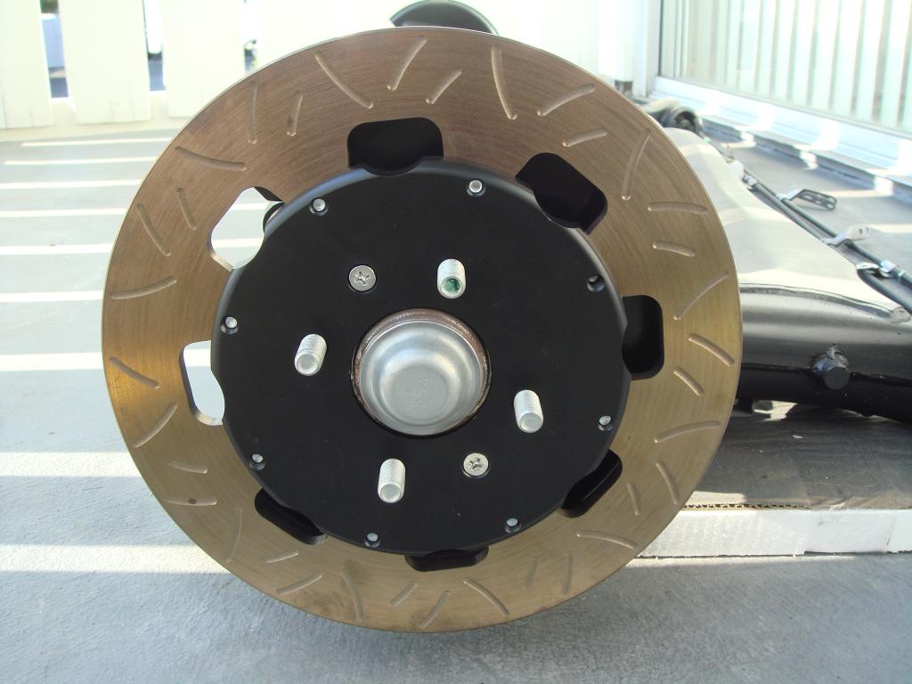

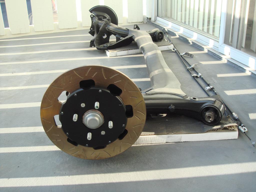

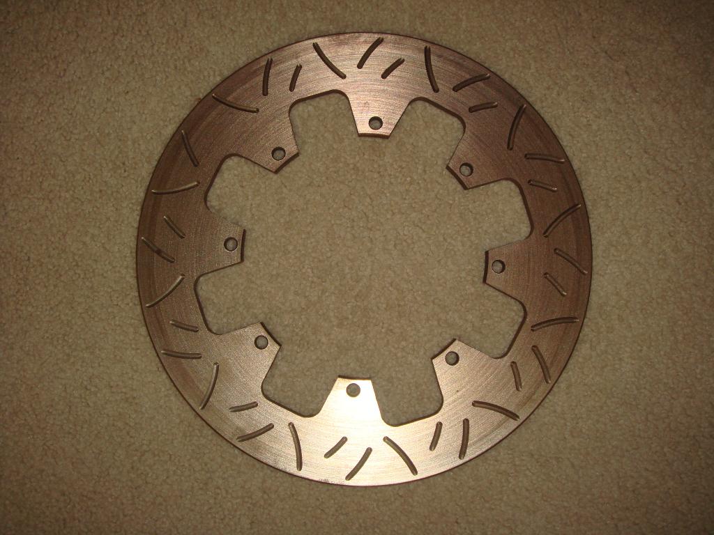

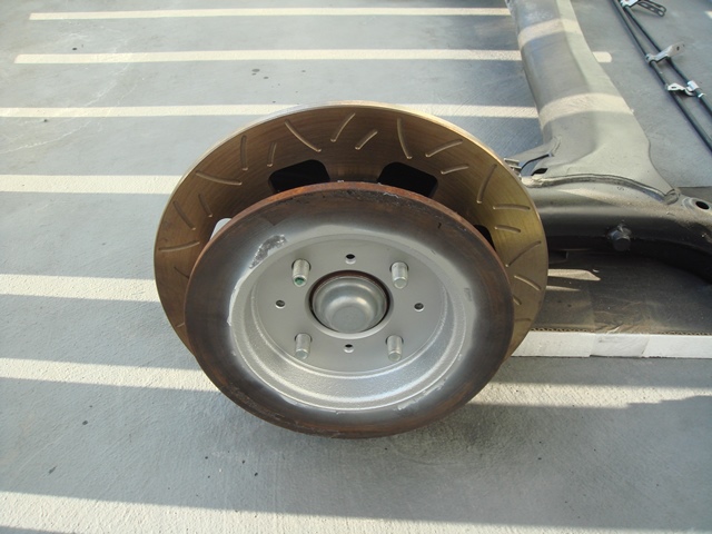

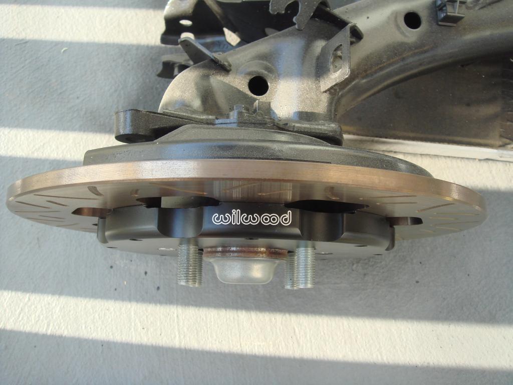

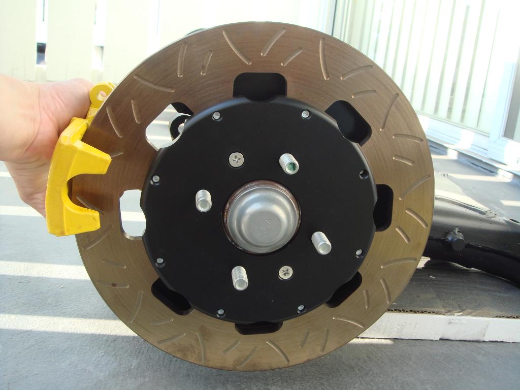

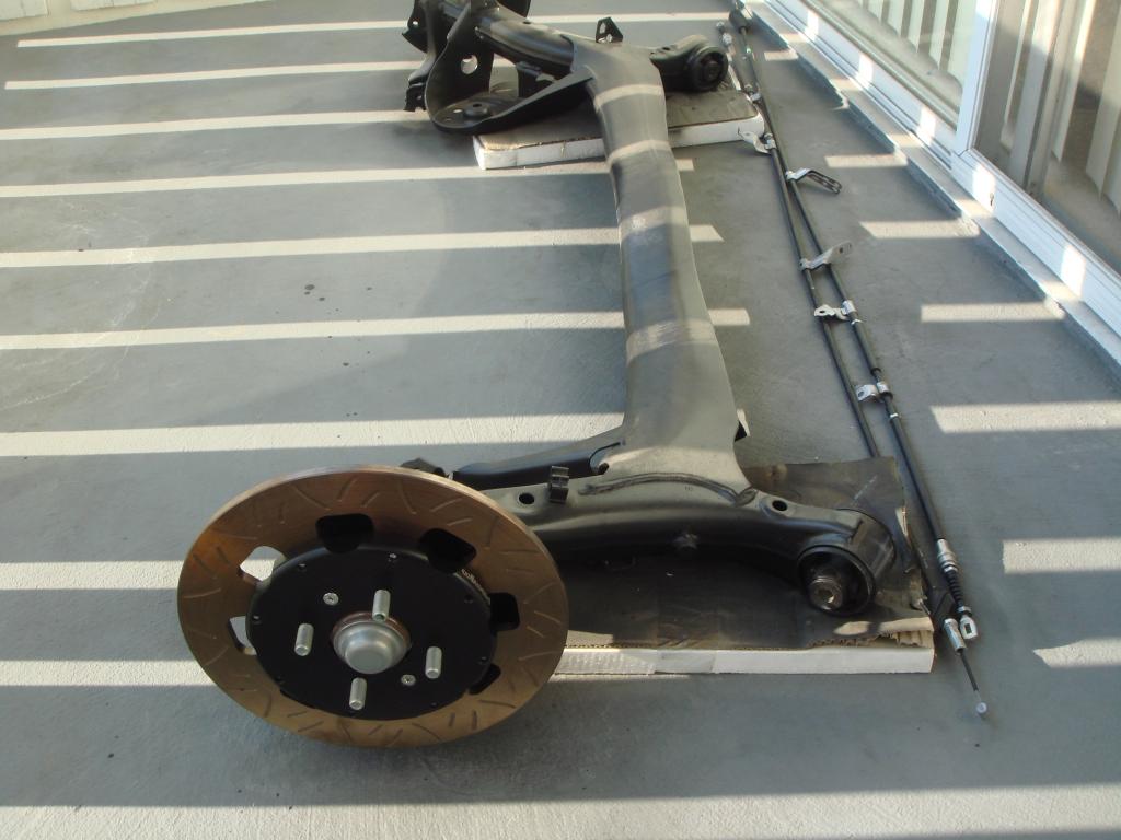

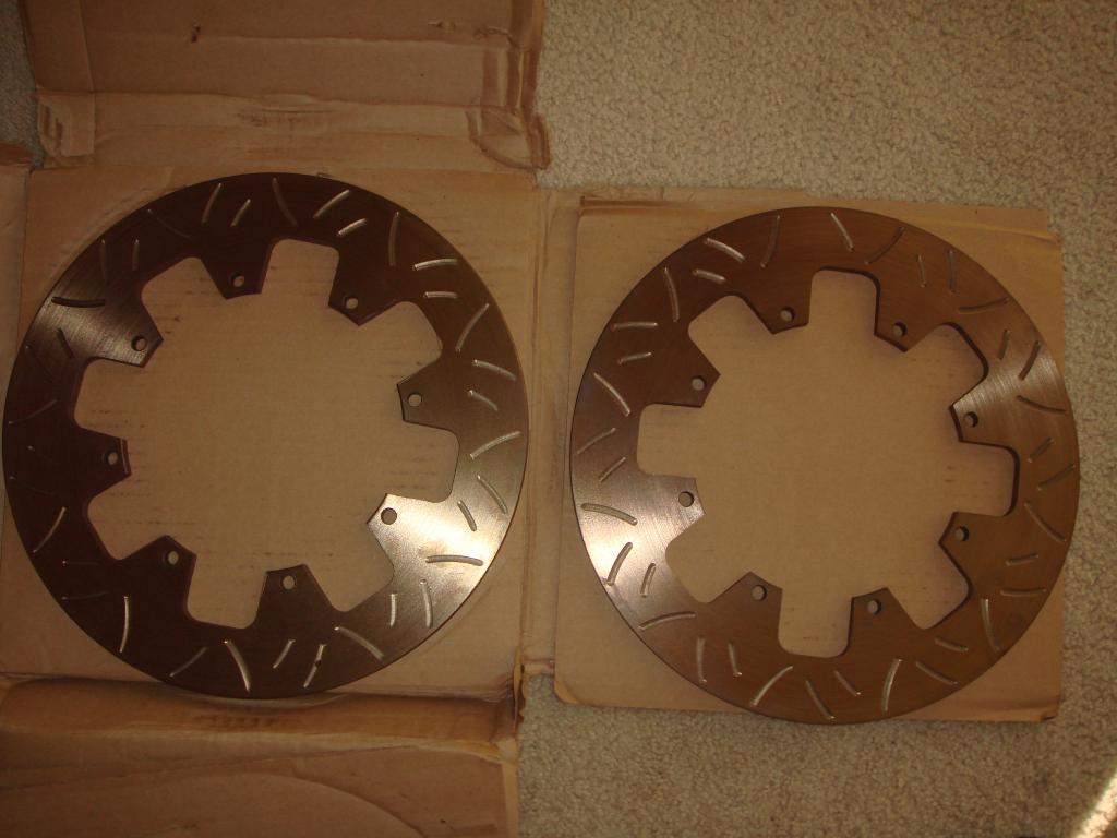

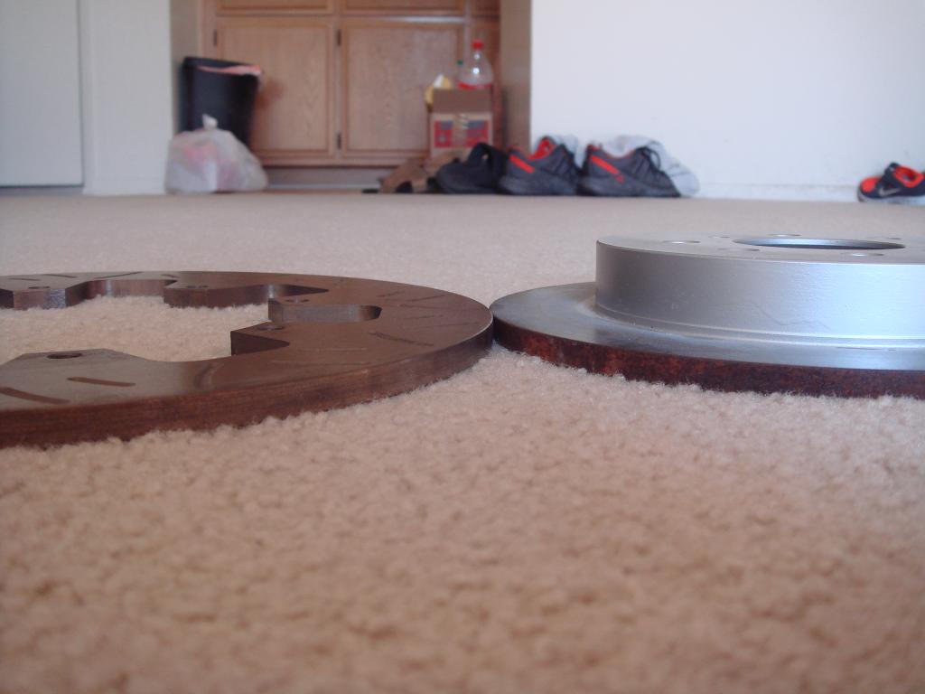

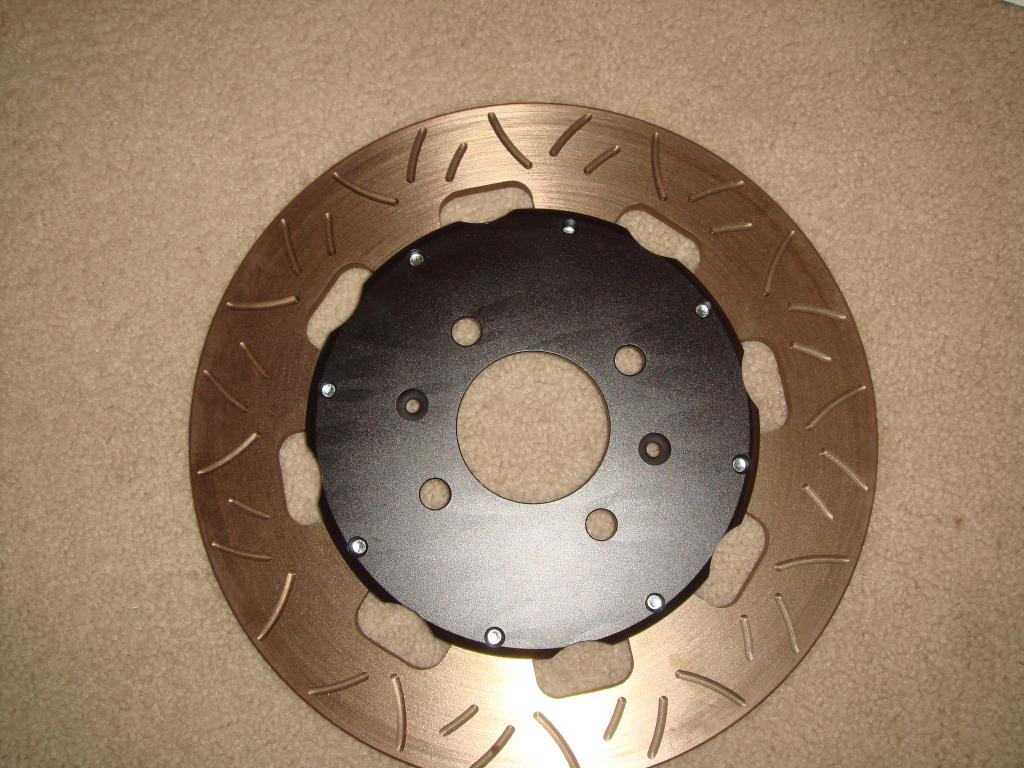

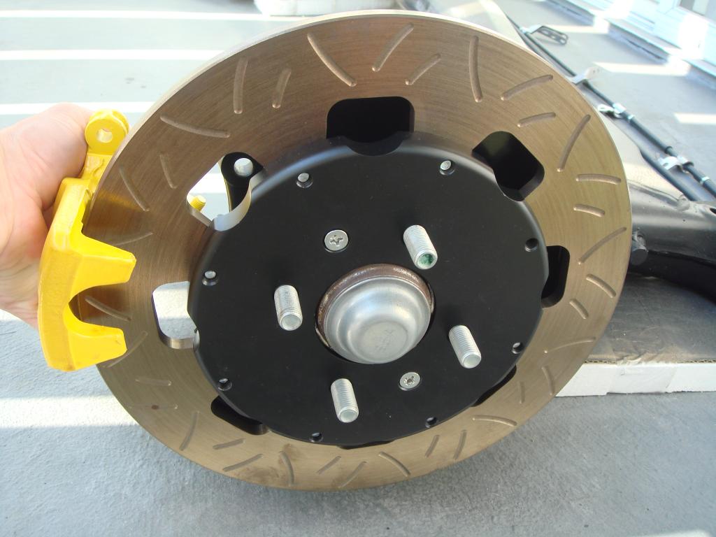

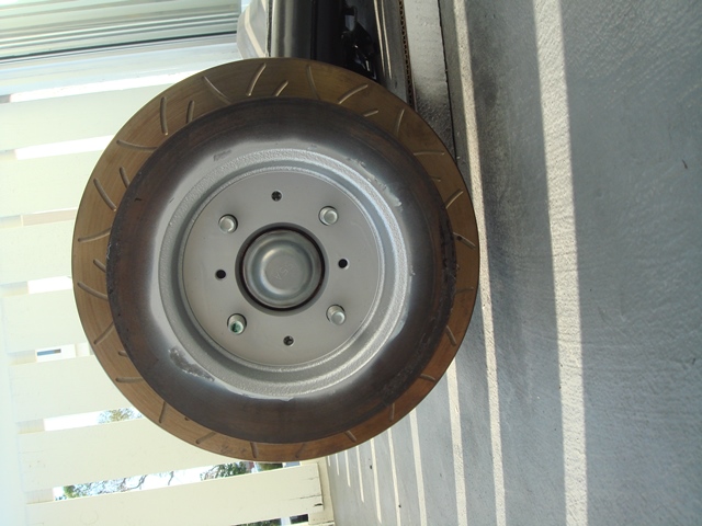

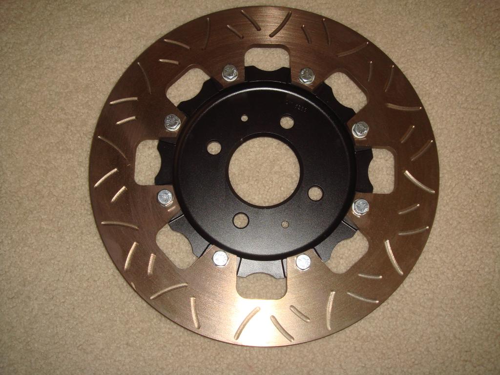

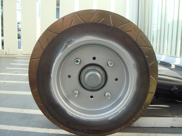

I had been ordering all the parts needed for the Rear Disk Brake Rotor UPGRADE to larger rotor.
The first parts to arrive today are

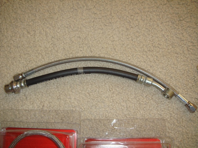

the pair of Goodridge Universal 11inches long Rear Brake Line.
This will connect between the rear axle hard line to the rear disk caliper.

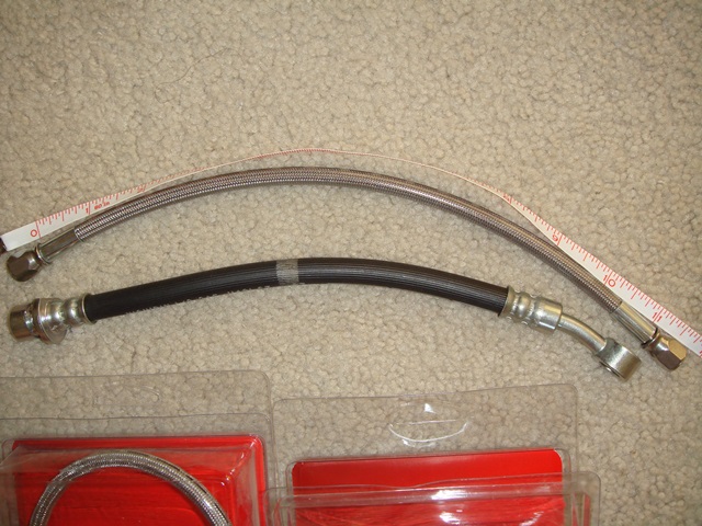

I need this because the standard rubber brake line that came with my JDM RS rear axle would not be long enough after I upgrade the rear rotor.
The Rear stock rotor were just 9.41in in diameter, while my Custom Made Rotor by Coleman Racing were 12in in diameter,
so the distance between the center of the rotor (radius) will be go up from around 4.705in to 6in (a different about 1.295in).
since the shortest universal goodridge brake line is 11in and I don't want to spent money or time to buy blank brake line, blank banjo and do it my self tools to make a brake line, so I decide to "compromise" a bit by buying this ready made 11in universal brake line from Goodridge.
It will be a tad longer than I need, but that's ok... who knows,
I might upgrade to 14in rear rotor later hahaha (no just kidding, 12in rear rotor is already big enough).
The Subaru BR-Z brembo kit had 14in rotor front and 12.4in rotor rear,
but I choose to order just 12in rotor diameter because if someday I want to buy 12in cross drilled Wilwood rotor, then I don't need to adjust the caliper bracket anymore... so 12in it is
This Goodridge universal line came with STAINLESS STEEL Fitting on each.

at the picture below I compare the Goodridge Universal 11in line with the stock rubber line.
I will update again as soon as more parts arrive later this week

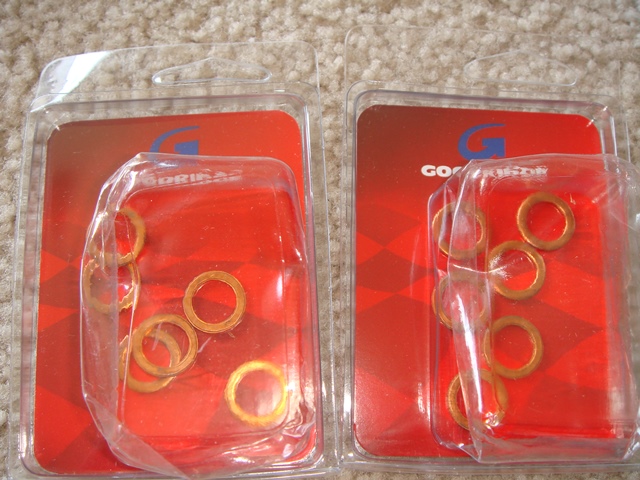

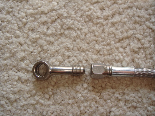

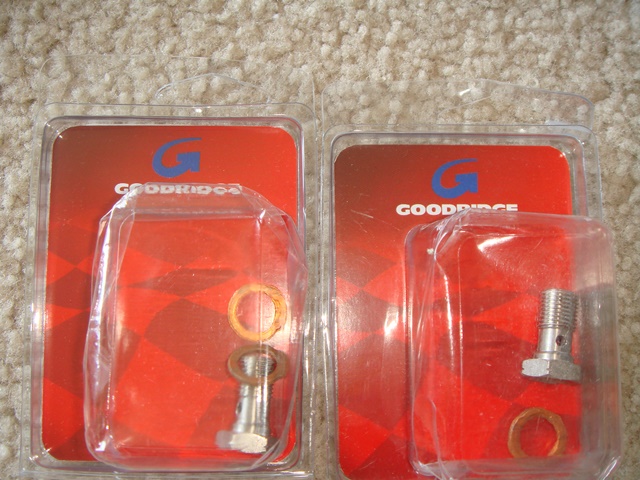

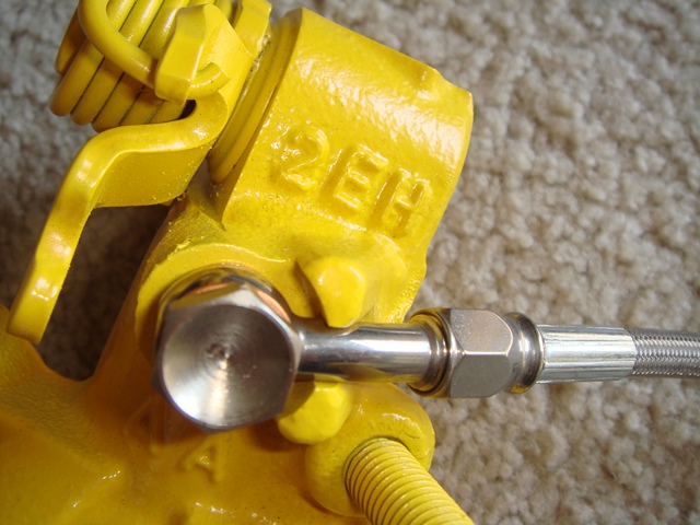

Now, to connect the Goodridge Universal Brake Line to Rear Caliper,
we need this Banjo and Banjo Bolt (with copper crush washer):
and the connection will look like :

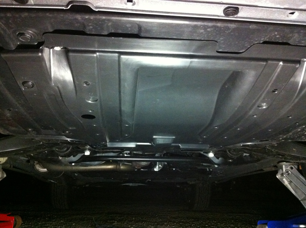

It is a Plastic Ventilation which I will put into the CR-Z/Insight Under Engine Panel Cover.
Remember the CR-Z/Insight Under Engine Panel Cover do NOT have any ventilation,
while the Beatrush model have,
so basically, I am going to cut a hole at the CR-Z/Insight engine panel cover and used Epoxy glue to glue the ventilation hole above to the CR-Z/Insight engine panel cover.
This mean I will have a VENTILATED CR-Z/Insight engine panel cover
Ok, to make it easy,
here are the pictures of the CR-Z/Insight engine panel cover installed by other fitfreak member:
and here are the beatrush under engine panel cover:
now, I still need to buy the CR-Z/Insight under engine panel cover later,
I plan to buy this when I had to buy all the tools needed to over haul the real caliper and many bolts needed for my JDM RS rear axle install,
so stay tuned
I also had bought a solid brake line pipe to modify my Master Cylinder,
but since not all fitting are here, I will post it later so it will not be confusing.
so stay tuned

ups forgot to add, that the Goodridge Banjo BOLT that I bought above were the short one for Brembo caliper, and turn out our Nissin caliper need (or can use) the longer one,
so I am going to order the longer Goodridge Banjo Bolt (Stainless Steel) later.
The Correct (long bolt) part number are :
992-03-31C
the one that I bought are
992-03-31SC (S for short)
992-03-31C
Rear Custom Disk Brake had arrived,
I also order DOUBLE Heat Treatment (Stress Relieve) for this Disk Brake.
First Heat Treatment Before Slotting (Gas Vent),
and another Heat Treatment after that.
Later I want to do a Zinc or perhaps Cadmium Coating for this disk brake rotor before I install it on the car,
so the part that do not get swept by the brake pad will remain rust free.

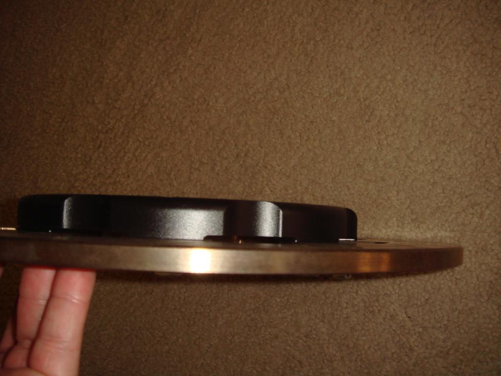

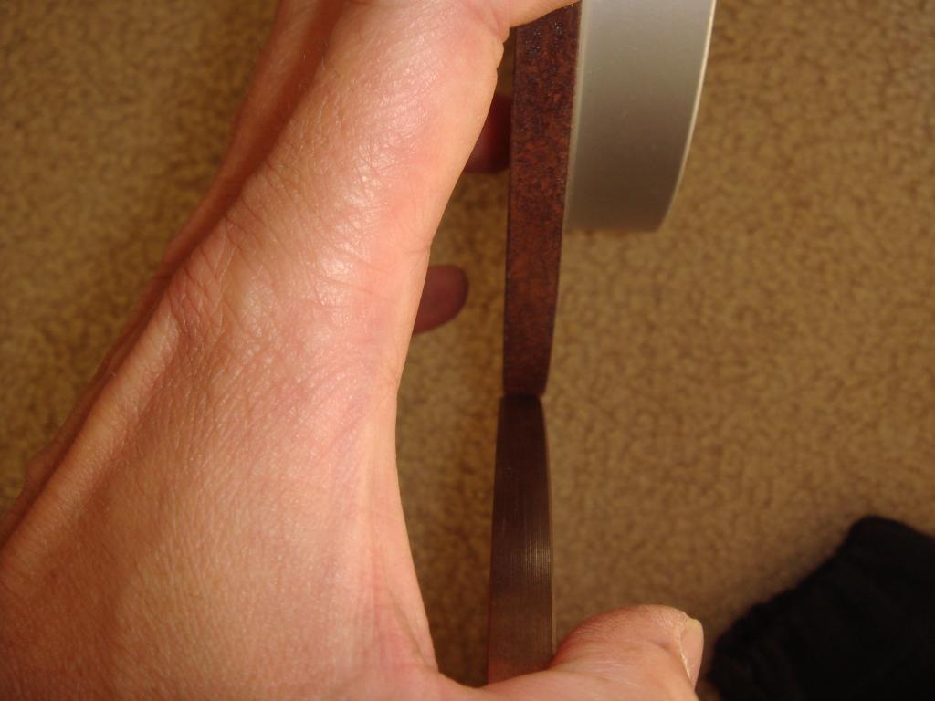

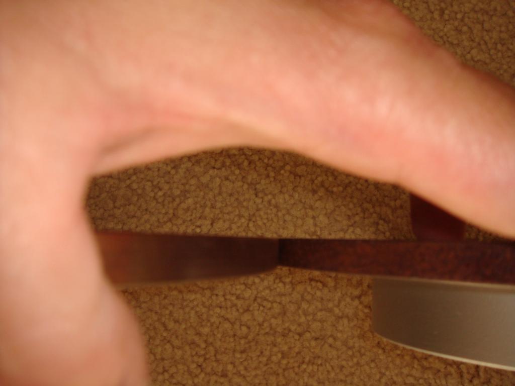

Ok here are the pictures of the disk brake itself, and after mounted on the Wilwood Hat and later mounted on the rear axle it self
Comparing it's thickness with factory standard rotor:
Last 3 Picture comparing the diameter of the new 12in rotor against the stock 9.4in rotor:

Well I finally arranged enough free time and the weather cooperated long enough for me to swap in the RS rear axle with disc brakes. The humidity made the job a little more tedious but overall it went very well. The only real time consuming problem I encountered was attempting to get the driver side parking brake cable grommet to be seated in its hole. The passenger side can be accessed via the bottom of the car but the driver side is hidden by the gas tank neck that connects to the long filler neck. All attempts to drop parts from the bottom of the car didn't allow enough room to push the grommet up so I ended up going from the top to pull it through. They come into the car about 8 in behind the center console so I had to pull the driver seat and some trim parts on the rear driver seat area to get enough clearance to pull the grommet through.
As far as raising the rear axle to the car, I used three floor jacks that I had. One on each lower spring perch and a third in the center to counter the action of the rear axle to roll off of each jack on the ends. Raising them each a little at a time and then moving them on their wheels to center the axle on the car, I was able to put the axle up by myself. This is not to be taken lightly however as the item is very heavy and awkward to maneuver into place without the aid of the floor jacks.
After bleeding the brakes I took it for a test drive and everything feels very good, definitely a better feel to the pedal and more bite in the brakes overall.
Just a couple of shots of it installed.

Congratulations,
I think you are the first one who drive a USDM Fit Sport with JDM RS Rear Axle (with disk brake)
(at least to my knowledge)
also thanks for the guidance (DIY), I think it will help me a lot.
I am also glad that every parts of that JDM rear axle works fine ,...
