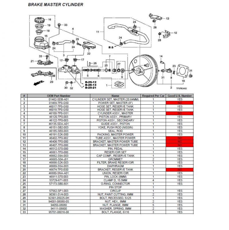

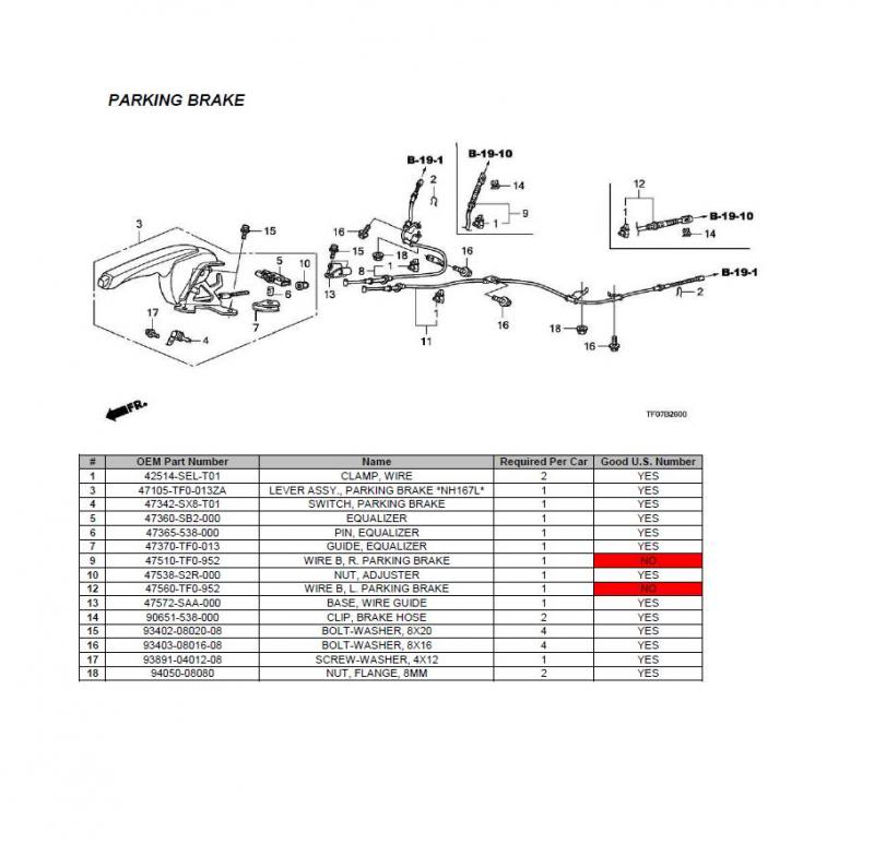

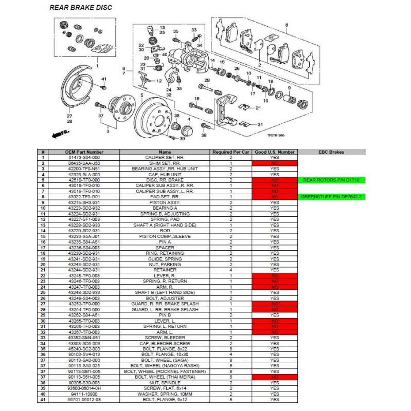

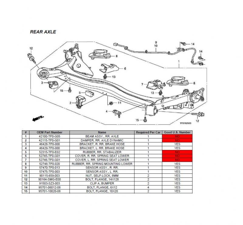

I put these together the other day after deciding I wanted to do a rear disc brake swap. I hope these help anyone else considering doing it this way on a USDM GE8.

Originally Posted by hondacivic90ed
Hi hondacivic90ed,
I will try to push them to get your JDM rear axle shipped sooner from Japan
so you can install them in your car asap...
cause I don't know when I will be able to install mine hahaha
by the way, the Japanese brake master cylinder above have the same 3/4in diameter as our USDM car, the different is only because they are RHD so their outlet point to different direction then our (outlet that connect to hard brake line).
if after installing your rear JDM rear axle,
you wish to improve with larger brake master cylinder,
I suggest this brake master cylinder part# 46100-SNW-J01
it's a 1in diameter Civic (FD2) Type R
and here is the link to the picture: (I try to put the picture here directly,
but it won't do it, so I have to use a link):
http://www.supergt.com.hk/full/ENHAFD2010.jpg
of course you still have to modify the hard brake line from this master cylinder to the VSA unit.

I called EBC Brakes today to see if they could get their hands on the rear pads or rotors. I spoke with someone named "Will" and he said that the rear pads are something they stock so obviously it is a cross to something else Honda related, but the rotors were specific only to the Fit/Jazz so he is going to find out if they would be willing to import them or not. I have to call him back Wednesday at 3pm EST to find out what their answer is. If I can't get them through EBC I may use either the Japanese or European EPC catalogue and get oem rotors. This is all assuming that the rotors that come with the JDM rear axle aren't salvageable. I have a Hunter brake lathe in my garage so as long as they won't be under 8mm I can always turn them, though I usually have an unwritten rule not to turn solid rear disc brakes just because they are so thin to begin with, I guess I'll have to see what I end up with when the axle arrives.
BMW ALPINA, thank you for your help in procuring the JDM rear axle. I'm anxiously awaiting any and all status updates on its progress. It will be installed as soon as I have all the t's crossed and i's dotted as far as the components for the brake swap. I'm looking at getting the Wilwood front calipers and painting the rear calipers black to match them.
Old Jun 17, 2013 | 08:54 PM
Hi hondacivic90ed,
I am pretty sure you will still be able to use the Rear Disk Rotor that going to came with this JDM rear axle, because the car it came from are brand new car, at least my rotor are still in like new condition, when I measure it, it still 9mm (like new thickness).
but if you want to upgrade,
the easy thing is to buy Mugen Rear Rotor from Rakuten Japan.
Here is the Part Number for the REAR Mugen Brake Rotor:
43250-XLF -K0S0
Price around 23,000 yen
Rakuten: 43250-XLF -K0S0 - Shopping Japanese products from Japan
The front one are slotted, but so far I had not found the picture of the rear one, but I guess it will be slotted too
Here is for Type S "SPORT" type REAR brake pad (Mugen):
43022-XLF -K000 (price lower then 21,000 yen)
Rakuten: 43022-XLF -K000 - Shopping Japanese products from Japan
Here is for Type T "TOURING" type REAR brake pad (Mugen):
43022-XK7D-K000 (price lower then 13,000 yen)
Rakuten: 43022-XK7D-K000 - Shopping Japanese products from Japan
Have you ever buy from Rakuten and ship it use Tenso?
if not, just email me, and I will explain to you step by step.
Pretty easy
you can also use Yahoo Japan Auction but buy it using Buyee (subsidiary of Tenso).
Another place to buy is Amazon Japan, and ship it using Tenso.
All the 3 place above have this Mugen rotor and pads available

Originally Posted by Mini_Odyssey
So i got a look at the 4wd GE fits and its a beam axle setup, that's got to be weird.
Last weekend, I done some checking and turn out the only model that have both Disk Brake and Internal Sway Bar combo at the same time is only either the RS or RS Hybrid model.
other might have sway bar but no disk brake.
while,
The 4wd model do not have disk brakes and don't have internal sway bar.
The 4wd rear axle is called "de dion formula" (I know this after translate the Honda Japan Spec for GE website with google chrome)
I think they don't want sway bar for 4wd so the rear axle will be more flexible on the rough road and thus provide extra traction on rough road... but this also mean the inherent handling on normal road/highway will not be good, especially with the extra burden of a rear differential on the rear axle...
here is the Honda of Japan official spec website for Honda Fit :
«”\ | ƒtƒBƒbƒg | Honda
note: use Google chrome is recommended so you can translate all the Japanese word into English seamlessly
