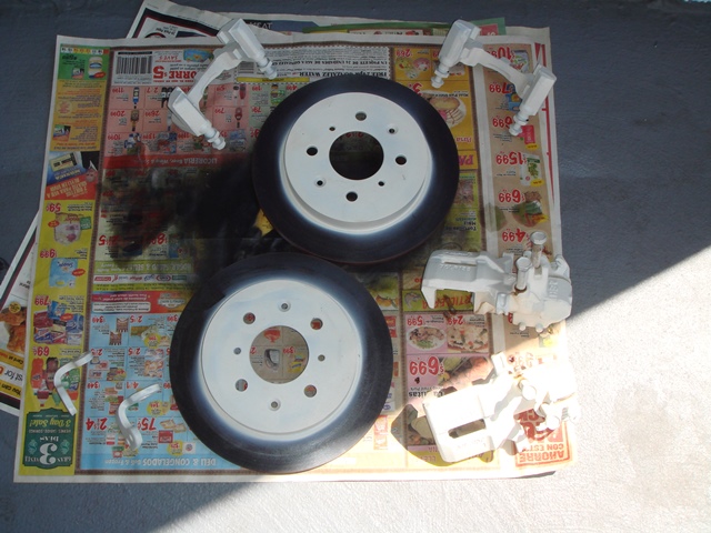

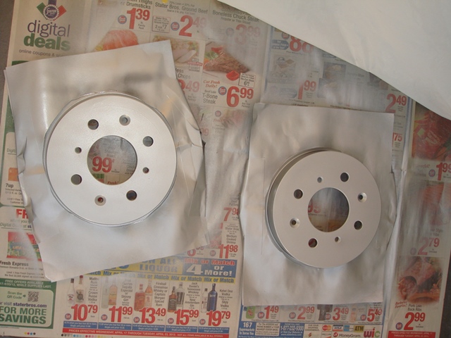

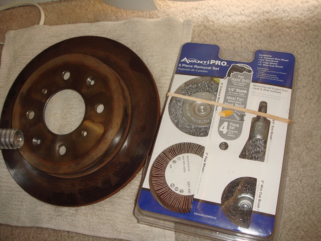

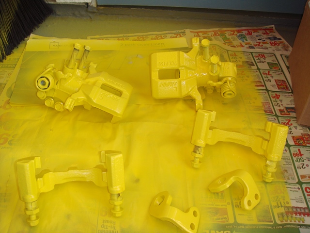

I bought several Caliper Paints, Brake Cleaner, Lubricant and also Wire Brush
hopefully tomorrow I can start painting the Caliper and the rotor ...
I had started doing a little wire brushing on the rotor, but not finished yet...

Last Week I apply the Primer Coat VHT Paint to the Caliper and Rotor (face), (VHT Paint Code SP118 Flat White Primer)
and since the instruction said to wait for 7 days for paint to cure,
that is why I only bake it in oven today.
Here are the pictures after I bake it in the oven:
Then I wash them, clean them and dry them,
then I paint the caliper YELLOW
(VHT Paint Code SP738 Bright Yellow)
Here are the pictures:
For the Rotor Face, I paint them Aluminum color
(VHT Paint Code SP735 Cast Aluminum), but I need to paint the rear face of the rotor tomorrow since I had to flip it, and I cannot do it now since it will ruin the front face paint... (don't have room/place to hang them with coat hanger)...
after this, I will wait another 7 days to cure and then bake them again in the oven, then I will apply clear coat to the caliper only, and wait another 7 days and bake them again... still long long way to go
I don't think I will use this rear rotor though cause I plan to install a larger 2 piece 11.44in diameter Wilwood rotor, but since I already bought the paint, so I had to use it anyway, otherwise it will be a waste...
here are the rear rotors:
