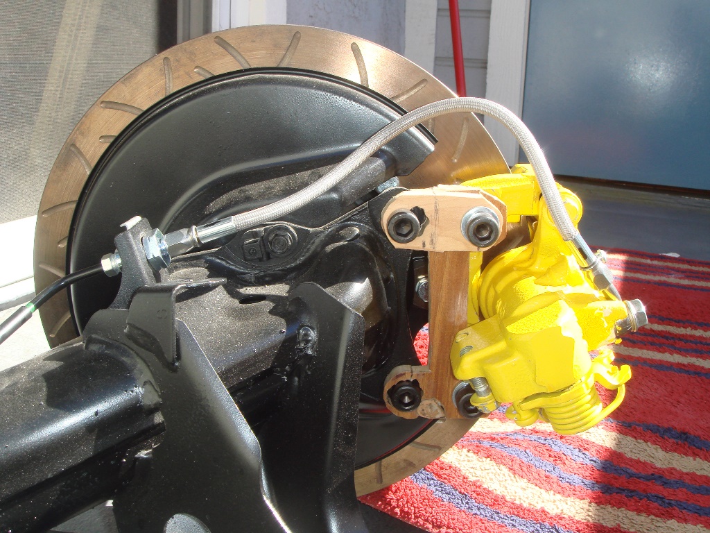

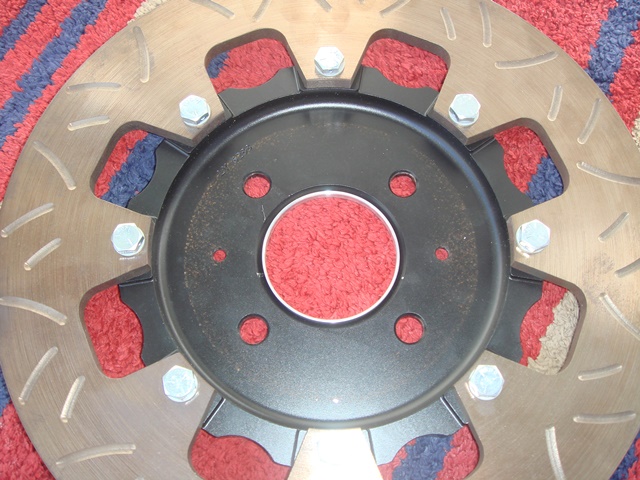

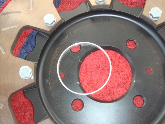

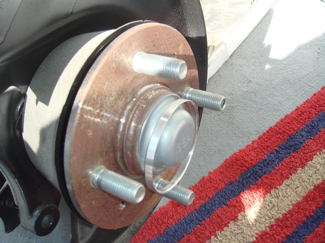

Done more shopping today in relation for this upgrade:
1. Buy HUBCENTRIC Ring from FASTBRAKES.com !!!
Their customer service is amazing, within 30 minutes of paying them by paypal, they already email me the USPS priority mail tracking number !!!
and this is for a $30 only hubcentric ring !!!
I am happy with this kind of customer service !!!
Also they are really nice in giving technical input...
and if I buy my front Brembo kit from them,
they can modify and make the bracket for me since they had a Honda Fit Spindle in their facility, so I can just really BOLT ON the Subaru front brembo kit on my car without doing anymore custom work my self !!!
Wow
oh, this hubcentric ring were needed because my Wilwood hat have a 64.2mm center bore while the original Honda disk brake have 61mm center bore hole. actually the Wilwood do have the 2 centering screw holes, so I don't really need to buy hubcentric ring...
but since I want PERFECTION, and the hubcentric ring is only $30 for a pair (shipped to my door), well why not ?

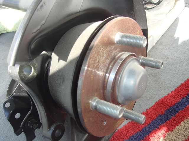

Another parts needed arrive today
Here is The Hubcentric Ring needed to make sure my Wilwood Hat sit perfectly centered on the hub.
The Wilwood Hat hava center bore hub diameter of 64.2mm,
while the stock JDM RS rear axle had a center bore hub diameter of 61mm.
Here are the pictures :

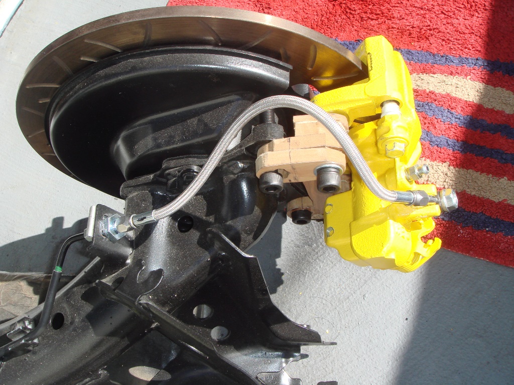

Just TESTING if my CUSTOM Goodridge brake line will fit the larger rotor (need longer line since the stock brake line is not long enough for 12in rotor)...
My custom Goodridge utilized all STAINLESS STEEL fitting, while if you buy regular Goodridge kit,
the fitting were most likely Chrome Plated Zinc...
