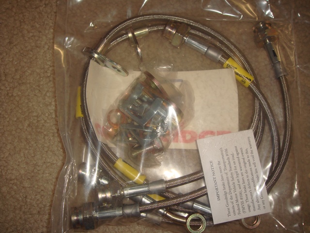

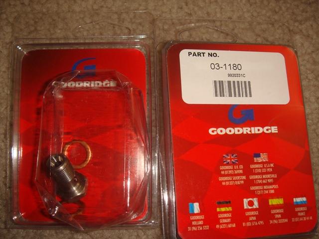

More Parts arrive:
1. Another Goodridge Bolt, this one the correct length

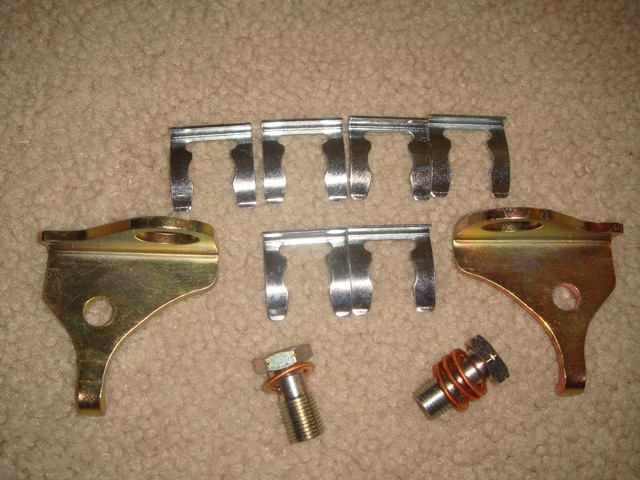

2. The Goodridge kit for USDM Honda Fit (consist of 4 lines, 2 Front, 2 Rear (between chassis and rear axle):

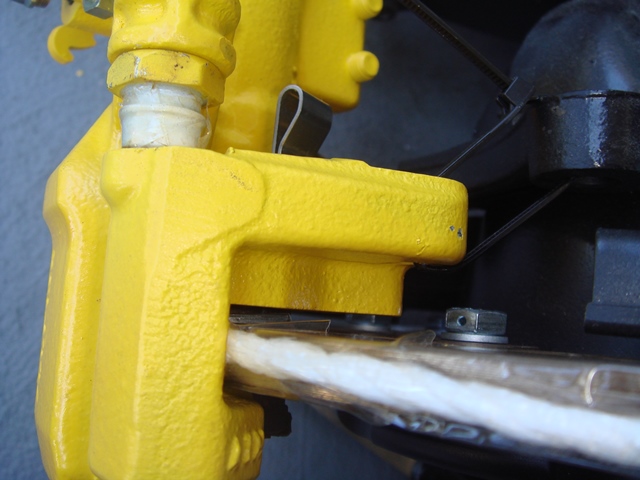

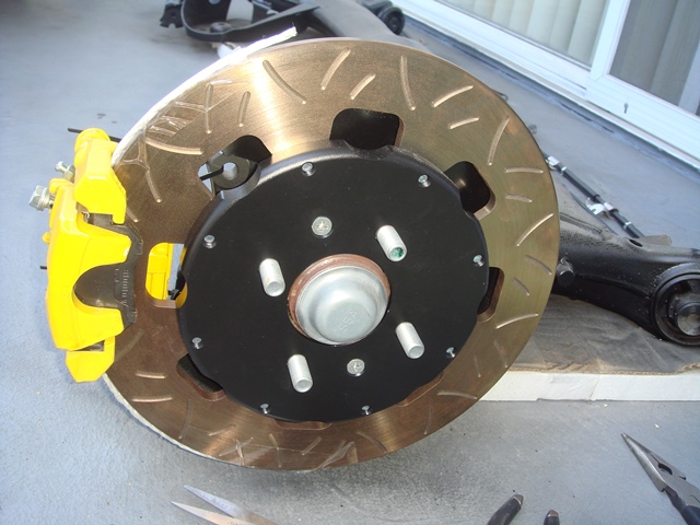

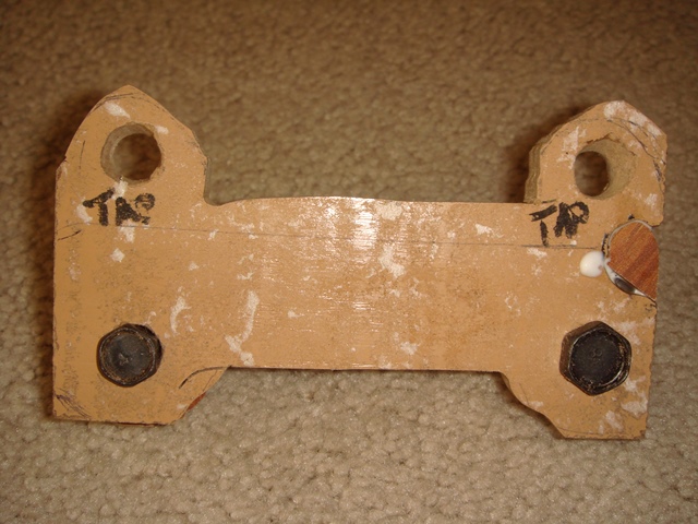

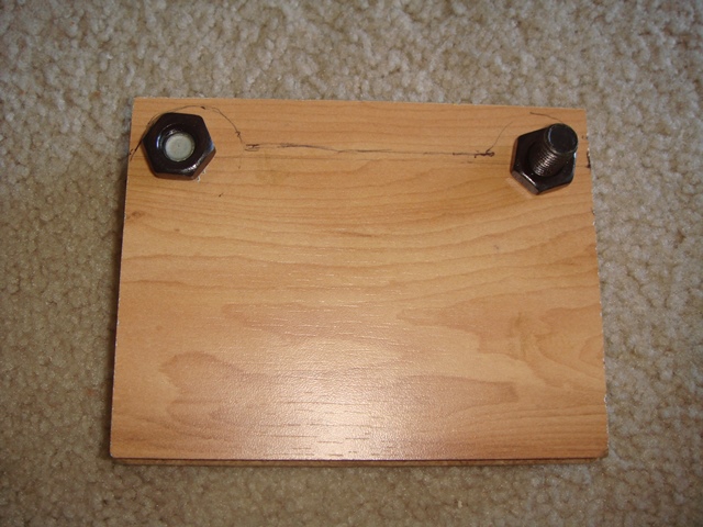

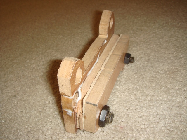

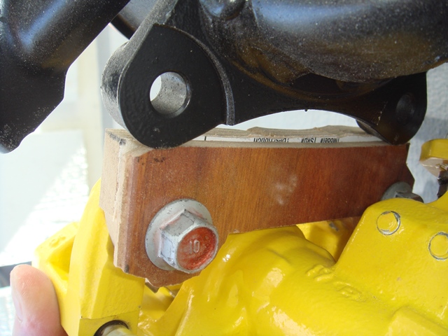

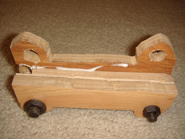

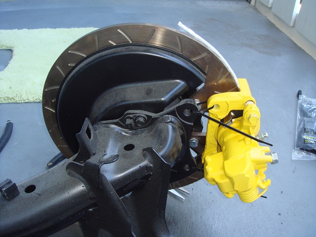

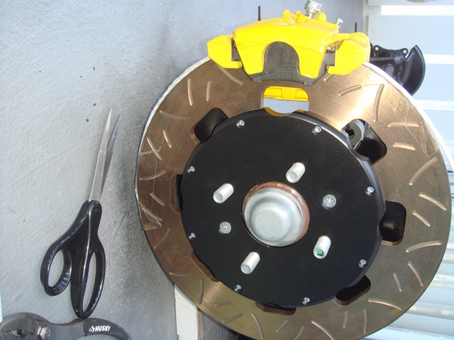

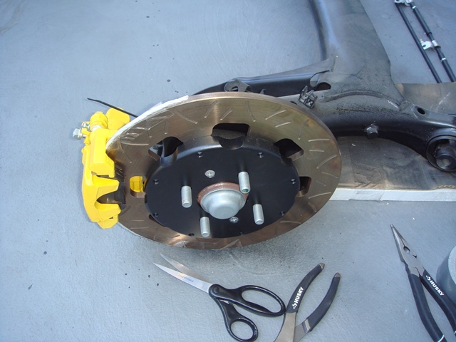

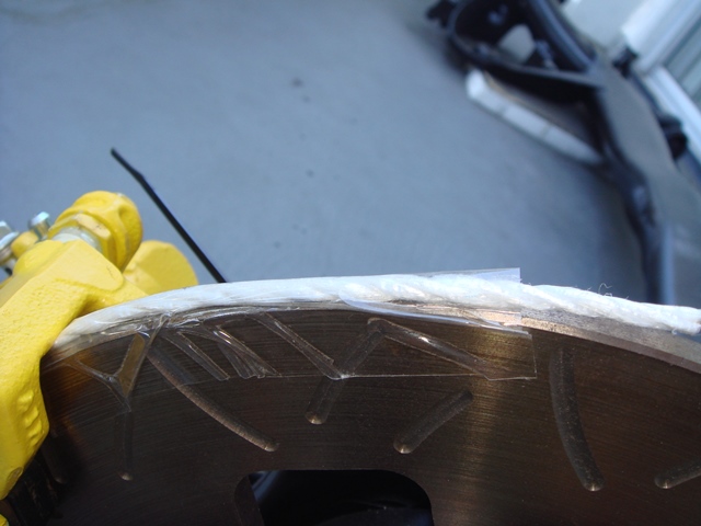

I have free time today, so I decided to start making the Template for my Rear Caliper Bracket.
The original Rear Disk Rotor from Honda were 239mm (9.41in) in diameter,
the new rotor were 12in in diameter.
Another things to note is, the brake pad shape and caliper were not designed for 12in diameter, so there had to be some adjustment using the bracket to make sure the brake pad will swept most of the available disk rotor surface area, and also to make sure the edge of the rotor will not grind to the caliper.
so to make it easier, I tape a plastic rope on the other edge of the rotor,
this will give me around 2mm of space between the caliper and the rotor edge so they will not touch.

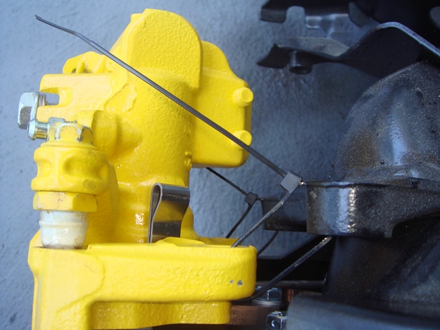

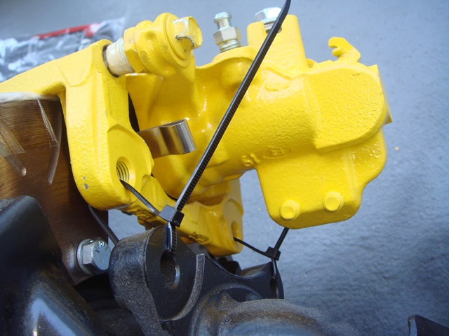

Then I use Tie Lock to tie the brake caliper so I can start doing the measurement for the bracket dimension.

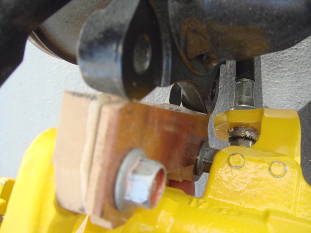

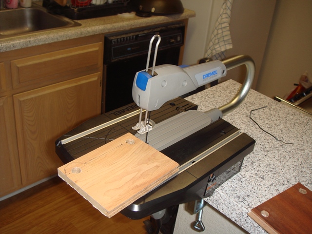

At Home Depot, they have a lot of FREE small sheet of hard wood floor sample with varying thickness, so I grab several of them to make the bracket... Hahaha... well I actually also buy some sheet of MDF at Home Depot, but those MDF were not needed, and this Free small sheet of hard wood floor sample is all I need...
start by drilling the two main holes that will connect the bracket to the caliper holes:
Using Dremel tools I cut those hard wood sheet into the bracket shape that I need:
The bracket side that attached to the caliper is done below,
next is to make the bracket side that attached to the rear axle:

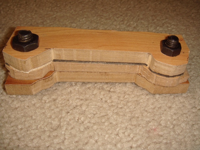

Complete bracket done below:
Tomorrow, I am going to find a CNC shop that can make the bracket using the wooden template that I made above

That is awesome thinking. And a nice dremel cutting saw where did you find that I have never seen one before.
Old Jul 29, 2013 | 03:29 AM
  #168
BMW ALPINA's Avatar
Joined: Jan 2013
Posts: 2,449
Thanks Loudbang,
I bought this dremel on Amazon,
here is the link:
Dremel MS20-01 Moto-Saw Variable Speed Compact Scroll Saw Kit - Amazon.com Dremel MS20-01 Moto-Saw Variable Speed Compact Scroll Saw Kit - Amazon.com

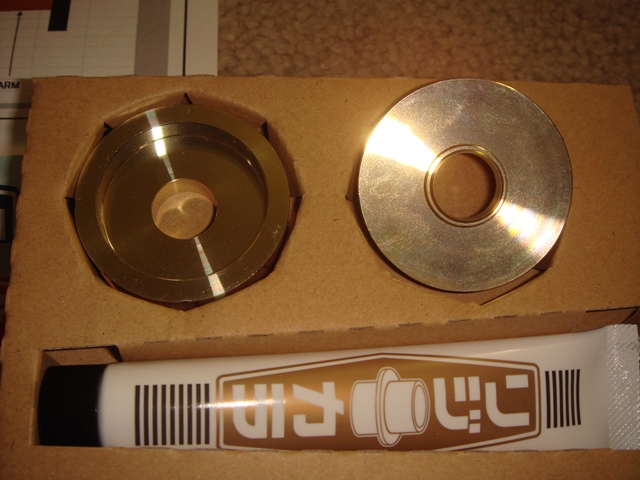

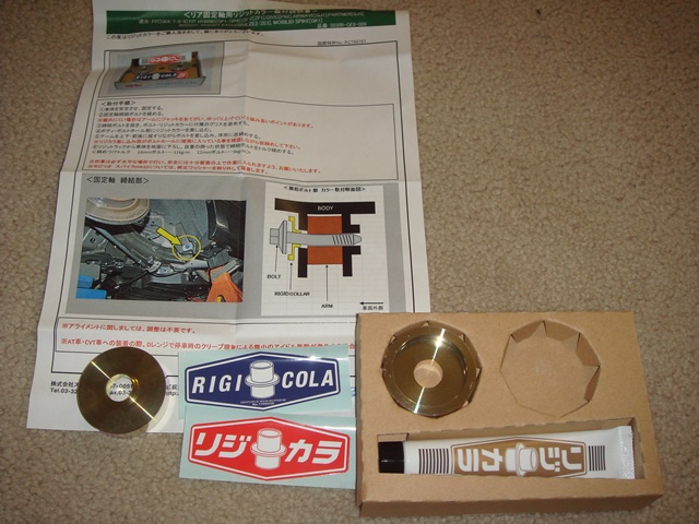

My SPOON Rigid Collar for the 2 Rear Axle Bolt
just arrived from Japan today (using Tenso as usual)...
I don't buy the Front kit because I don't think they have any effect for the front subframe since it is metal to metal,
but for the rear axle, I think it do have effect because it involved tightening
the bolt that have rubber bushing on it (some inherent flex movement)...
especially since I am experiencing some movement on the rear axle (little fish tailing effect) whenever I travel through rough grooved freeway surface...
this is due to my tire being too large and grippy...
Also SPOON had warning for using this product that is if we put the gear in D (for AT transmission) while at the same time we press brake pedal,
there might be some slight vibration,
which can only mean it really reduced the flex of the rear rubber bushing,
which is what I am after.
