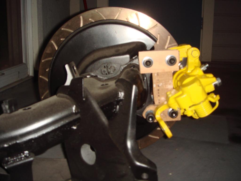

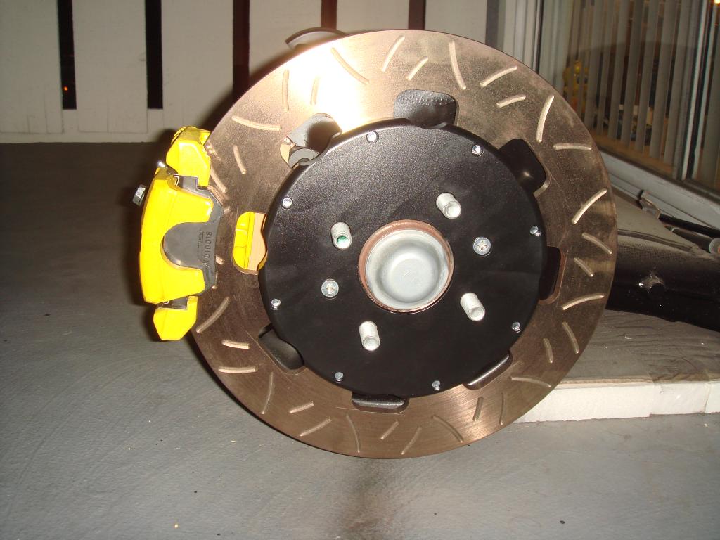

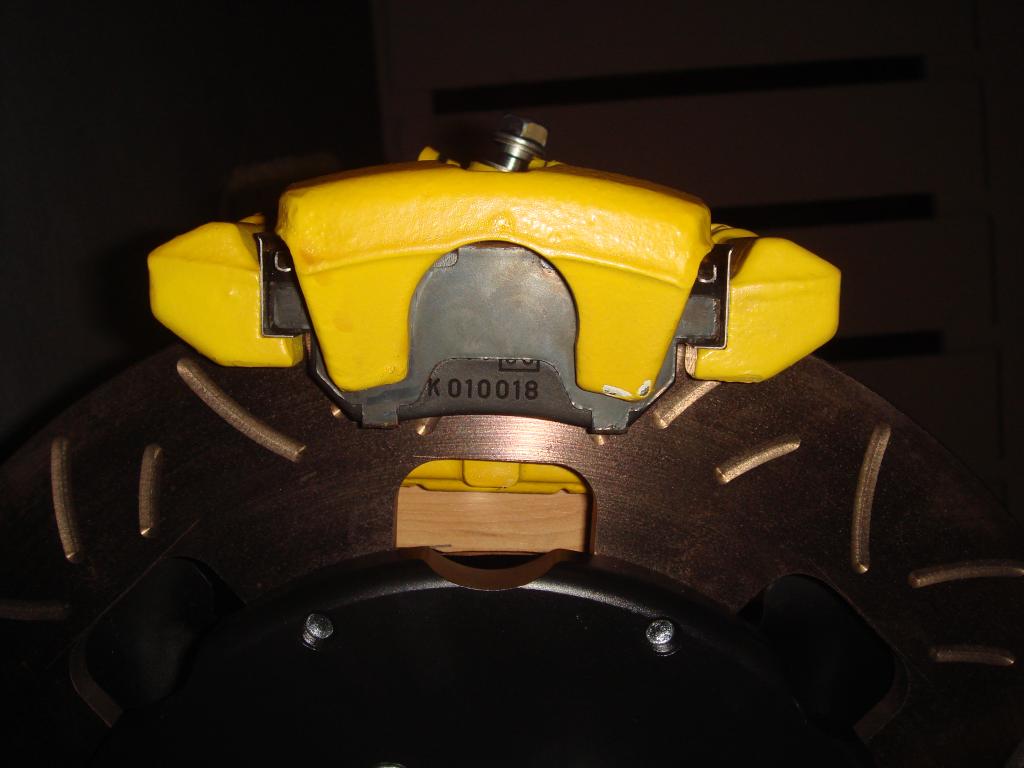

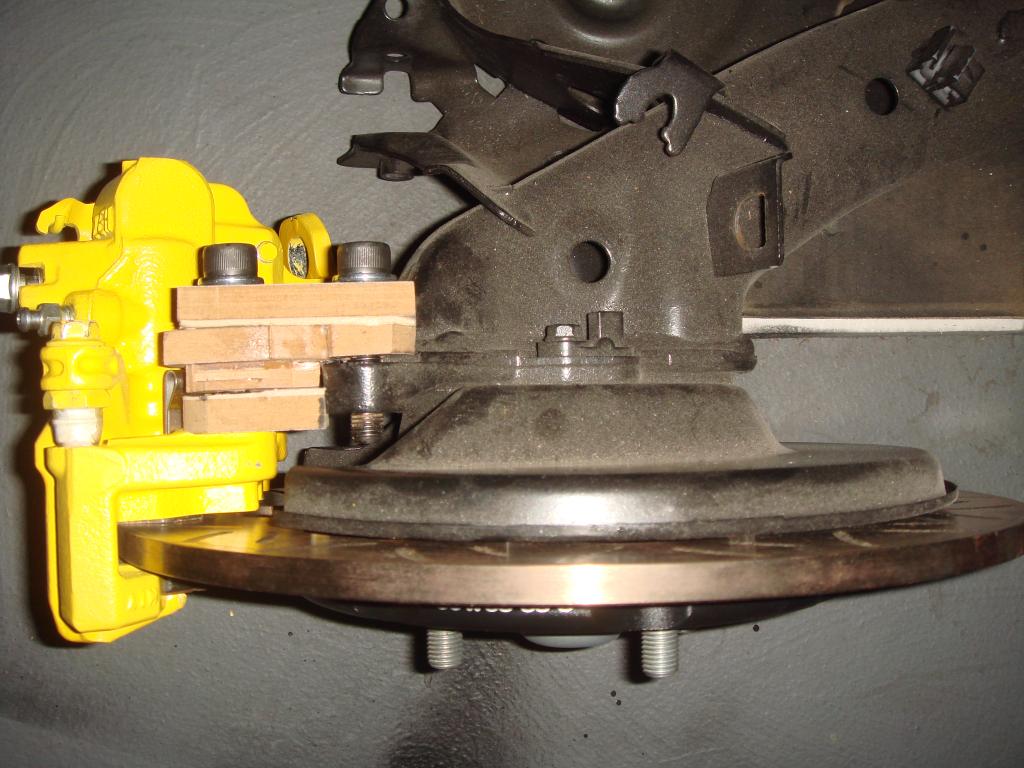

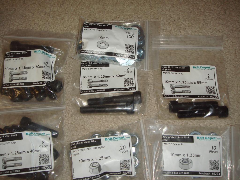

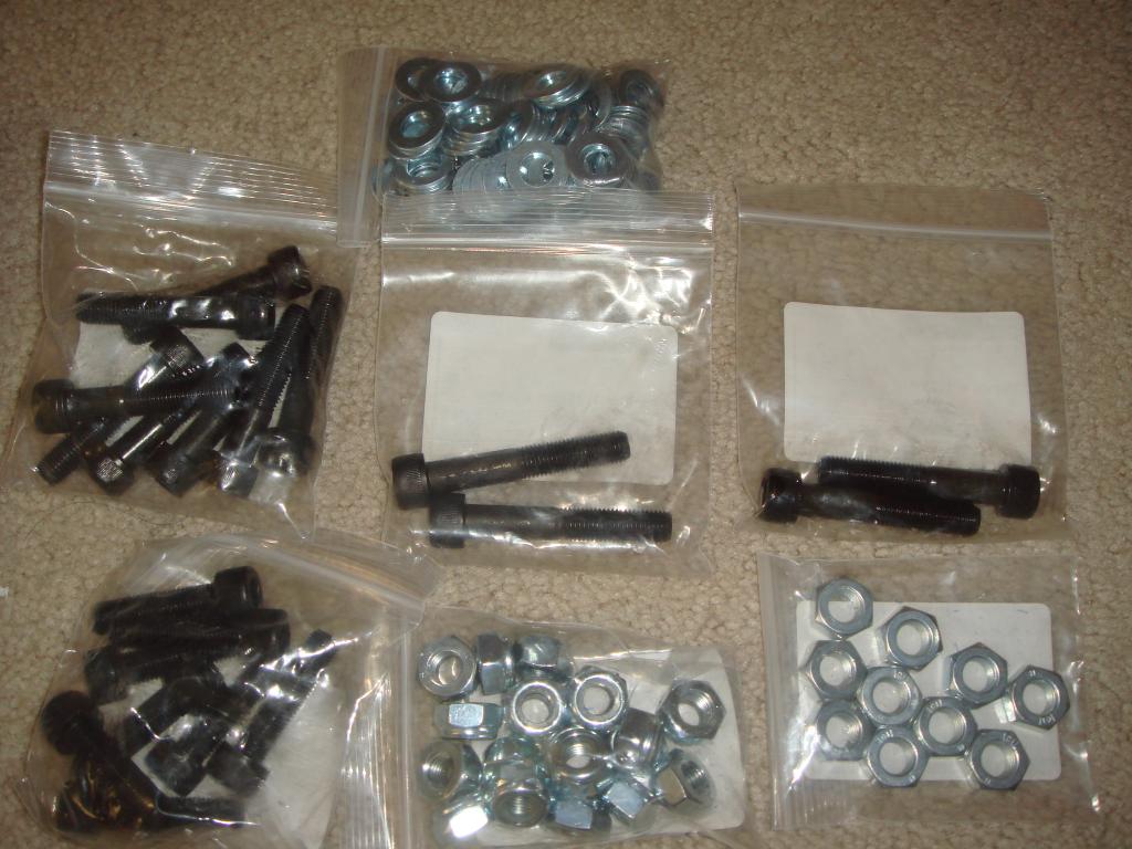

I just received the shipment for Bolts and Nuts that I bought from
BoltDepot.com
All the Bolt that I bought were
Metric Socket Cap with Class 12.9 Grade Steel Material.
The Type is M10 (10mm) with 1.25mm pitch.
The length vary from 40mm to 60mm.
All the Nut that I bought were Metric Hex Nut, Zinc Plated Class 10.9 Grade Steel Material and of course type M10 (10mm) with 1.25mm pitch too.
Of the Nut is a Lock Nuts with NYLON Insert !
I also buy Washer and Collar Lock Washer again made from Class 10.9 Grade Steel !
Take note that I choose the SOCKET CAP type of Bolt instead of the ordinary Hex Head Bolt because I think the SOCKET CAP bolt looks better and also slimmer in profile which is important in this application since a hex type one would have spacing problem, in fact, I still need to modify the parking brake cable bracket in order to clear the bolts...

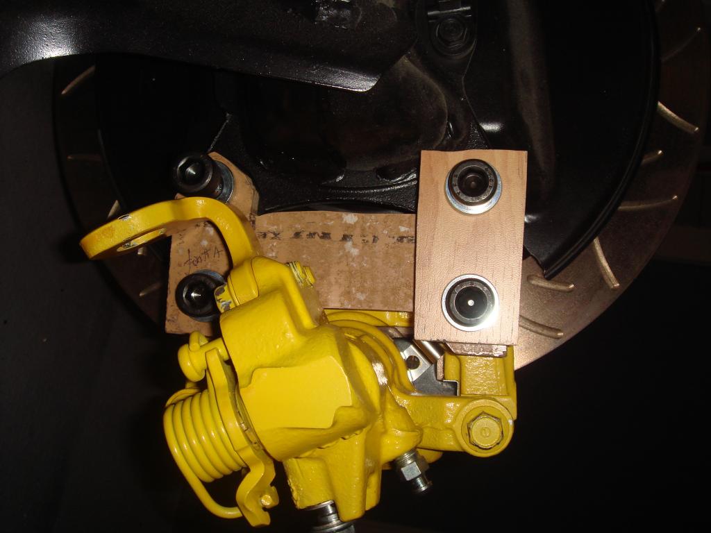

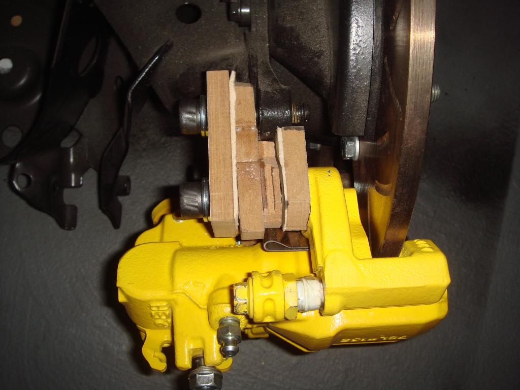

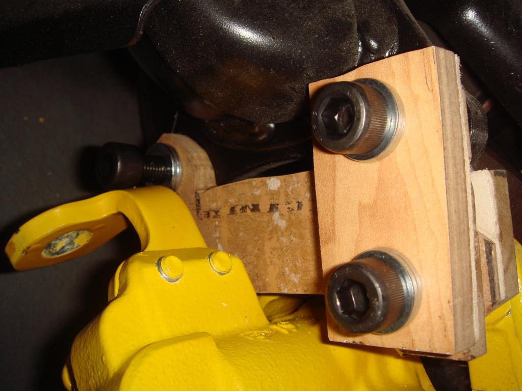

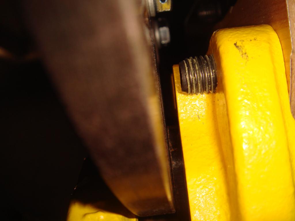

After getting all this nuts and bolts, I finally able to Test Fit my WOODEN Caliper Bracket (Template) hahaha...
and turn out, it almost perfect, just need some adjustment in the distance
between the caliper toward the center of the axle (about 3mm adjustment), I plan to adjust this tomorrow during daylight, too dark to do it in the evening...
but I just want to let people know that if you really want to replace your drum brake with disk brake and decide to make bracket your self,
and get the Civic Si rear brake, it is NOT hard to make the bracket yourself.
Just copy my way of using wooden template first,
later you can measure all the dimension and order a machine shop to CNC the bracket for you
again the key is to make the wooden bracket as a template first so you can actually mount the caliper onto the disk brake, then measure it correctly/precisely.
Ok here are the pictures of the bolts, and my caliper mounted to my rear disk rotor using my wooden bracket and bolted with the bolt that I just received today

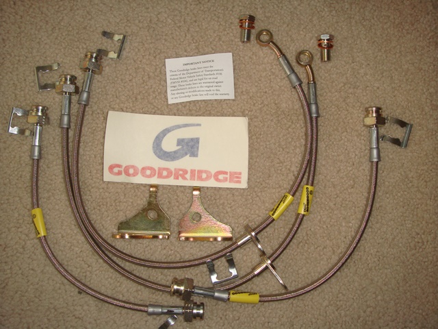

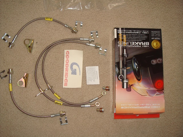

I want to sell my Brand New Goodridge Stainless Steel Braided Brake Line Kit, (part# 20114).
I had never used this, and I now change plan and want to buy the Mugen Brake Line Kit instead,
so this kit is for sale.
It came with all the bolt and hardware required for the installation, the sticker and the original boxes !
I will sell it for $128 ALREADY include shipping cost to you.
if interested, please PM me at fitfreak.net
my ID is BMW Alpina
Thank You.
List Date: 8/29/2013
For more info, click here to view the original listing: https://www.fitfreak.net/forums/sale...-stop-kit.html

SOLD SOLD SOLD to My Good Friend in NY

Just make a Good Deal with my Good Friend from NY
He bought my Goodridge (US 4 lines version),
I will order the Mugen Micro Mesh Fit RS brake line (JDM Fit RS 6 lines version),
later when the Mugen arrived,
I will keep the 4 lines (front and middle)
and send the 2 rear most Mugen lines to my friend together with my US Goodridge
(I can not use the 2 most rear lines from Mugen cause I need custom longer rear lines for my larger rotor).
This way, I can have as much JDM parts as possible for this conversion

Haven't read your entire saga on your swap. From the looks of things having larger rotors wont accomplish a thing without matching calipers.
Hello mkane,
here is what I want to and will surely accomplish with my larger rear rotor.
First and foremost,
I will have a much Better Looking 12in Slotted similar to Brembo Type 3 Rear Rotor that fill up my 18in wheel which suit my taste, because my main reason is for looks
Just look at that, ain't she GORGEOUS ?
I plan to put a 14in Brembo 6 piston front brake kit from Subaru BR-Z which will have a Brembo Type 3 rotor,
this mean I will have a MATCHING front and rear rotor
so from the looks point of view alone this 12in rotor already satisfy my needs and make the cost worth it for me
Second, weight penalty is not bad
Plus this custom rear rotor is a real 2 piece design utilizing Wilwood center aluminum hat,
which make the weight different between the small 9.4in stock RS rotor vs my custom 12in only 1 pounds heavier !!!
beside a slightly heavier rotor mean more mass to absorb the heat
Third,
From the heat capacity point of view it is also already better than the stock rotor (with that extra 1lbs of mass),
plus
the larger rotor area would allow for much more rapid heat release, so the 1lbs weight penalty is nothing, and less chance for brake fade, not that I will drive that hard anyway
Forth, why I keep the OEM JDM Fit RS stock caliper ?
The current stock caliper that I had, had 99% of their brake swept pad area cover (on top of) this 12in rotor,
there might be a 1mm area at the highest part of the brake pad that is outside the rotor outer most perimeter, but that is it,
and I will grind the brake pads so it will not have that problem any more.
I understand that you said a matching caliper is better,
well,
perhaps I forgot to wrote it here,
but the rear disk brake rotor of JDM Honda Fit RS is a SOLID rotor design (only 9mm initial thickness) and it is NOT vented,
that mean if I want to put a larger caliper,
most likely I had to buy rotor that is ventilated which mean it will be MUCH HEAVIER (since it would be double the thickness).
If I buy a larger rear caliper (that is aftermarket), it might not have the ability to combined the integrated parking brake function easily without
further upgrades/parts.
My 12in rear rotor will have more braking power (torque leverage) due to the farther position of the brake caliper from the center of the hub.
That alone would surely increase the braking power from the stock JDM RS disk brake, and for sure much more than USDM standard drum brakes.
If you recall, the Fast Brake Rear Disk Kit for Honda Fit (with only 11in rotor)
2007-2011 Honda Fit rear drum to 11" disc conversion
is already considered too much for the stock front disk brake in our USDM Honda Fit.
and that Fast Brake Rear Disk Kit utilize similarly size caliper from Honda (most likely from Honda Civic rear caliper).
With a Front Engine High Center of Gravity car like our Fit,
I really don't want too much braking power at the rear which would make the rear easy to lock up.
In fact, I might not be able to install this 12in rear disk until after I install the front 14in Brembo Kit.
so even if there is a larger rear caliper from Honda OEM parts that still utilize solid rear disk,
(which I doubt there is, because I don't think there is any larger rear caliper that work on 9mm THIN solid rear rotor),
I still do not want to use it, because as I had explain above,
my 12in rear disk upgrade will be more powerful than
a. stock USDM rear drum brake
b. 9.4in JDM RS disk brake
c. 11in Fastbrake rear disk conversion kit
and more than that, it might became too powerful for our Honda Fit.
IF and ONLY IF after I install my 14in Brembo front brake kit,
I still feel I need more braking power to the rear,
I can always install higher performance brake pad to compensate further.
I also had done some rough comparison with the Brembo 4 piston rear brake kit for Subaru BR-Z
and keeping in mind that Subaru BR-Z is a rear wheel drive car with much better front and rear weight distribution
and much lower center of gravity,
and I came to the conclusion that my 12in rear rotor with stock JDM RS rear caliper,
should be more than enough to balance the upcoming Front Brembo 6 piston caliper with 14 in rotor that I plan to install.
