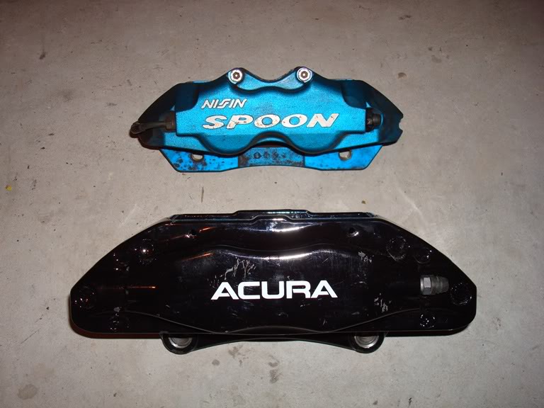

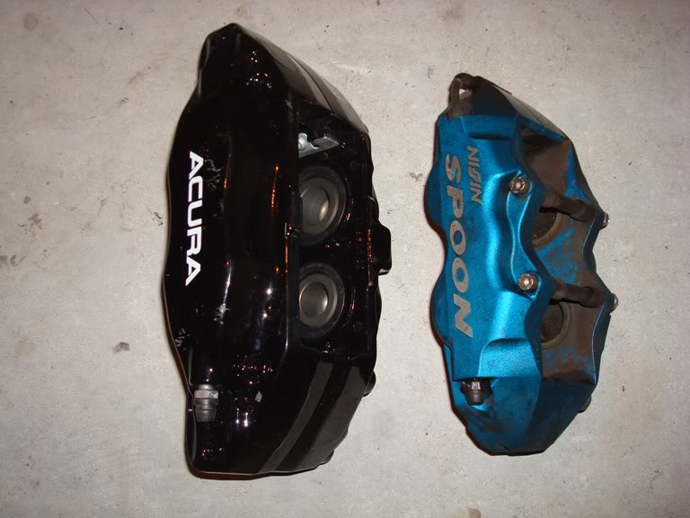

Few weeks ago, there is someone who wants to sell a Brand New Brembo GT Turismo Kit for Acura Integra NON type R (which will fit bolt on to Honda Fit Front Wheel). I almost bought this kit because he want to sell it for just $1,800 brand new !!! and he have this pictures of comparing the Spoon Caliper to
Acura Caliper (the Acura Caliper is the same size as the Brembo Caliper that he was trying to sell), and it really show how small the spoon caliper is. And I also realize that the Acura Caliper is also still small for an 18in wheel..., so I decided not buying that kit for Acura Integra and start doing my own research.
Now here is a pictures of Car with 18in wheel and FRONT 355mm Brembo Rotor with 6 piston Caliper:
The Acura/Brembo 4 piston Caliper is only about HALF the length of the 6 piston Brembo Caliper, and the Spoon Caliper is even smaller then the Acura/Brembo with 4 Caliper...

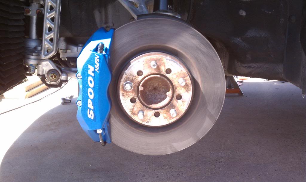

So go with the bigger Spoon calipers?
^That's on an NSX. Spoon caliper install
I only posted twinblocks since those have been done on Fit's with relatively little modification (just new rotors & 3mm spacer). The Spoon's above I believe will fit up to 320mm (from what I've found on the webz).
Comparison shot below. Spoon Twinblock Vs. Monoblock - EK9.org JDM EK9 Honda Civic Type R Forum
Those giant BBK's look great, but overkill on the Fit. Atleast you'll be able to stop on a dime.

but I might not install it until I have the front brake too,
cause it will upset the braking balance with the smaller stock front brake...

Wow based on the list above,
even a 6 piston Brembo Caliper is still LIGHTER then a stock Honda Fit Brake Caliper ???!!!
I am really surprised...
so "ahem", I am saving weight after all hahaha
(you know, self defending my show car mods hahaha)...
although I am pretty sure the larger 355mm 2 piece Brembo rotor will still weight much more then our current 1 piece stock rotors,
at least 6 lbs more per rotor...
