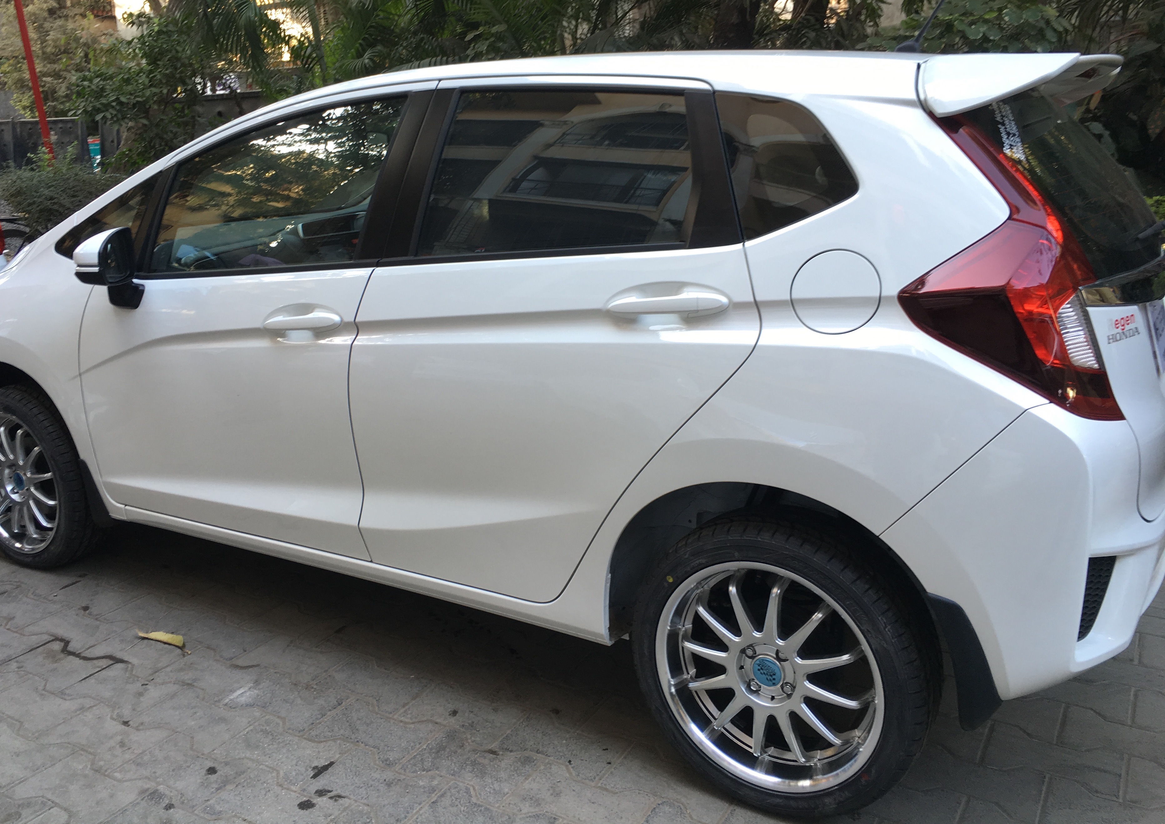

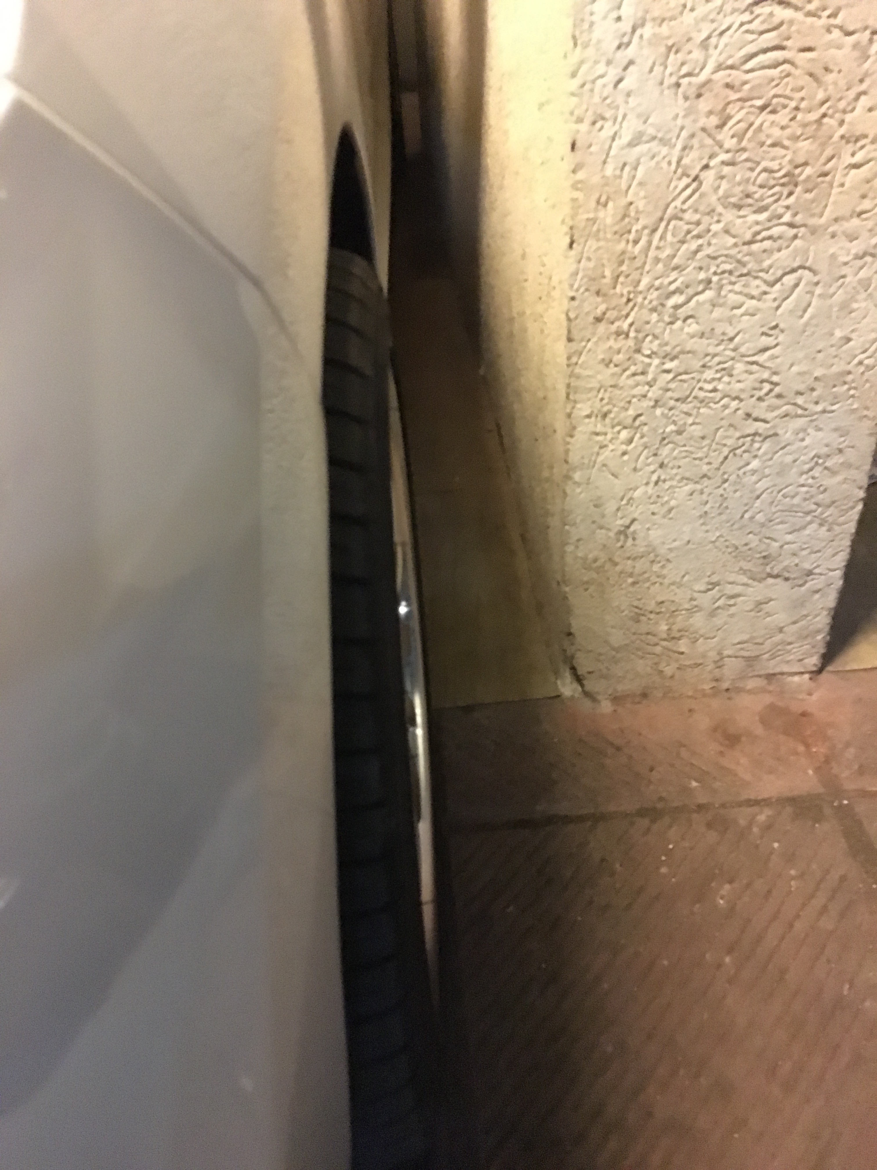

Hope this helps. Yesterday, I installed a new set of wheels.
SSWs 17x7. 38 Offset. No rub. Tires 205/45
And just today, I got a some Tein H-techs, mild drop. and no rub on speed humps, bumps, potholes...
I've read conflicting reports on the rubbing issue but i'm glad this set-up works but there's not much more room, 7.5 or a 7J with lower offset might graze.

Cool. Thanks for the info. I don't mind some grazing. You have any pics of your setup. I'm more interested in the amount of sidewall. I worry that there not be much with 17s.

I'll get some pics for you today. There's enough sidewall and still pretty comfortable, I'm running new Yokohama A-drives.

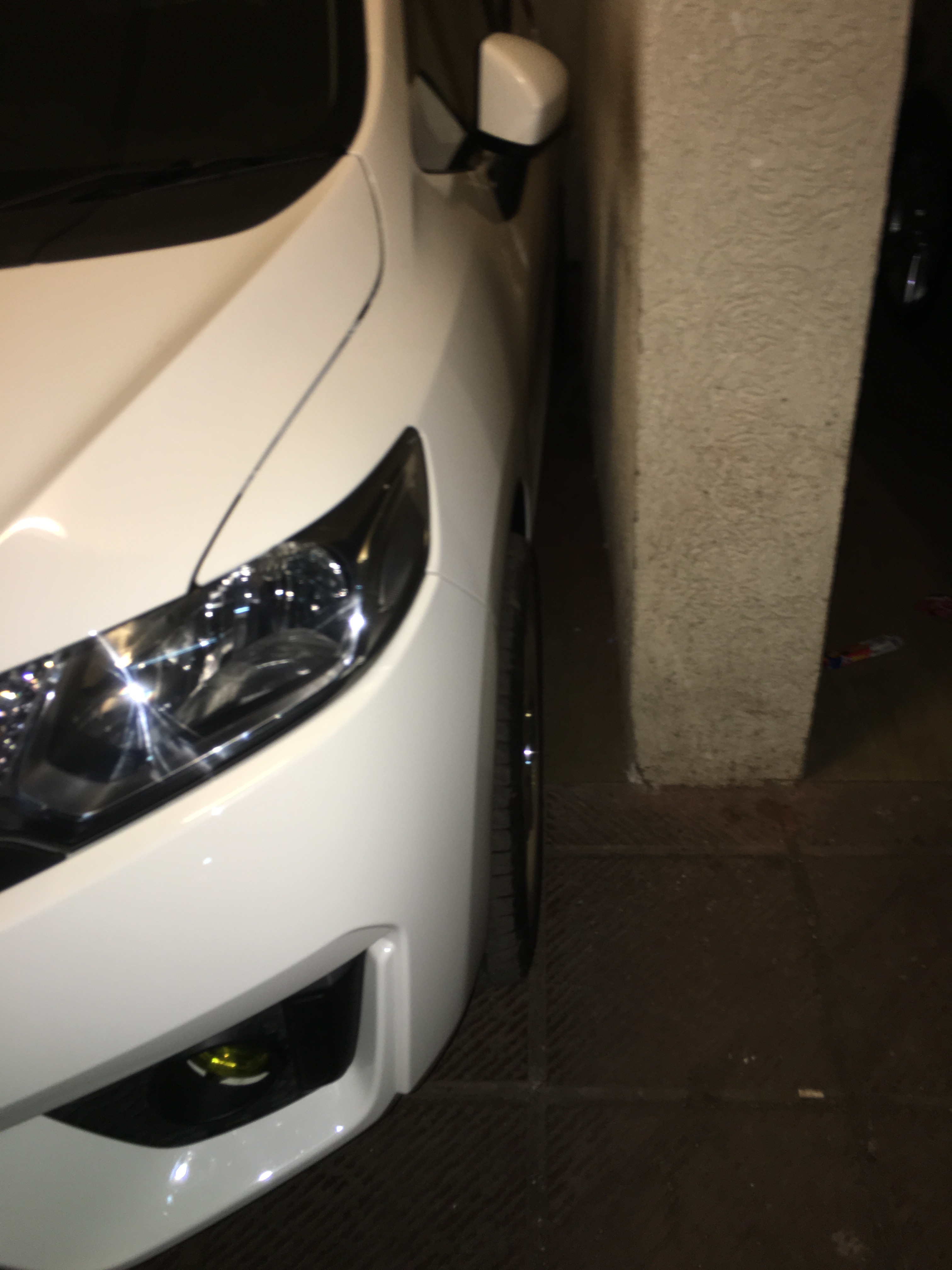

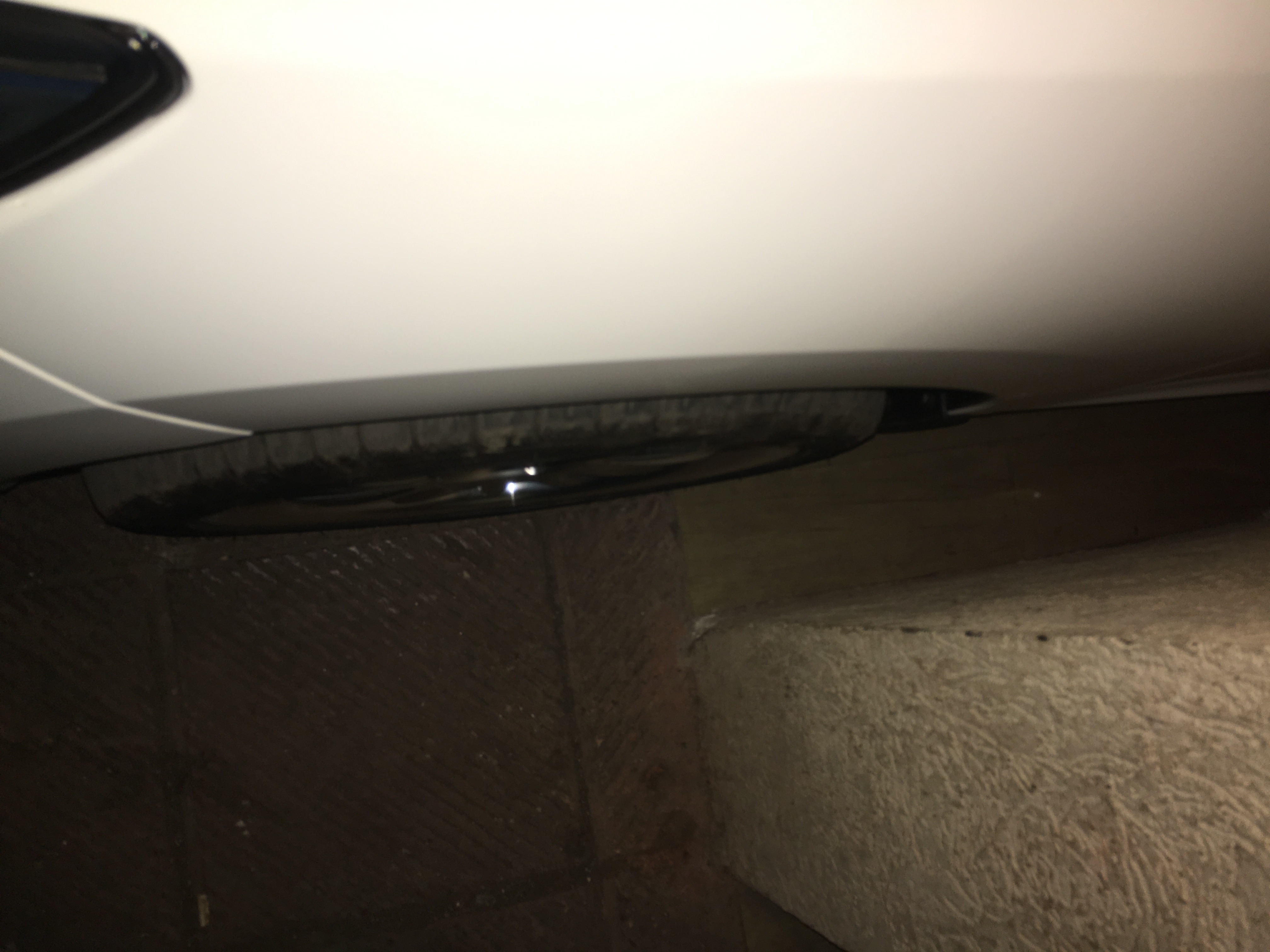

Before springs, and after springs install

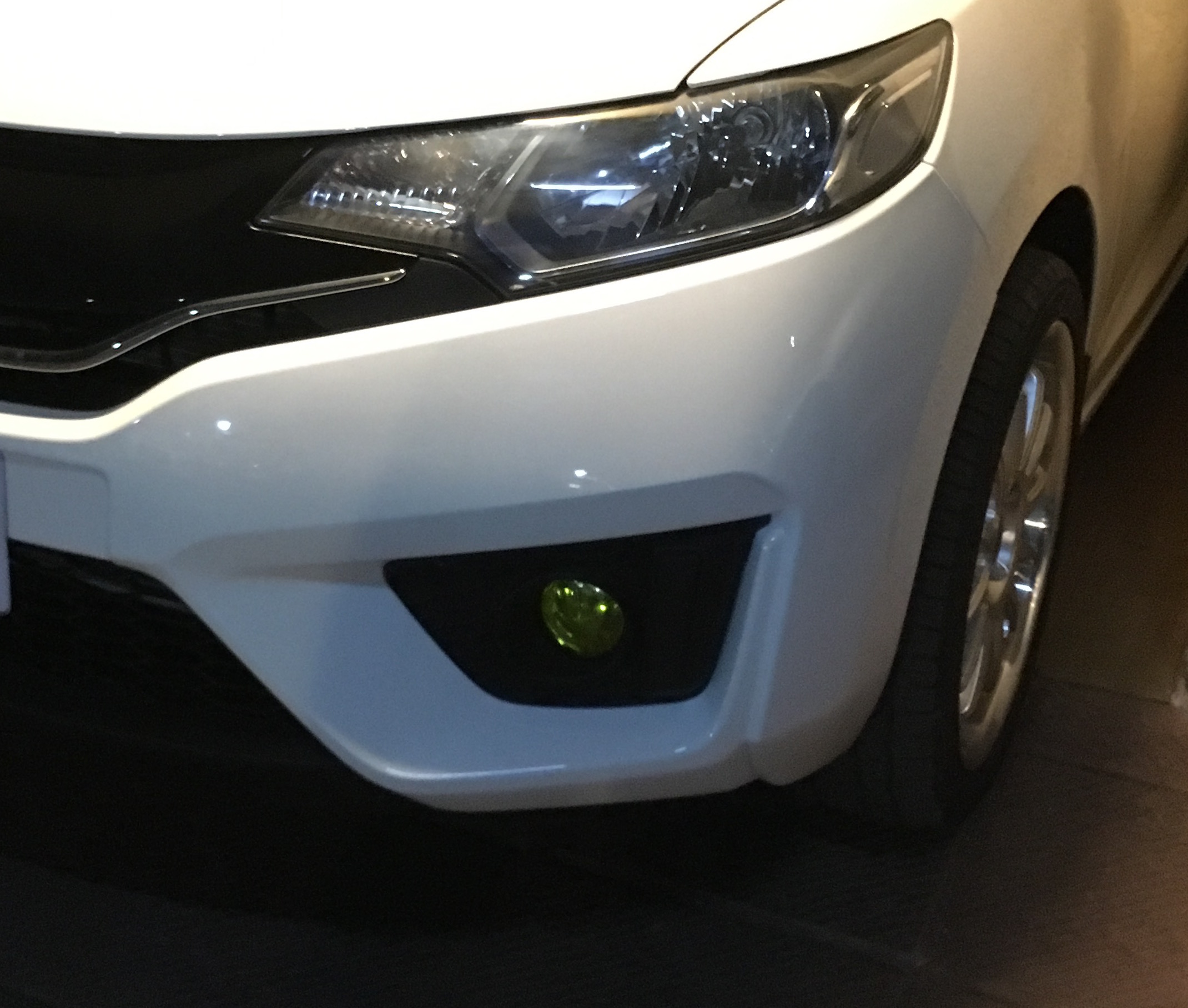

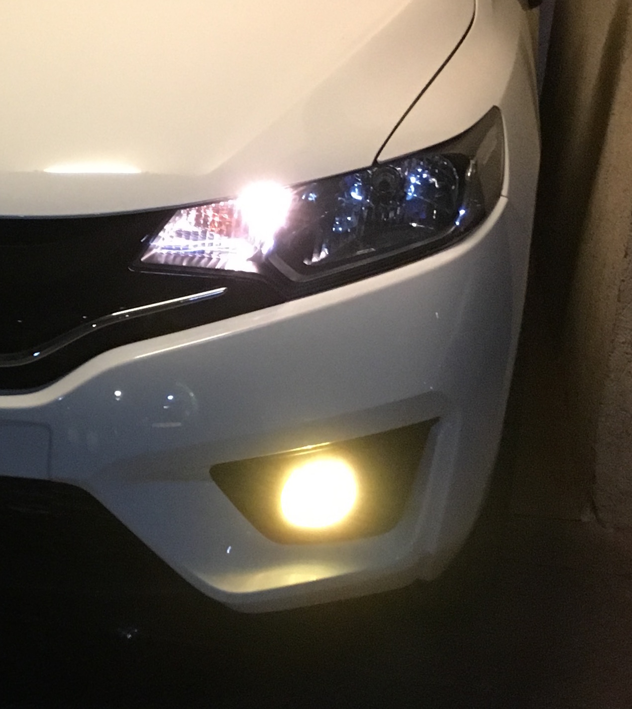

I also tinted the fog light in yellow, easy to DIY. You need a philips driver, scissor/blade, hairdryer/heatgun and a plastic plier/ruler to pop the fog lamp cover. There was a screw on my fog cover.
