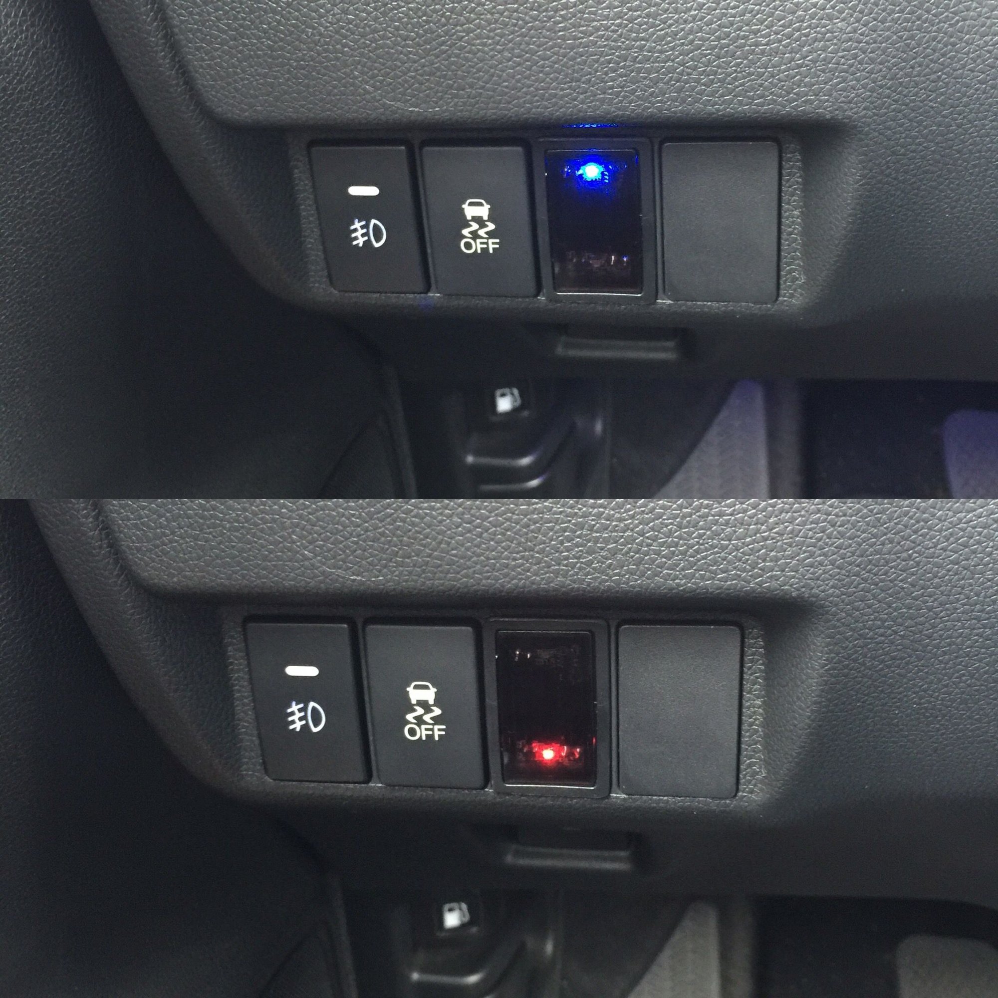

Added a touch switch for my ambient lights on Saturday. Had to trim a little bit of the plastic guard on it to get it to fit in there correctly.
Blue is on, Red is off.

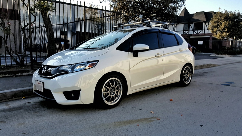

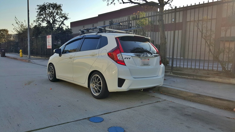

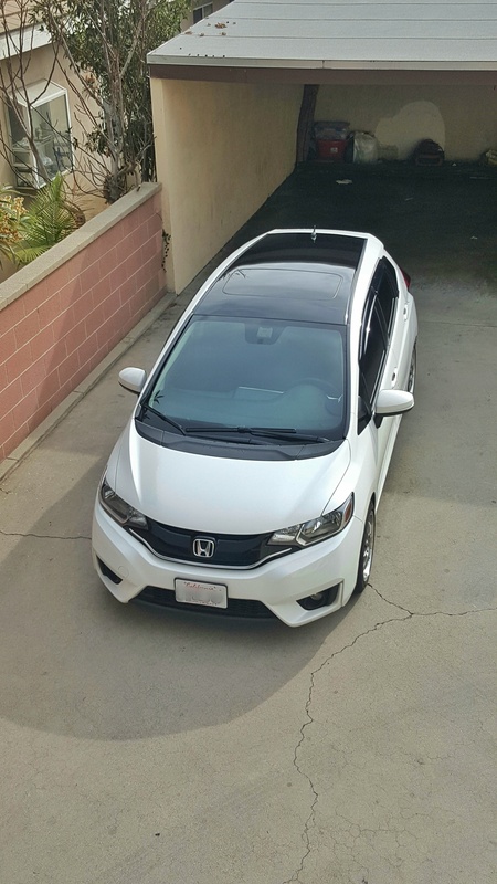

Well here's what I've done so far
What I've done so far.
Tein springs 1.6 front and rear drop.
Enkei J10 16x7 42 offset 195/50.
Black roof wrap.

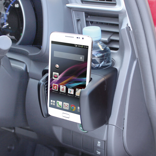

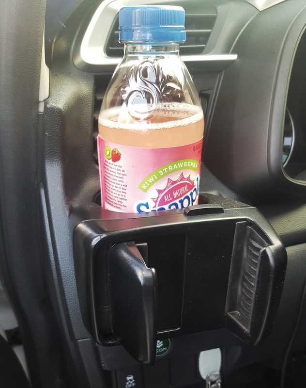

Japanese cup holder phone mount.

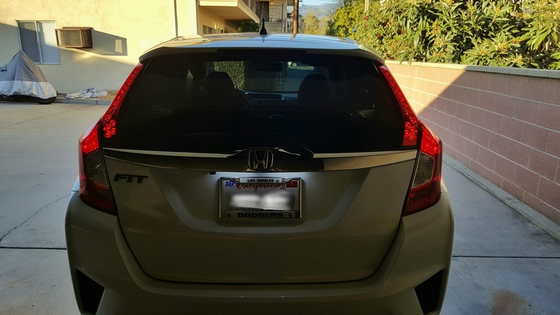

Rear led upper tail lights.
Blox mini antenna.
Honda window visors.
15% tint.
Thule roof rack.
Led interior lighting.

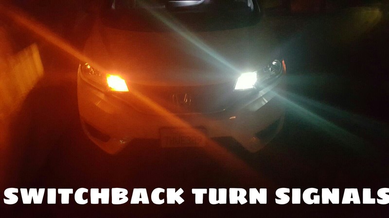

Front switchback turn signals.
Husky all weather floor mats.

Where the upper tail lights a direct plug and play or did you have to do some custom work?

What did you use for the switchback turn signals?

I had to make an existing hole bigger to be able to shove the connector in inside, then just tap the 3 wires to 1. 3rd brake light 2. License plate light 3. Ground. Took me about 1 1/2 hours since u need to remove part of the spoiler.

When it's on with ur regular lights instead of having an amber color I have white. When I use a turn signal it switches to amber.

I know what Switchbacks are, I was asking what specific product you used for it?
