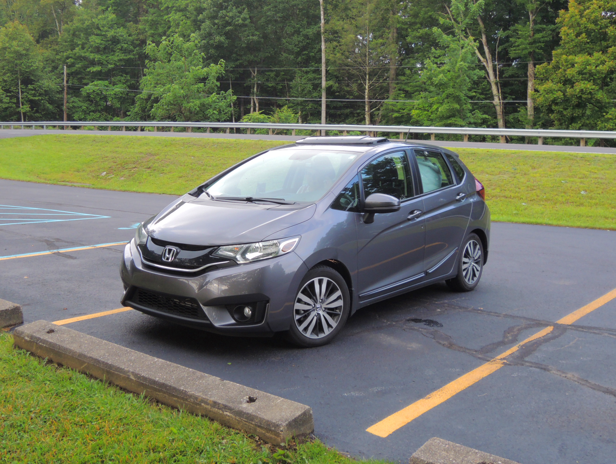

Road Trip!
We (I) drove our 2015 Fit (new in August '14, currently with about 9,000 logged miles) from Atlanta to Rochester NY and back, a round trip of about 1,900 miles. We were not sure of the comfort in driving such a distance, but Loki-chan was very comfortable, and performed without a hitch. I must admit that at 5'10.5", I pretty well max out my driver space. I have successfully found a long-term posture for my accelerator foot (by flexing the knee) and appreciate slightly more frequent stops than gas re-fills require, but all-in-all, we are definitely ready for long trips in the near future.
Road-weathered but unbowed, on the return loop in West Virginia:

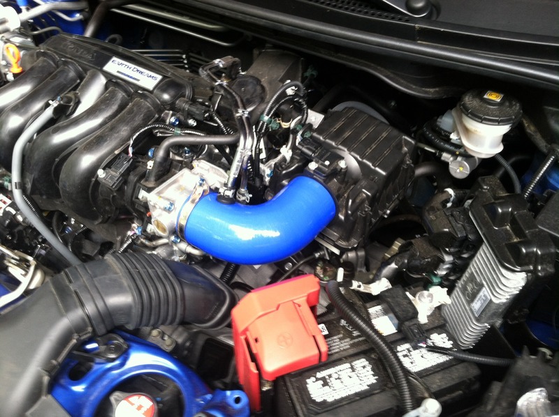

Made my own custom air intake. Removed the bottom box and the long pointless hose and box in the fender well. Very simple 2.5" silicone 90 degree hose had to cut a hole in the hose for the attachment. It sounds a little more throaty under acceleration and hoping for a little better mpg's. No cel so far after two days!

Nice! I think most cars will be free of CEL as long as the MAF is intact. However, direct injection might be slightly trickier. Fingers crossed.
Does the "pointless hose" generates more cold air previously? Or is it just a resonator to keep the sound decibel lower? I haven't gotten a good look at my engine bay.

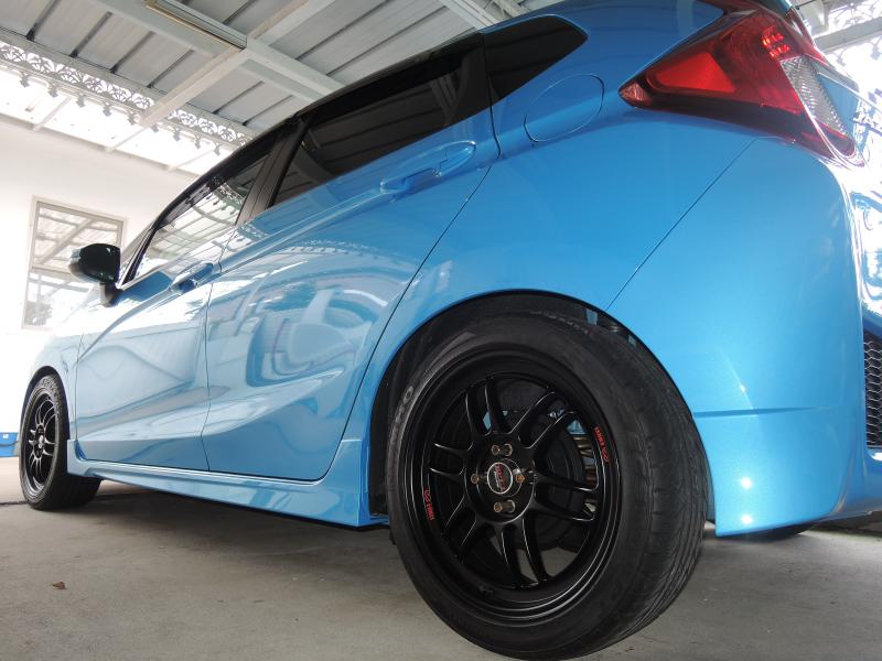

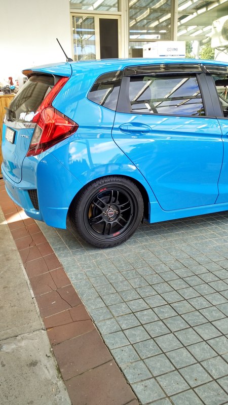

Installed NEW KYB Lowfer Sports suspension kit
Today I got my 3 month old Tien H Tech Spring removed and new KYB Lowfer Sports Suspension kit installed.
Reason for this, is because I want to lower the car by just a little and also to get better handling and control.
The Tein H Tech Spring does the job, but it makes the already bumpy rear end even more bumpy.
So, I ordered a set of new KYB suspension from Japan.
Part number: LKIT-GK5RS
It is made for JDM FIT RS, but it fit nicely and feel much more comfortable compare with Tein Spring.
For more info please see PDF link from KYB (Japanese only)http://www.kybclub.com/Release/news1..._Low_fitrs.pdf
With Tein H Tech Spring.

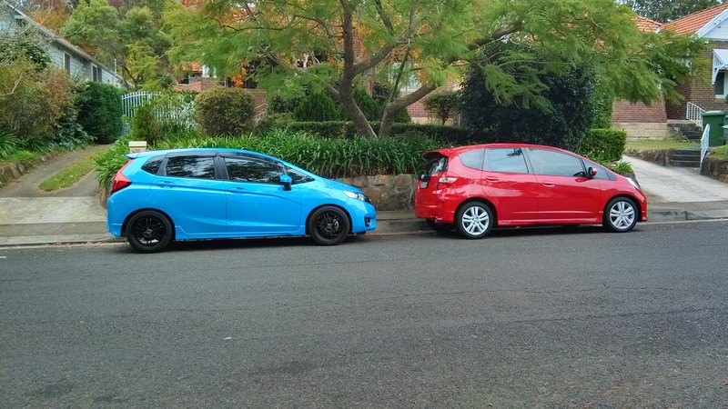

Taken with a parked 2nd Gen Fit. (With Tein H Tech Spring)

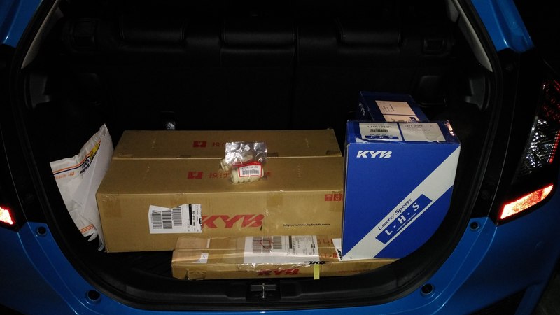

KYB Lowfer Sports Kit loaded ready for installation.

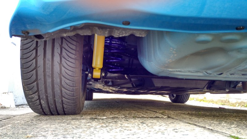

Installed. Love the purple spring + yellow shock absorber.

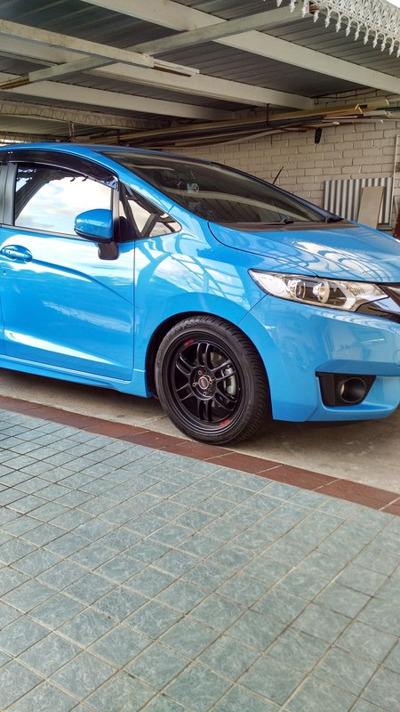

Front end with new suspension.

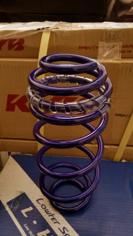

Almost forgot to share a little tip for this KYB suspension kit. I was recommended by another user to add some spring silencer. Because the rear springs do make some noise when larger movement occur (Up and Down).
So this is what I did. Bought some 10mm vinyl tubing from hardware store, and cut them like this then fitted on the rear springs. Just for the area I did in photo below.

Just to reduce sound. Pointless lol

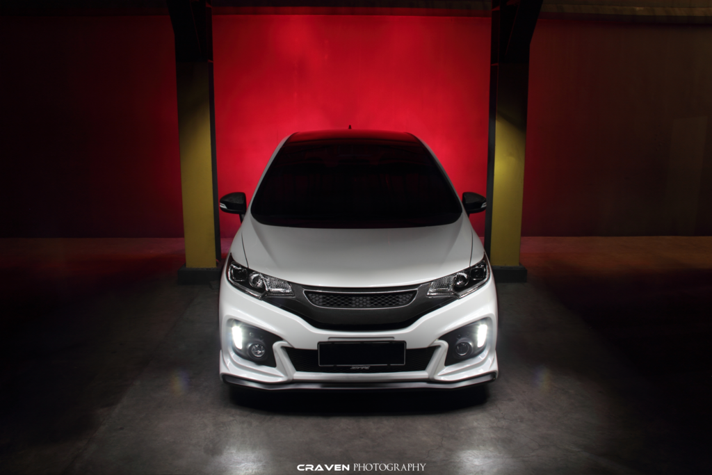

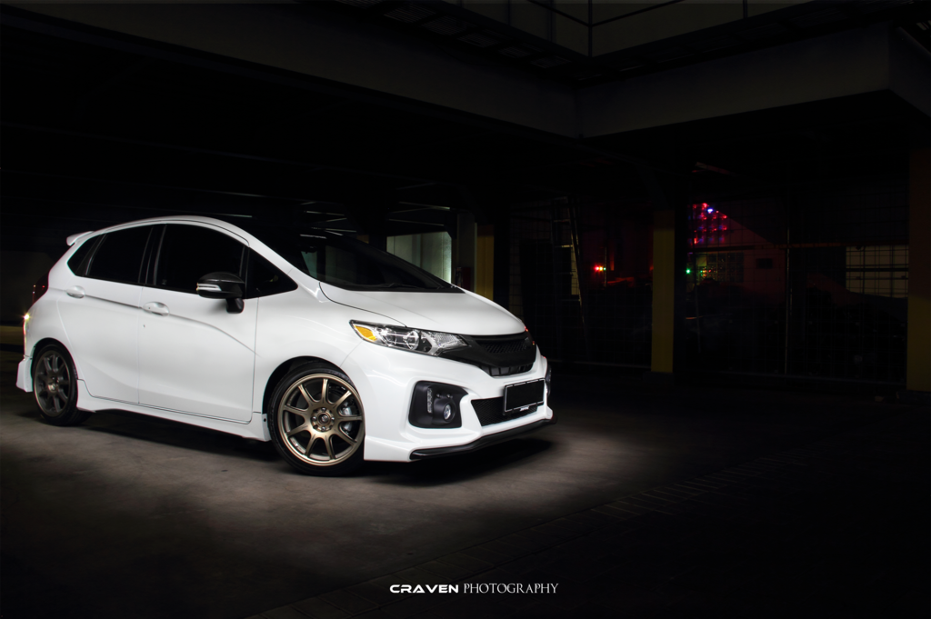

I was going to post these photos a few days ago

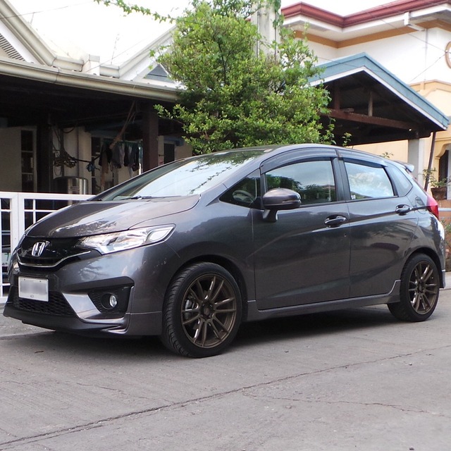

Wow that is nice! What rims are those?

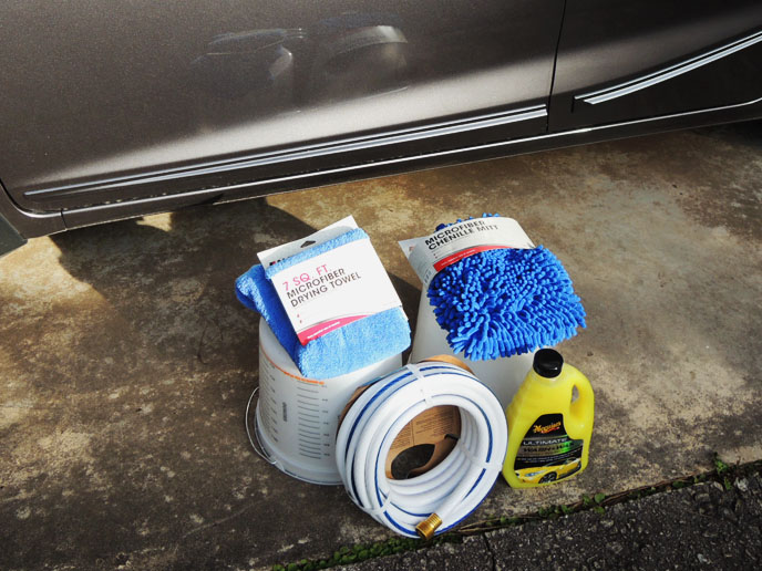

Hopefully more often
While morning shadows lasted in the car port this morning (preface to a Hot Day in Georgia), got in a two-bucket hand-wash with all the "right stuff". Loki-chan is looking good, and I'm feeling a little bit less like a slacker.

Rays Gramlight 57G 17x7.5 ET45
