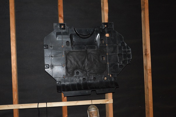

Old Jun 20, 2017 | 08:07 AM
  #197
wasserball's Avatar
Joined: Nov 2016
Posts: 1,098
From: Friendswood, TX
Originally Posted by TorontoBoy;
[/I
If you have the splash shield, then use it. If you don't use the splash shield, what will you do with it? Hang it on your wall as a reminder of inferior Honda engineering?
That's exactly what I did. I took your advice
Attached Thumbnails Anyone else get a loose engine splash shield under their car?-2ag_9094.jpg
Old Jun 20, 2017 | 08:21 AM
  #198
TorontoBoy's Avatar
Joined: May 2015
Posts: 938
From: Toronto, ON, Canada
Oh...my...I jest. Surely the splash shield is more useful attached to the underneath your car rather than protecting the inside wall of your garage?
Honda needs no more trophies for bad engineering. We also have the rear hatch cover, which, after it cracks, you can hang it on your wall. Thankfully I cannot hang up the 6th gear of my 6MT.
