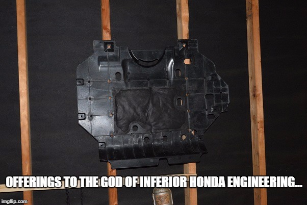

Originally Posted by Press Fit
That is the tidiest garage I've ever seen. I keep my splash shield on my car because there is no where to hang it!
Notice Honda provided the "Depend" pad to absorb the oil in the event of a leak. So, instead of getting washed out, it stays with the undercover forever. Great idea, Honda. It is not something you can go to the parts and say, I need some of them Honda Depend Pads
