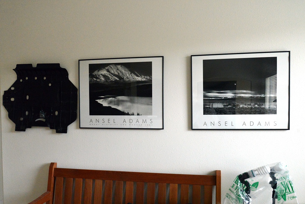

I turned mine into a museum piece after the first oil change.
Attached Thumbnails Anyone else get a loose engine splash shield under their car?-2ah_8847a.jpg

Great idea Wasserball.
That guard is a nuisance on the car. After every change I have to inspect it to make sure they put it back right.

If Honda went to the trouble and expense of designing it and manufacturing it, there must be a good reason.

Not sure if it rises to the level of Ansel Adams, but hey art is subjective.
Rather than blaming the splash shield, blame the Honda dealership/technician doing the work. The only time I've had an issue was when I let the dealership do their first free oil change. Since I've done the oil changes myself and haven't had any problems.

wasserball love the gallery.

I was going to make a joke about that, but I see the joke is hanging on your wall.
