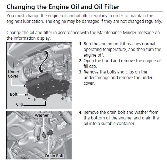

I think there is some confusion on what the part that is removed. The whole splash shield assembly is three pieces seen in this picture:
The center piece is the only one needed to be removed for an oil change. It is held on by 6 metal screws and capture nuts in the front, then 2 plastic push pins in the rear.
I remove the whole center piece, 6 screws and 2 plastic push pins. It only takes a few minutes.
Where you have problems is if someone rushes to put it back on. Doesn't slip the front piece under the bumper (it helps hold it on), or doesn't make sure the screws go into the capture nuts and tighten it down, or the plastic push pins aren't tight in the holes. Or a combination of.

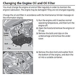

It is not a splash guard. It is called an under cover. Honda makes no claim that it protects anything.

Ezzactly That center piece needs to be removed. There are 4 pieces shown in the drawing (not including the fasteners). The large middle one is the one needing to be removed. It is made out of some kind of plastic. The small middle one, shown above the large one, is just a piece of an absorbent material, attached to the topside of the plastic large one. My sister calls it the "panty shield" or the "panty liner." My grandma calls it the "adult diaper."
