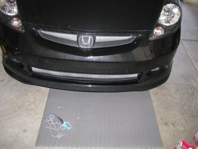

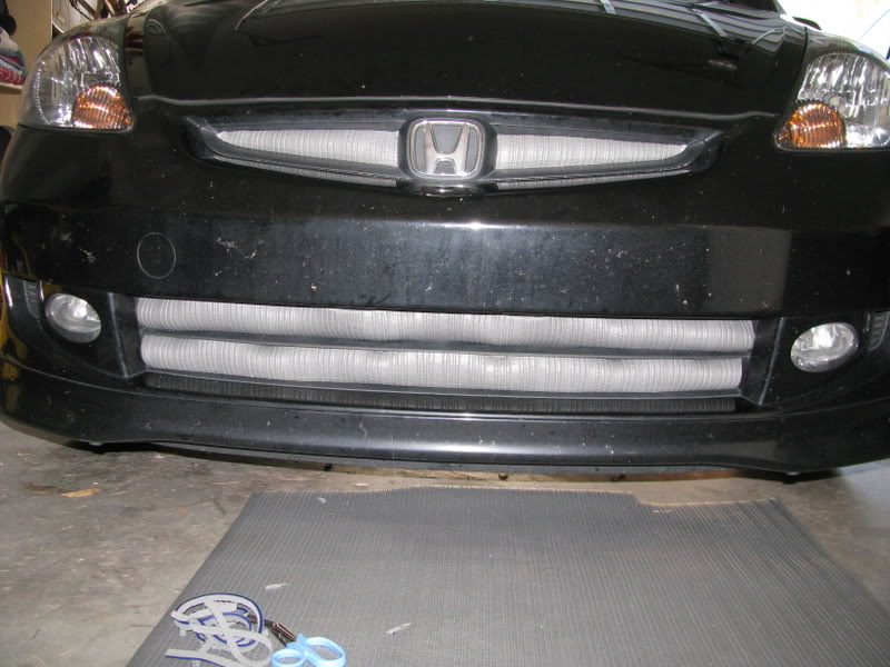

NO SGII here but I drove to work this morning with my full block in. I left with an outside temp of 33F and arrived at work at an outside temp of 43F. I drove about 60miles. NO engine over heating lights! Me likey!
The block:

Shawn,
I would not recommend a full bock like that for a few reasons:
1) You have know idea what the water temp is. Waiting for the cooling light (assuming it works) may be costly.
2) Most (including myself) that have done the block, found out if it's get hot enough to turn on the cooling fan, it negates any + FE. I could not hear it but could see the sudden temp drop on the SG.
3) My (master Honda Mech) buddy tells me for sure the SG numbers for Water Temp are BS and are at least 15F low. I know you don't have one, but if you did you would see 217ish. After he told me that, I took mine off.
4) IMHO The small FE gain is not worth the potential to damage the eng oil early and maybe hurt the engine.
Hate to rain on your deal, but figured it would be something to consider.
Now if you could rig it up so it was in place till you made eng temp and than removed that would be sweet!

Good Data Paul, I know your knee is happy and that is not bad for just CC at 55mph.
The only reason I did a full block was because of the cold temperature this morning. The evening commute was a little warmer but no problems noted. If it remains this cool for the rest of the week then I will be able to tell if this helps or not. If it gets in the mid 50's I don't plan on using the block. Well, I just checked the 10 day forecast and it appears it will be in the 60-70's I guess I will not find out if this block works for me or not.

Well, the foam wasn't worth a shit. I lost the both of the lower grille pieces, they fell out. I either need a more firm foam or plastic. I am definitely going to hold off on this. The next mod is to instal the Zeta Dead foot pedal(sitting at home waiting for me). I am thinking about the aero undertray though.
