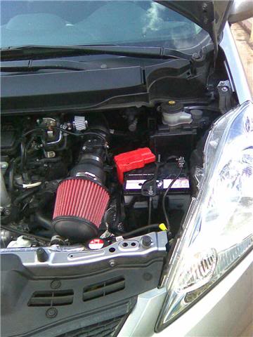

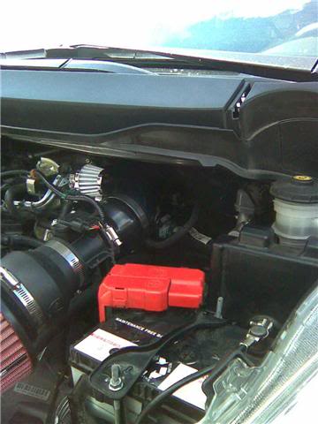

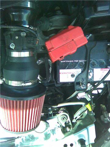

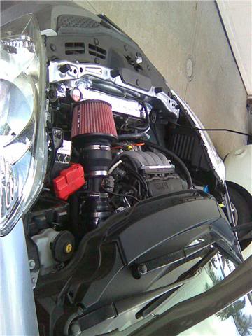

did my intake last night took idk 20 min... with the cutting but i went a little different route i got a coupler from the tb to a 3in. 90 deg. bend to another coupler to the mas/maf then from that to my filter. i noticed the there was a smaller filter in autozone so i used that

Very nice, that's why I like this, you have the freedom to install at any angle and with any filter you want. How's that look from rain though? Check it a few times after it rains to make sure you aren't running a risk of hydrolock.

yeah I wouldn't run the filter facing the direction the car travels. You do run the risk of getting water into the engine...although I doubt you could get hydrolock unless someone fed a hose to it. There is the risk of some water making it way through the grill and your filter is right there waiting for it. It's also going to be pulling hot air since it's close to the header. You're better off positioning it like Lyon did.

Only other thing I can think of is that it is directly above the radiator which should be a hot spot. I wish this engine bay had a little more room so you could route it to a fender or some other safe spot from there.

Interesting. Why didn't you want to utilize the under hood scoop?
I would also recommend making some sort of heat shield on the left side of the filter. You don't want the intake to get heat soaked from the engine right next to it esp. since there is no real cold air being fed to that location directly.

haha ya, i thought about pluging off the rad. plate that had holes for the intake but, when i noticed how the hood sat, taking off the scoop on the hood made the air flow straight to this filter location. then if any1 has noticed i dont have fogs.... i made a velocity stack fit in one of the holes for the driver side fog then i took 3in. dryer piping and made a ram flow right into the filter
and in the second pic. you can see the little tube from the ram. and there is a small area of the rad that you can see its blocked off so air is forced into the rad. ( for those with questions i will post in "what did you do...." thread)

I get you. Smart design. I would still utilized some sort of heat shield on the left side of the filter (between the engine and filter) to block off some of that engine heat. Utilize that ram air cold air even more. You obviously are good at fabricating stuff. A simple heat shield should be easy for you. You can probably use the stock air box screw hole locations to mount the air box.
Nice custom setup.
