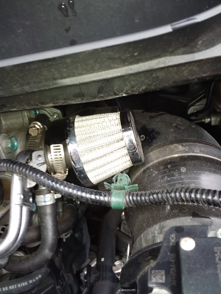

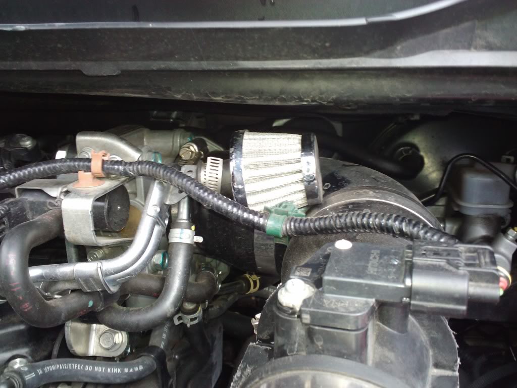

i was wondering if i needed a catch can or not but after a long time of driving without checkin the filter (like months) i bought a grey/silver one to check on dirt and oil build up but i got nothin, it was clean and i have it on an upward slant thanks to the metal hose clamp on the air intake
