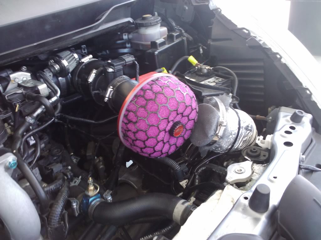

where do u think the cold air is comming from? i blocked off the rad so all air thru the front has to pass thru it. i have a little scoop from the grill thru to the air filter and i have my "ram" from my fog light housing. do u think im still in the "cold spot"
