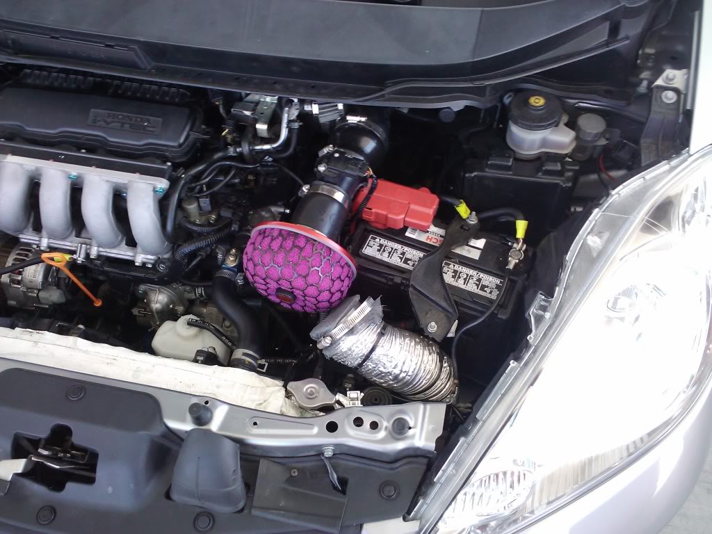

Finally got around to making my intake.
the 3" to 2" coupler I used from Lowe's was kind of on the larger end so i had trouble getting the intake in place.
So i decided to get a 2" 90degree elbow, connected that to the MAF and the TB in place of the coupler from the stock box.
my assembly is kind of large and i will secure it down soon. it is kind of stiff but still free floating right now, just resting on the front.
very nice, another person to go with the frontward facing design...check out my prog thread to see what else I did to mine!

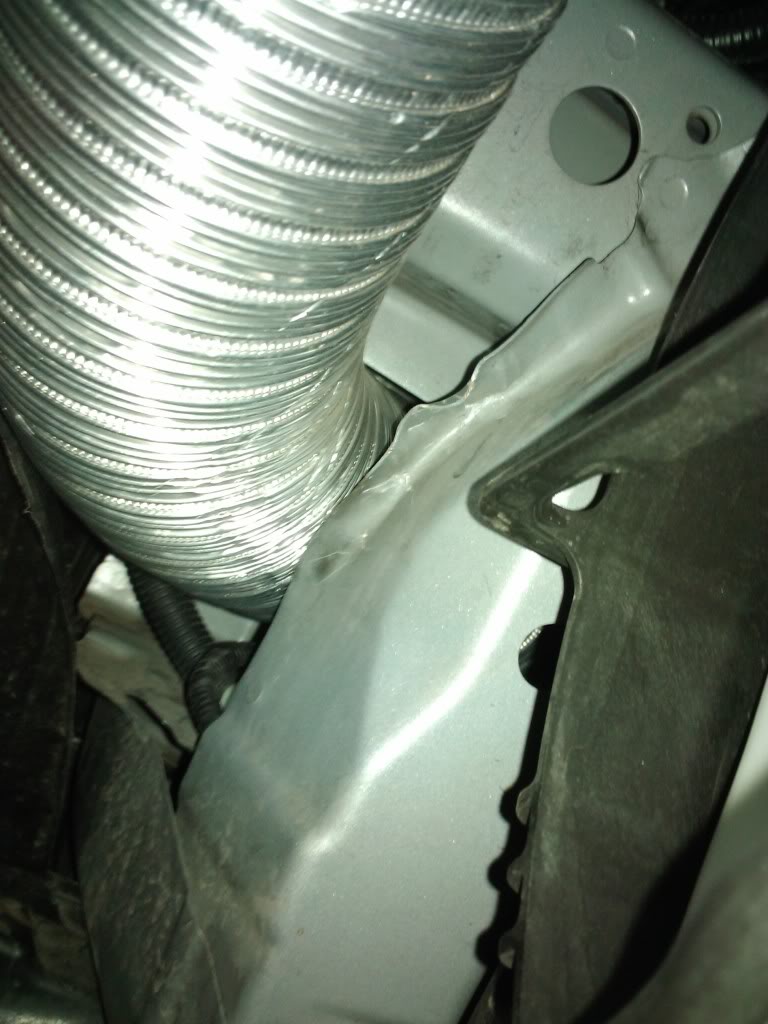

do you have any suggestions or tips on the heat shield? or making a bracket to support it?
edit:
i also removed the underhood scoop due to the positioning of my filter. the scoops lip was covering the front
I also removed that scoop, useless for the filter in this position. The heatshield is being held by two supports, one on the left and one on the bottom...i forget where in my thread it is but i should have some pics of the brackets i used. One is repurposed from the stock intake and the other i made from a strip of aluminum. I also made a securing bracket from an L brace to secure the filter to the heatshield bracket to keep it from moving. By doing this it also still moves with the engine because that bracket is attached to it.
Heres the pic of the left bracket

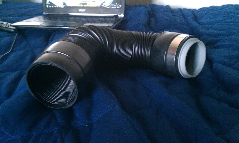

DIY Ram Air coming soon.
