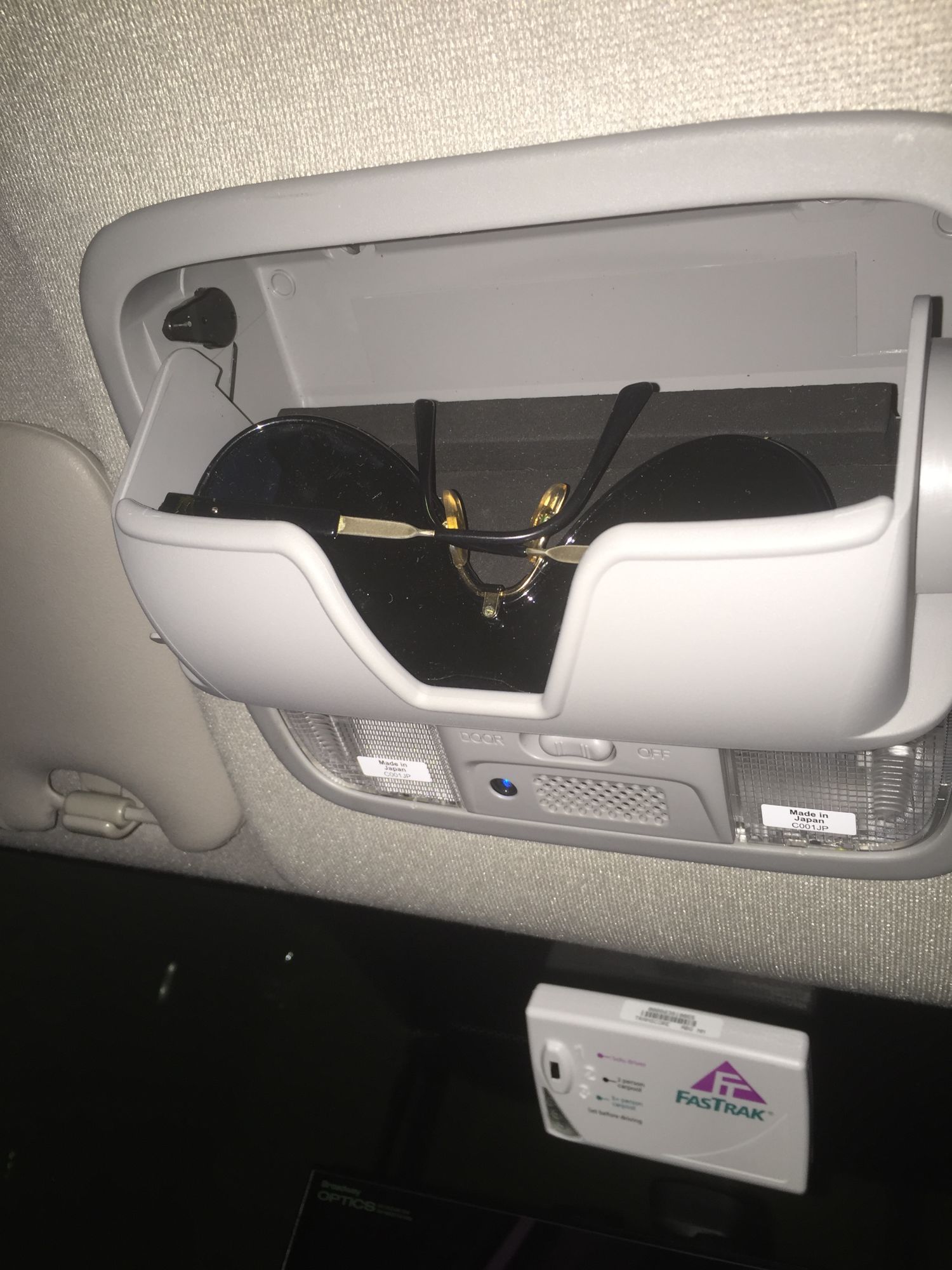

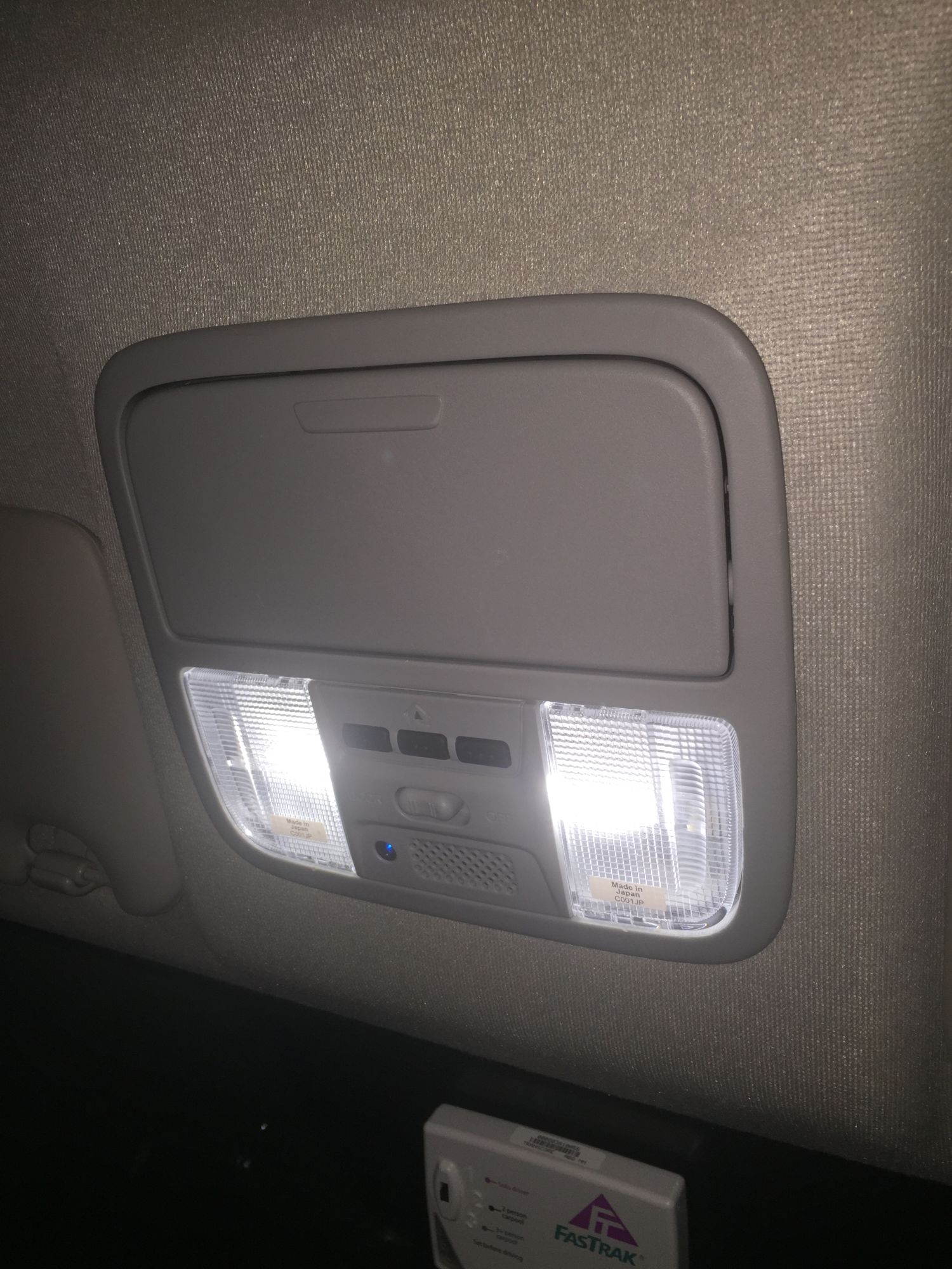

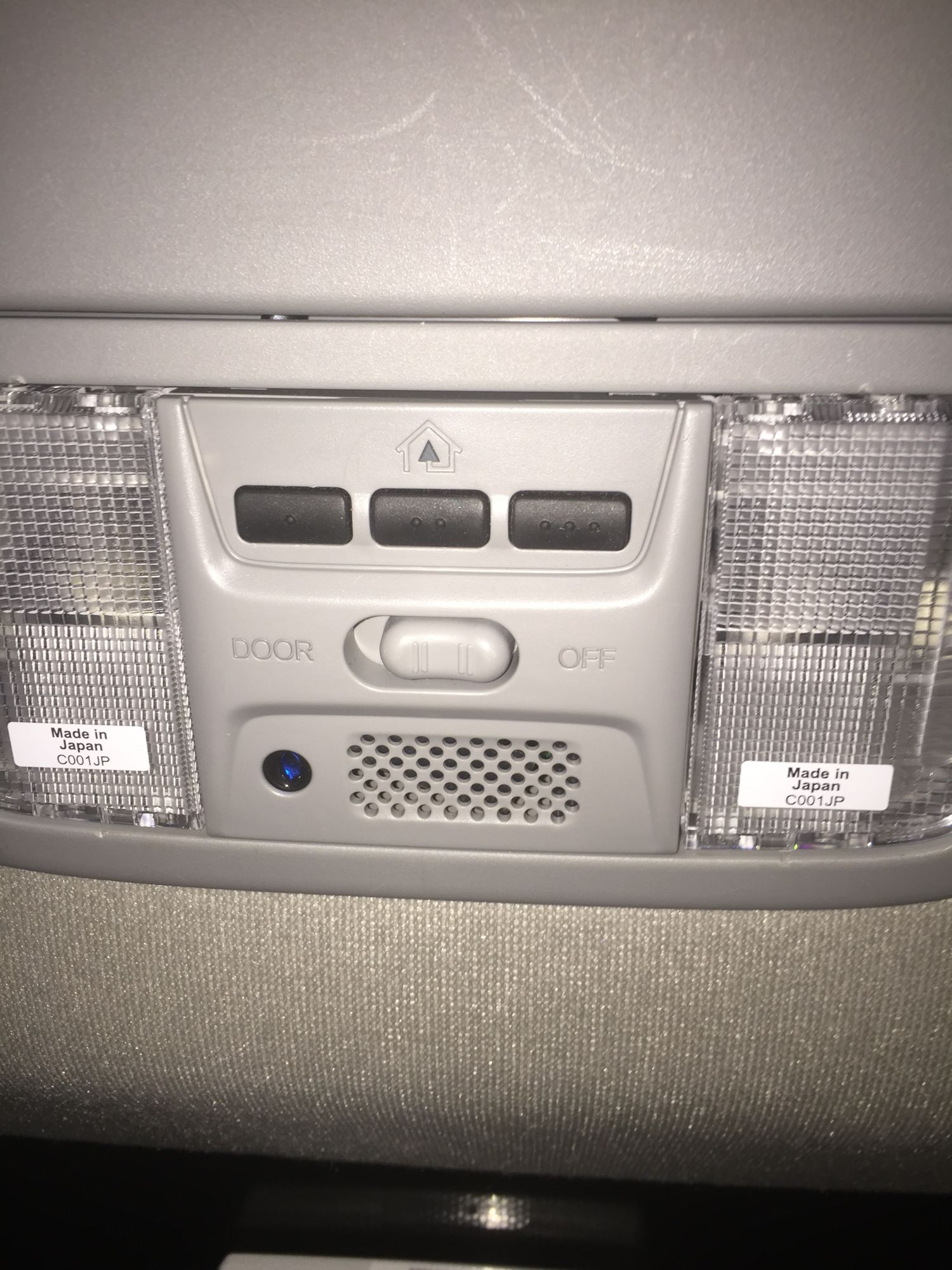

Testing and Programming the Garage Door Opener,
and work right away,
here are the pictures:
Notice the nice cool blue ambient light built in on this Acura Unit,
and notice the big space for the sunglasses,
this really makes the car feel more luxurious

Unfortunately I don't because some one else already make a DIY about this one here,
it is just that I think that one do not have the sunglasses holder and not running the microphone wiring and the ambient light not connected to another ambient light wiring like I did.
Basically you need to connect the two LIGHT green wires from the socket behind the garage door opener together,
then connect the black wire from the socket behind the garage door opener to a ground,
connect both white/blue wire from the two socket behind the garage door opener to the pink wire from the car wiring that goes to the original dome light as permanent plus power source...
then connect another wire DARK green wire from the socket behind the garage door opener to the blue wire on the center dome light which function as the ground switch to the car door.
another thing is, you need to put somekind of spacer (I use thick 1 inch foam) to space out / Lower the headliner so it would meet the lips
of the garage door opener (this is only if you buy like mine where it have sunglasses holder).
otherwise there will be huge gap between the headliner and
the garage door opener assy.
(when I say garage door opener I mean the whole assy above include the domelight/sunglasses holder etc)...
You also need to cut the headliner if you decide to got with the one with the sunglasses holder,
be careful, one mistake and you had a hole on the headliner hahaha
Now, if you decide to use the ambient light, or run the wiring for the mic,
this is where it get more more difficult.
because you had to run the wiring through the A Pillar, down to the under dashboard.
You need to remove the sun visor, (there is a youtube video from Honda Owners on how to do this)
then you have to open the door handle at the headliner,
to allow you to have space to work your hand under the headliner and pull all the wiring...
I also use wire loom to protect all the wiring so it reduce the chance for short circuit to the car body.
then pull all the door weather sill,
then you need to slide the wiring between the A Pilar plastic cover/and A Pillar metal parts down to the lower dashboard.
If you have ambient lighting already, you can just splice the wire to the LED and connect it to the garage door ambient lighting,
if not, then you can tap one of the interior light so it turn on when you turn on the light.
My JDM ambient lighting had dimming circuit so it is even better.
By the way, I also have an ambient lighting kit combine with illuminated door sill (OEM Genuine JDM Honda Access for sale on this forum), this ambient lighting kit do not HAVE auto dimming though, but it have
the same cool blue color that will match

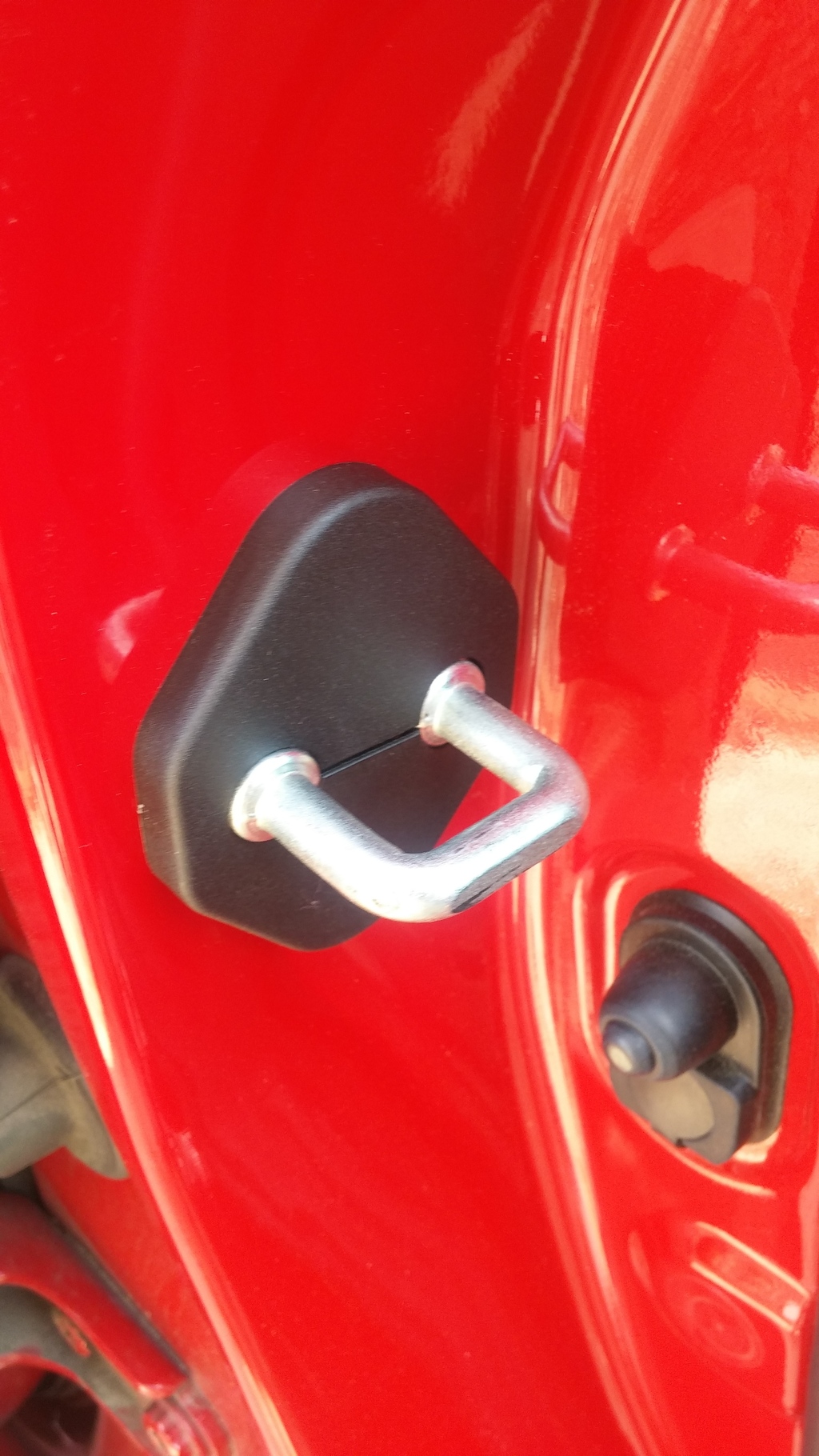

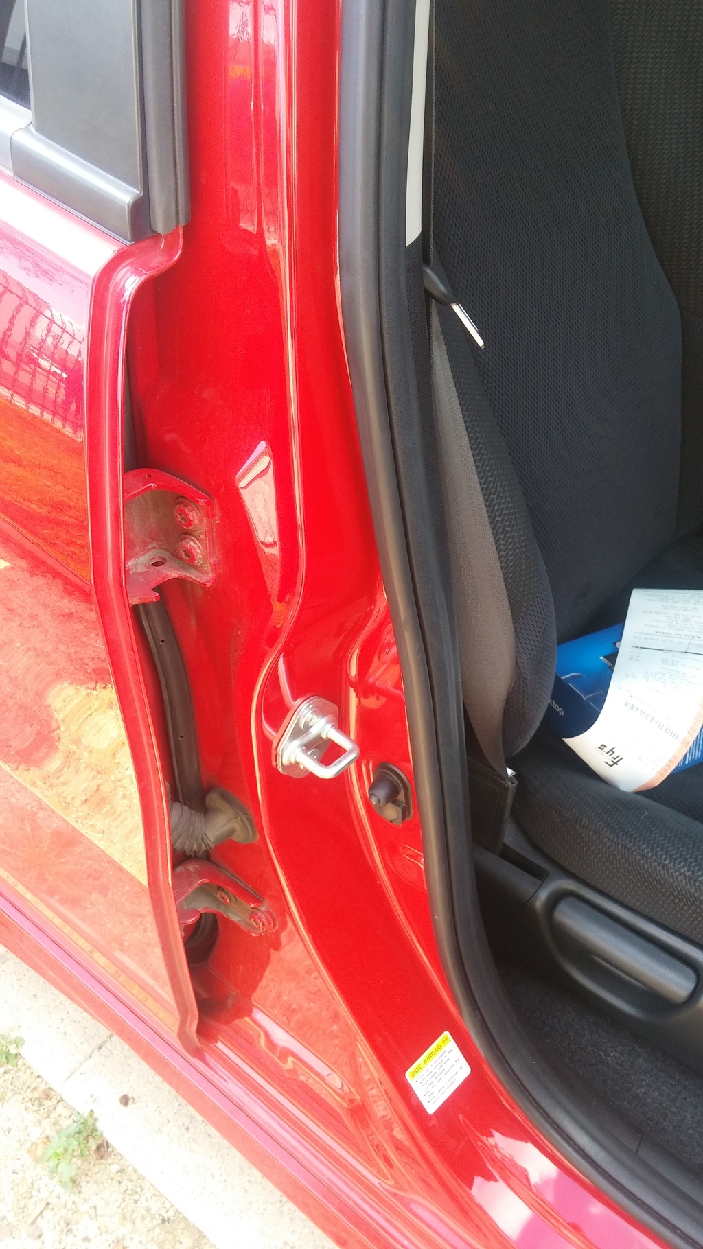

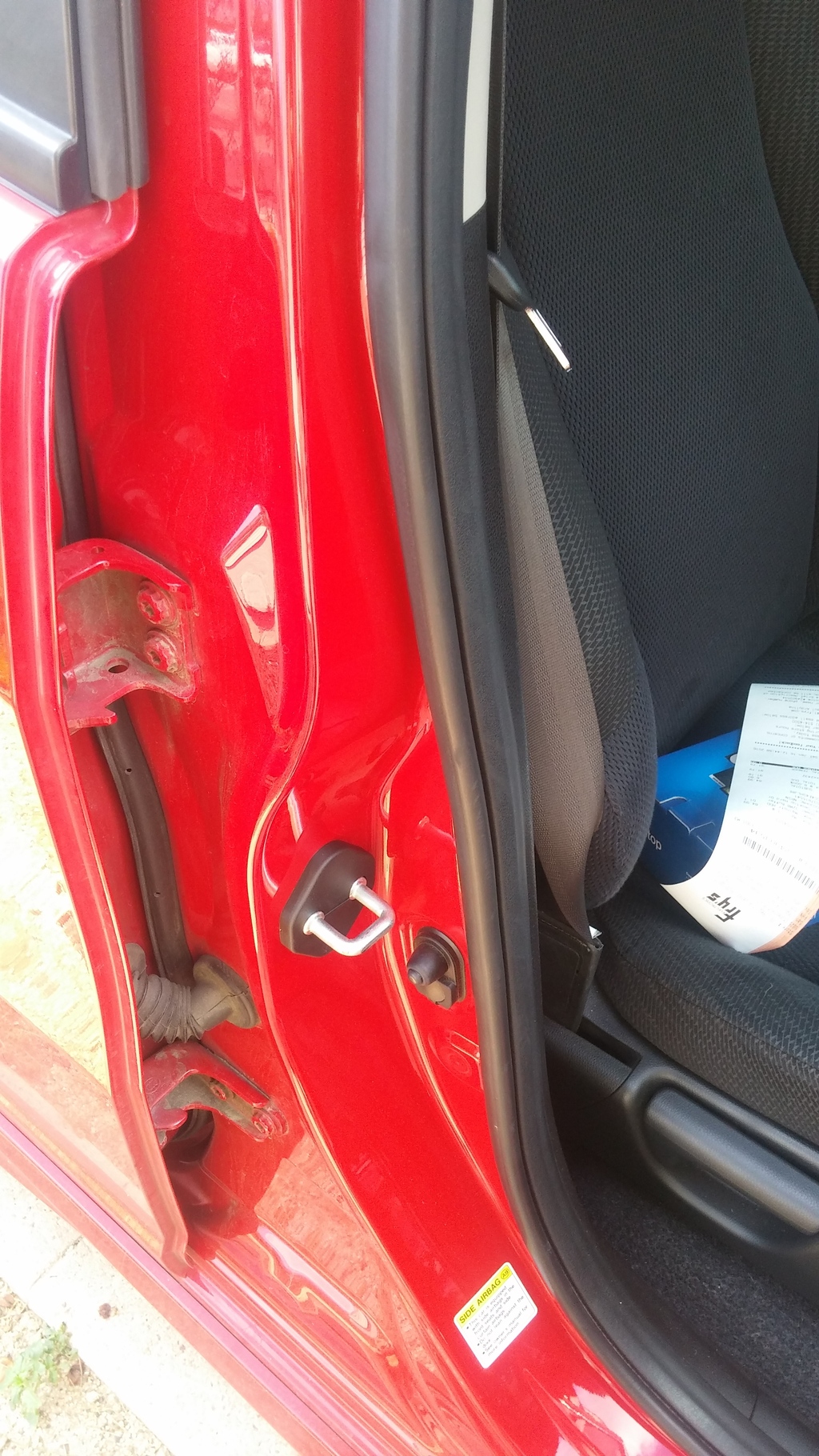

Added these door latch covers I found on ebay. They simply snap into place, fit super snug and look clean. May have to do the door hinge ones next.
Before and After.

Hi, the plug from the OEM Honda Fit Sport map light is totally different than the Acura one,
but when I buy the assy (used on eBay),
it came with the 2 socket and have some decent wiring length behind the socket, so I just SOLDERED to the wire from the car wiring.
(No Tapping for me, only hard soldered ).
Secure it to the roof is using the same 2 bolts holes because the bolts holes
are exactly same spacing.
I did have to change the bolt though because now it need longer bolts.
I also put some double tape behind the sunglasses console,
because on our fit there is not place to bolt it,
in Acura it use 4 bolt, front where the light are,
and rear where the sunglasses are.
Plus when I cut the headliner, I cut it very tight so it help hold it also.
