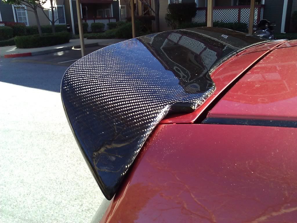

Originally Posted by space egg
i know the GD mugen replica will not fit a GE with just tape.
I had to drill holes in tailgate, and then seal the gaps between the spoiler and the tailgate with black silicone sealant. it worked great, and it looked pretty good, but i took it off, and wouldn't recommend it. also if you want you can have my GD mugen replica it is CF you can see it on my car in some of the pics from the page on my sig.
i recommend just buying the spoiler you like for the GE. or go no spoiler at all! the fit looks great without (if lowered)
Hmm.. it looks like it's fairly similar to the OEM spoiler as you can see here:
Not sure what to do about it.

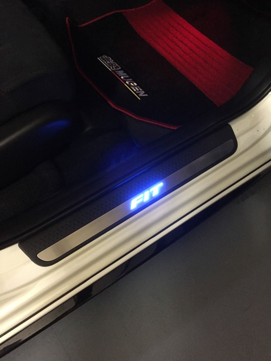

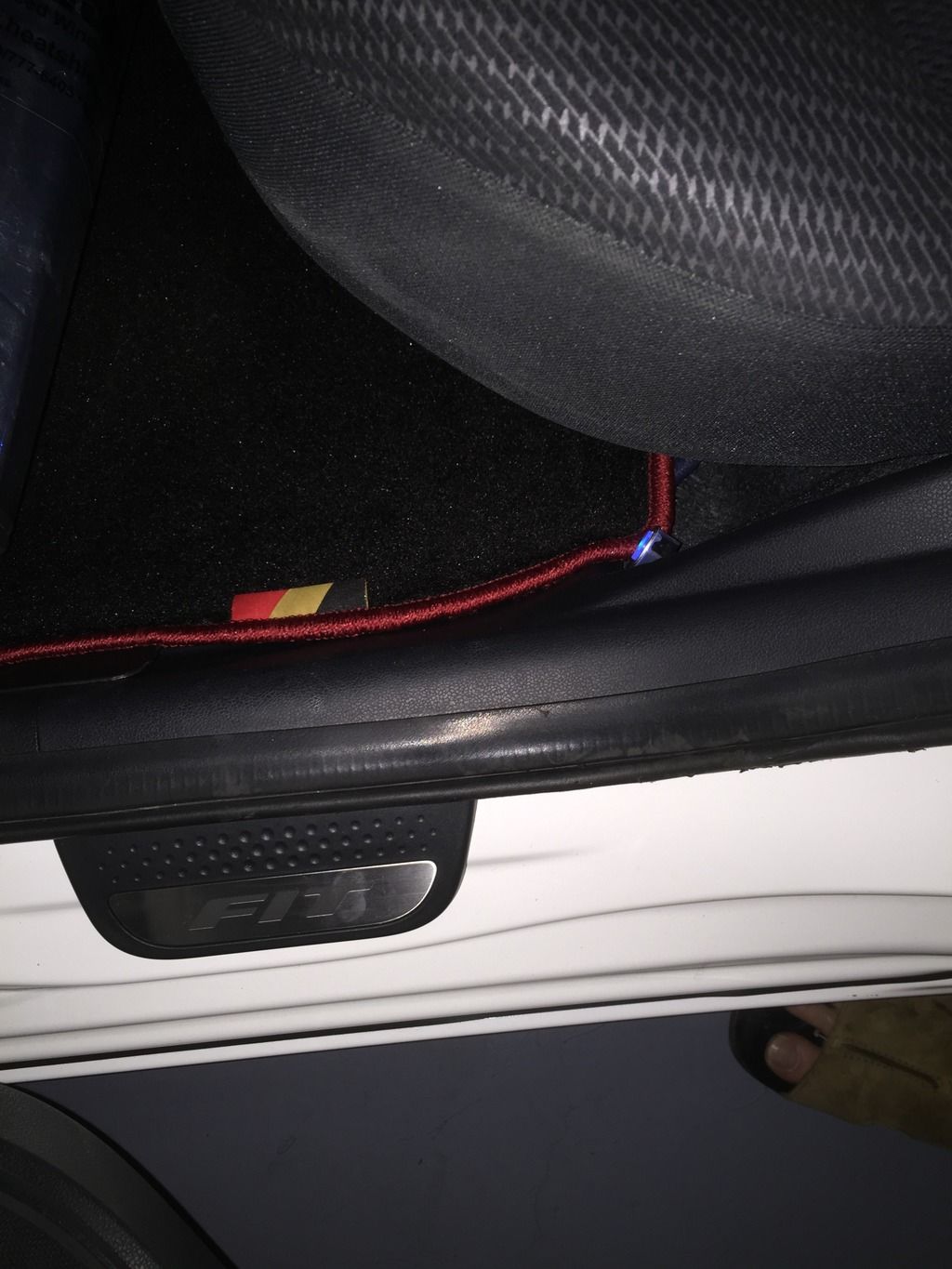

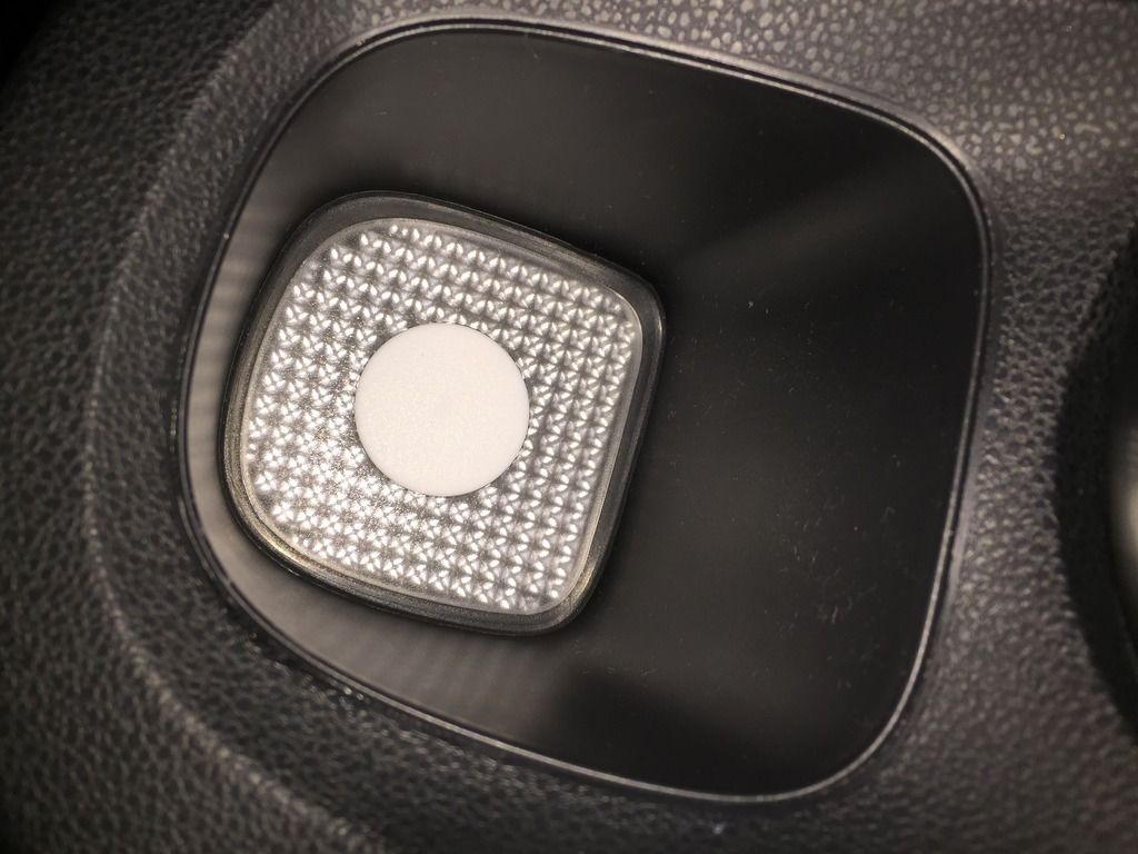

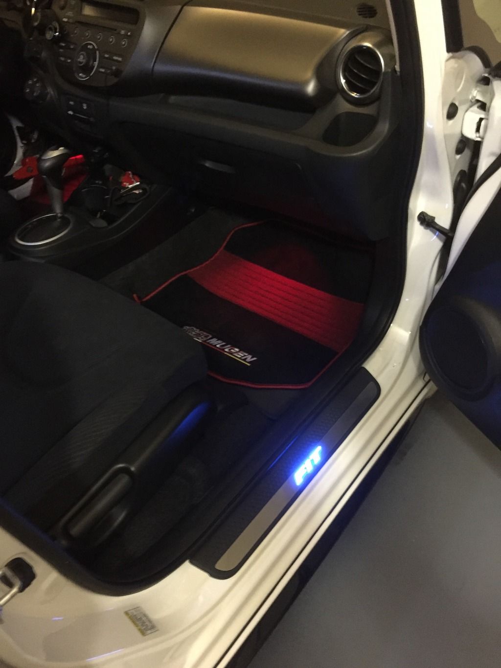

Installed JDM Honda Fit Illuminated Door Sill + Ambient Light + Illuminated Cup Holder.
Need to make the wire to the Driver Side/Left Side Illuminated door sill longer because this kit was design for JDM Right Hand Side,
so have to solder an extension.
and since I already have the Red JDM Ambient Light up front,
I decide to also get an extension and run the blue LED ambient light
that came with this kit to the side of each rear seat for REAR LED Ambient Light.
I also install my JDM Mugen Fit RS floor mat (this one have the center part for the rear passenger), and much better material than the USDM one.
oh also different color then USDM one.

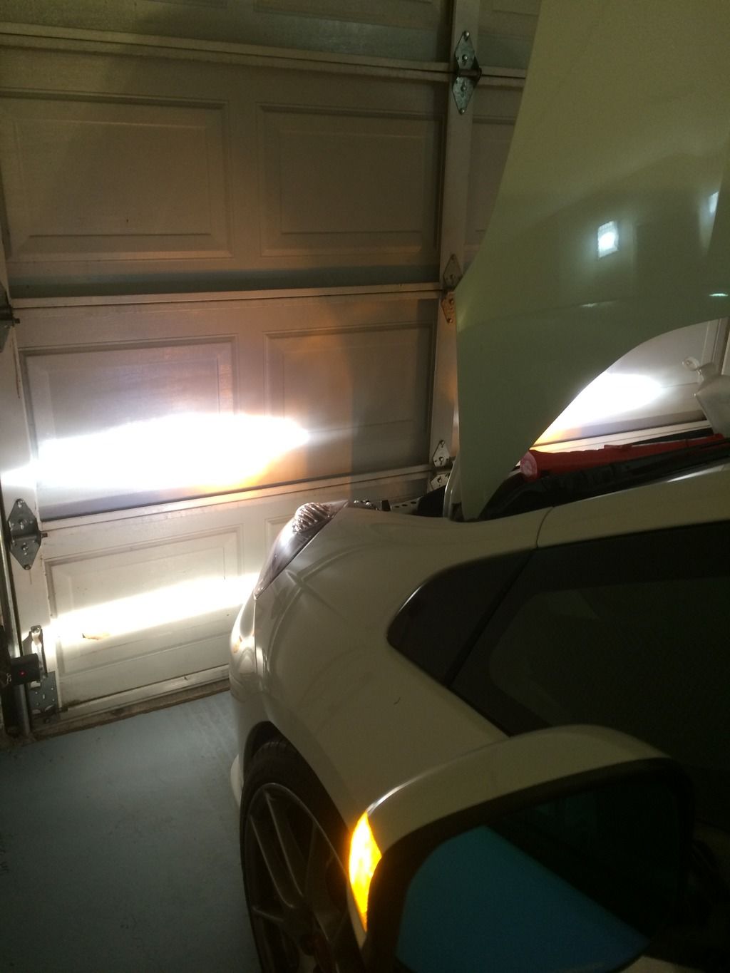

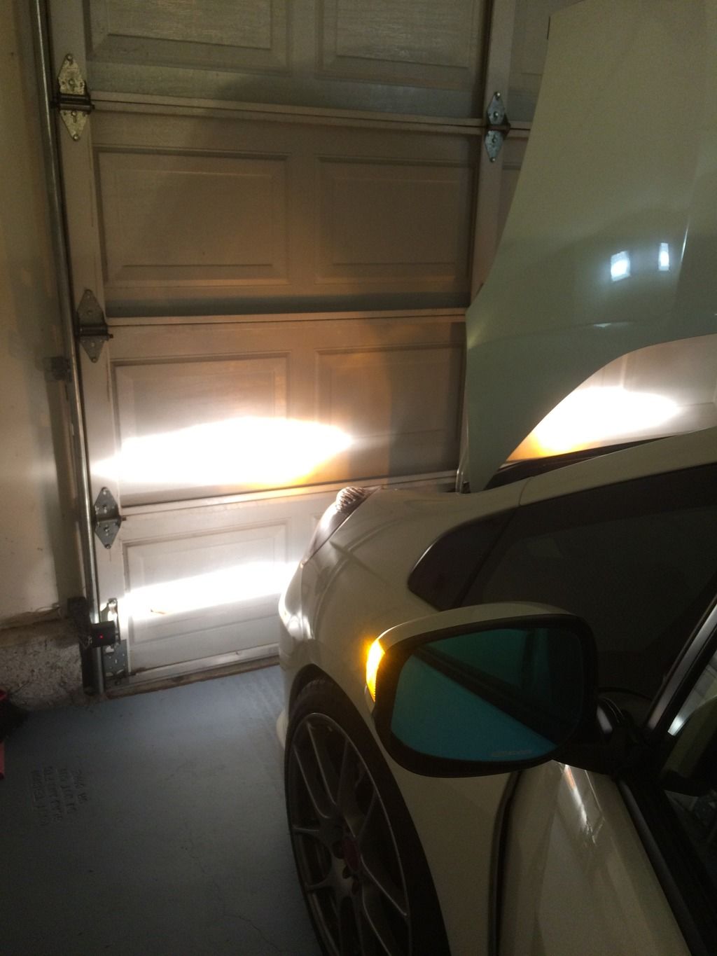

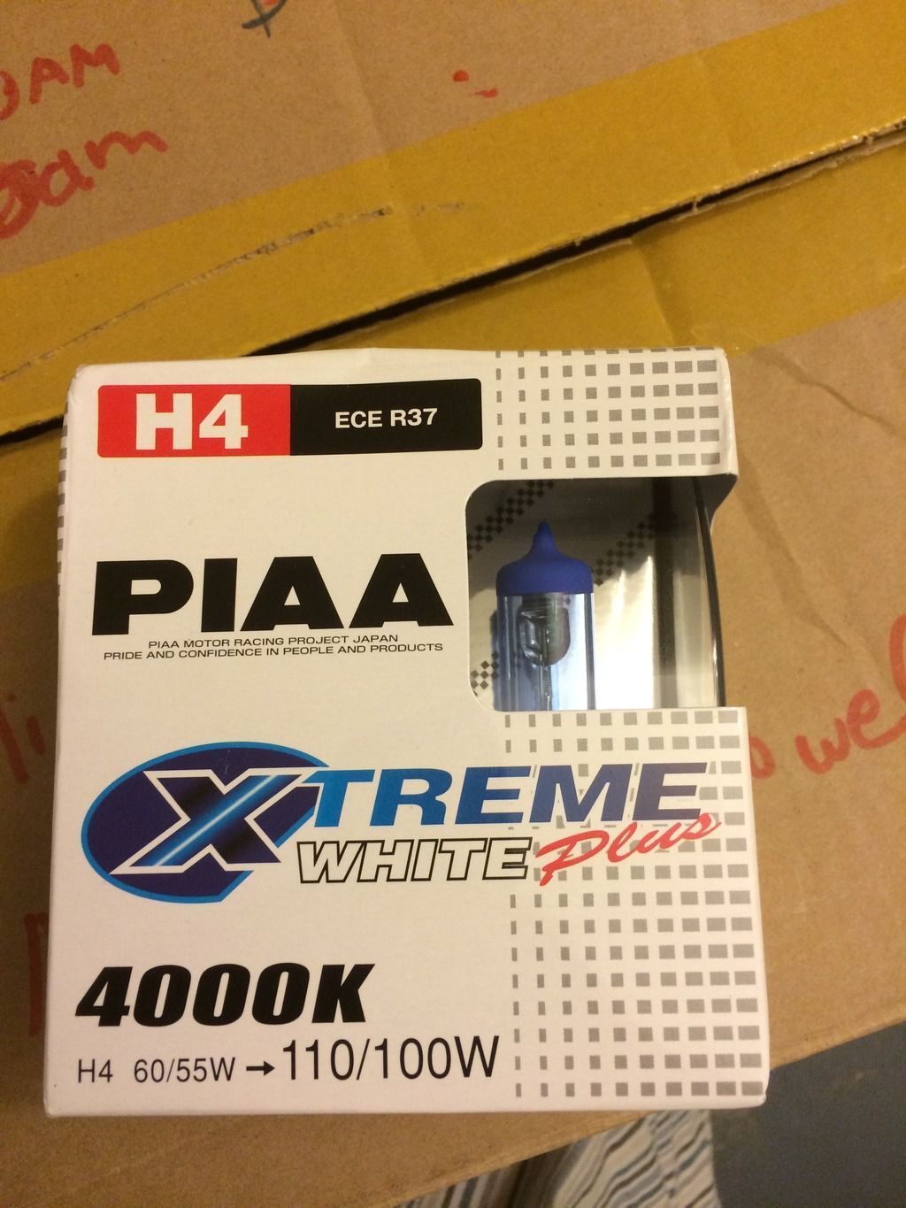

and last Install my PIAA Head Light,
I was thinking of doing the full V-LED front LED headlight conversion with switchback, but after reading that it have problem with the cutoff or not working well, I decide to just do a PIAA bulb conversion...
Don't want to do HID retrofit because I just don't like the idea to open the headlight housing and then do a JB weld cause worry it might crack someday or not holding it strong enough since if I do HID I will prefer the big Lexus double beam HID projector... which will be big and heavy one...
anyway, I am quite please with the PIAA Head Light bulb conversion,
might change the bulb on the foglight too with the same xtreme white bulb from PIAA later.
Here are all the pictures:
On the road, it also translate on better cut off and shine further and wider.
The FIT lighted blue color on the front door sill is very bright and gorgeous,
also note the RED Ambient Light (from my previous install/JDM Fit front LED RED light that can dim automatically if you close the door),
shining on the JDM Mugen Fit RS floor mat:

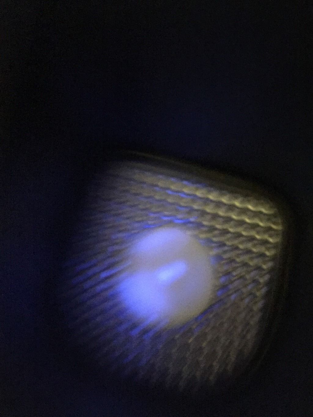

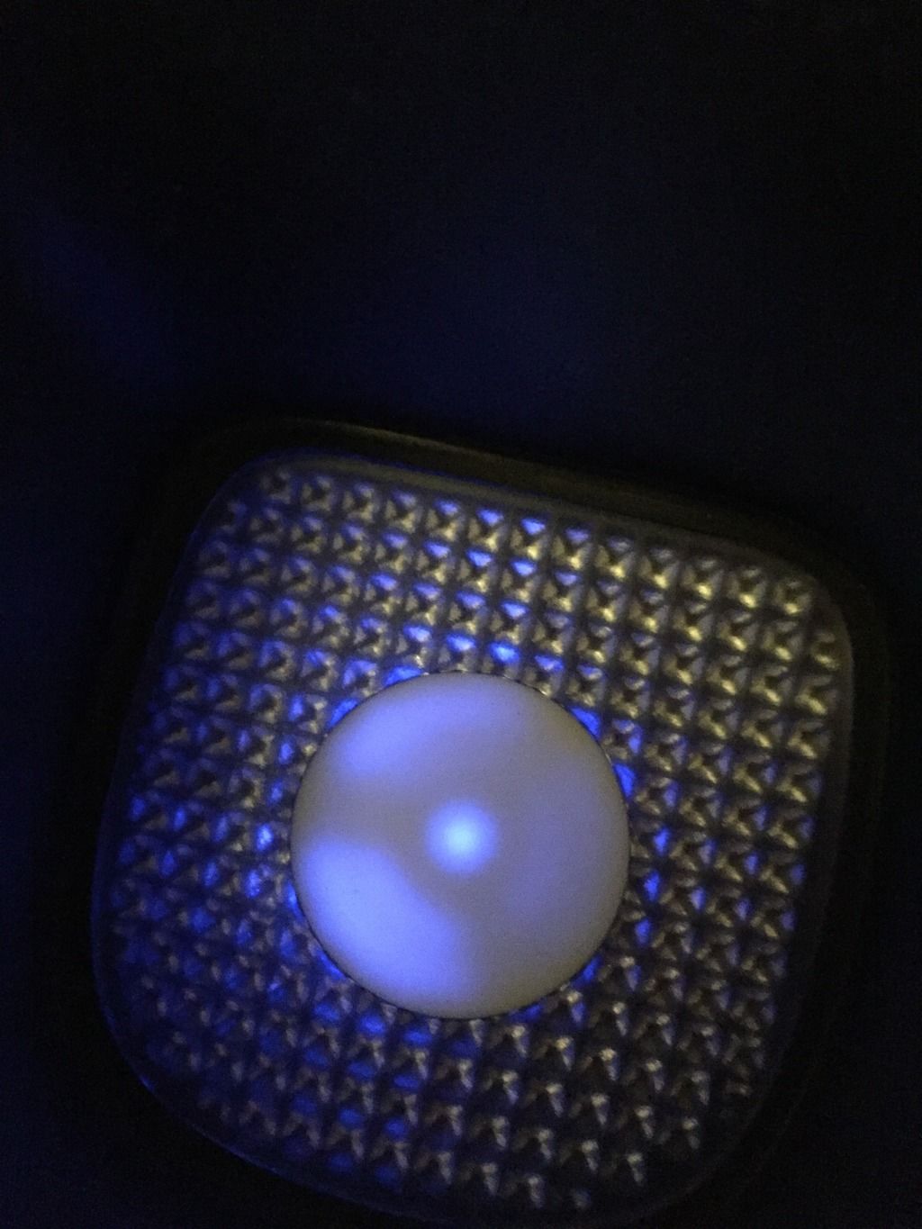

LED light inside the cupholder make the color of water in your water bottle
to be bluish
REAR Ambient LED Light on the corner near the rear door sill,
I run the wiring through the side lower plastic panel (hidden):

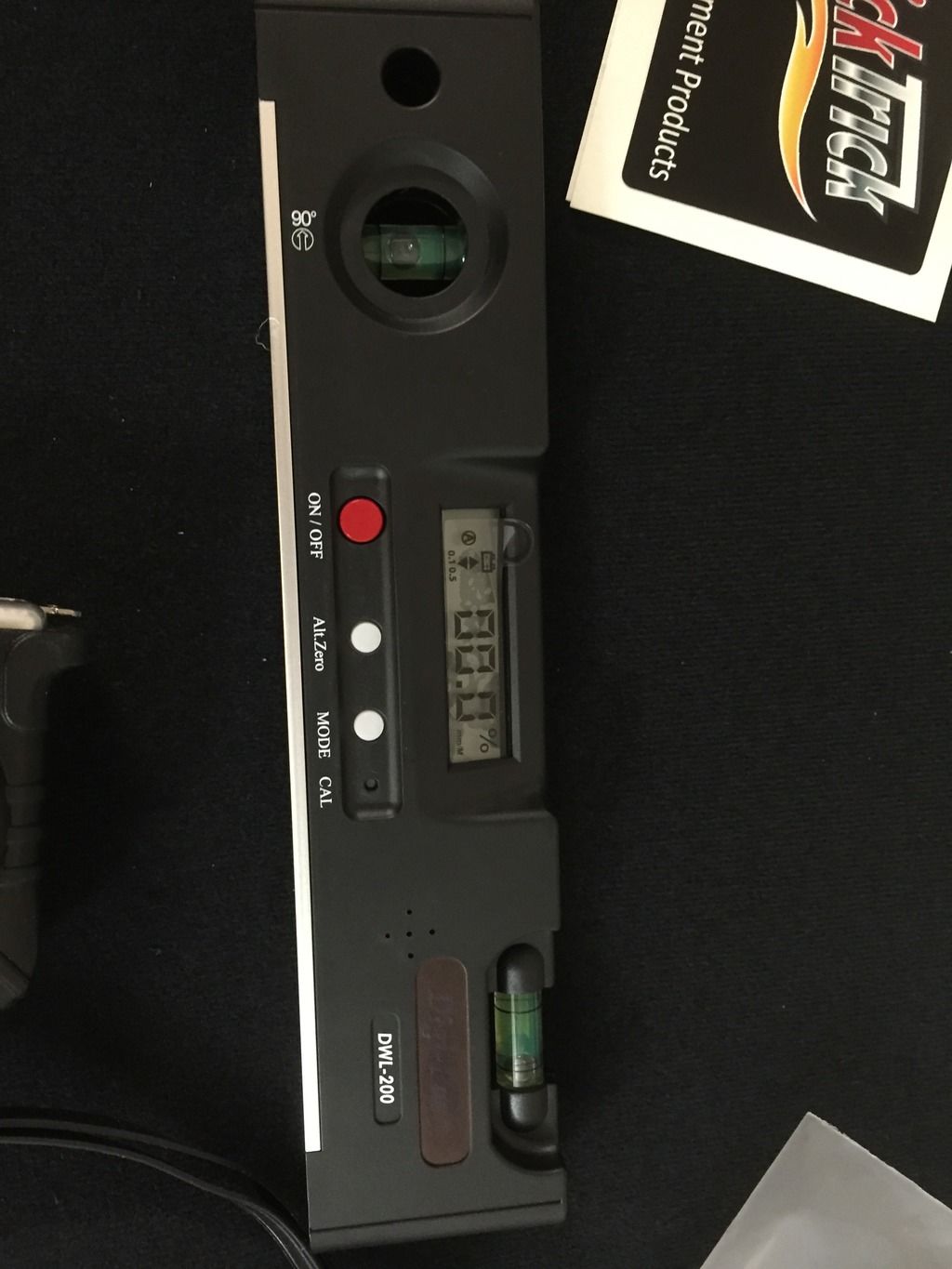

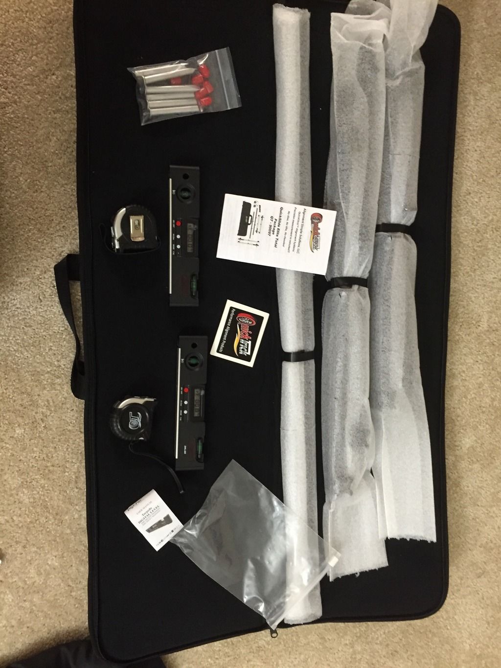

Oh one more thing,
My QuickTrick Alignment Tools Arrived Today,
it is the model
90097 QuickSlide Elite – Complete Mechanics – 13 – 22″ Wheels up to 38″ Tire
90097 QuickSlide Elite - Complete Mechanics - 13 - 22" Wheels up to 38" Tires - QuickTrick? Alignment Tools
It came with all the tools (including 2 unit of digital gauges) to measure
both left and right wheel Camber, Caster and Toe simultaneously...
I plan to do my own alignment asap since I have not done it since I install my Ohlins:

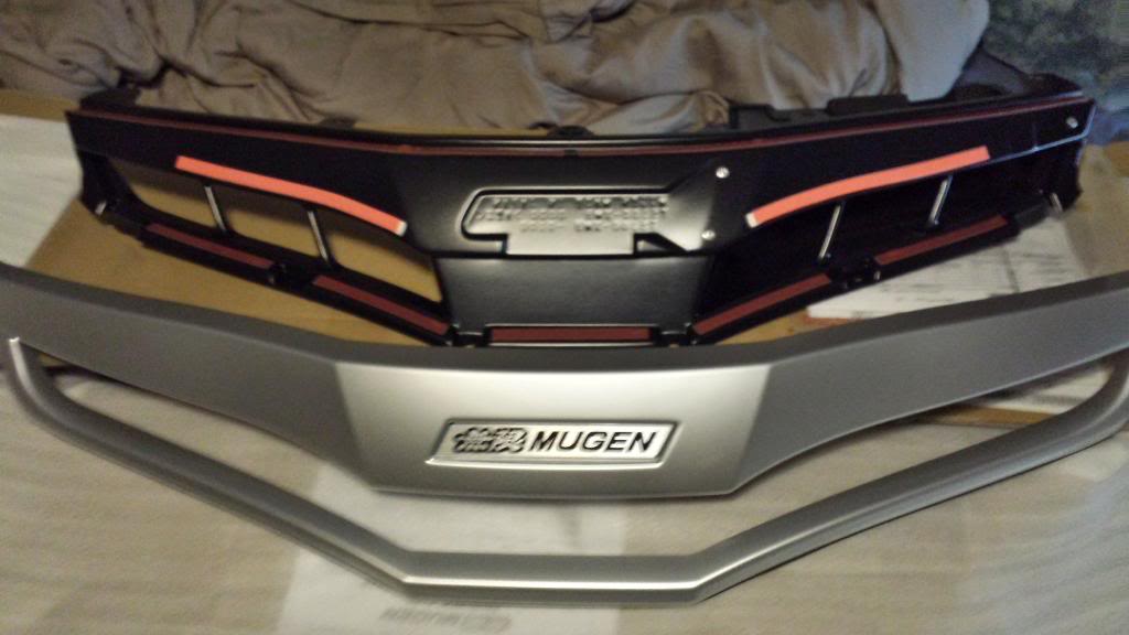

JDM Grille Fit
Alledgedly, it is supposed to fit the 2012 Sport, unlike the "Sport" grilles advertised on Ebay which specifically state that they are for the base model. At any rate, we'll see how it turns out!
I don't think that will fit.
But who knows maybe with some cleverness and engineering it might work. If it does you will be Fit famous
The only jdm grilles that will Fit the 2012+ Sport will be the Fit Shuttle grilles
But I hope you prove us wrong, or can make it fit-- but I have a feeling the lines won't line up.
Don't know where you got this info. It's well documented here what fits a 2012 Sport. Wish you found them and saved yourself some money. People here have taken that risk before. 2012 grill clips are 5 clips. The one you bought has 6 afaik.
Here is my Shuttle Grill:

BMWAlpina,
A projector retrofit will complete your car. JBweld not required if your using something that will just drop in like an H1 or D2S. However everything else will need cutting hence the JBWeld.
But, there are some retrofitters out there that make custom brackets now for headlights that minimize cutting, and make it easier also in the end to change out the projector to something else. Go on FB and check out a group called Headlight Junkies.

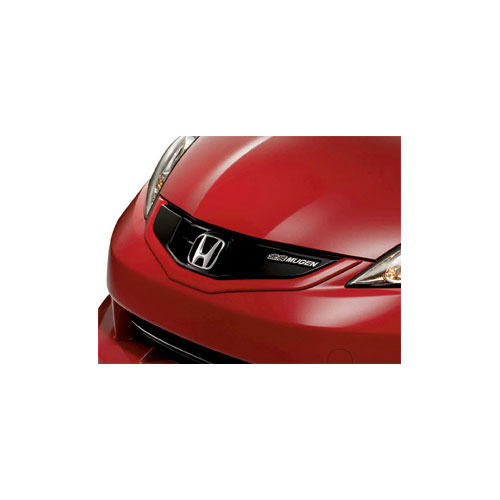

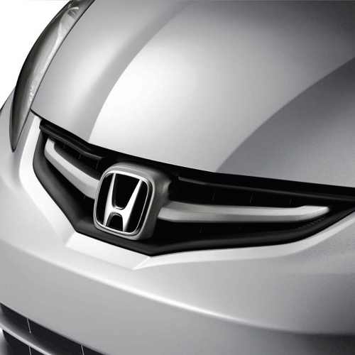

Originally Posted by cajlog
In that note, what grilles would fit a 2010 base ? Sorry if this has been answered before.
The USDM "Sport" Option grill will fit. Its not the stock sport grill but an oem accessory.
And I'm pretty sure the USDM Mugen grill also fits the base.
Attached Thumbnails What did you do to your GE fit today?-09_fit_grille_m.gif   What did you do to your GE fit today?-2009_fitmugen_frontgrill_m.jpg

Yes, the Mugen grille does still fit the base models.
