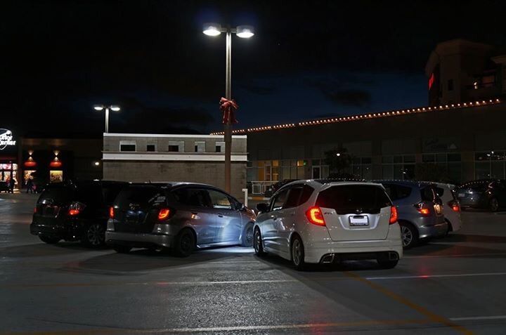

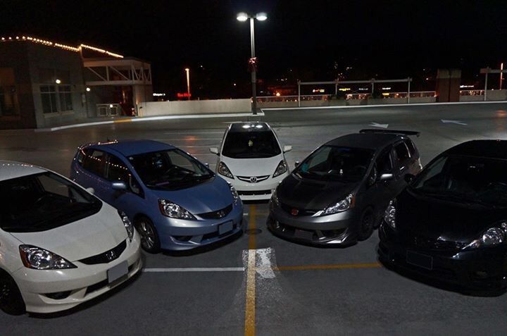

Meet up with some fits from canada and usa!
Props to v_fit for taking the pics!

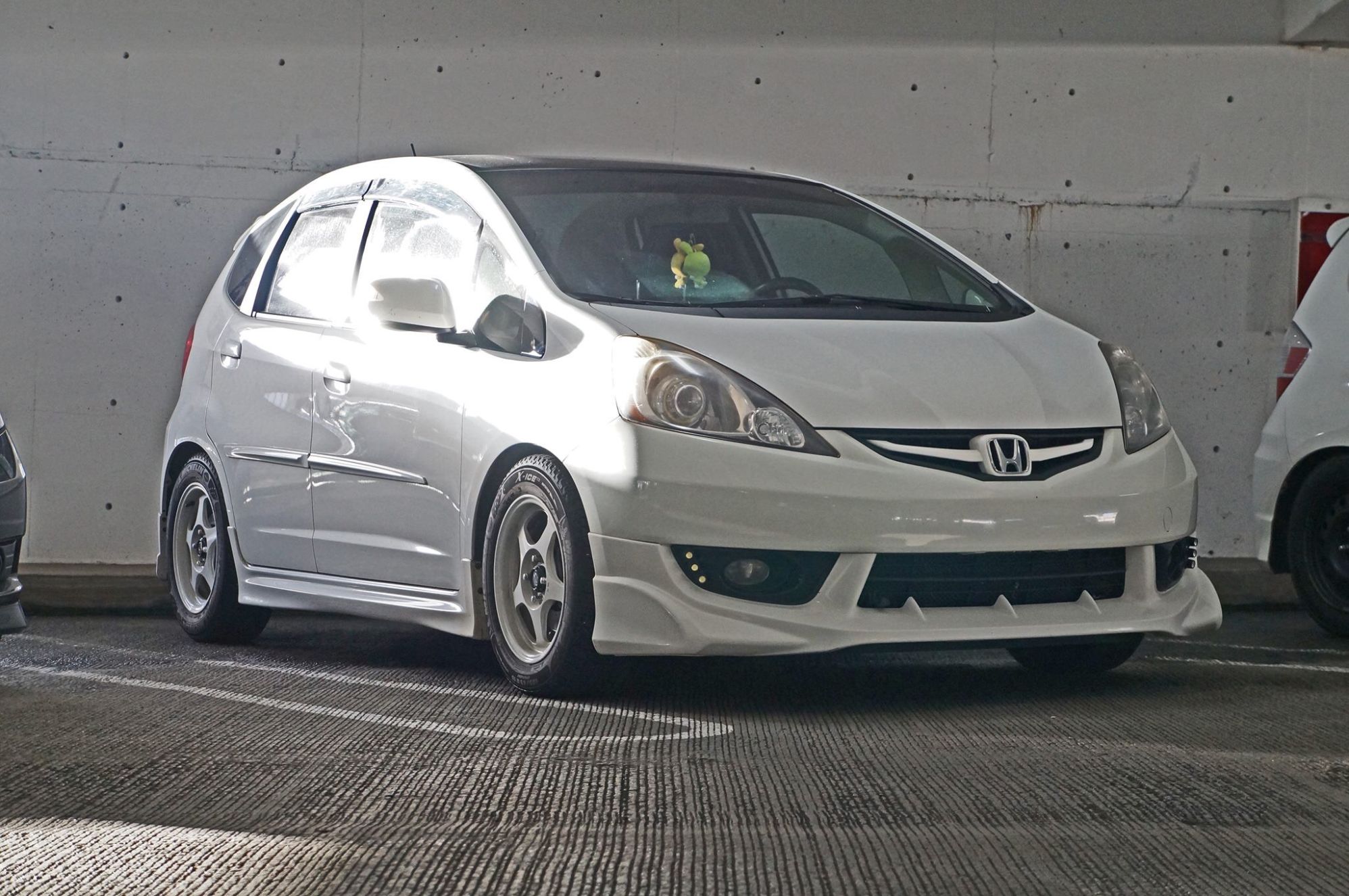

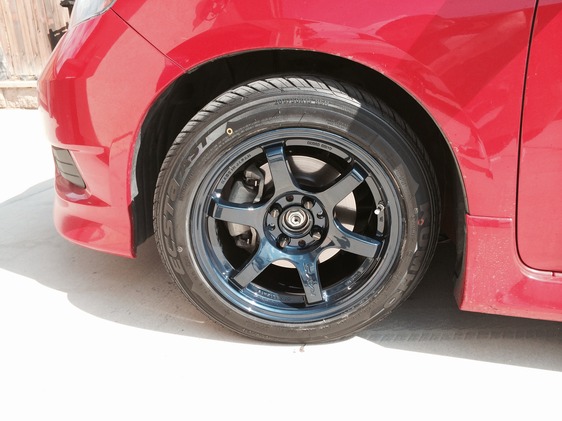

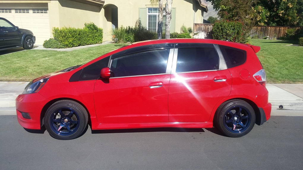

I tried to read through your thread to find your wheel/tire combo. I agree yours looks better than my 205/50/15 setup on Rays 57dr 15x8 +35. I attribute some of the gap to the smaller than stock replacement tire....but that would only account for about 1/2"....not sure how some GE's look like they have 1 finger or less gap. If my setup fit more like your TW then I'd be happier.
What did you do to your GE fit today?-42568136501.411354417.im1.05.565x421_a.562x421.jpg

A lot of it also depends on tire size. If you run a fatter tire you will have less gap, but some people don't like the meaty tire look. It's all personal preference.
Well you are running a smaller wheel so you are gaining a 1/2" gap already plus running a thinner tire than the stock circumference is adding another 1/4" so take the -.75 inches and subtract it from your drop. Lets say in this case your drop was 1.25 inches. So in actuality you only lowered your car. .75 inches from the fender to the wheel.
Its a lot of trial and error. But you could always run a bigger wheel 16 or 17 and run a tire with a wider side wall to make up for it.
Yeah once these 205/50/15s are done I plan to run a 205/55/15 to gain that overall diameter back to stock. I'm happy with the wheel, lighter, looks great and provides a cushy/comfy ride. Just gotta wait as these tires still got some serious life left.
Rained today and got one of the better spots at work so took a pic. Need to put the bra back on one of these days.

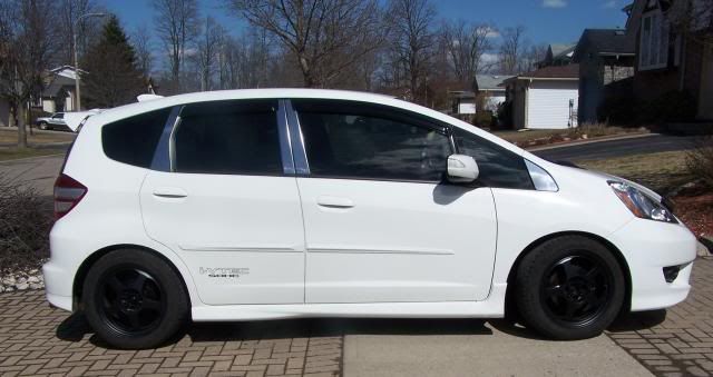

Attachment 2347
Attachment 2348

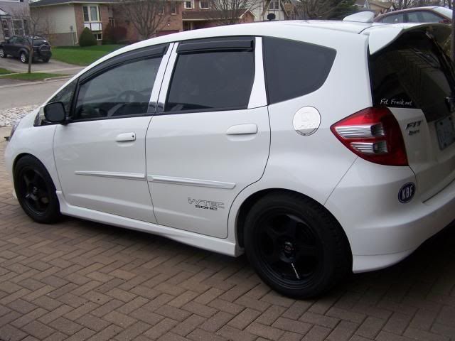

I am on 205/50/16

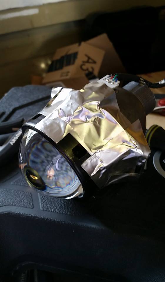

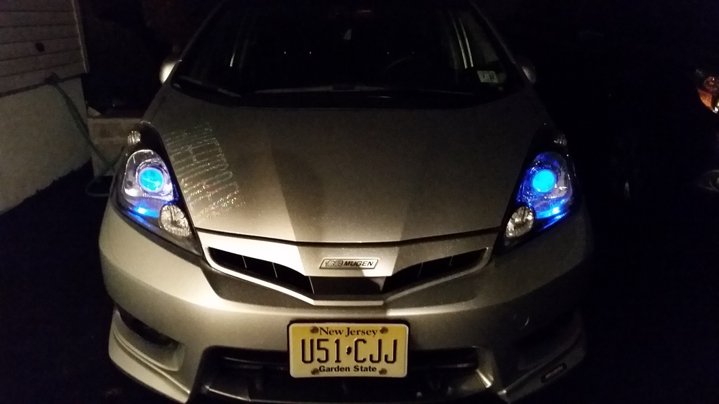

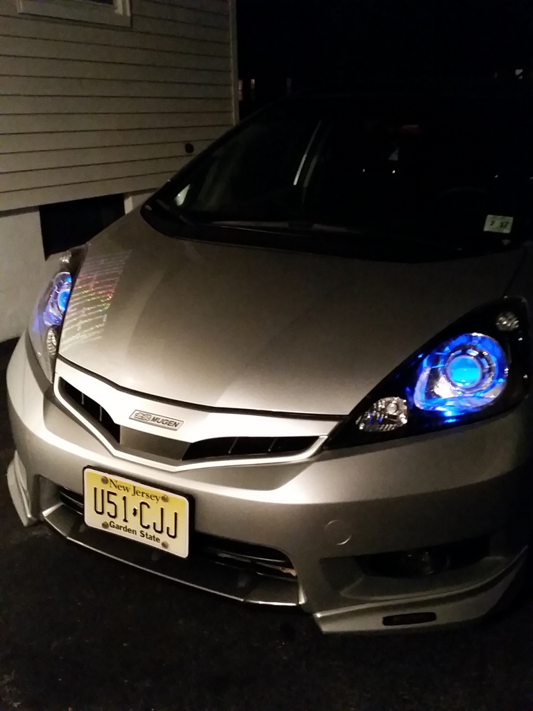

Finally got around to finishing the passenger side retrofit. Now much less light leakage from the rear and sides of the projector.
Before:
After:
Makes it a lot brighter and focused at night. However the improvement is marginal in the daytime. Still yet to see anyone with demon eyes that can out shine the Sun.
Installed my Js Racing Oil Cap and Radiator Cap. Replaced my stock D2s Bulbs with CBIs. Bluer color, but not convinced its brighter.
