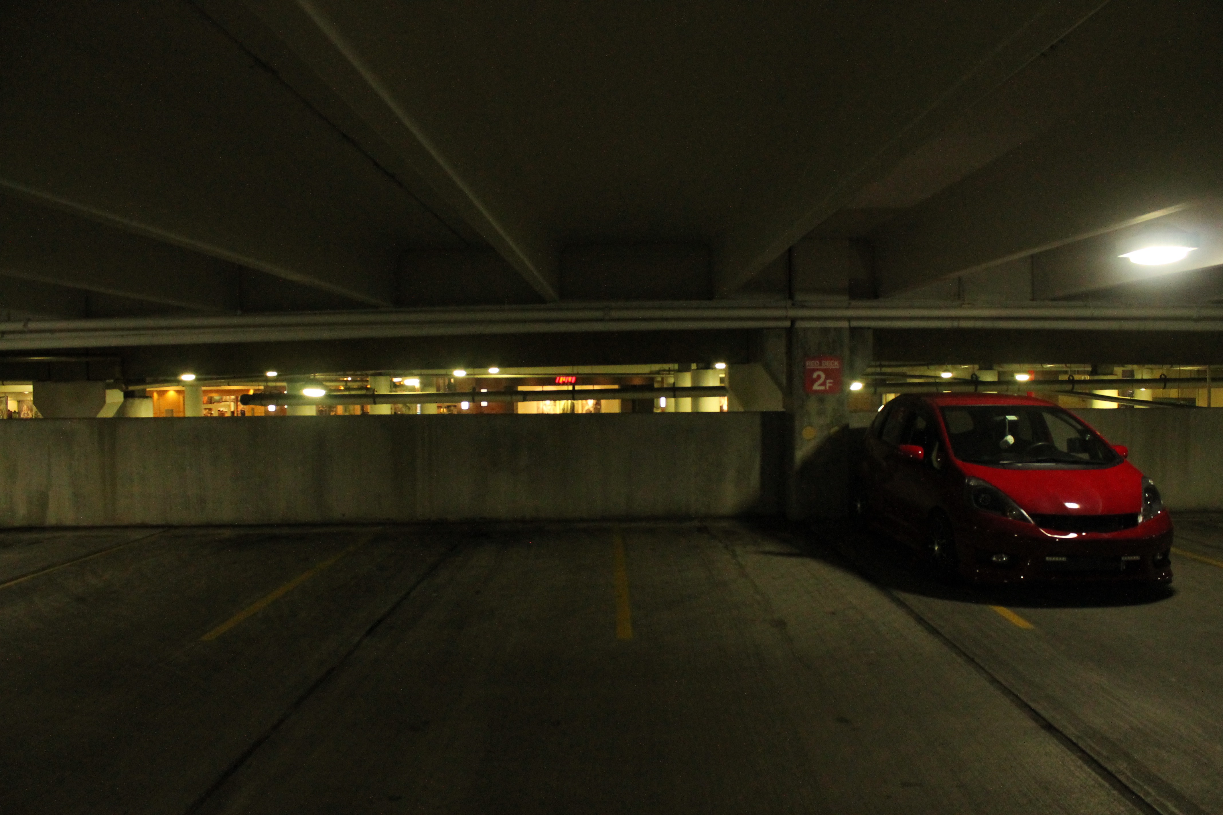

Here's a few pics I took tonight...
Honestly without the grille it looks pretty aggressive

Damn I'd feel honored lol. The pics will be better when I have a grille and eyelids

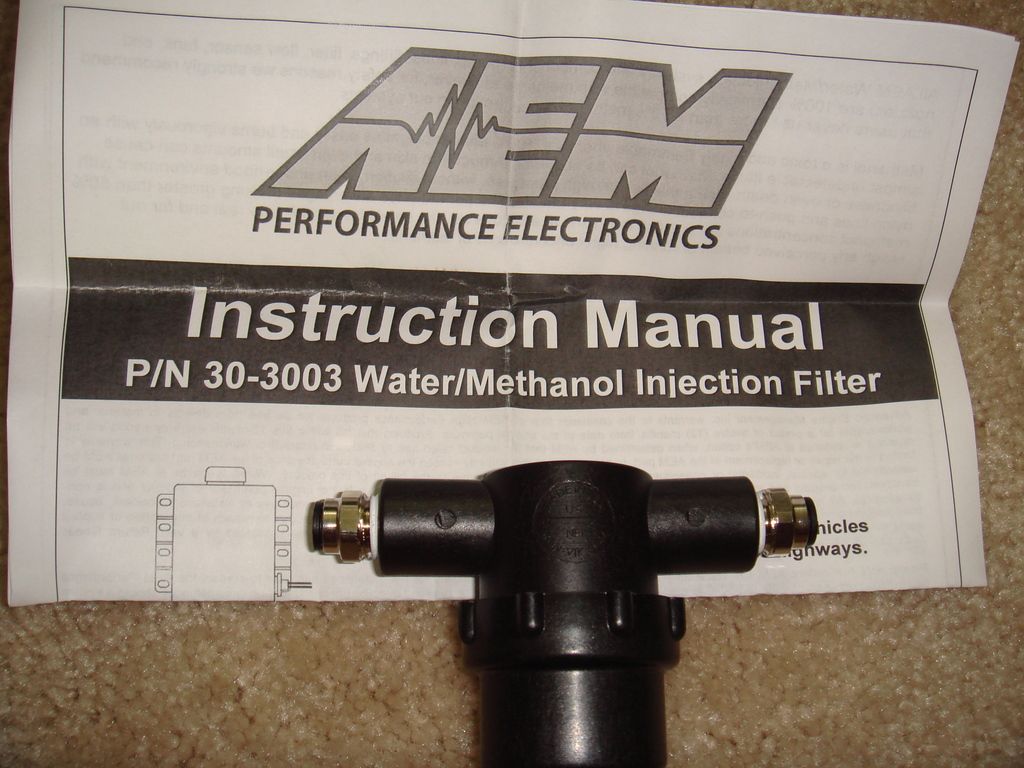

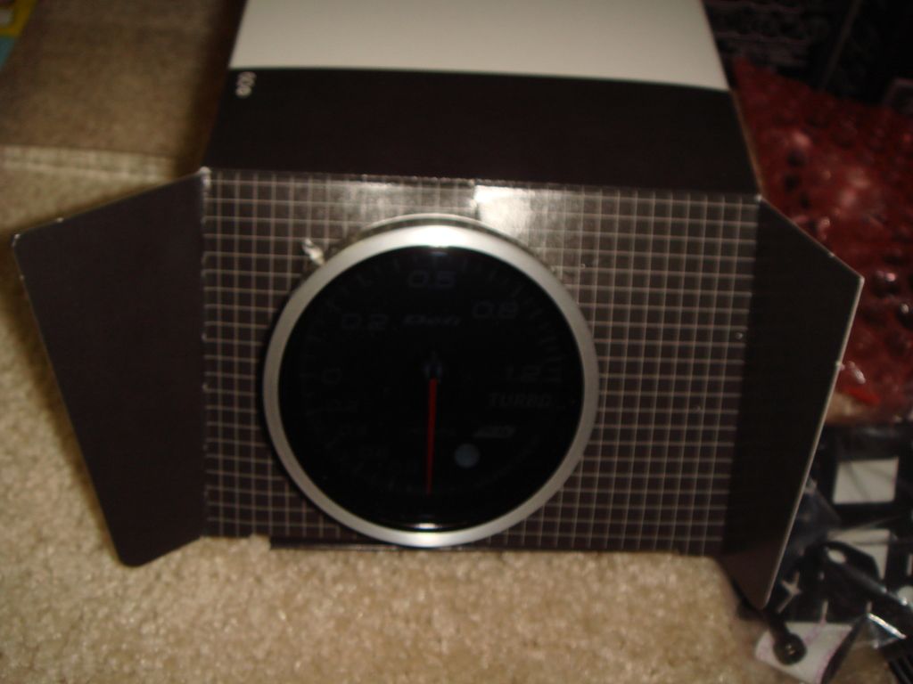

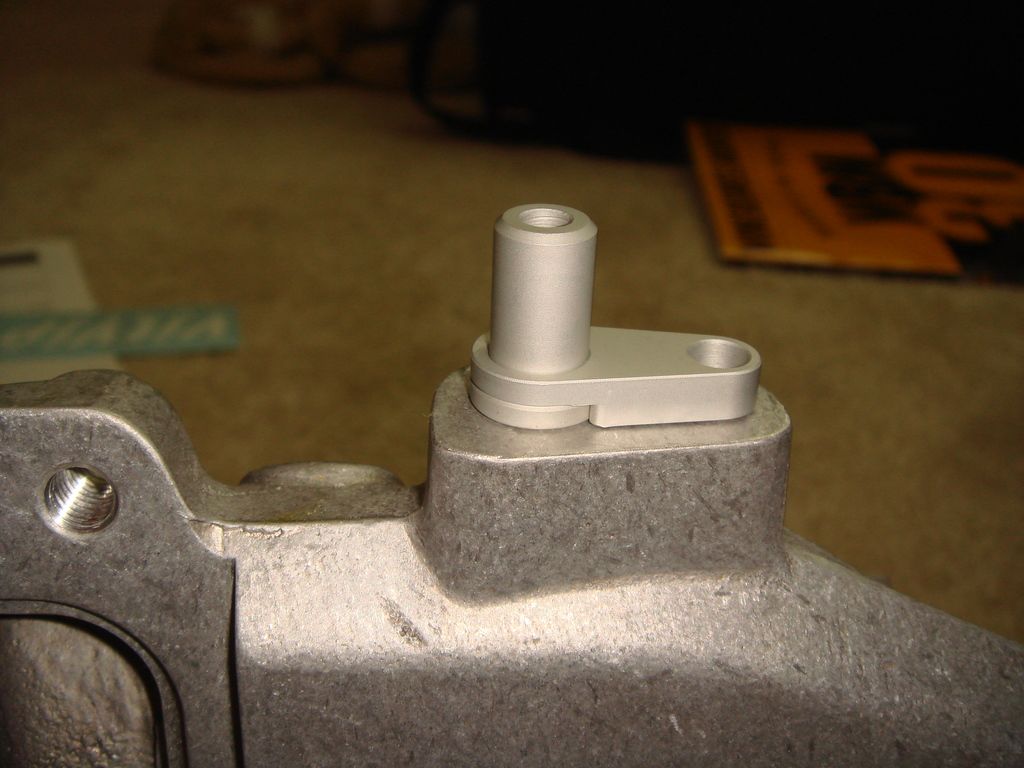

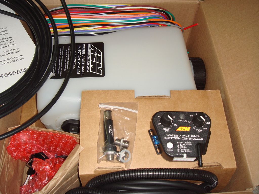

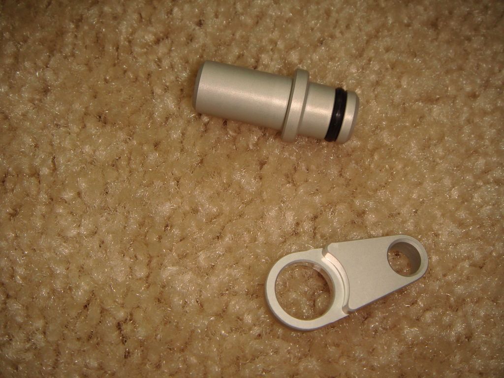

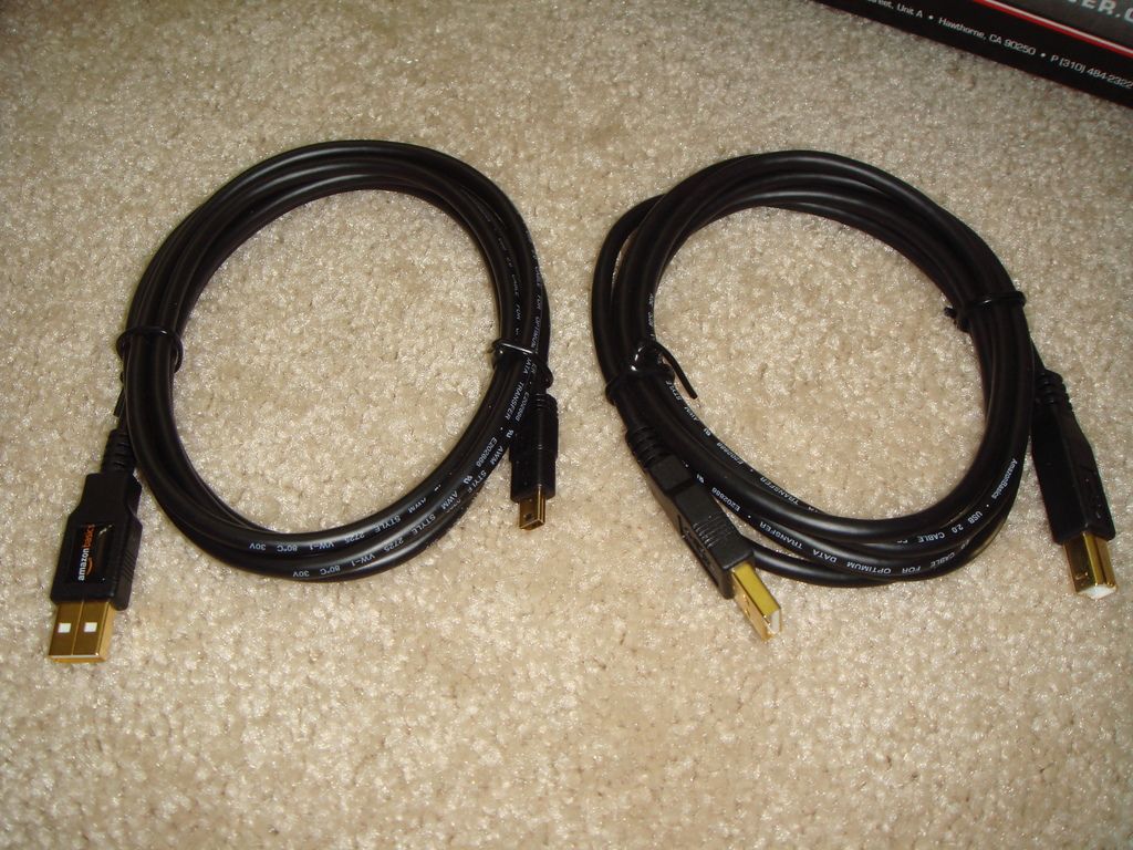

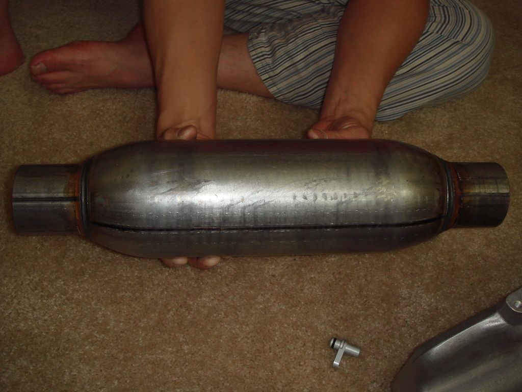

I have several parts for my Sprintex Install arrive today:
a. VitTuned Barb over MAP holes fitting:
b. Dynomax Race Series Bullet Round Muffler to help lower the noise
on my current 2 1/4 custom exhaust system:
c: AEM Water Methanol Injection System and Inline Filter:
d. USB Cable to download map to either AEM F/IC-6 or SMT-8L (most likely I go directly to AEM F/IC-6
f. Defi Boost Gauge, Water Temp Gauge and Controller:
Attached Thumbnails What did you do to your GE fit today?-80-dsc09756_cbee9836012e4ed05ae07b1cf6f38ac8171bd000.jpg   What did you do to your GE fit today?-80-dsc09758_ef1b42bf650dbe216664695fa9835919fbadf548.jpg   What did you do to your GE fit today?-80-dsc09759_036251d82adb97ab37a78252219755898d2674dc.jpg   What did you do to your GE fit today?-80-dsc09760_e97570e896ed83395a0472423ceda3f03ab3eb13.jpg   What did you do to your GE fit today?-80-dsc09762_e44992c34fe571a96b65c94fcf5f4a51a0526e91.jpg
What did you do to your GE fit today?-80-dsc09763_dea0fcfed6bbc6b5a4d345b81775baf5537722e0.jpg   What did you do to your GE fit today?-80-dsc09761_44ca3429a8f999dc1392182b1aad811ca91882de.jpg   What did you do to your GE fit today?-80-dsc09764_a99c7ddd2773dccb5c7a5fe8f0ffb5ea5a8737c7.jpg   What did you do to your GE fit today?-80-dsc09765_985f9698b96ce41d8c78f6aadd31711b5ca83551.jpg   What did you do to your GE fit today?-80-dsc09766_9463c429b64d30ac326e82d595cd0fcebaa4256d.jpg
If I ever supercharge instead of swapping, I know who I'm calling for advice haha. Is the AEM injection system for the supercharger to run better? I don't know anyone else who is doing this.
Old Jan 29, 2016 | 01:09 PM
  #14790
BMW ALPINA's Avatar
Joined: Jan 2013
Posts: 2,449
Hi Burzpaw,
I actually got advice from fellow member here SlimChriz who had done the Water/Meth Injection system on his Sprintex Supercharged car.
SlimChriz actually built his own water/meth injection system.
I want to make it easier for me so I just buy the AEM kit
The reason is because I had decided that I am going to use larger injector and no longer use the 5th injector from Sprintex kit.
This 5th injector is not accurate (in my personal point of view),
but it do have advantage of cooling the incoming air when it spray
fuel onto the intake elbow.
since I am losing this cooling and since Sprintex is a supercharger without any intercooler,
then the only way I can get cooled air is by
using this AEM Water/Meth Injection system,
this way I can run the same boost (or more with smaller pulley)
and do not have problem with detonation which should enable me
to have more reliable power available.
Thanks

That sounds like a plan. What's the highest boost you can run with the sprintex?

Oh nice! So is it going to be able to make more power than what Sprintex stated(~170) or is it going to make more power available in the lower powerband/rpm and make it more efficient? Or both?
But yea that's good to know for future reference haha. Thanks!
I actually have no accurate reference regarding the boost from Sprintex supercharger with standard pulley (not to mention smaller pulley),
that is why I bought the Defi boost gauge so I can know accurately
especially since I plan to grind port and polish both the intake elbow
and intake manifold.
Well, the Water/Meth is suppose to prevent detonation at high boost application but since our sprintex were designed with the 5th injector in mind which mean cooler intake charge and were NEVER design with any
intercooler, that mean if I am going to take out the 5th injector,
there is high risk of getting detonation especially in hot day, with the port/polish, Mugen intake and Spoon larger throttle body,
and not to mention smaller pulley when it is available.
so I decided to incorporate the modification on the intake elbow needed to integrate the water meth injection from the start.
Having said that,
I am pretty sure this water/meth will help make more power in the same boost since it will have more dense cooled air... I mean my knowledge and experience is limited in this area since I never do this before...
but I think that should be correct hehehe

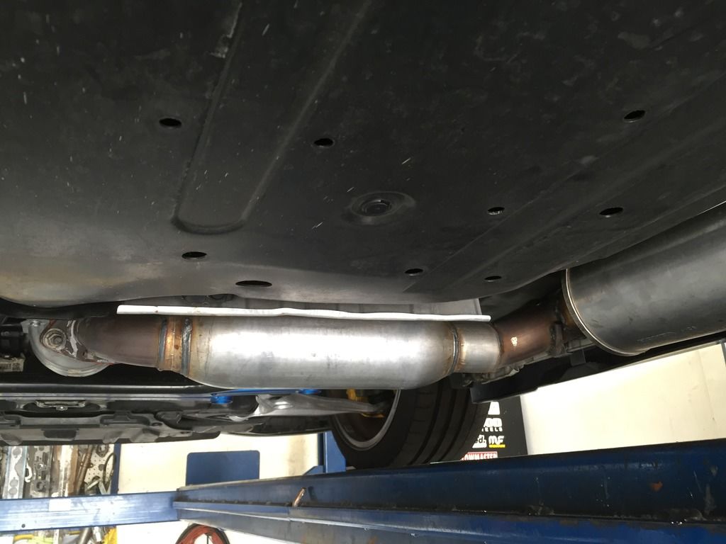

Adding another resonator to my custom exhaust system to make it quieter,
and now It sound PERFECT !!!
https://www.fitfreak.net/forums/2nd-...ml#post1334355

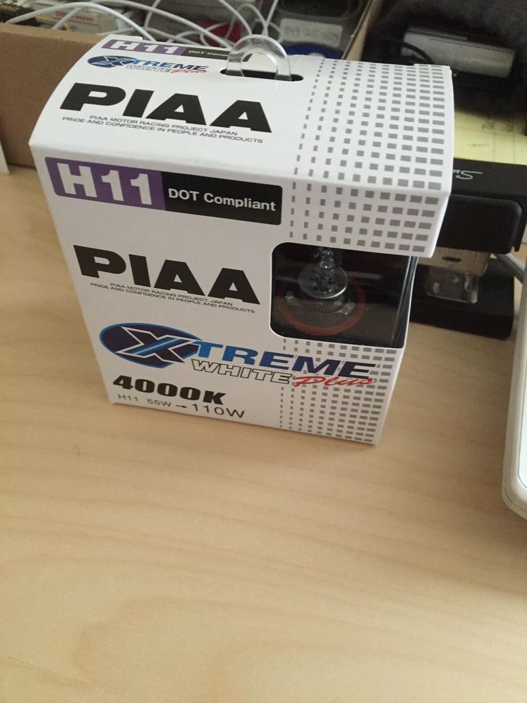

oh and my PIAA Xtreme White Plus bulb for the foglight arrive yesterday,
I will try to install them tonight so the foglight will finally match the headlight
Attached Thumbnails What did you do to your GE fit today?-80-img_0346_2df633b250f46866ad10e0a4601febf30ddfd76a.jpg   What did you do to your GE fit today?-80-img_0351_d53f2d8379bafba383ff884e742a8054eb11c453.jpg

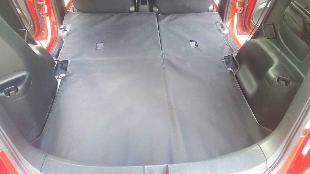

Started to install my OEM cargo liner I got for a steal on fleabay. Center piece installed super easy, remove the 3 headrests...install designated straps and lay flat and attach using the velcro thats stitched into the liner to stick to the upholstry.
Tried to install the side pieces and apparently the velcro I had laying around has the worst adhesive ever. Gum wouldve worked better. The velcro dots kept falling off despite cleaning the surface as directed.
Awaiting better velcro before I can install the sides.
Also ordered my Curt hitch so i can use my newly acquired Kuat sherpa 2 bike hitch carrier. Sold/selling my yakima roof rack to offset the cost. Anyone interested in a yakima snowboard/ski mount?
