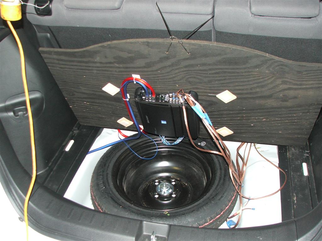

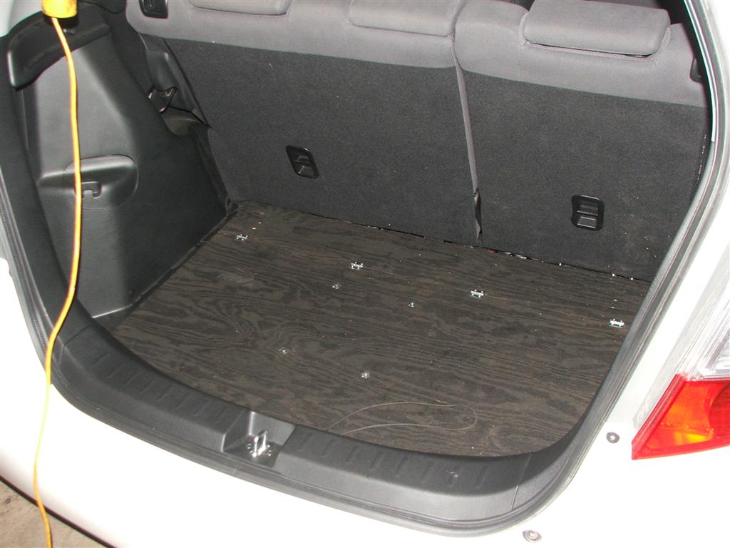

Here is what I did today, in the home stretch now. Just need to mount the terminal strips, put in the working crossovers (still haven't finalized a design yet, I am playing with them), tidy up the speaker wires (waiting for the final position of the terminal strips) and then I need to cut the carpet to shape and put that in. I also need to get a longer ground wire and figure out where I want to put the jacks for the sub-woofer speaker wire.

Old Apr 17, 2012 | 10:43 AM
  #4787
ThEvil0nE's Avatar
Posts: 3,626
From: Illinois
that's good to hear.
is that a 4/5 chann A amp? I don't think confining it under there without proper ventilation is a good idea. Also, check if installing the amp upside down is ok.
all in all... good progress
Old Apr 17, 2012 | 10:59 AM
  #4788
x_25's Avatar
Joined: Apr 2011
Posts: 524
From: North West NJ
Five channel class D. It gets warm but not hot, even playing loud. The way the heatsink is shaped and with it being enclosed, mounting position won't matter. If it ends up being a problem I will install a fan to get the air moving (already have a 12v supply back there now, so easy to do).
The end by the back of the seats has a 1.5" or so opening to the cabbin and there are plenty of airgaps arround the rest of it, so it should actually cycle air itself reasonably well.
