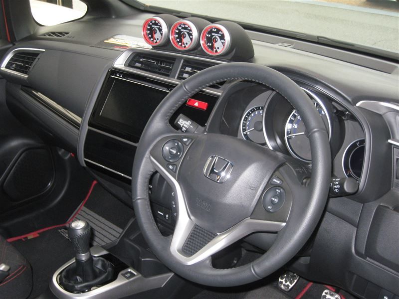

3. Then I need to get JDM Mugen Assist Meter (Triple Gauge) kit for Honda Fit GK model and will cover it with leather and yellow stitching and of course modified the gauge pod (if needed) so it will fit GE dashboard right behind the A/C vent. This Mugen Triple Gauge is made by Defi so I am sure I can just use one controller to control the rest of my Defi Gauge. I will also need to add Fuel Pressure Defi Gauge with some Goodridge 811 line to feed the fuel rail and the fuel pressure gauge from the firewall connection.
This is the picture on a GK Fit:

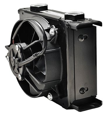

4. Setrab FP119M22I Oil Cooler (integrated Fan system) with Goodridge 811 and Laile/Beatrush Oil Cooler Sandwich connected to the Mugen Assist Meter Oil Pressure and Oil Temperature Gauge.
here is the pictures:

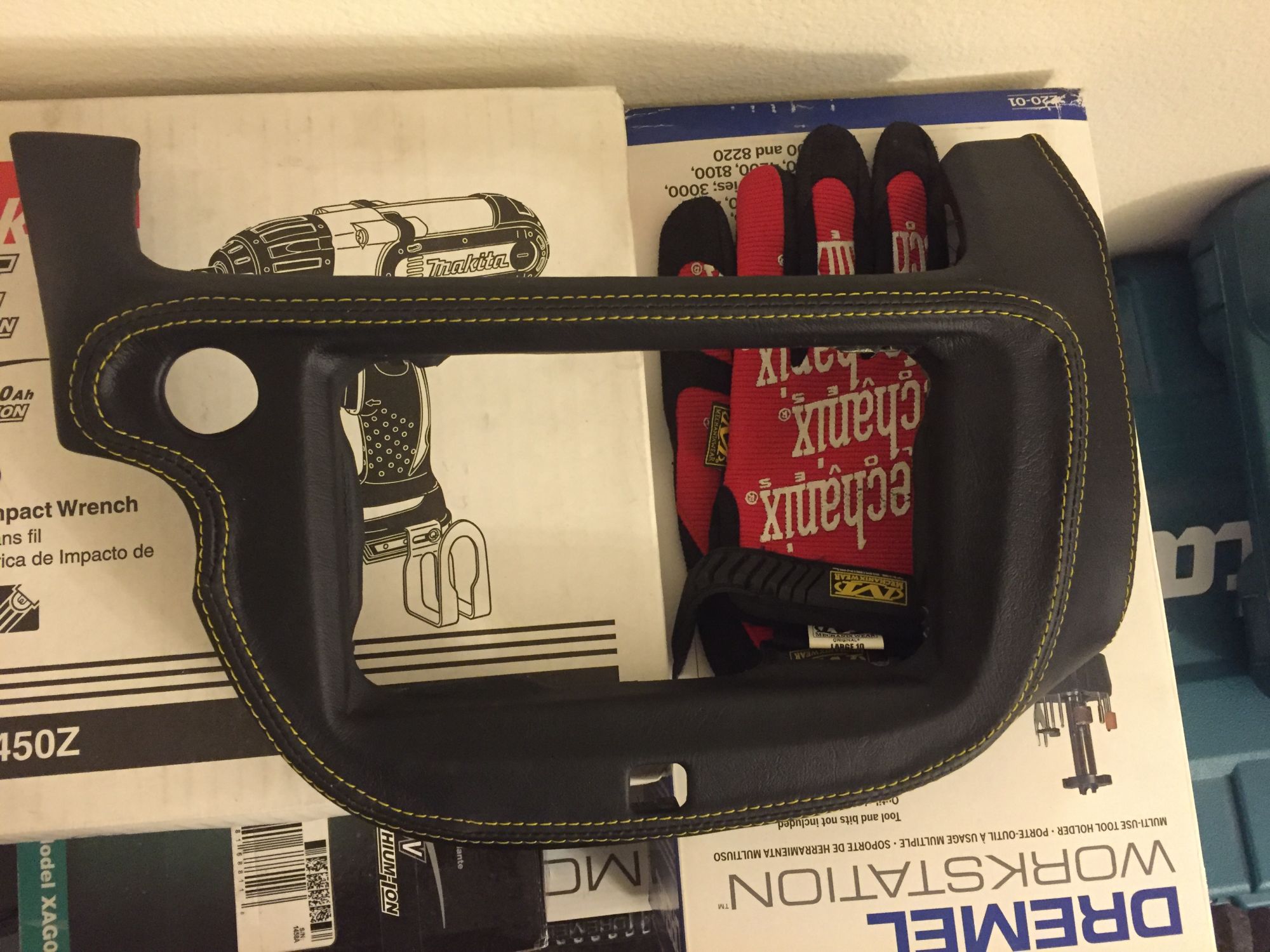

6. Upgrade the Sound System with a Navigation Head Unit with Fiber Optics Output (currently only Clarion made one (latest model), but maybe by the time I upgrade, Alpine/Pioneer will have a new one so I can choose... Alpine have one right now but it's few years old model so I don't want it) so I can have Zapco or Audison DSP and use Zapco 6 channel amp to drive 3 way Dynaudio Esotar system actively, Rear View Camera plus either Alpine or Pioneer under seat sub (will decide once I install the Recaro and measure the available space under the seat).
I currently already have the Honda OEM Navigation Trim covered in Leather and Yellow Stitching ready, (with JDM red hazard button), but I can't use it until I change to Nav head unit since my car is NOT Nav.
Here it is:

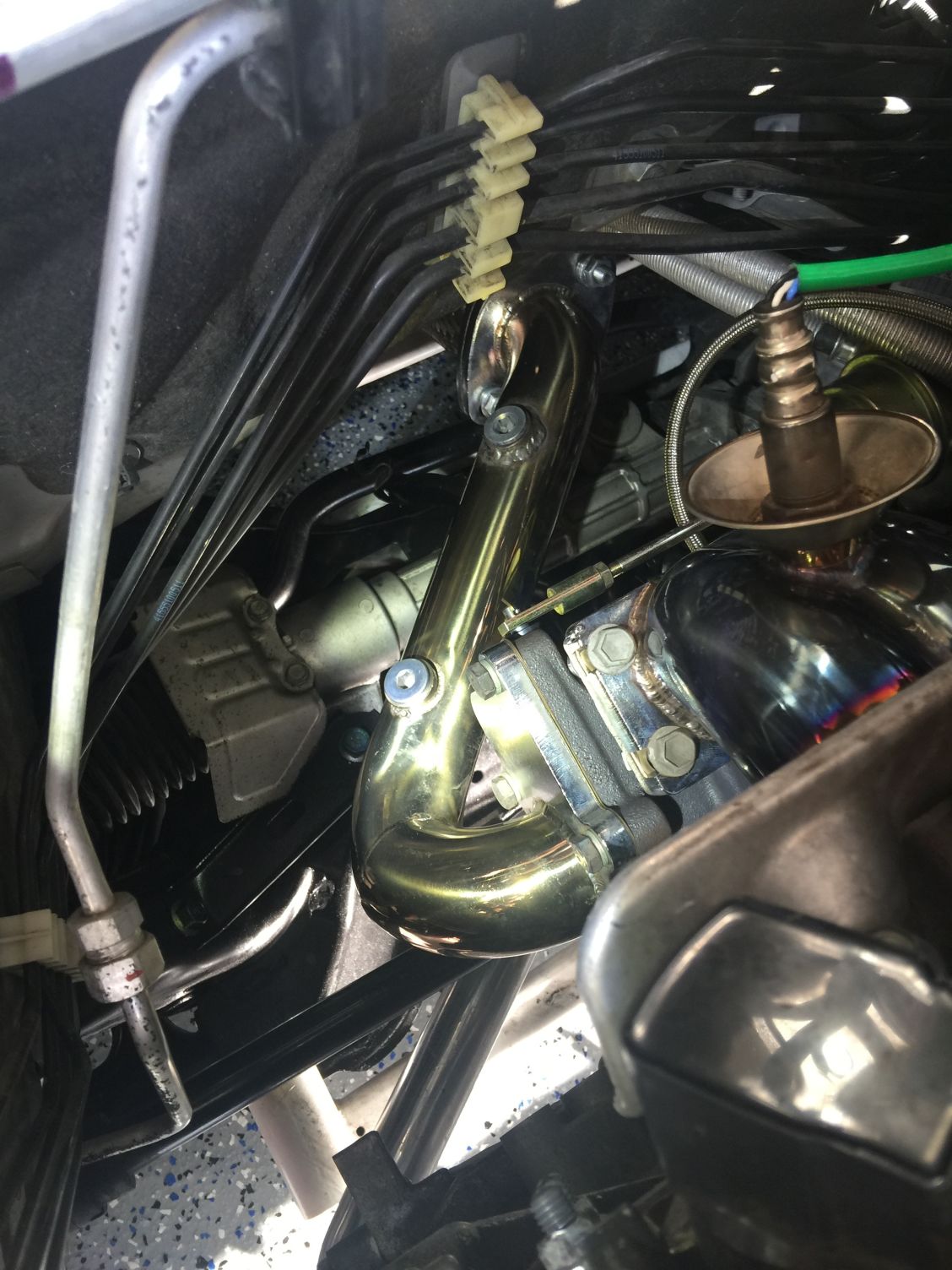

boosted my fit!!!

Damn... How much did that cost?

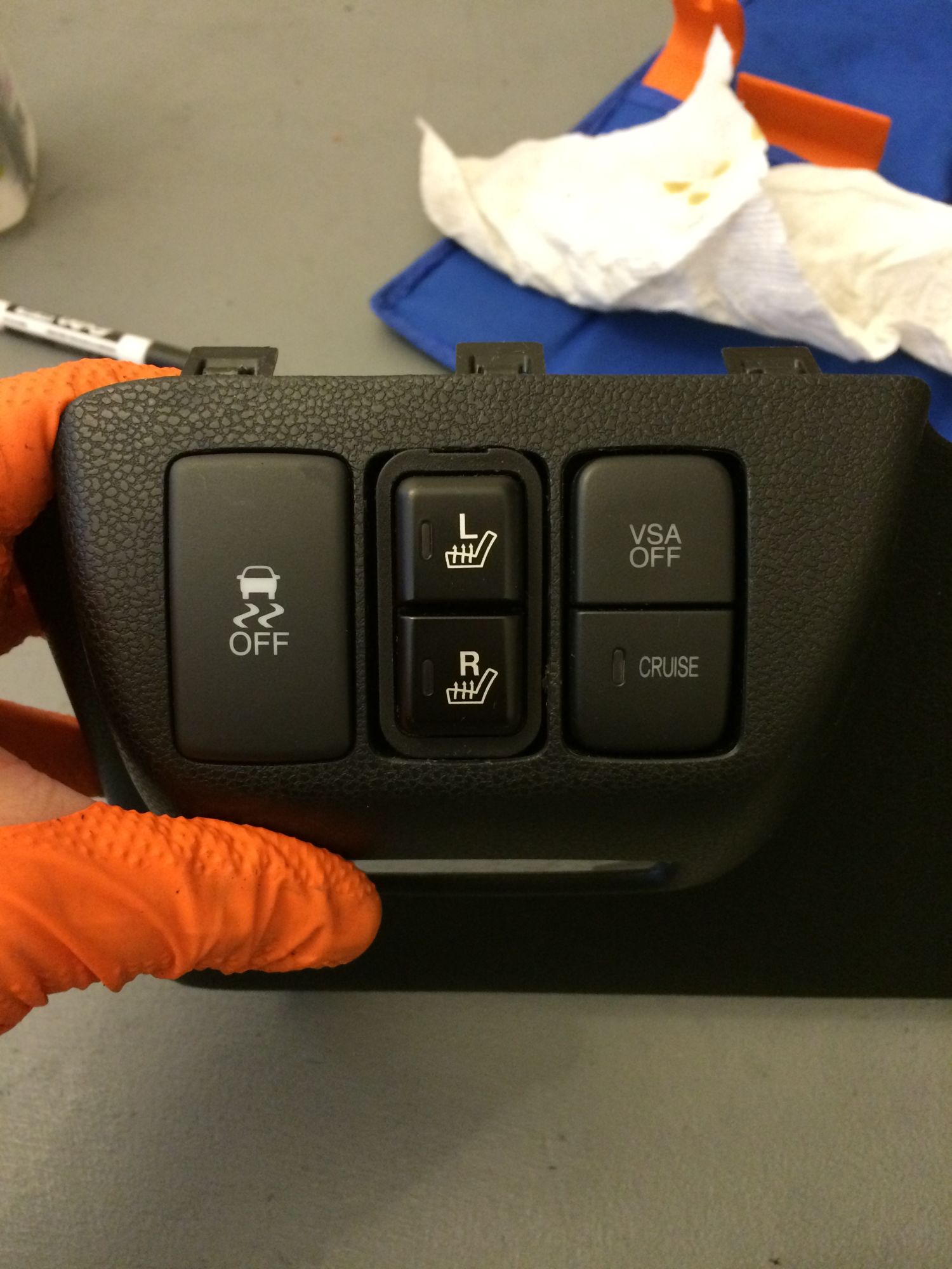

In this case, you can use this button currently sold on eBay:
1992 96 Honda Prelude JDM SI Seat Heater Single Switch LH RH Nice | eBay
I bought this one for my current project, the button is slightly taller
than the Honda Fit slot so a little filing/dremel is needed.
here it is already installed on my Honda Fit:
so you can replace both the base fog light switch and DRL LED rocker switch with just one of this switch and put it on the first slot.
then buy another one of this double Honda seat heater switch for your new button application and put it on the second slot,
if I am not mistaken you need 3 more button right?

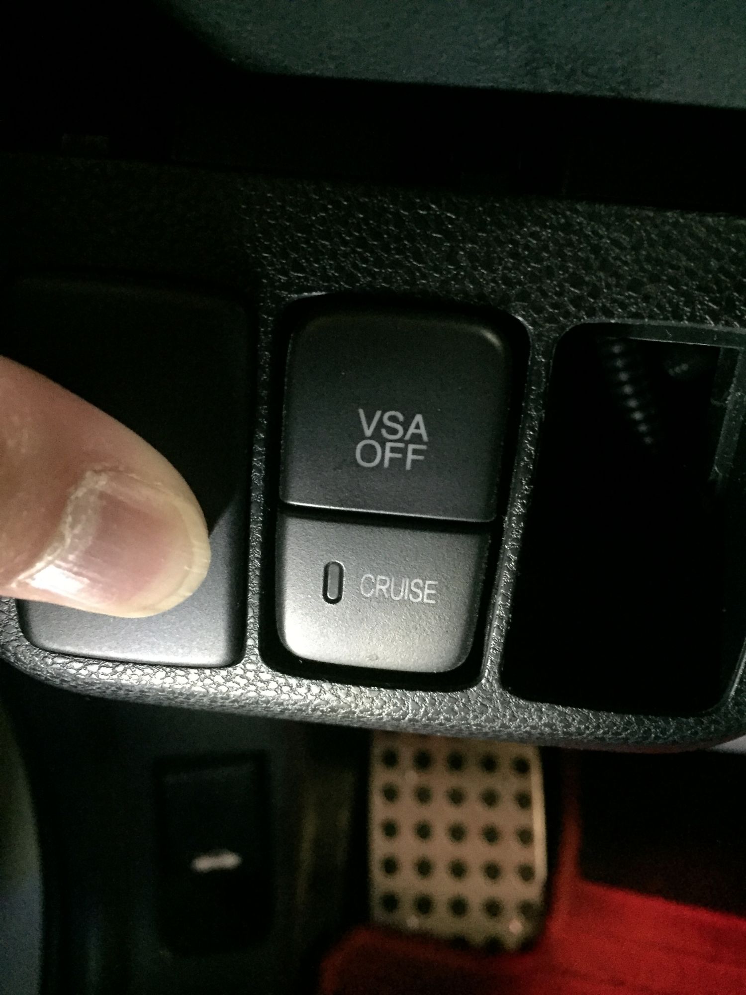

that mean,
you need to also replace your current VSA switch,
with the Honda CRV VSA/Cruise control combo switch.
like this one:
the only tricks is the VSA on our Honda Fit is normally close position,
so you need relay to use the Honda CRV VSA switch to make it normally close, while the cruise control button can be use for the last button that you ned.
